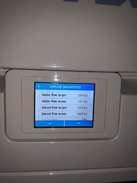

It’s been been a while ; so perhaps I haven’t noticed .
Inlet valves in rooms I can feel a definite air flow . Outlets ( to the outside ) ; so bathrooms etc. I can feel nothing at the vent . Even a piece of tissue infront the vent doesn’t stutter . This correct ? . Though if I take a shower the mvhr kicks in - so I assume working ???
I can't feel anything at my extract points but if I put a sheet of toilet roll at the terminal the air flow holds it there.

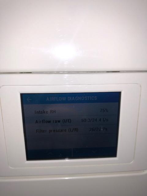

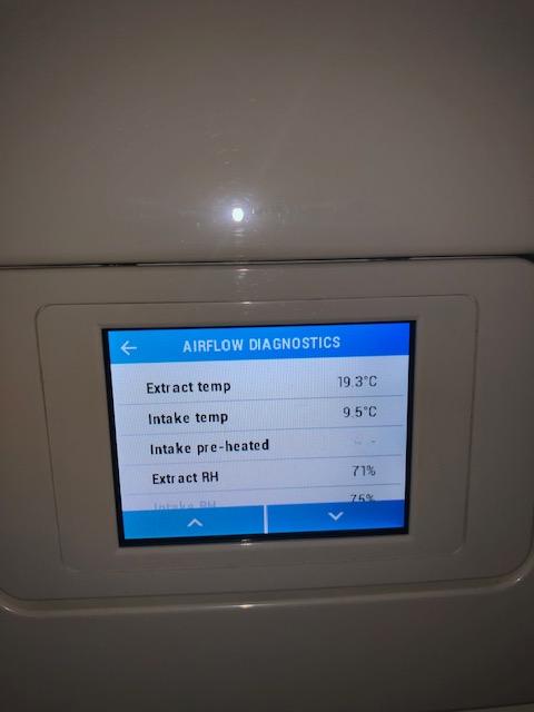

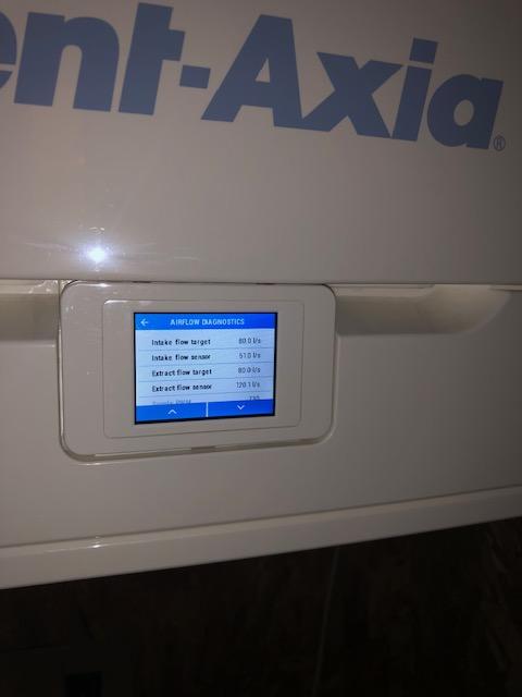

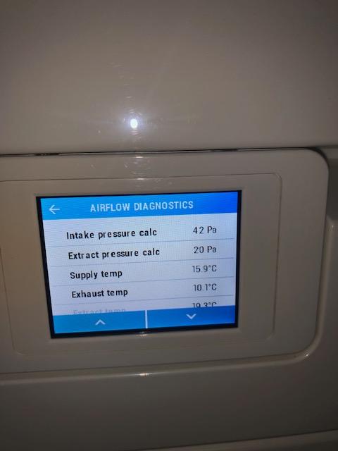

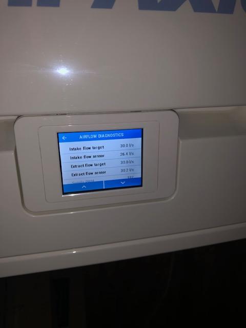

So as a test to prove it’s all working could I block all outlet valves ( plug them ) and just leave the bathroom one open . I’m assuming then I should definitively feel air being drawn out as only 1 outlet valve in use .

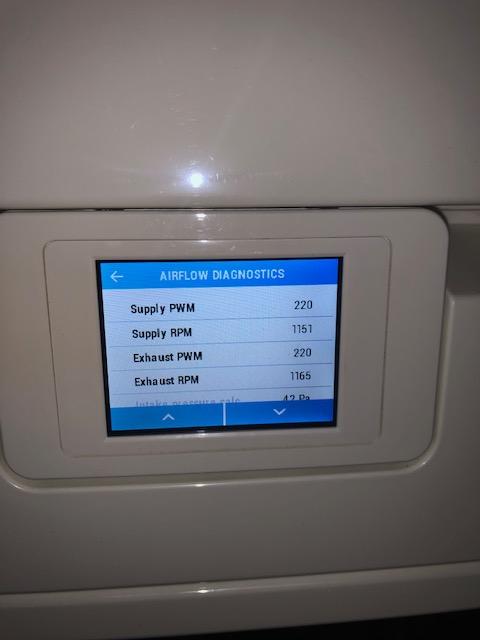

Sorry for the delay!
About 15 mins after a shower. Outlet have a tiny flow ( even though fully open )
I completely closed all inlet vents underground apart from 2 outlets
MVHR is now going for it!!
But still feel very little airflow at the bathroom outlet for example....
Strange!. Removed all the inlet caps and it's returned to normal speed . Outlet ones didn't appear to change
I checked and replaced the filters .
Atmosphere in almost black !
Air out ; grey with dust .
So it seems to be working; but the airflow out in room is hardly there ….
