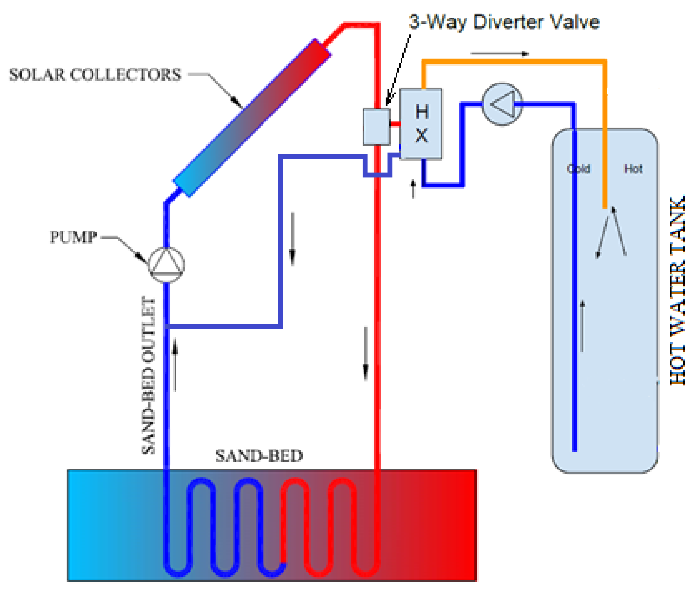

1 hour ago, Iceverge said:
I'd start with something like this.
Then line the inside with foam boards with all joints crossed and foamed.
Then something like dense mineral wool like that which is used for EWI that would happily take hundreds of degrees of heat.
Next part is tricky, Maybe a thin steel liner, tech screwed together.
Electric heating elements embedded in the sand then.
Run a copper coil through it back to the house to small radiator and pump to extract the heat.
300mm of PIR plus 100mm mineral wool should give a U value of about 0.06w/m2K.
Assuming the volume remaining inside is about 1.8mx1.8mx3.6m you would have an internal surface area of about 32m2 and a volume of 11.7m3. Sand with a specific heat capacity of sand at 800j/kg/K and a specific density of 1.6 would give about 1.5 Mj of storage per degree or 0.4KWh/K.
If you were to assume the lowest useable temp to be 40 deg and you wanted to raise temp to 100 deg it would take 24kWh of input. Not undoable.
The losses however ( assuming an average temp inside of 70 deg and 10 out side would be 32m2 x 0.06 W/m2k x 60 DeltaT would be 115w or 2.76kWh per day, say 3kWh with pipe losses.
Assuming this system was charged and discharged over a 2 day period it sounds like 24kWh in and 18kWh out = 75% Efficiency. Not nearly as bad as I expected.
