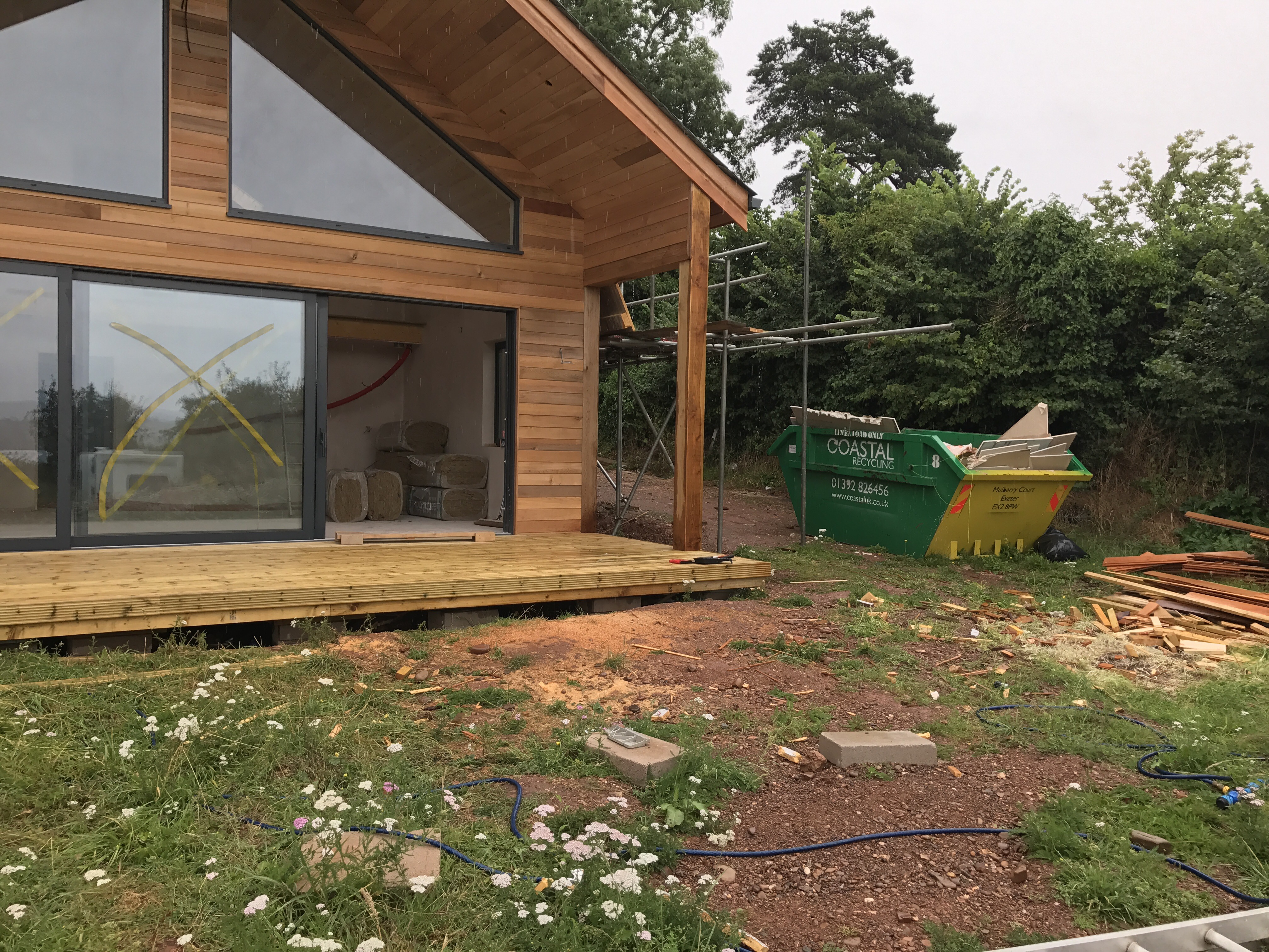

Jimbouk Posted July 11, 2017 Posted July 11, 2017 (edited) Our decking runs the width of the house circa 8m and extends out 3m, as we have dug the house slightly into a hill, we are looking to use the spoil to reprofile the ground adjacent to the decking. This will raise it circa 40cm by the decking, giving a continuous level surface from the internal finished floor, across the patio door threshold, decking and then grass. (Many sleepless nights getting those levels spot on so far!) This will mean the lawn is adjacent to the sides of the decking, will this be ok? Joiners have suggested fixing some dpc membrane vertically between the two, I'm wondering about some acro drain (not very attractive). Any better solutions welcomed! Edited July 11, 2017 by Jimbouk Photo added 1
PeterW Posted July 11, 2017 Posted July 11, 2017 DPC to the side and a narrow french drain - other option is to edge the grass with timber and make sure there is a gap between that and the last joist leaving an air gap
ProDave Posted July 11, 2017 Posted July 11, 2017 I would stop the decking short of the grass, and put a strip of paving slabs or a soldier course of paving bricks to form the transition from deck to lawn.
Nickfromwales Posted July 11, 2017 Posted July 11, 2017 14 minutes ago, ProDave said: I would stop the decking short of the grass, and put a strip of paving slabs or a soldier course of paving bricks to form the transition from deck to lawn. And much easier to strim / mow against too.
Barney12 Posted July 11, 2017 Posted July 11, 2017 (edited) I would create a transition with stone/gravel. 4-6" would be enough which means you could go for something expensive. If you take the grass to the level of the decking it will only be a matter of time before you damage the decking with the strimmer or mower. Edited July 11, 2017 by Barney12 Typo
daiking Posted July 11, 2017 Posted July 11, 2017 http://www.pavingexpert.com/edging4.htm Or create a separate timber edging between them that can be replaced and won't cause you decking to deteriorate http://www.pavingexpert.com/edging2.htm
Ferdinand Posted July 12, 2017 Posted July 12, 2017 (edited) Practically, I would be thinking about a B-list movie: Vermin in the Void (and how to get them out again if the worst happens). I think I would look at pavers on edge to cover the gap ... they could be decorative, and perhaps a path of the same pavers round it. If it were me the paver path or edging would be laid loose on a French drain or gravel filled trench, where I could stick services running round the house or garden in future if needed, or dig out in a restorable fashion for future work. If I had some left I might even stick a duct and drawstring in it, rather than skip it. Path for future watering system or lecky? Or the path could be laid as an edging at or just below turf level. Could also be done with a narrower path. F Edited July 12, 2017 by Ferdinand
Jimbouk Posted July 27, 2017 Author Posted July 27, 2017 Thanks, we have now poured a concrete footing all the way around. Will build a block wall on this and the cap with narrow pavers, flush with decking and lawn. This should avoid the damp issue and add a bit more structural integrity to the deck, it will have the blocks just under the leading edge. More time and expense, but hopefully worth it in the long run.
