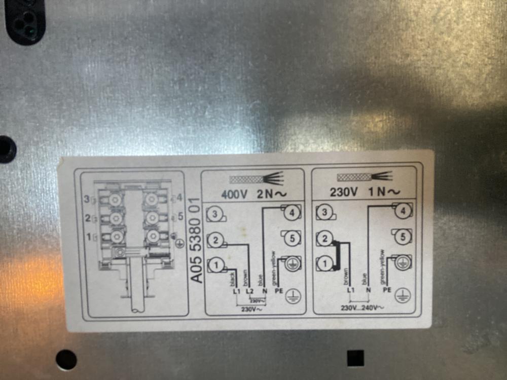

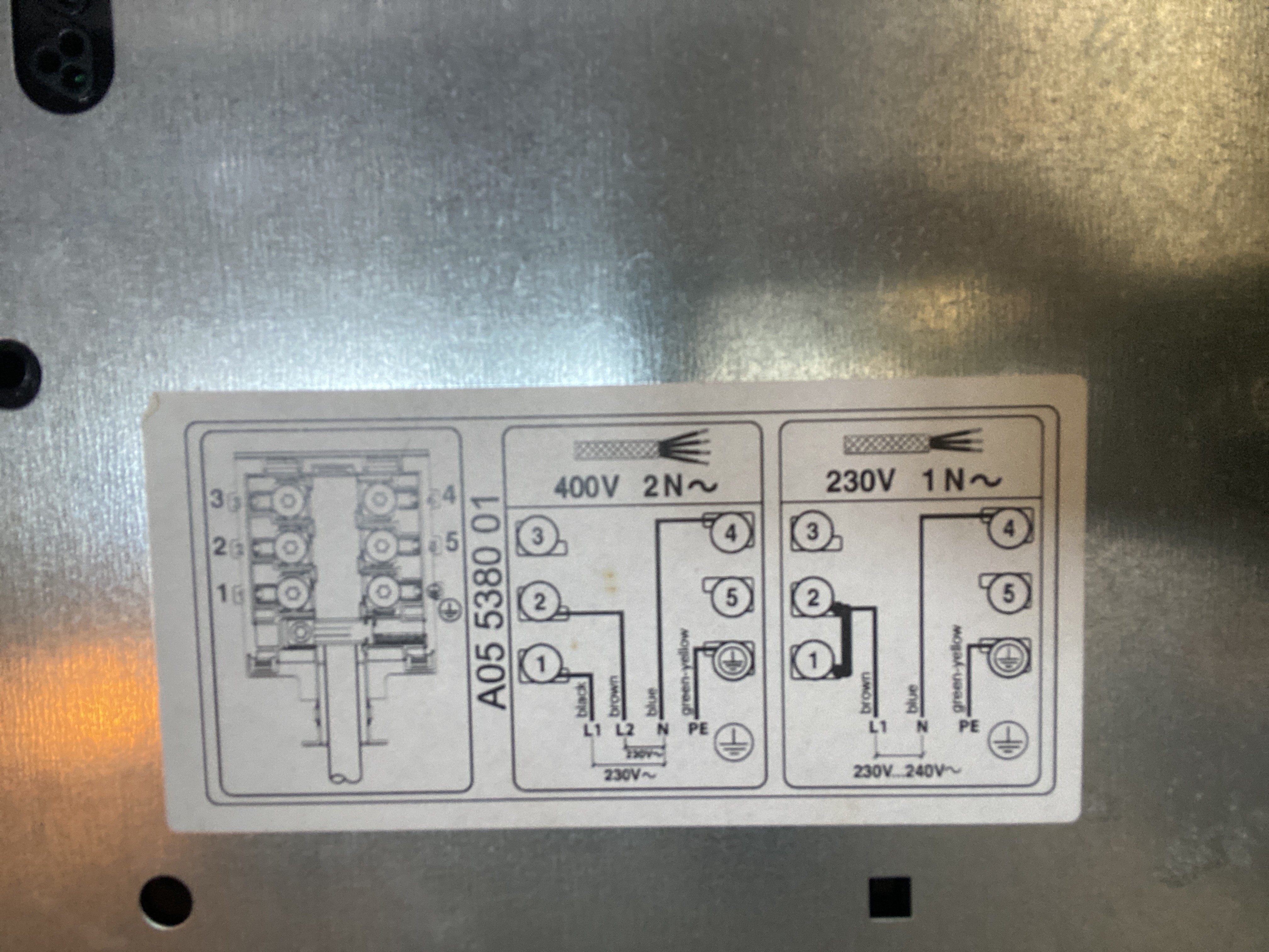

CotswoldDoItUpper Posted December 29, 2022 Posted December 29, 2022 I have inherited an induction job that I might stick into the utility room (mainly for making jam etc). The label on the bottom suggests it can be wired into a standard 230v circuit. Is there any reason I can’t wire it onto a plug and simply plug it in to a socket? Thought it’d be wise to check here first!! thanks!
ProDave Posted December 29, 2022 Posted December 29, 2022 Probably not. Induction hobs are usually high power. Are there any other rating plates or other info, even a make and model number. 1
jfb Posted December 29, 2022 Posted December 29, 2022 Indeed, the fact it runs on 230v doesn’t say how much power it uses 1
CotswoldDoItUpper Posted December 29, 2022 Author Posted December 29, 2022 It’s an AEG induction hob. No other info on it, just the number on the sticker which could be a model number. A05 5380 01.
Bonner Posted December 29, 2022 Posted December 29, 2022 Most induction hobs are 7.5kW / 32A, way over the rating of a 3 pin plug and normal circuits. It needs a dedicated supply off it’s own fuse/breaker. 1
Alan Ambrose Posted December 29, 2022 Posted December 29, 2022 (edited) If you google the code you gave above you might (after a couple of jumps) find the same number as me for that product: that is 7.35 kW. Max for a UK plug is about 3kW, and actually 3kW often doesn't work too well if either the plug or socket isn't high very quality - you can get arcing and heat. In principle you could do it and expect the 13A fuse in the plug to blow if you used more than one ring/zone. But I wouldn't. I'm sure a qualified electrician will be along in a jiffy, but the 'right way' of doing it would be a dedicated circuit to the consumer unit on say 20A or 32A wiring / breaker and out to a proper cooker-rated switched spur with the hob directly wired in. Or just buy yourself a single/double zone hob less than 3kW. Edited December 29, 2022 by Alan Ambrose 1
billt Posted December 29, 2022 Posted December 29, 2022 Some induction hobs are designed to be able to work from a 13A plug. They limit the total power to the rings to use less than 13A. This probably isn't one of those though.
CotswoldDoItUpper Posted December 29, 2022 Author Posted December 29, 2022 Thanks @Alan Ambrosethats a good search! Def not a plug then! There is an already a 45a cooker circuit there with a switched fused spur and an existing double oven wired into it. Does anyone think I can add this hob to that circuit? I guess 45a is enough for the oven but not the hob as well?!?
ProDave Posted December 29, 2022 Posted December 29, 2022 8 minutes ago, CotswoldDoItUpper said: Thanks @Alan Ambrosethats a good search! Def not a plug then! There is an already a 45a cooker circuit there with a switched fused spur and an existing double oven wired into it. Does anyone think I can add this hob to that circuit? I guess 45a is enough for the oven but not the hob as well?!? Ovens take surprisingly little so I would go with that. Click make this handy double appliance cooker connection unit, swap the existing one for this to connect both the oven and the hob. https://www.tlc-direct.co.uk/Products/AA45DCOP.html
gravelrash Posted December 29, 2022 Posted December 29, 2022 its designed for 3 phase but can be used on single with split live and identical to De Dietrich - as per diagrams, but they must be hardwired with 40amp min and 6mm cable. Do not share connection.
TonyT Posted December 29, 2022 Posted December 29, 2022 It can be used on 230 volt but not a 13 amp plug top, needs hardwired as others also have advised.
