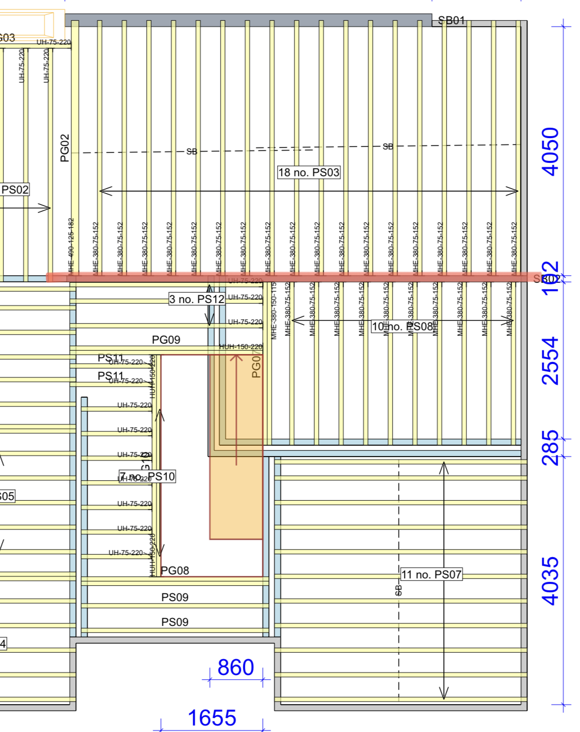

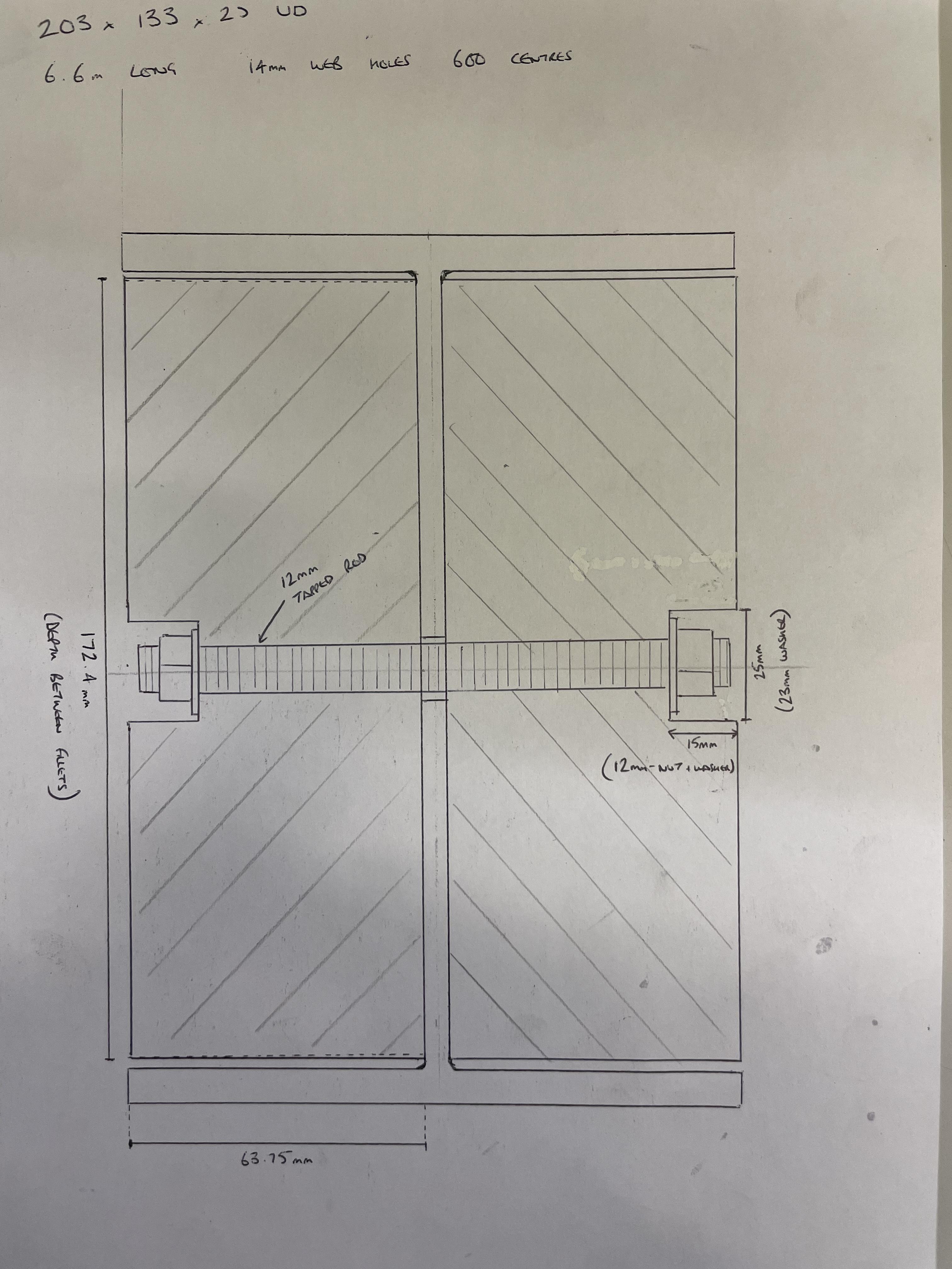

richo106 Posted December 28, 2022 Posted December 28, 2022 Hi All My internal steels are going in next week and then it’s down to me to do the joists (posi) they are all on site ready to go. I have a beam that will have joists fitted to it both sides (see attached pic - beam highlighted red) I was planning to clamp 2 pieces of timber in the web using 12mm tapped rod so the joist hangers can be screwed to these. The UB has 14mm web holes at 600 centres. I was going to sink the washer/nut so it doesn’t affect the joist hangers etc. Please see attached drawing I have done to show my plan, does this look ok or is there a better method of doing this? Does the timber need to be perfect fit or would you leave a slight margin for error? Or would it be better to be perfect fit especially the depth? The joist hangers are MHE 380-75-152 Daft question…will any wood screws be ok to fit the hangers? Certain size required? Any advice/information greatly appreciated Many Thanks

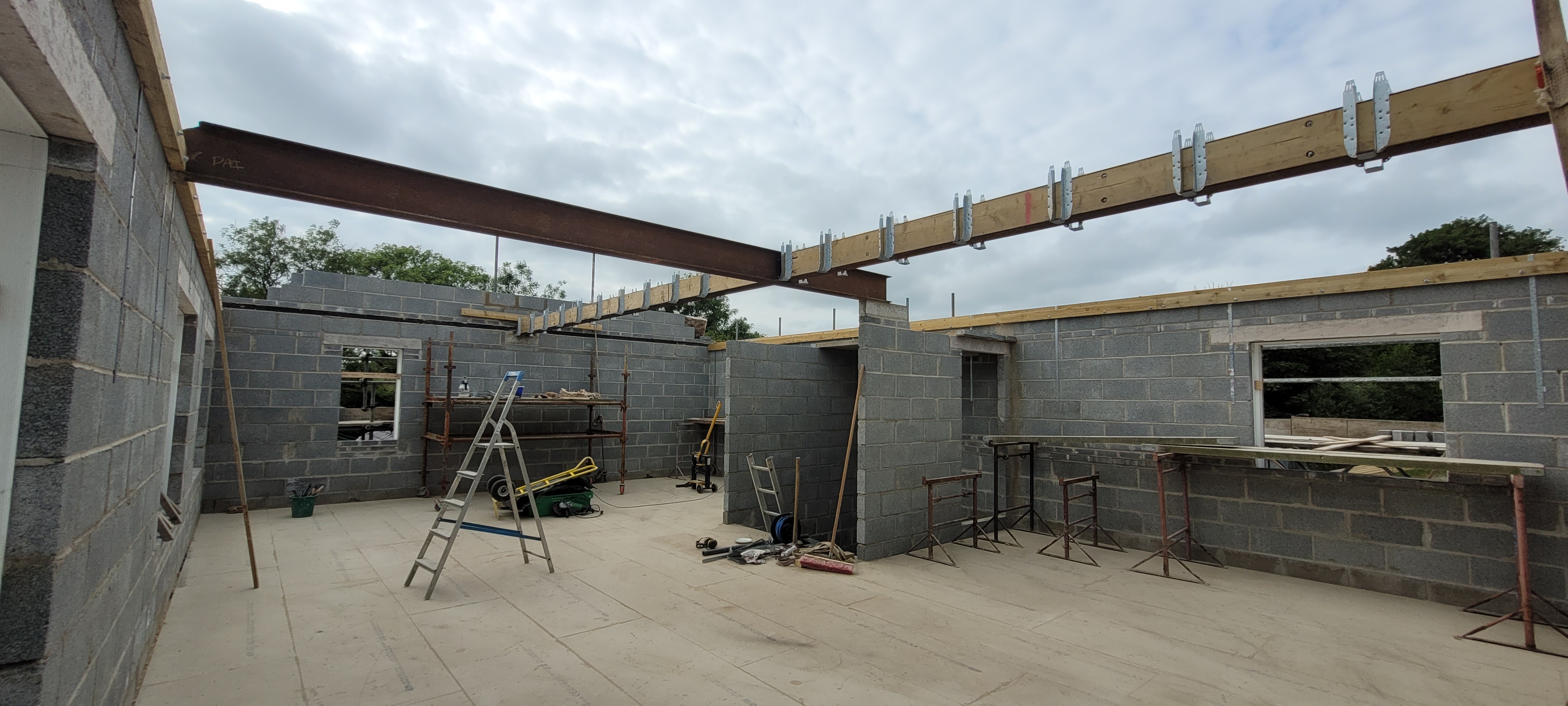

nod Posted December 28, 2022 Posted December 28, 2022 The easiest way is to bolt a timber in the beam prior to lifting the steels in Then simply nail the hangers in It took me about two hours to do eight steels Very easy on the ground More tricky when in situ

richo106 Posted December 28, 2022 Author Posted December 28, 2022 Thank you @nod I was hoping to do them on the ground but the steel guy is bringing them to site and dropping them straight in unfortunately Does your timber fit perfectly flush to the front of the RSJ? Will a mm either way hurt?
nod Posted December 28, 2022 Posted December 28, 2022 4 minutes ago, richo106 said: Thank you @nod I was hoping to do them on the ground but the steel guy is bringing them to site and dropping them straight in unfortunately Does your timber fit perfectly flush to the front of the RSJ? Will a mm either way hurt? The two pictured did with the corners planned The deeper ones needed a rip of 10 mil ply I cut all mine ready and put a couple of bolts in each and lifted in place with the steel guy Then spent a couple of hours drilling the Timbers and bolting The steel guy will expect this

ToughButterCup Posted December 28, 2022 Posted December 28, 2022 When I had questions about our POSIs, I rang up the manufacturer, and talked it through with their designer. To double check (because I knew less than nothing about the matter) I rang Cullens. They put me on to one of their design team and we had the issue sorted out straight away. It shouldn't surprise you to say that their advice was to exactly what @nod suggests. We chose German wood-to-steel screws. Worked like a charm. On the few screws that appeared not to 'cut' into the steel , we simply spat on the screw tip ; spit , it appears is a cutting agent (who knew that eh?) 1

Miek Posted December 28, 2022 Posted December 28, 2022 Fix the wood at ground level if you can, so much easier. Usually timber hangers are fixed with sheradised twist nails, not screws. If the wood is a bit proud of the steel it won't matter IMO.
richo106 Posted December 28, 2022 Author Posted December 28, 2022 1 minute ago, Miek said: Fix the wood at ground level if you can, so much easier. Usually timber hangers are fixed with sheradised twist nails, not screws. If the wood is a bit proud of the steel it won't matter IMO. Looks good! Thanks for the comment regarding the twist nails rather than screws (I did not know this) This was my thinking regarding the wood, would rather be a little proud (mm or 2)

Miek Posted December 28, 2022 Posted December 28, 2022 42 minutes ago, richo106 said: Thanks for the comment regarding the twist nails rather than screws (I did not know this Nails are stronger in shear than screws. If in doubt fill all the nail holes in the hangers is my advice.
