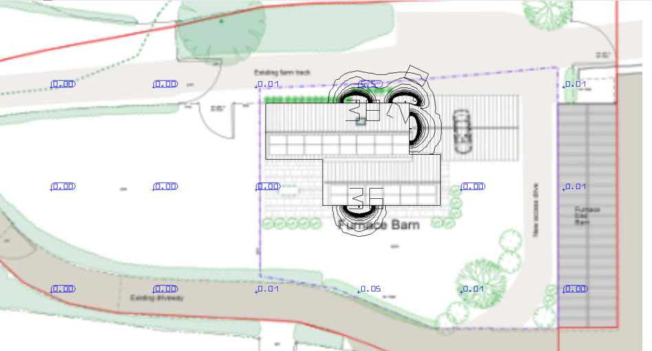

Furnace Posted June 10, 2023 Share Posted June 10, 2023 My recently granted permission has this more onerous condition imposed: The requirement for a contour plan is a bit of a drag, but I cobbled together something using an excellent free piece of software called Dialux (www.dialux.com). I only generated the contours for the 4 external lights proposed and mitigated the light spill from internal lights by stating I will have curtains and blinds on all windows. I'll post back when I know if the LPA accept my DIY approach. Link to comment Share on other sites More sharing options...
