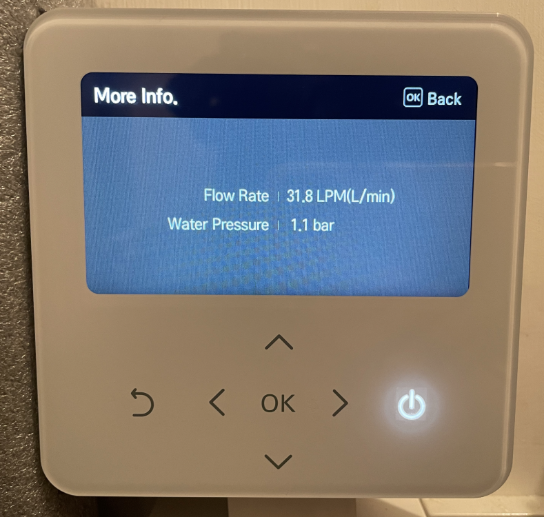

I had this problem right from the start.  The two issues were nowhere in the manual did it state what the minimum water flow rate was, and there was no means to measure it.  A phone call to LG told me it was about 10 litres per minute approximately that it needs to see, but there was a bit of tolerance in the actual value the flow switch registers as okay.
I then installed a flow meter so I could actually see the flow rate I was achieving and it was only just enough.  So I installed a second circulating pump in the house in addition to the one inside the ASHP which improved the flow rate and solved the issues.

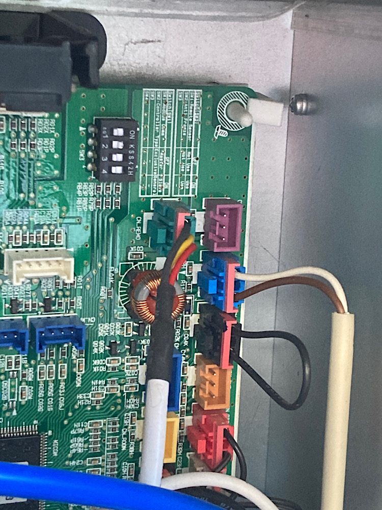

Think the flow switch is in a failed condition, so read a huge flow rate.  This allows the heat pump to run for a while until the controller logic says, that cannot be correct, let's shutdown.
First check the wires for the flow meter meter, disconnect then reconnect the wires first.  If that fails the switch may be goosed.
However if under warranty call the installer, that's what the warranty is for.

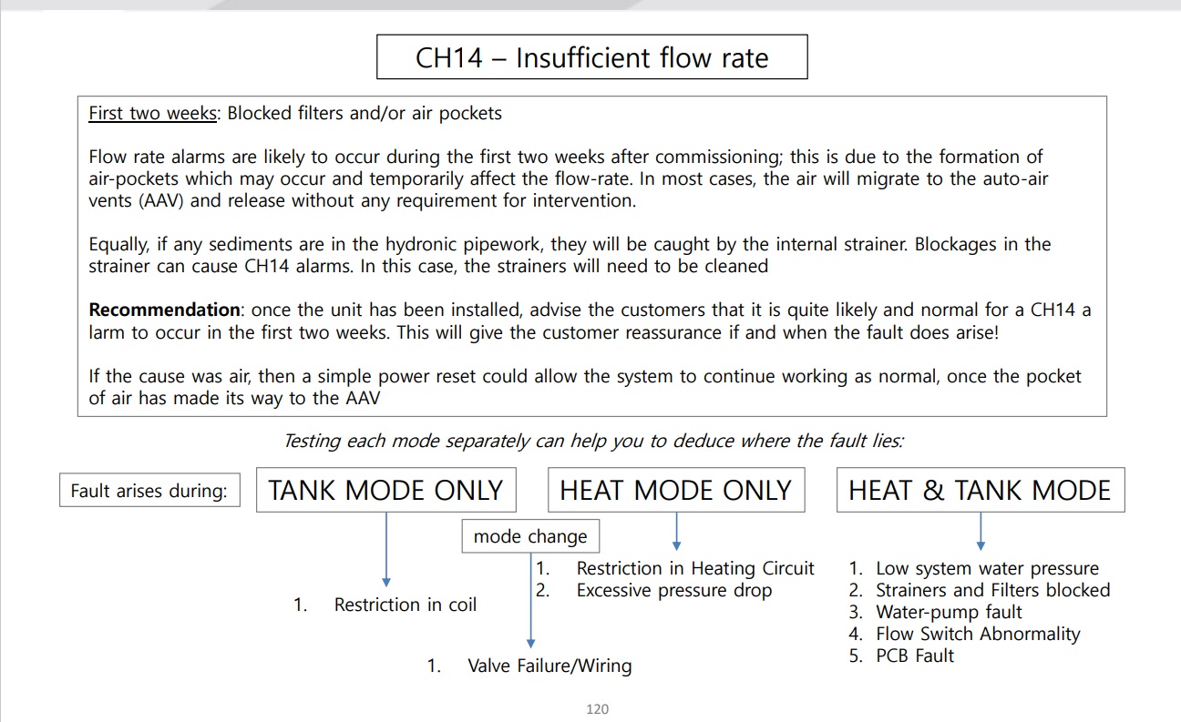

If it's one or other then it should be able to heat the hot water without error or run the heating system with out error.  If it's both then it's one of the 5 possible causes listed under "Heat and Tank Mode" (unless it's a valve problem that occurs when switching between DHW-"Tank Mode" and Central Heating-"Heat Mode").
The water pressure is good so that eliminates one of the five possibilities.  That leaves:
Strainers and filters blocked
Water pump fault
Flow switch abnormality
PCB fault
Don't worry about the WIlo pump for your radiators; that could be completely dead and the Therma V would not know.  So it's not the problem; nor is anything on the central heating side of the buffer tank.

Ok so looking at all those comments and using @ReedRichards checklist.
1. Strainers and filters blocked.
Will check and clean filter (on next dry day ..).

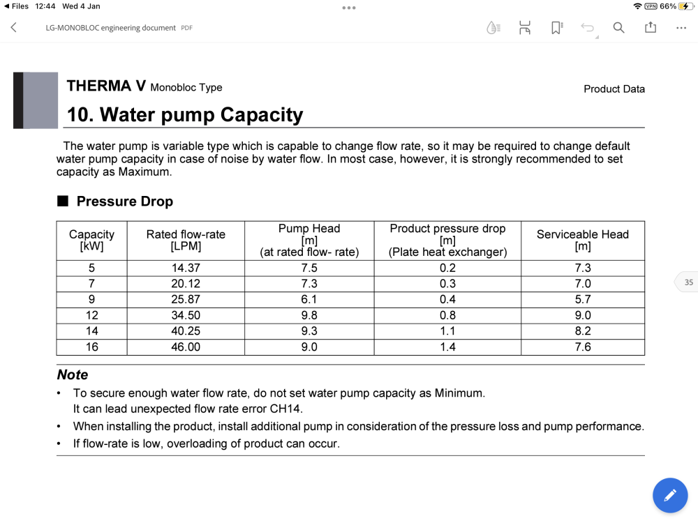

2. Water pump, possible fault.
- per @AKJOS, pump capacity should be 30 LPM (2.5 * 12j. Rated flow per attached technical document is only 34.5, so little tolerance. Recommends pump set to max (need to work out how to check this setting).
- technical document I found refers to use of additional pump, also suggested by @ProDave, or replacement with larger pump (yes, there are isolating valves, enabling filter removal and cleaning).
I have attached this  technical document. See in particular
- piping schematic (pp 15).
- reference to CH14 errors arising from pump setting (pp28), including the following info.
“The water pump is variable type which is capable to change flow rate, so it may be required to change default water pump capacity in case of noise by water flow. In most case, however, it is strongly recommended to set capacity as Maximum.
Note
• To secure enough water flow rate, do not set water pump capacity as Minimum. It can lead unexpected flow rate error CH14.
• When installing the product, install additional pump in consideration of the pressure loss and pump performance.”.

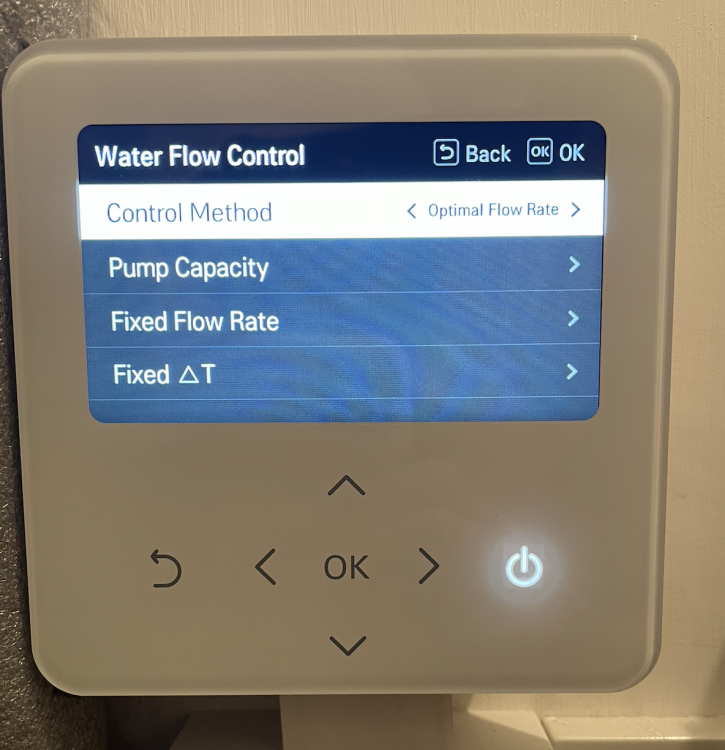

Thx.
Just checked installer settings on the LG controller - pump capacity set to 100%.
Still need to check if the the Grundfoss pump in the outdoor ASHP unit is set to max.
Tim
I would assume that LG, like all good heatpump manufacturers, use a PWM controlled primary pump so they have control over the delta-T. So there should be no need to check what speed it is running at.
Link to comment
Share on other sites
100% might be the max limit. On our CoolEnergy, there are settings for min and max, and for a higher startup setting (probably to ensure the flowmeter trips before settling back into deltaT control) as well as the actual deltaT across the ASHP.

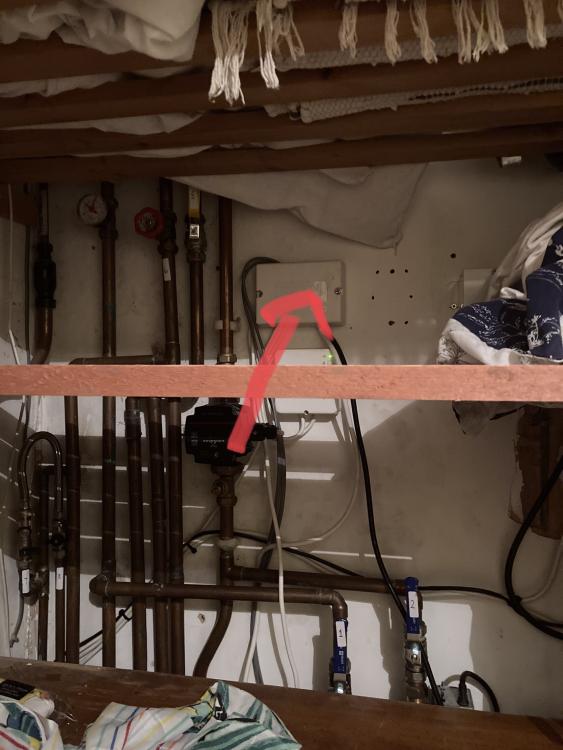

I was plagued with this on a Samsung unit after a pump change with it working for several days then randomly failing with flow rate errors. Fortunately we had a flow meter installed so could see the flow rate. I chased my tail for a bit thinking it must be the new pump as it was a different model from the failed pump. However it turned out to be a two way valve that was very slow to operate.
Link to comment
From my investigations, the LG heat pumps expect the required flow to be achieved within 10 seconds of the pump starting. If your valve takes longer than that to open you will have a problem.

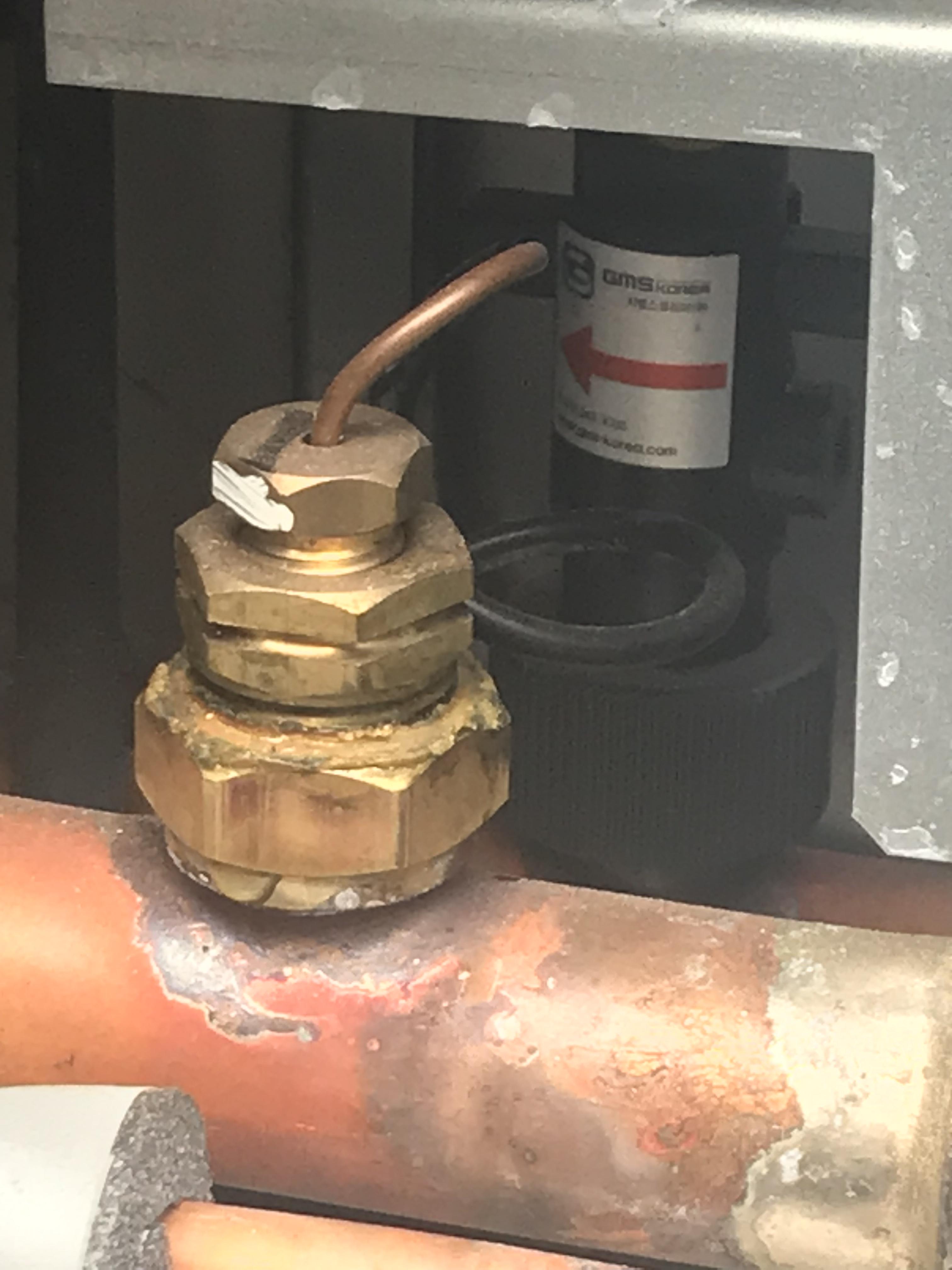

Ok so partially drained, filter removed (little or no debris), cleaned and reinserted.
Flow switch is a Sika V3. Unclear which model at this stage, but label indicates 15l/min set point.
Not yet removed to check paddle operation. Also, it may have an adjusting screw, tbc.
Powered by cable back to control board - blue connector.
Attached info.
Any more suggestions before I remove FS, check paddle, any flow adjustment option?
On electrical connection, what is there to check and how?
thx again

3 hours ago, ReedRichards said:
I presumed the valve being referred to is the one that controls whether the water flow is to the buffer tank or the DHW cylinder?  So it's two-way valve and wouldn't there be flow even if it was stuck half way?
In my case it was slow to start to change and then slow to actually change. It interrupted the flow enough to cause the error but only occasionally. I suspect it was failing for a long time but the original pump’s flow rate was higher than the replacement pump so was hiding the problem.
The two way valves seem to be a common failure point on every system as I’ve had at least one fail in every house I’ve lived in and replaced a few for neighbours. Consequently I kept one on the shelf just in case. That was how I stumbled across the fix as after exhausting everything else I replaced the valve and it cured the problem.
