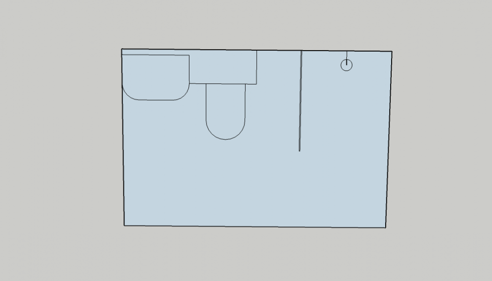

Crofter Posted July 9, 2017 Share Posted July 9, 2017 SWMBO has decreed that it is not acceptable to have the shower mixer valve situated beside/under the riser rail. This is because the shower will be a large walk in enclosure with a fixed screen, and the riser will be down the far end. So she reckons we should have the valve 4ft away on the wall opposite the entrance, so that you can turn the shower on and off from outside. I reluctantly admit she may have a point. The problem with this is that the wall there only has a 25mm void behind the plasterboard, which is nowhere near enough to conceal a shower valve. I think I will have to resort to some combination of spacing the wall out a bit, and/or locally digging back into the insulation to create a bigger space. This means breaching the vapour/airtightness membrane and cutting back into the 50mm PIR, then making it all good again afterwards. It's not a particularly appealing prospect tbh. I could go a bit Heath-Robinson and fit an exposed mixer, with a third elbow fixed onto the outlet where the hose ought to go- this would feed the outlet back into the wall where a concealed pipe run would take it to the riser. Not convinced I could make that look right, and it would be a bit harder to clean. So my questions are... - does anybody know of an exposed mixer valve that is actually designed to be sited remotely, with its outlet feeding back to a concealed run? - failing that, what is the lowest profile concealed mixer valve that I can get? Quick and dirty sketch attached... remote mixer valve would be located on the RHS wall, opposite the entrance to the shower. Link to comment Share on other sites More sharing options...

Crofter Posted July 9, 2017 Author Share Posted July 9, 2017 2 hours ago, Nickfromwales said: Just had this discussion on my current install. The idea of placing the shower valve outside of the wet tray area was a bad idea imo, so they agreed to move it. How big is the tray ? Does the fall stop at the glass end? Not clear from my sketch, but the idea is for the tray to extend the full width of the room. And it probably looks like it's going to be a wet room, but it's not. Nothing set in stone yet... and I'm bracing myself for the delivery costs on a 1600x800 tray... Link to comment Share on other sites More sharing options...

Crofter Posted July 10, 2017 Author Share Posted July 10, 2017 Thanks, but I don't think I can go for a wet room- it's on a suspended timber floor. My sketch was probably a bit misleading. Link to comment Share on other sites More sharing options...

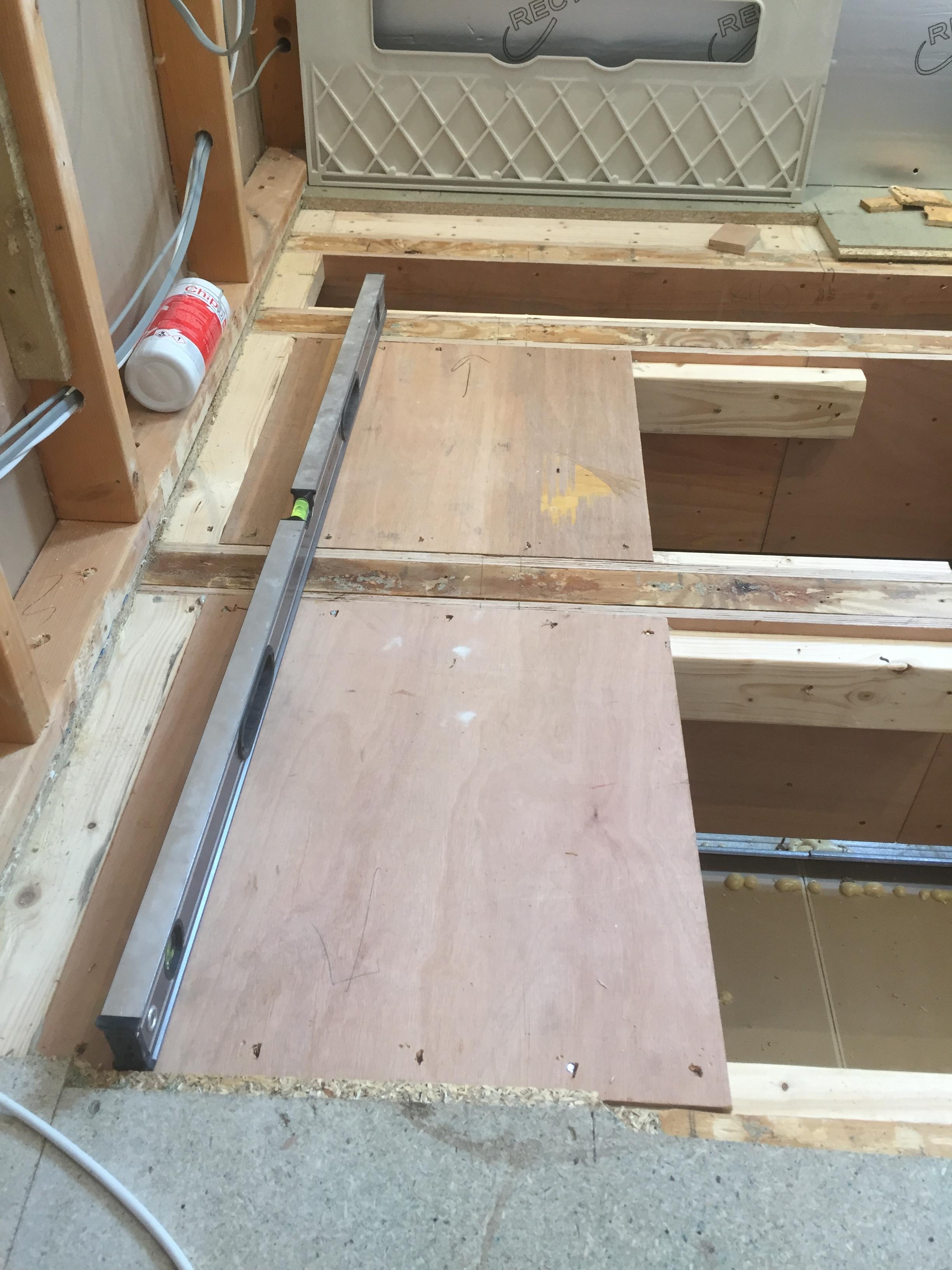

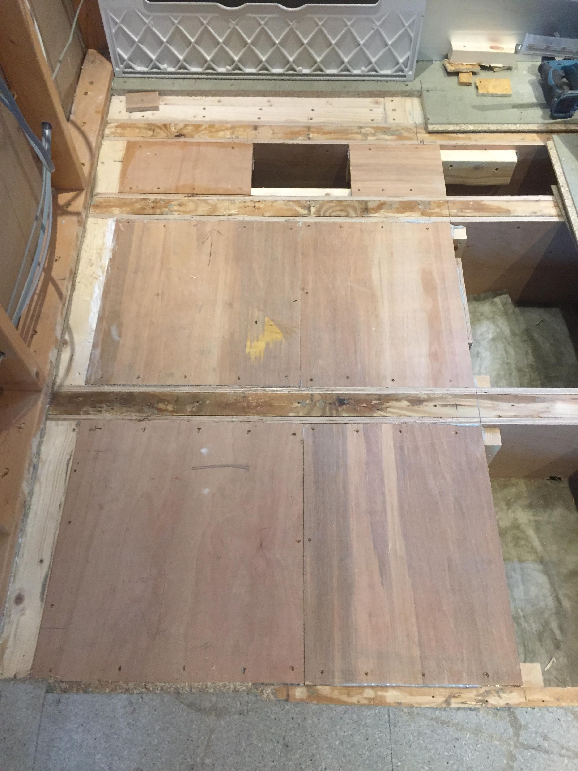

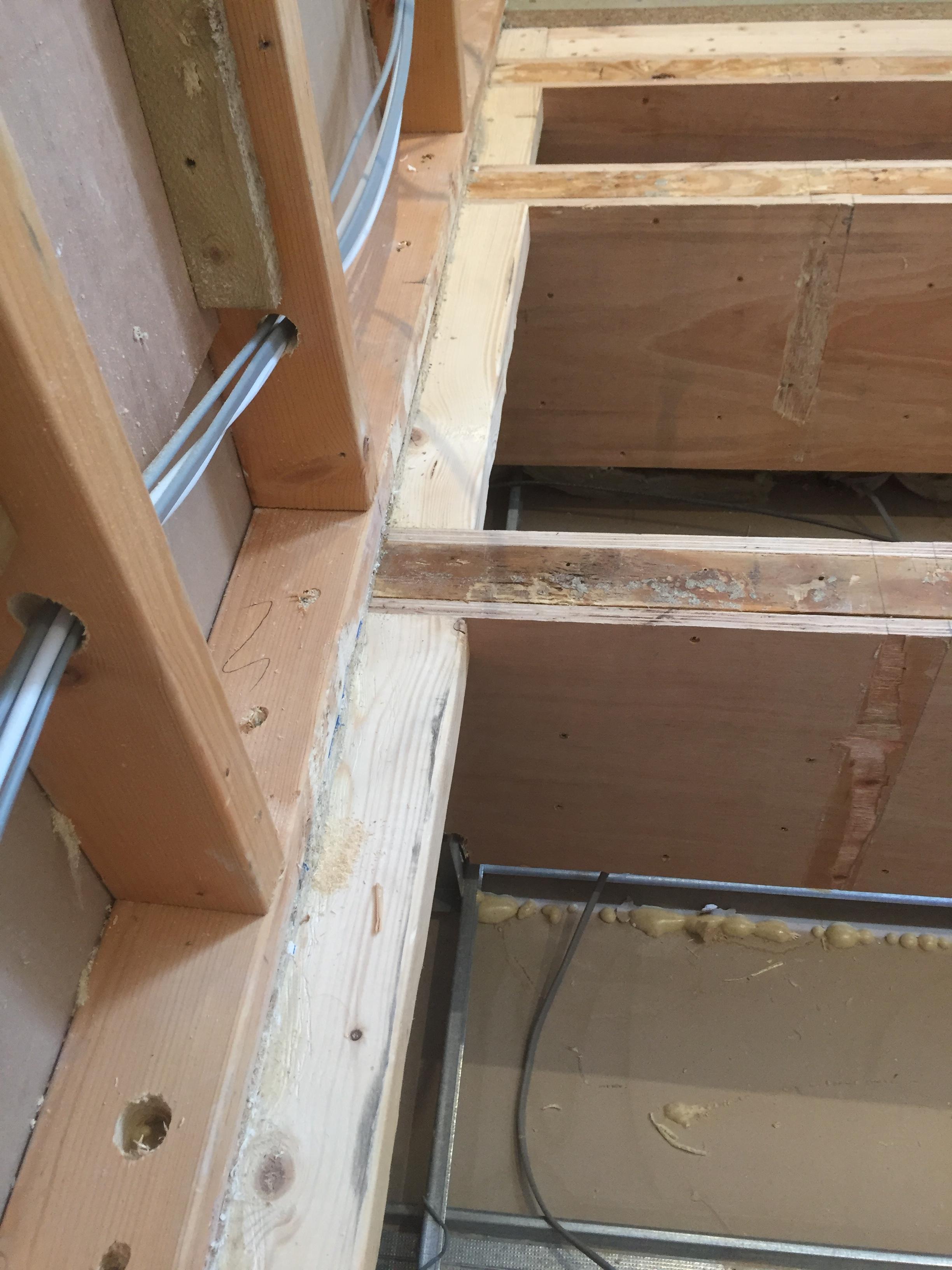

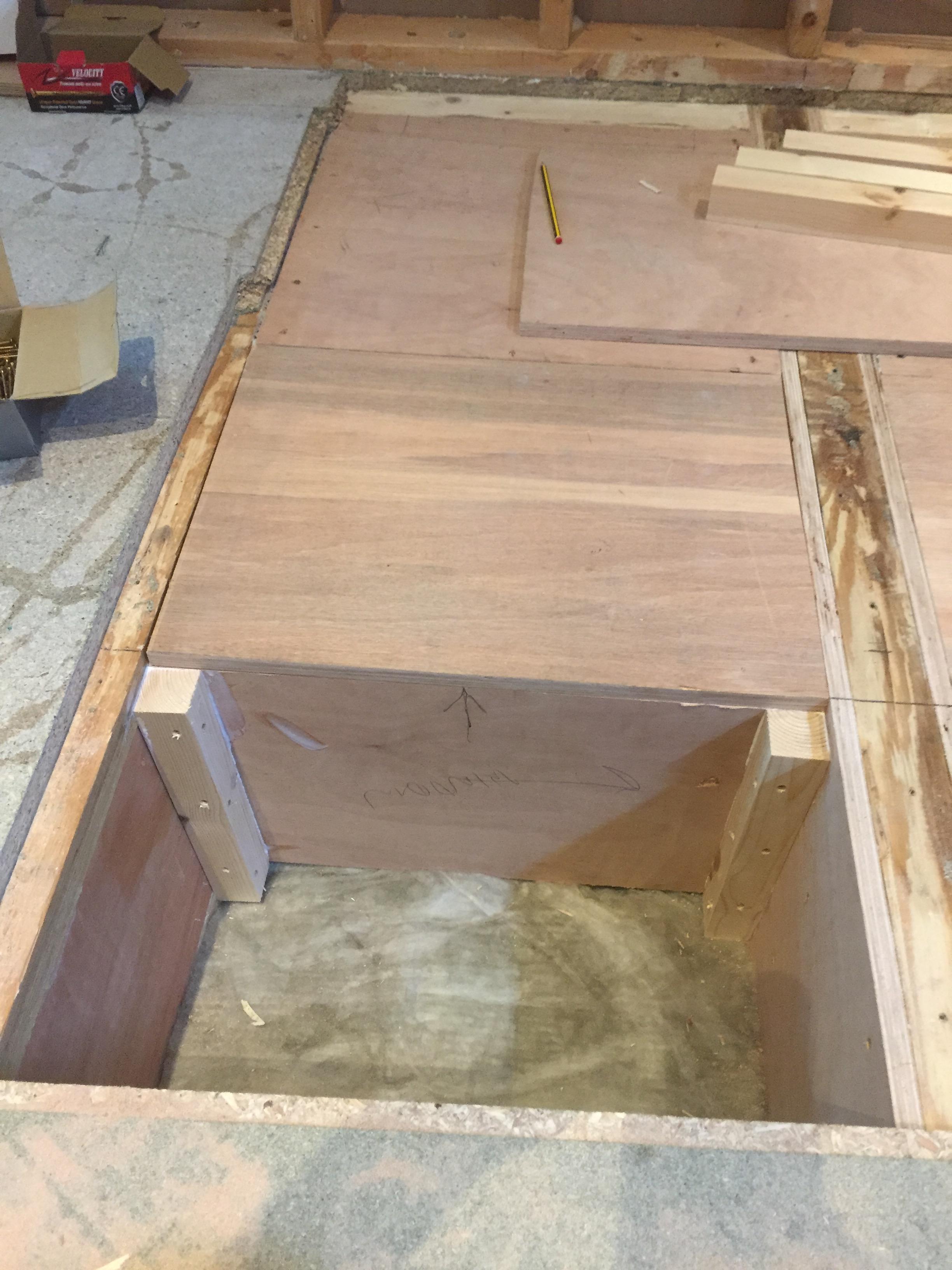

Crofter Posted July 10, 2017 Author Share Posted July 10, 2017 Go on, enlighten me... genuinely puzzled about how I would go about having a wet room. Would I have to raise the whole floor? Because I can't lower it to create a drain point without cutting into the tops of my JJI joists... Link to comment Share on other sites More sharing options...

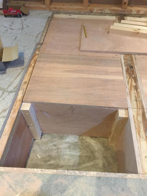

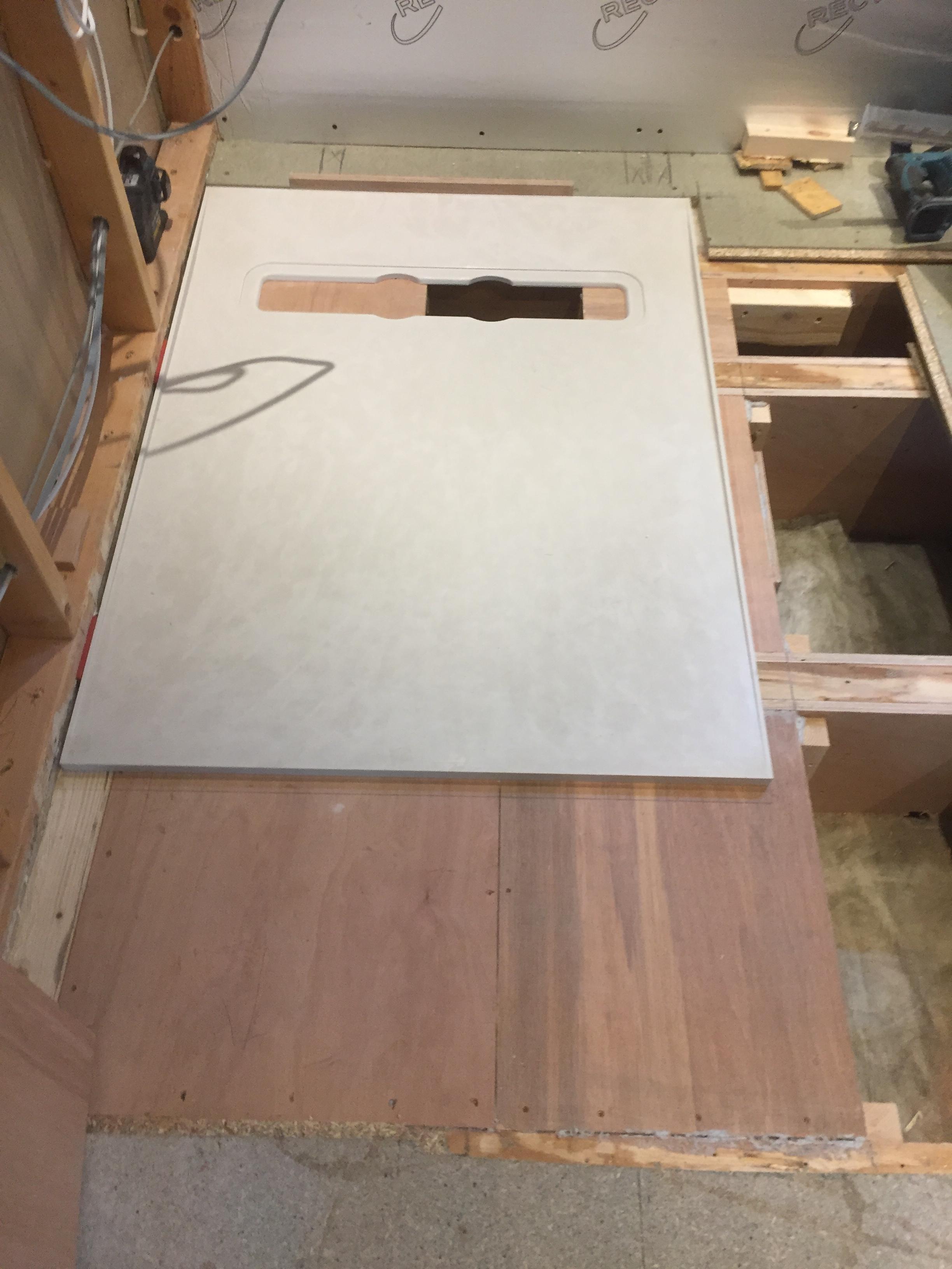

ProDave Posted July 10, 2017 Share Posted July 10, 2017 Plan your drain runs in the main to run parallel with and between the joists. You can cut through the web of a JJI but you probably need to add a plywood gusset plate glued and screwed each side. Shower former sits straight on joists, you will need to add some strengthenig webs flush with the top pf the joists to properly support the former. Floor boards on top of joists up to former. This is exactly what I am doing except I have posi joists I can't see the drain issue being any different between a wet room former and a standard shower tray, unless you were planning to put the tray up on legs? 1 Link to comment Share on other sites More sharing options...
Nickfromwales Posted July 10, 2017 Share Posted July 10, 2017 2 hours ago, Crofter said: Go on, enlighten me... genuinely puzzled about how I would go about having a wet room. Would I have to raise the whole floor? Because I can't lower it to create a drain point without cutting into the tops of my JJI joists... These were JJI's which I had to beef up. The webs got fully loaded with 22mm plywood, glued and screwed, then 18mm webs added top to toe, glued and screwed again. Bath going in here was 90kg empty so the flimsy joists weren't enough on their own imo so Capt OCD went to town. (x) mm ply goes under the former, equivelant size goes on top of P5 later. Then (x) mm ply goes all over the P5 to bring it back to one flush floor Or as @ProDave reminded me, do away with the ply, glue and screw the ? out of the P5 and use the Impey membrane which both bonds and decouples. 1 Link to comment Share on other sites More sharing options...

Nickfromwales Posted July 10, 2017 Share Posted July 10, 2017 (edited) I thought you'd say that TBH. It is a load of extra work. Tbh, a low level tray will look super-smart going the full width of the room, and swmbo canbhave the tap anywhere over the tray so winner winner. Set the tray on the deck, [ and for the rest of the room ] lay 12mm ply and then tiles and adhesive so very little of the tray is left proud. ? Edited July 10, 2017 by Nickfromwales Link to comment Share on other sites More sharing options...
