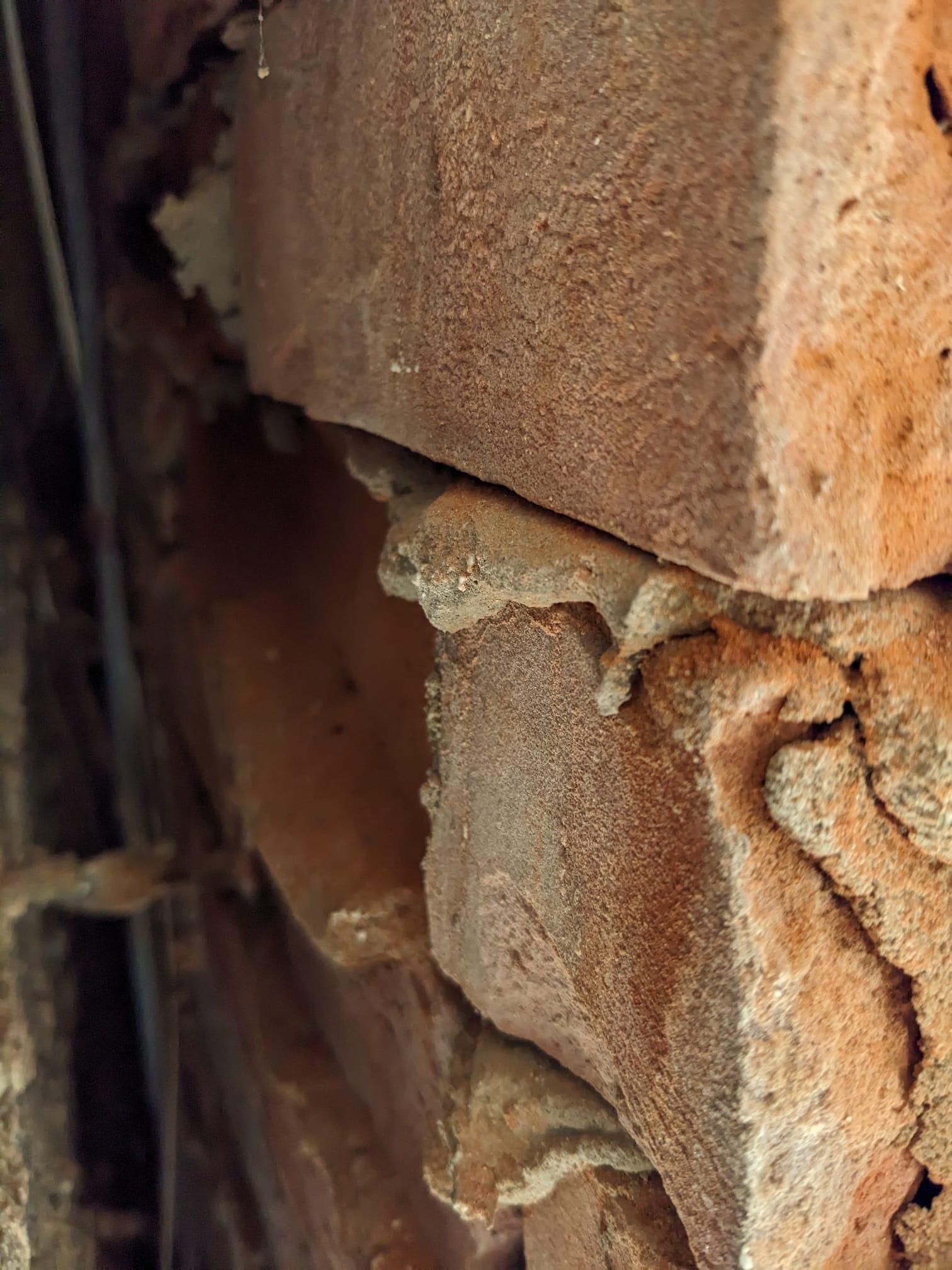

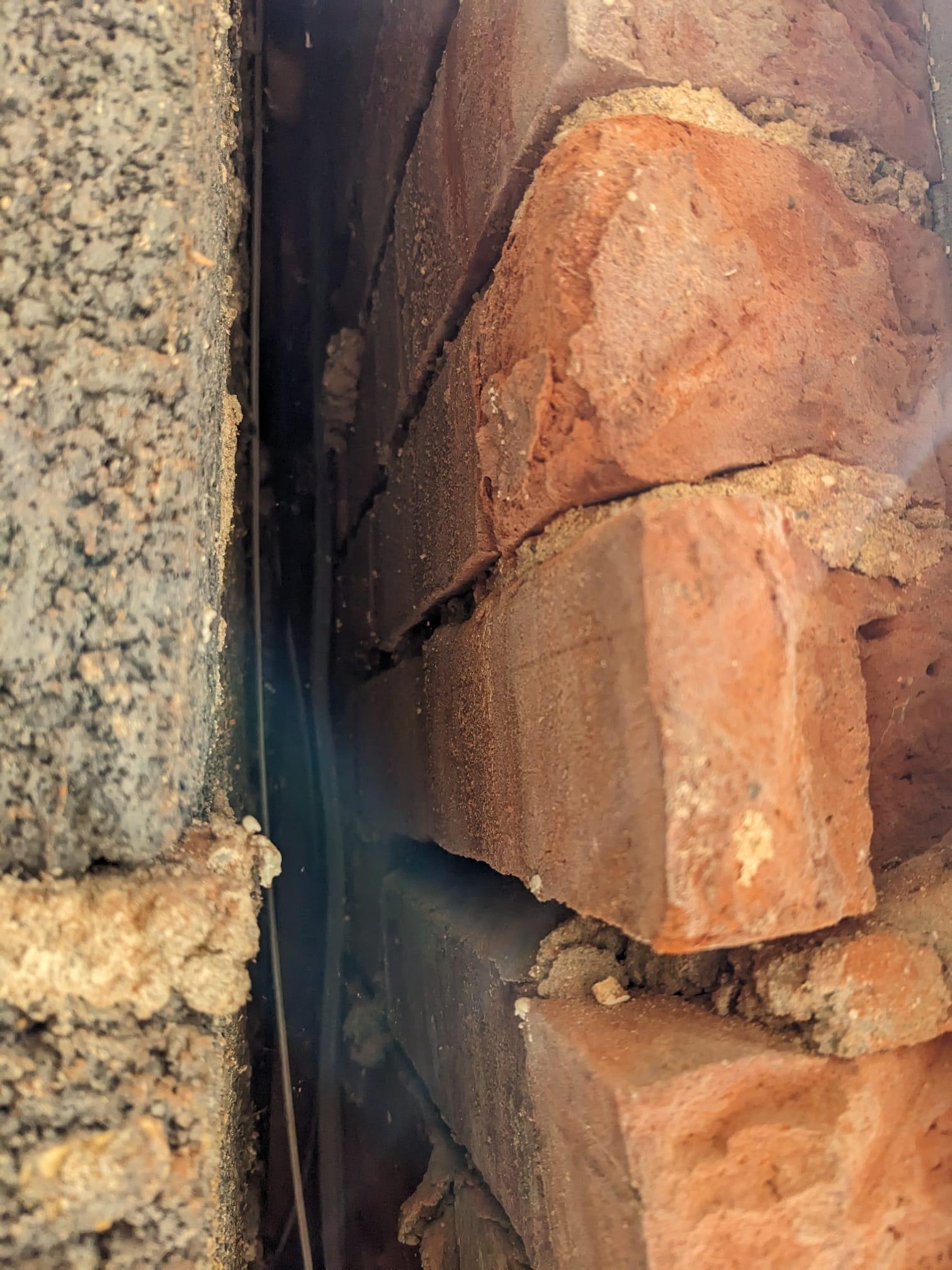

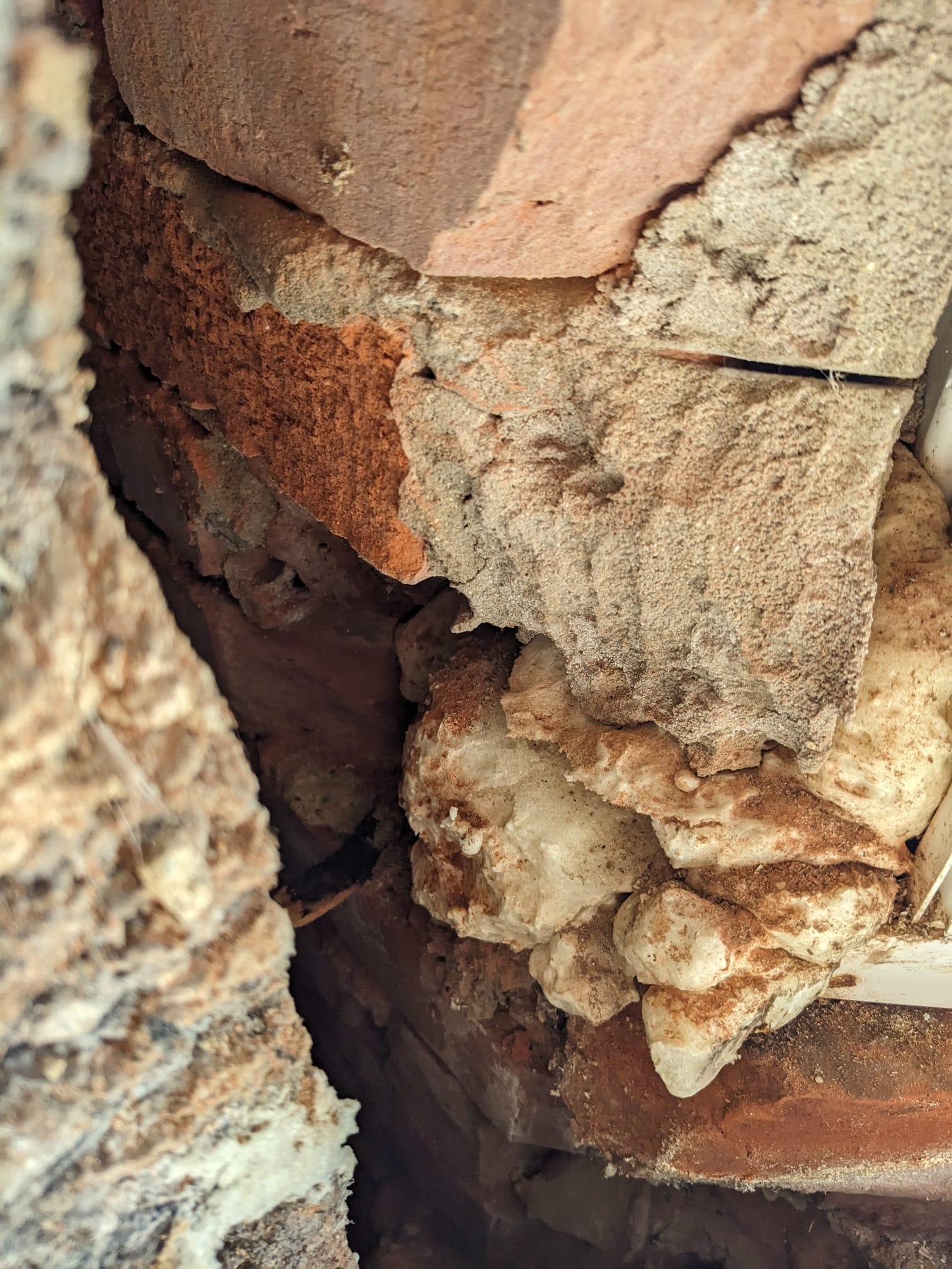

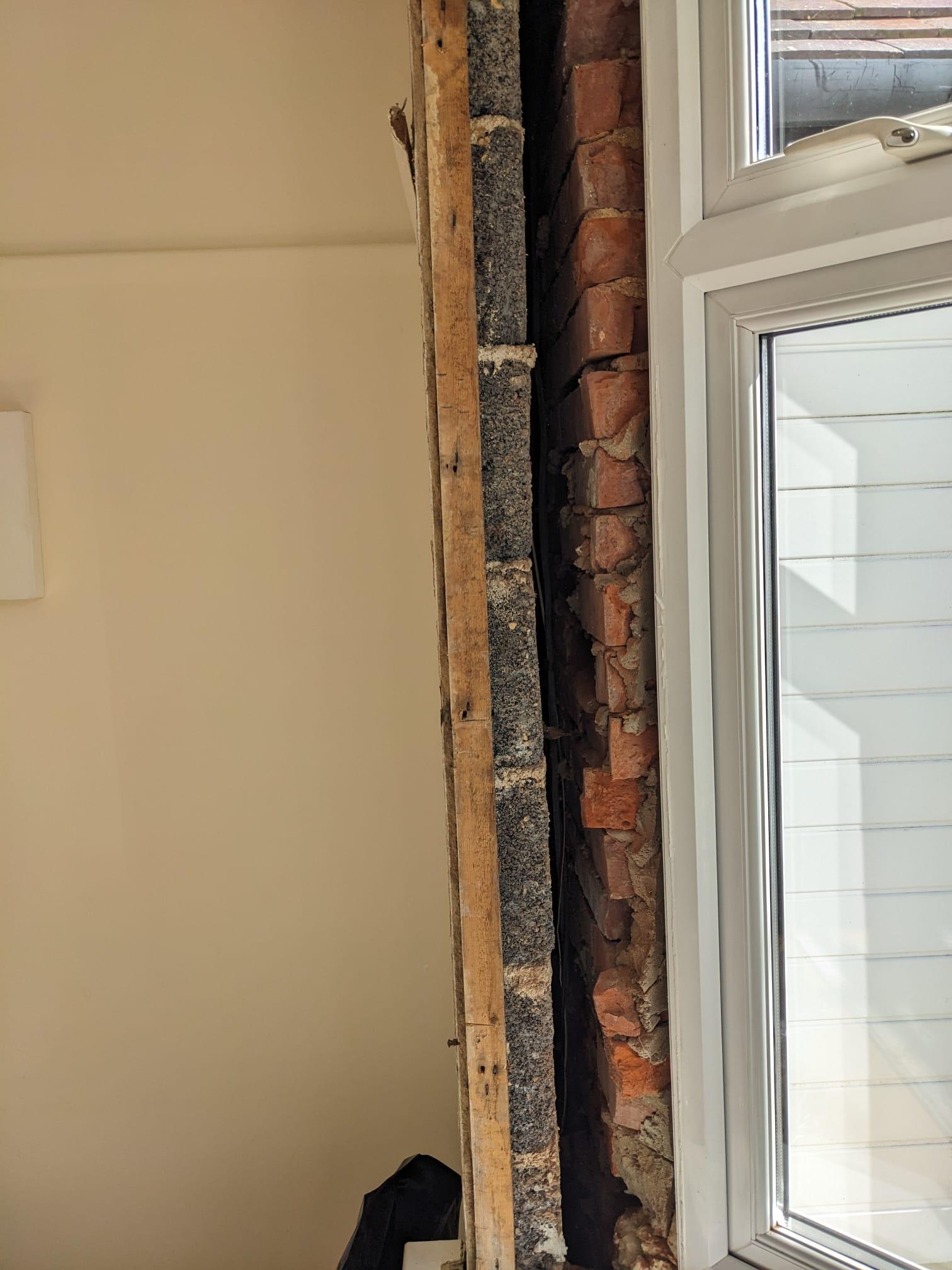

I took off a wooden cavity closer by the bay this morning. Turns out it's not just the bricks in the bay that are soft it's the whole wall. Think the render is holding the wall up!

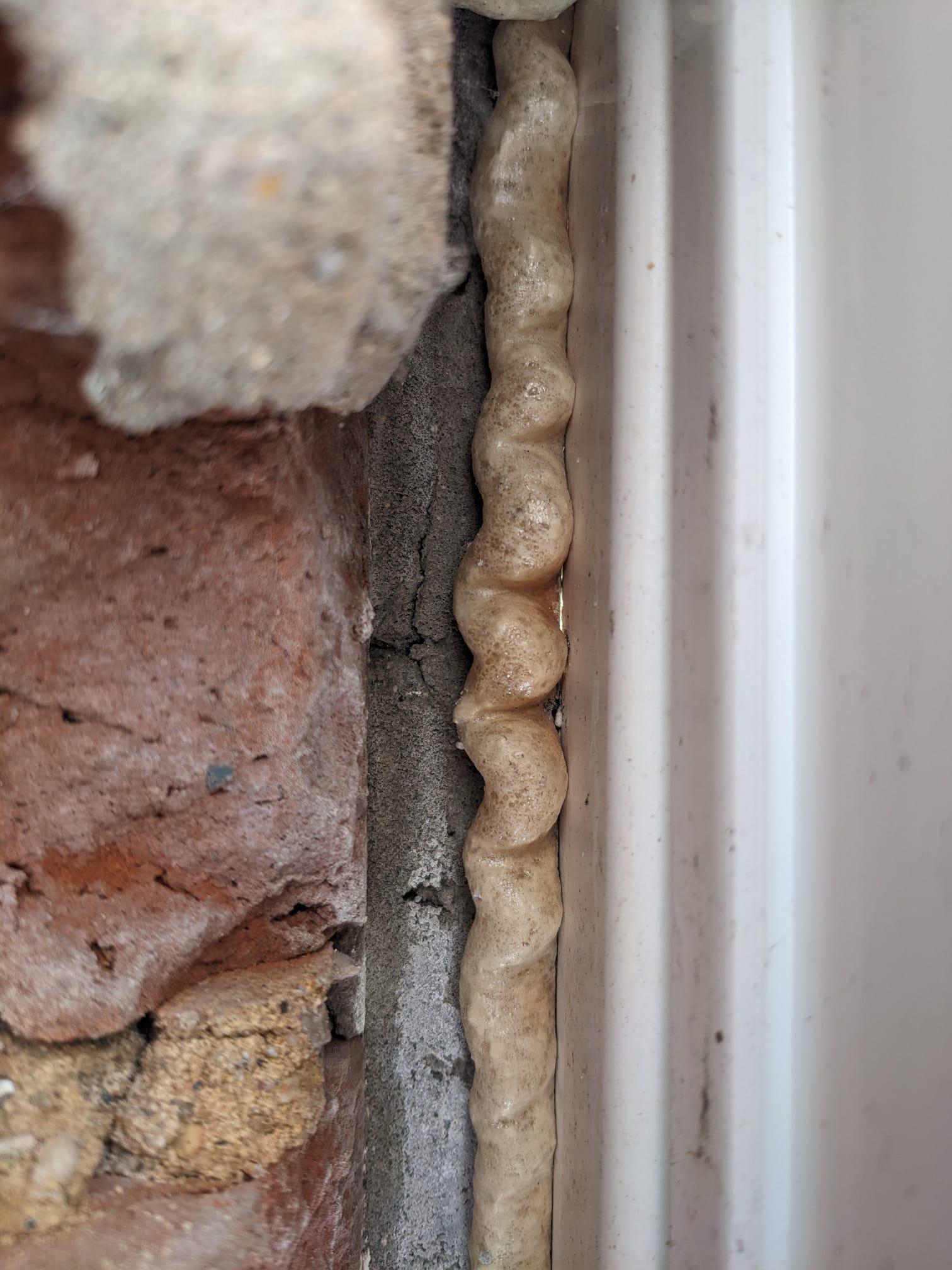

A generous gap was left between the UPVC frame and brickwork, plugged with mortar(?). Look out for the daylight below!
Lucky to have foam here, it's missing for most of the rest. The mortar-filled gap is over 2cm wide at this point.

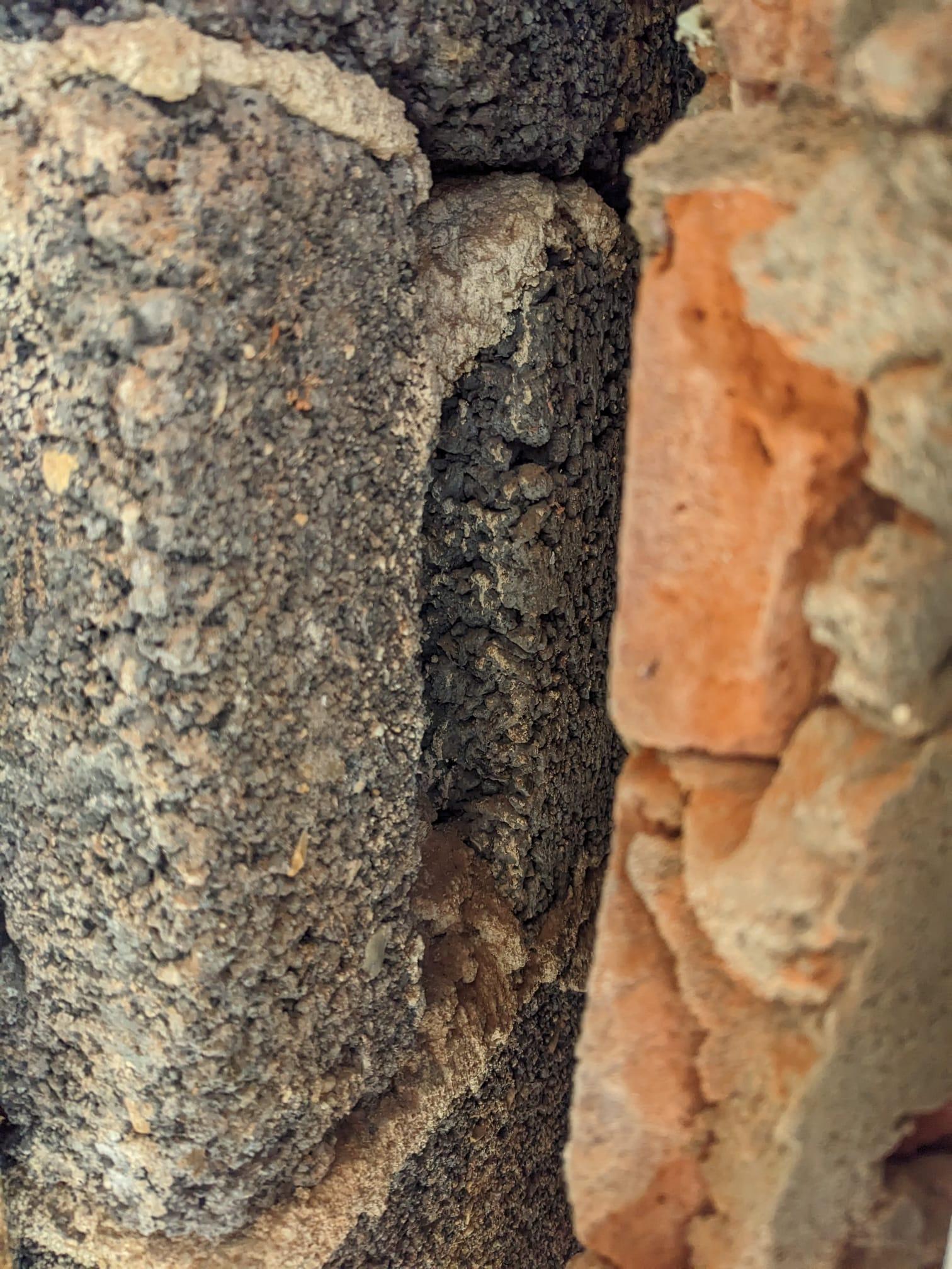

The out of focus bit is where the face of a brick has disappeared.
To get a nice straight edge to the window opening they didn't cut cinder blocks to fit. Oh no, they took small ones, lined up the edge and left a couple of inch gap to the next block... covering it with plaster in the room.
Despite the strong breeze blowing through and out of the cavity, it smells a bit - damp I think.
I've temporarily stuffed HelloFresh insulation in the cavity. My plan had been to shove 100mm PIR in as a cavity closer but the brickwork is too uneven for a 100mm sheet to fit. Will rockwool do the job as well?
And between the window and brickwork where there's the mortar and a little old foam: best to fill this entirely with foam, or does it need something more solid like chunks of PIR too?

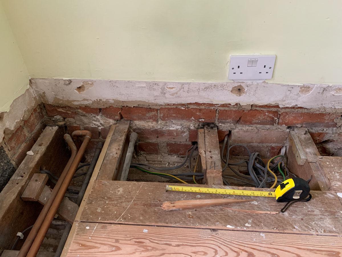

Posted
  On 23/09/2023 at 14:02, TonyT said:
Cables. Run in the cavity too, man that’s rough
Expand
I know. Thought it was only one room we needed to get rewired for cavity wall insulation but no...
How does a "normal" house get its cables from the fuse board downstairs to upstairs? A wide chase above the fuse board, through the ceiling, then fan out under the floor?

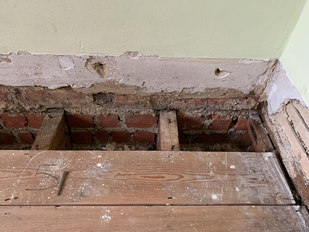

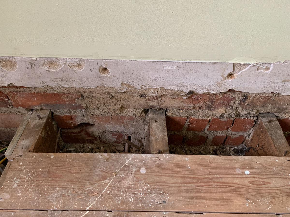

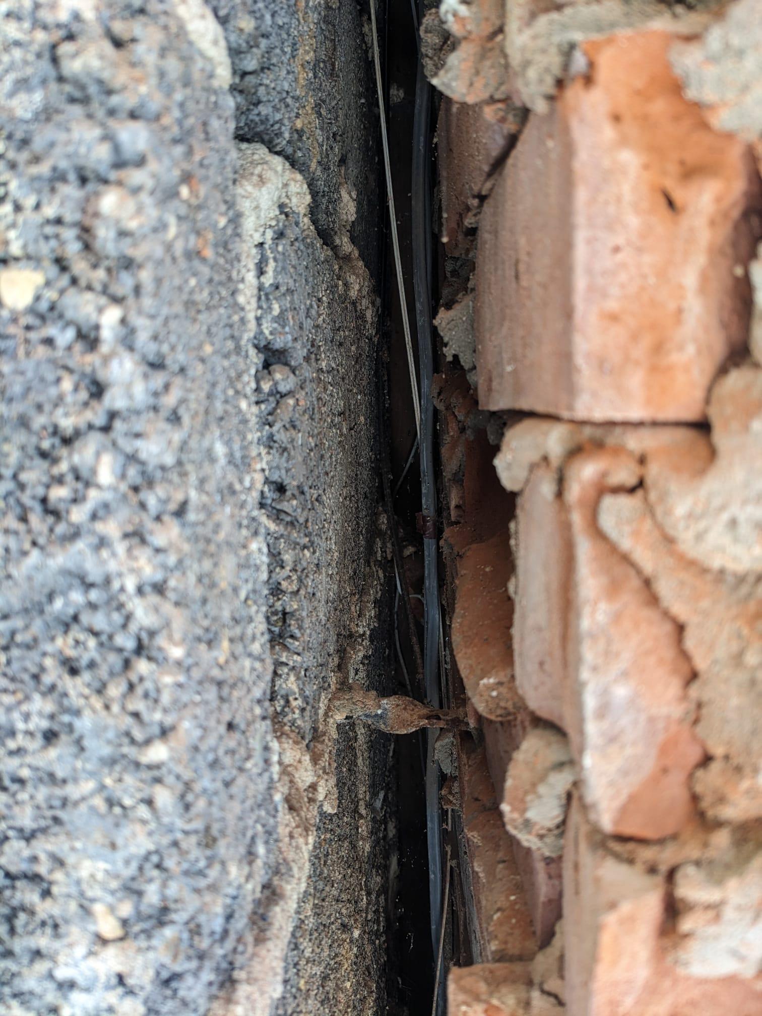

Penetrations. I've set a new record this week.
Not counting joist ends (I can poke a twig into the cavity round most of them) there's 7 penetrations into the cavity in 1.2m. And 5 penetrations through the ceiling to the room below, which houses the boiler and fusebox.
Rewring TBD later. Plan is to fill the gaps or coat the entire damn section of brickwork with something - mortar? plaster? - and then use Blowerproof to seal round the joists. I'm not taping this lot.

I have a solid wall construction and I'm packing the gaps and brickwork in the void with lime mortar.
