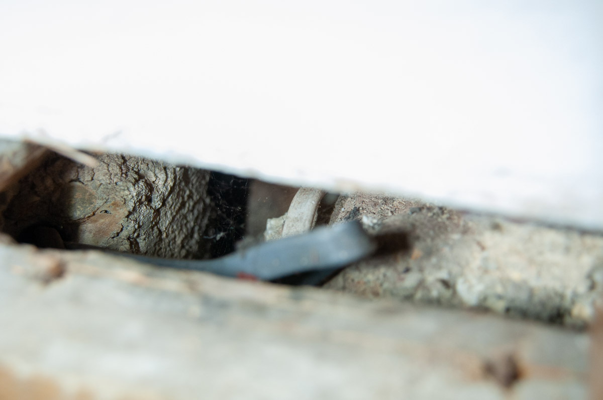

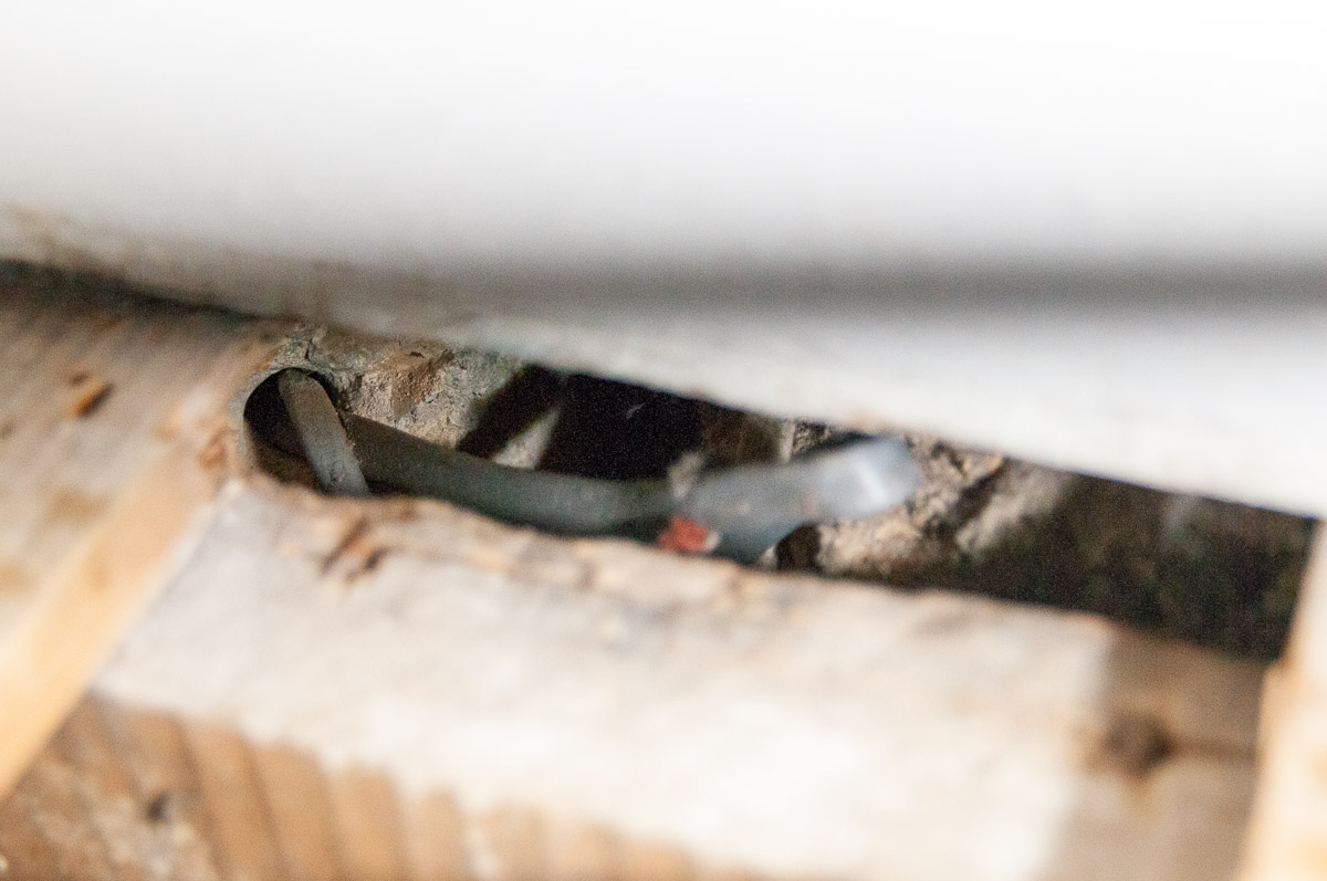

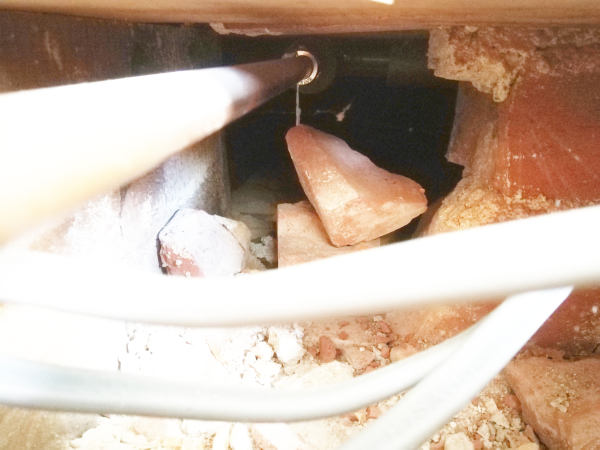

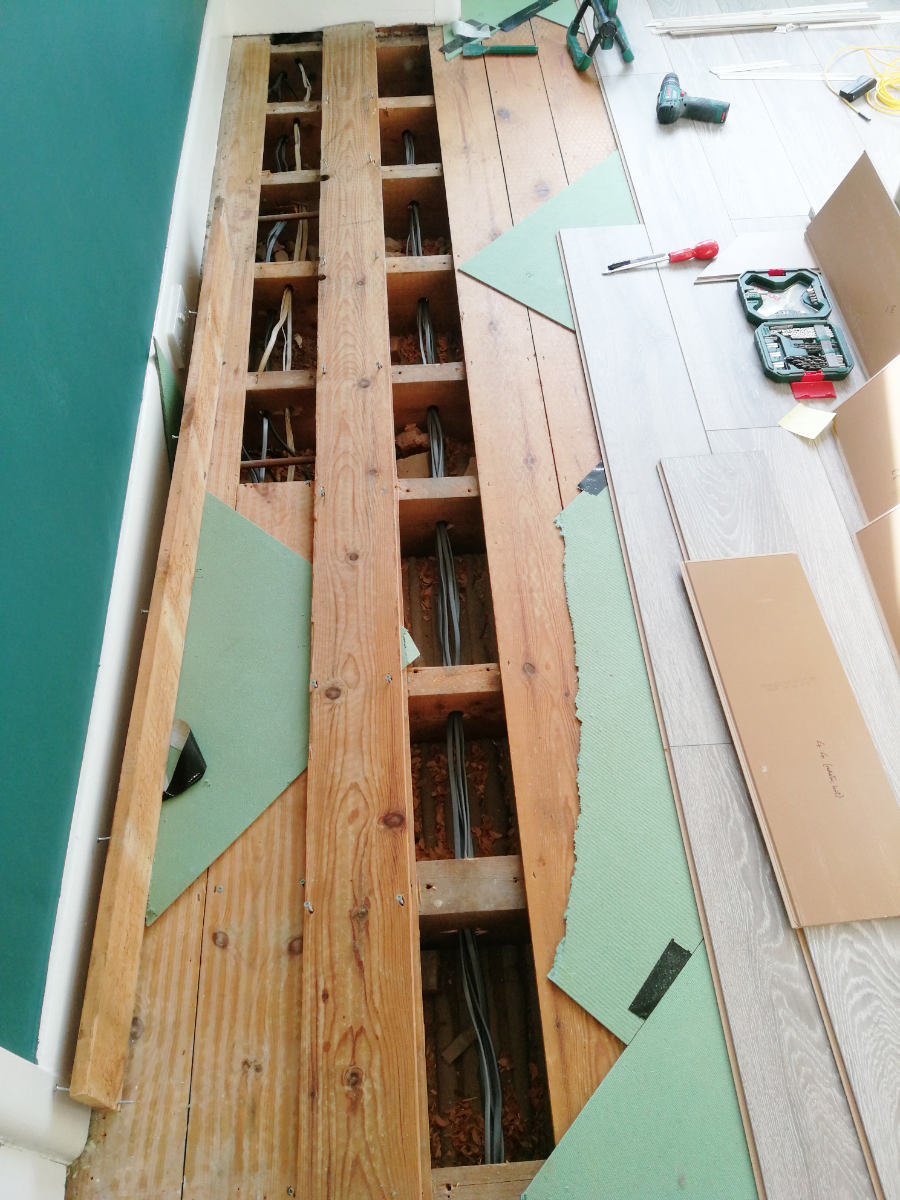

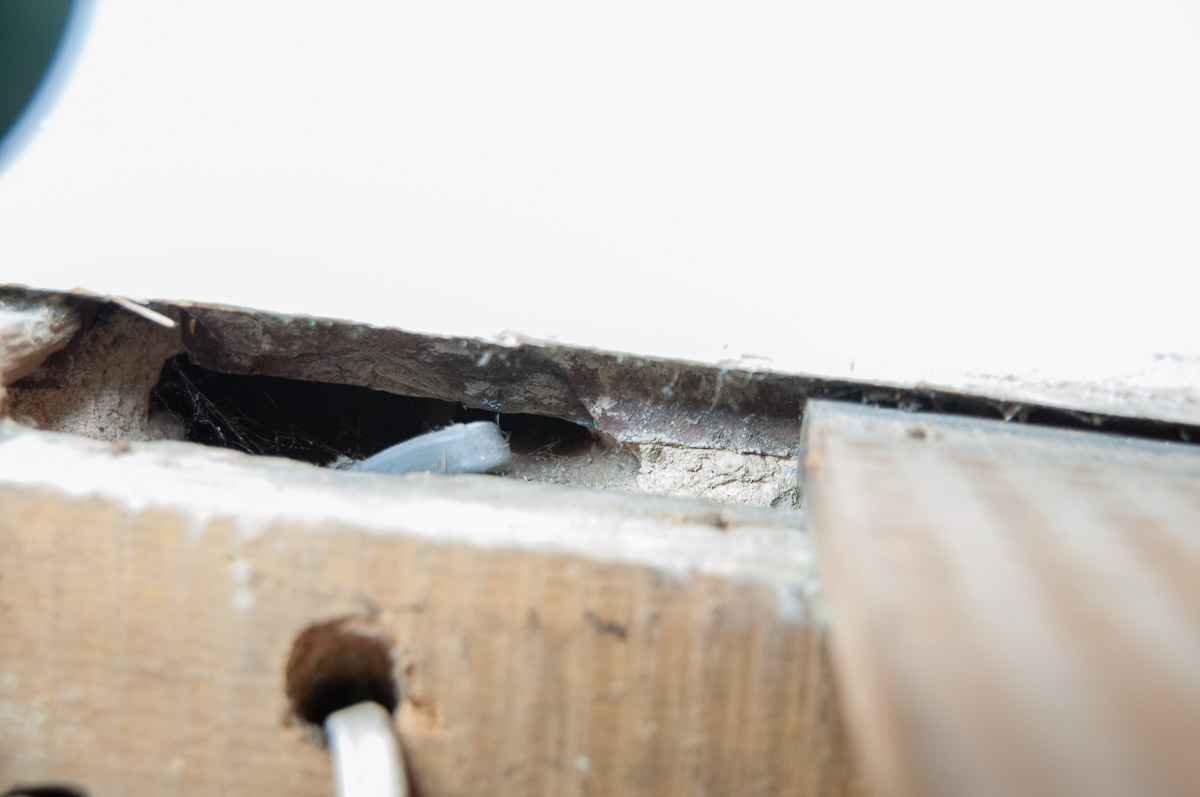

Sparrowhawk Posted December 29, 2022 Author Posted December 29, 2022 Happy Christmas everyone! We've had strong winds since Christmas and the front bedroom wasn't in use, so I took the opportunity to lift the laminate flooring and see where the draughts are coming from. There are big draughts under the skirting board to the side of the bay window (as well as in the bay window itself) and that was the easiest place to start. The laminate was easy to lift, laid in 2016 and didn't go under the skirting board. 2 floorboards were screwed instead of nailed so out they came. Looks like these planks were taken up for rewiring. White cable is the old stuff, grey the new. Bit more brick under the floor than I expected. Nice to see that when running heating pipes through the solid internal wall they knocked a chunk out of the wall rather than drill holes I digress. Looking at the external wall to the left of the window it's easy to see why it's so draughty here. At some point a hole approx 3x4" has been punched through the inner leaf and into the cavity. Sorry about the photos, there is only a plank's thickness between the last joist and the skirting board so a tight hole to take a picture through. Hilariously (got find something to smile about here) for the gray cable rewiring they drilled a tunnel 2 to the left of this hole to put the cables through. Didn't block the big hole up, oh no: To practicalities. What's the best way to make this airtight? I was thinking PIR board roughly cut around the cables and foamed into place, but without removing the original skirting boards it's going to be difficult to get it into there. Something thinner and more flexible to seal the hole, and then mineral wool or similar rammed in around the cables to stop any airflow?
Sparrowhawk Posted January 2, 2023 Author Posted January 2, 2023 I filled that hole with Soudal expanding foam and stuffed insulation between wall and joist as a temporary fix (floor had to be relaid by this morning). Now making plans to cut and lift all floorboards by the wall, and remove skirting board to seal all draughts along the length of the wall. Foam gun wouldn't close and kept letting foam out so I took it outside to clean. Unscrewed almost-new can from gun, and it didn't reseal. Cue jet of foam spraying everywhere. The garden looks like a blue snowstorm hit.

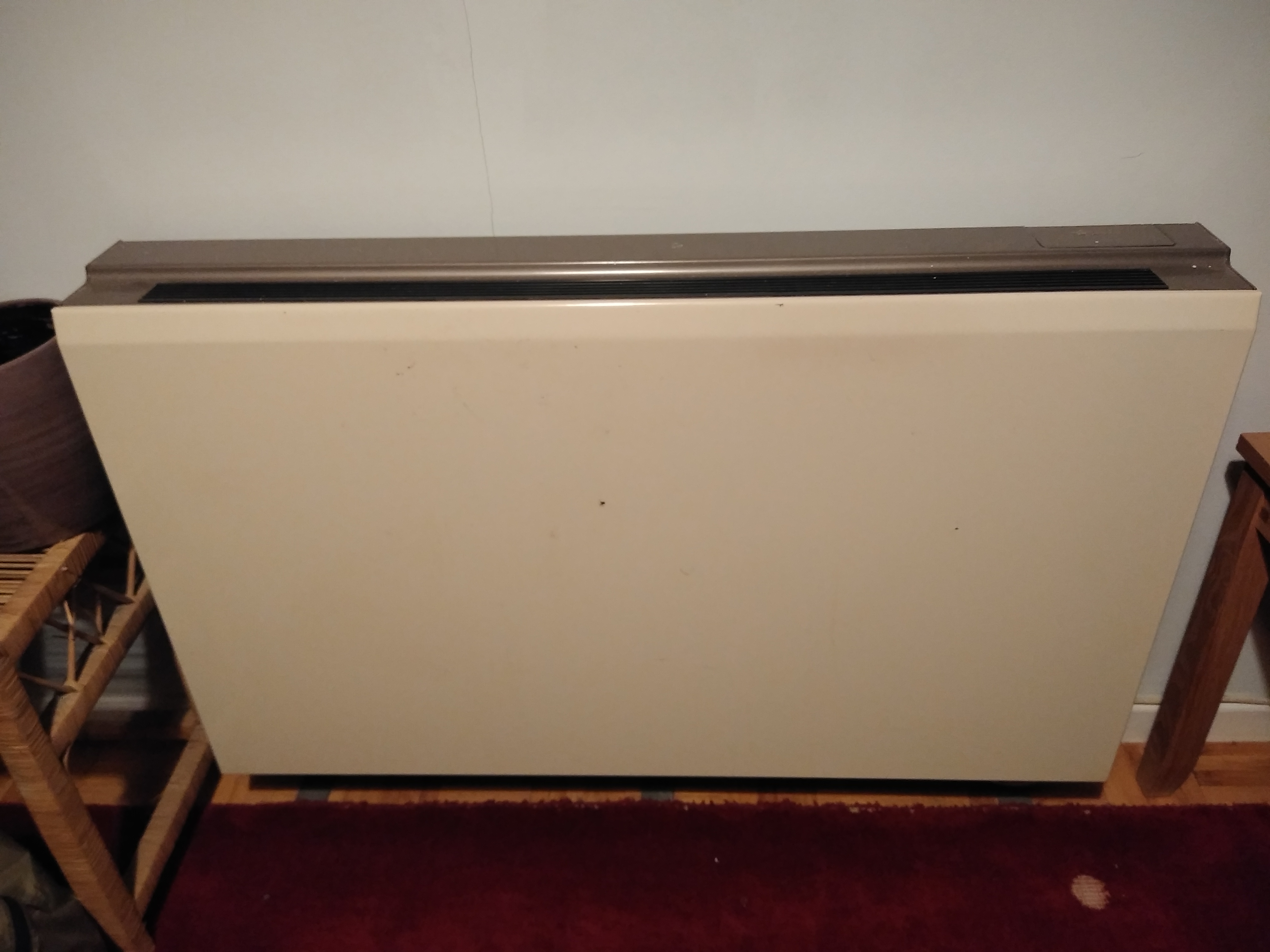

Gill Posted January 3, 2023 Posted January 3, 2023 @SteamyTea We have very old storage heaters and they're out of heat by early evening. We use the panels for top up and warming up a room that's only going to be in use for an hour or so.
SteamyTea Posted January 3, 2023 Posted January 3, 2023 On 03/01/2023 at 15:08, Gill said: We have very old storage heaters and they're out of heat by early evening. Expand Two things: Do you adjust the input/output at all? How would you heat the house if they did not exist?
Gill Posted January 3, 2023 Posted January 3, 2023 Input set to max. Output set to low. By 6pm its tepid and changing output doesn't make any difference. 30 + year old ones just can't retain / release much past 10 hours. The more modern (maybe 20 year old) bathroom one manages a few more hours. If they didn't exist we'd have to pay a heafty bill for running heaters on peak pricing! Probably cheaper in a Premier Inn that running those over the recent cold snap. I'd probably have made a hasty uninformed decision to upgrade to high retention or ashp by now. For now they'll see us through till we get CWI and new windows and then I can reassess.
SteamyTea Posted January 3, 2023 Posted January 3, 2023 On 03/01/2023 at 17:01, Gill said: Input set to max. Output set to low. By 6pm its tepid and changing output doesn't make any difference. 30 + year old ones just can't retain / release much past 10 hours. Expand My SHs are similar age, and are fine. So suspect they are too small for your heat losses, rather than just no good. Mine take about 10 kWh a night in total, so that is about 0.2 kWh/m2, or 8.3W/m2 for total floor area. Do you know how much yours are taking. Just as a sanity check, do they have a fairly even temperature across the whole face, elements can stop working.
Gill Posted January 3, 2023 Posted January 3, 2023 Will need to check even temps in the morning. By early evening any remaining heat is comes from the center of the grill. No actuals for consumption - something I need to try to get a measure of. DHW and intermittent dishwasher /washing machine use on the night rate coupled with poor usage data breakdown from supplier app for eco 7 make it a little fiddly to work out. I'll drop something into a new thread when I've got some numbers.
SteamyTea Posted January 3, 2023 Posted January 3, 2023 (edited) On 03/01/2023 at 19:58, Gill said: early evening any remaining heat is comes from the center of the grill Expand Could be a couple of elements gone pop. Easy to fix. What make of SH is it? Something like this old Creda. Edited January 3, 2023 by SteamyTea
