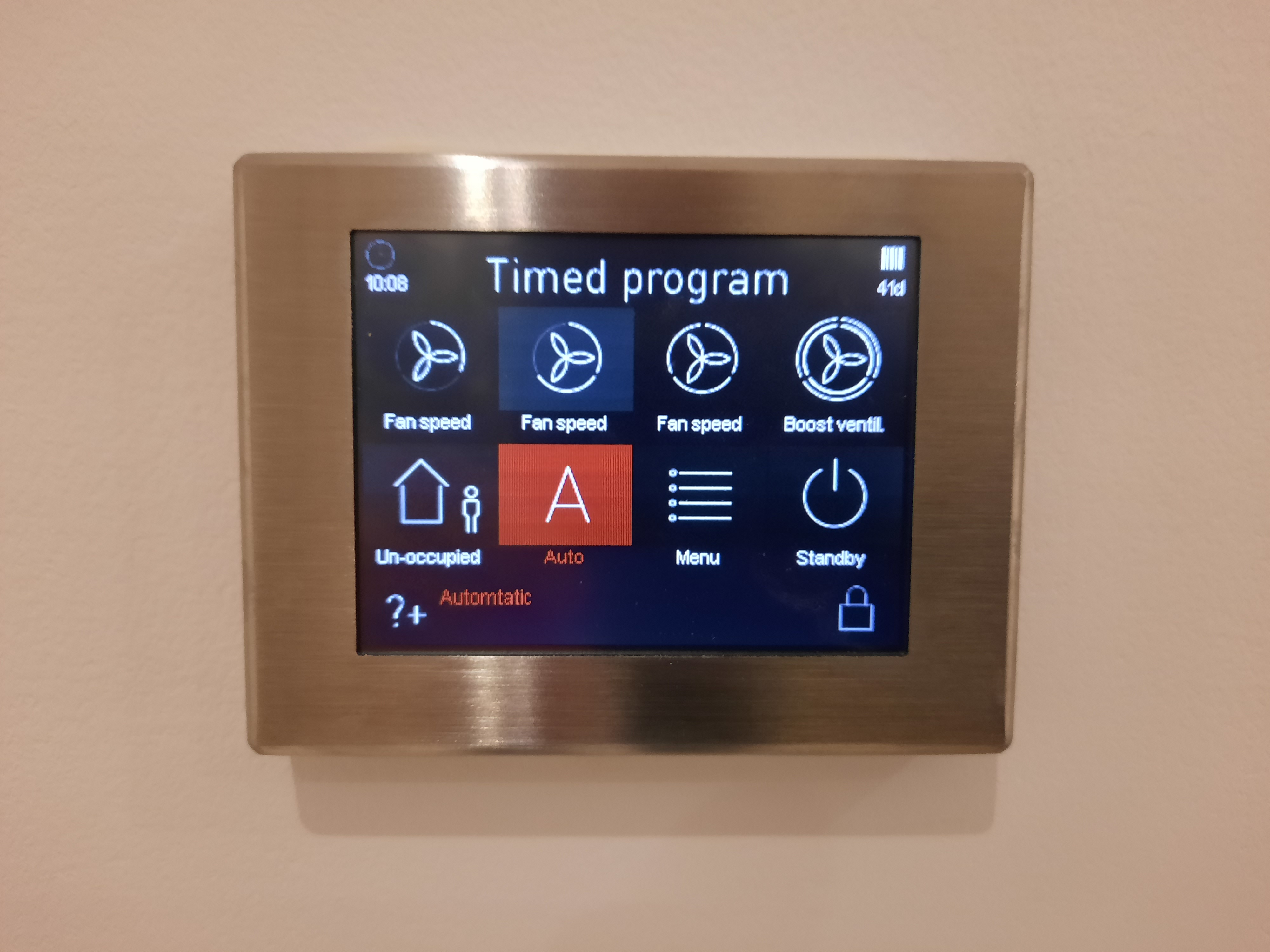

Mike Steel Posted December 16, 2022 Share Posted December 16, 2022 Hi all, We've recently self built and fitted MVHR for the first time, enjoying the constant fresh air! Like many other components with self building, the learning curve is steep and now we in the house we are reflecting on some of the many decisions we made and if given the time again, we would do some things a little differently. MVHR is a good example. The system we chose certainly appear to flood the house with fresh air but is perhaps fairly basic by comparison to some others on here in it's controls. Our system is either on or off with an additional boost function if required. Having read on here about other systems where you can effectively reduce the volume of exchanged air depending on occupancy, holiday mode etc I'm wondering if we should have gone for something more sophisticated. There's no doubt our system brings in plenty of fresh air, but we cannot help thinking its almost over preforming. Just wondered if anyone else has found the same and what they did aside from installing a new unit. Regards, Mike. Link to comment Share on other sites More sharing options...
Conor Posted December 16, 2022 Share Posted December 16, 2022 Does it have a service menu you can access via laptop etc? A lot of systems have a service menu for commissioning etc, Vs the owner menu / interface which can be limited My mvhr had four different modes that correspond to different fixed fan speeds. Default is 3, then when humidity goes over a threshold, it goes to full boost. In this cold weather I've changed it to mode 2, and on a timer as despite the heat exchanger, incoming air was only 15c and noticeable in bedrooms. Also, air was far too dry. Dry skin and static shocks all the time. Much better now and only runs at certain times of the day. Link to comment Share on other sites More sharing options...
ProDave Posted December 16, 2022 Share Posted December 16, 2022 Some of us (cough) run the MVHR at a slightly lower rate than building regs require, based on the fact the house has fewer occupants than building regs would count for the number of bedrooms. This makes it totally silent in all rooms and we still get lovely fresh air and no condensation or mould. Mine is also a basic unit and the only user controls we have are a timed boost activated with a button on the landing that we use when showering, that puts it into fastest speed for your chosen time period when showering. and another timed boost button in the kitchen that runs it at an intermediate speed while cooking. Link to comment Share on other sites More sharing options...

Simon Brooke Posted December 16, 2022 Share Posted December 16, 2022 My Ventaxia has a silent running mode which I have assumed means that the fans are running at minimum rates. The time period is adjustable via the touch screen. Link to comment Share on other sites More sharing options...
Mike Steel Posted December 16, 2022 Author Share Posted December 16, 2022 11 hours ago, Conor said: Does it have a service menu you can access via laptop etc? A lot of systems have a service menu for commissioning etc, Vs the owner menu / interface which can be limited My mvhr had four different modes that correspond to different fixed fan speeds. Default is 3, then when humidity goes over a threshold, it goes to full boost. In this cold weather I've changed it to mode 2, and on a timer as despite the heat exchanger, incoming air was only 15c and noticeable in bedrooms. Also, air was far too dry. Dry skin and static shocks all the time. Much better now and only runs at certain times of the day. No, as far as I know it has nothing like that. The user options are to have it switched on, or off, or boost mode. All via traditional 240v switches. It does have a summer bypass function which is controlled by thermostats on top of the unit. Link to comment Share on other sites More sharing options...

Mike Steel Posted December 16, 2022 Author Share Posted December 16, 2022 (edited) 11 hours ago, ProDave said: Some of us (cough) run the MVHR at a slightly lower rate than building regs require, based on the fact the house has fewer occupants than building regs would count for the number of bedrooms. This makes it totally silent in all rooms and we still get lovely fresh air and no condensation or mould. Mine is also a basic unit and the only user controls we have are a timed boost activated with a button on the landing that we use when showering, that puts it into fastest speed for your chosen time period when showering. and another timed boost button in the kitchen that runs it at an intermediate speed while cooking. Out of interest how long have you run your system slightly lower? I was looking at what building regs document F stipulate the other day in terms of minimum ventilation rates. One of the things that occurred to me was if the MVHR has been set up and balanced to meet building regs, should the MVHR ventilation levels take into account the level of air tightness achieved in that particular building? Presumably if a house is not as air tight as the next one, surely it will be providing some of the required ventilation naturally through fabric leakage, without the MVHR needing to be set to deliver 100% of what building regs stipulate. Edited December 16, 2022 by Mike Steel Link to comment Share on other sites More sharing options...

ProDave Posted December 16, 2022 Share Posted December 16, 2022 1 hour ago, Mike Steel said: Out of interest how long have you run your system slightly lower? About 4 years with no issues. The problem was my MVHR unit only has 4 speeds (it actually has a fine +/- adjustment on each speed) and I needed speed 2 to get the BR rates in all rooms. At that speed it was just audible in some rooms. So now it runs at speed 1 with the + adjustment on. It's not much below regs levels but dead silent. Link to comment Share on other sites More sharing options...
NSS Posted December 16, 2022 Share Posted December 16, 2022 Five years in we've experimented with different settings and settled for a summer programme and a winter programme. In summer it runs on speed 2 (of 4) from 7pm to 7am and speed 1 from 7am to 7pm. In winter we reverse that. If we have a particularly hot spell, as earlier this year, then we up the night time speed to 3. Summer bypass is programmed to avoid heat recovery when outside temp exceeds 20C. Speed 4 (boost) is reserved for the likes, for example, of when cooking fish and runs for 60 minutes unless manually stopped. In all bar boost mode there is no perceptible noise in the house. We never open windows, and doors are seldom open for more than a few seconds. Link to comment Share on other sites More sharing options...

Mike Steel Posted December 17, 2022 Author Share Posted December 17, 2022 11 hours ago, ProDave said: About 4 years with no issues. The problem was my MVHR unit only has 4 speeds (it actually has a fine +/- adjustment on each speed) and I needed speed 2 to get the BR rates in all rooms. At that speed it was just audible in some rooms. So now it runs at speed 1 with the + adjustment on. It's not much below regs levels but dead silent. Thanks for that additional info ProDave. The 4 speeds you have on your system, are they intended to be adjustable by the user, as we don't appear to have any adjustment on ours. Unless there is something deep inside the unit which I assume we should be leaving well alone. Link to comment Share on other sites More sharing options...
ProDave Posted December 17, 2022 Share Posted December 17, 2022 2 minutes ago, Mike Steel said: Thanks for that additional info ProDave. The 4 speeds you have on your system, are they intended to be adjustable by the user, as we don't appear to have any adjustment on ours. Unless there is something deep inside the unit which I assume we should be leaving well alone. the 4 speeds are selected by 4 volt free contacts. You could buy a switch that could be mounted anywhere in the house that was simply a rotary switch labelled 1,2,3,4 but I chose to do my own thing. I used this sort of time switch But because that has a switched 240V output I use that to switch on a small relay, that then provides the volt free contact to connect to the ASHP Link to comment Share on other sites More sharing options...
