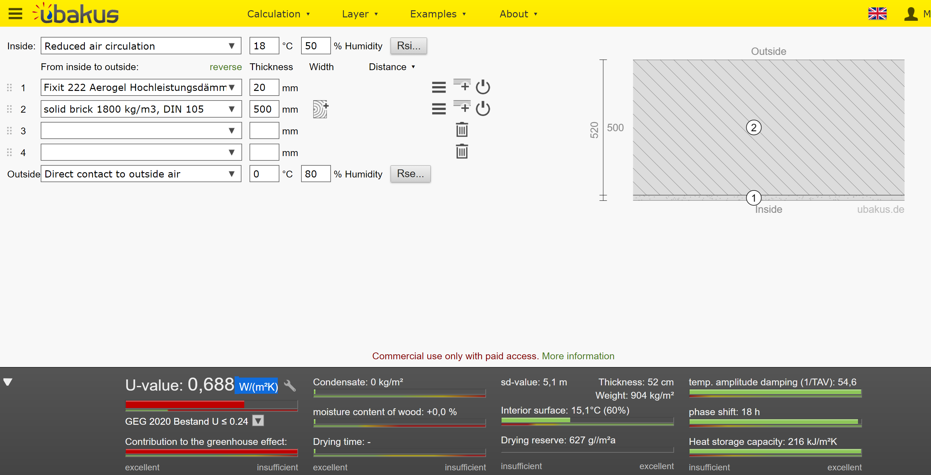

Radian Posted December 14, 2022 Posted December 14, 2022 (edited) 12 hours ago, Temp said: As I recall real Aerogel is only about twice as good as PIR foam. Real Aerogel is also fragile so i don't think the form used in insulation is the same. Have you got figures for the thermal resistance to compare? You can have a play with Fixit 222 on ubakus Edited December 14, 2022 by Radian 1

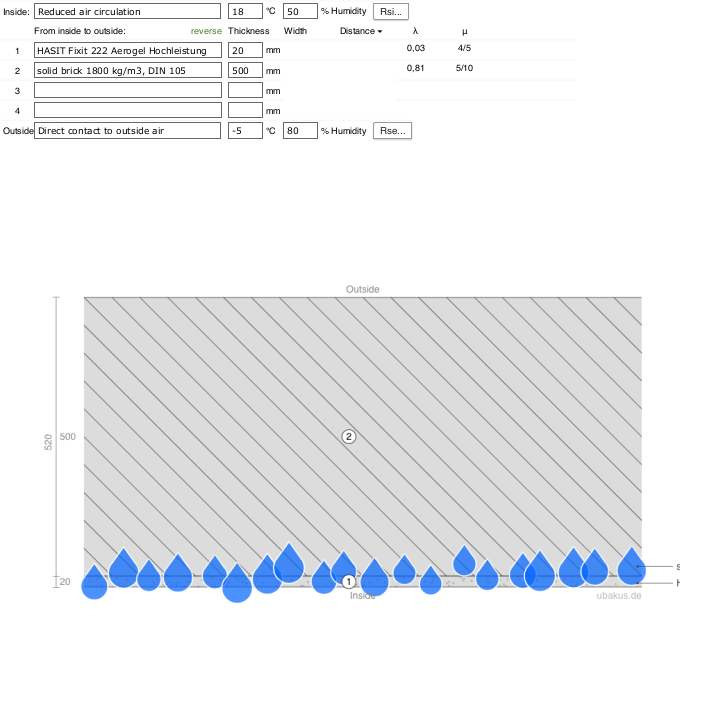

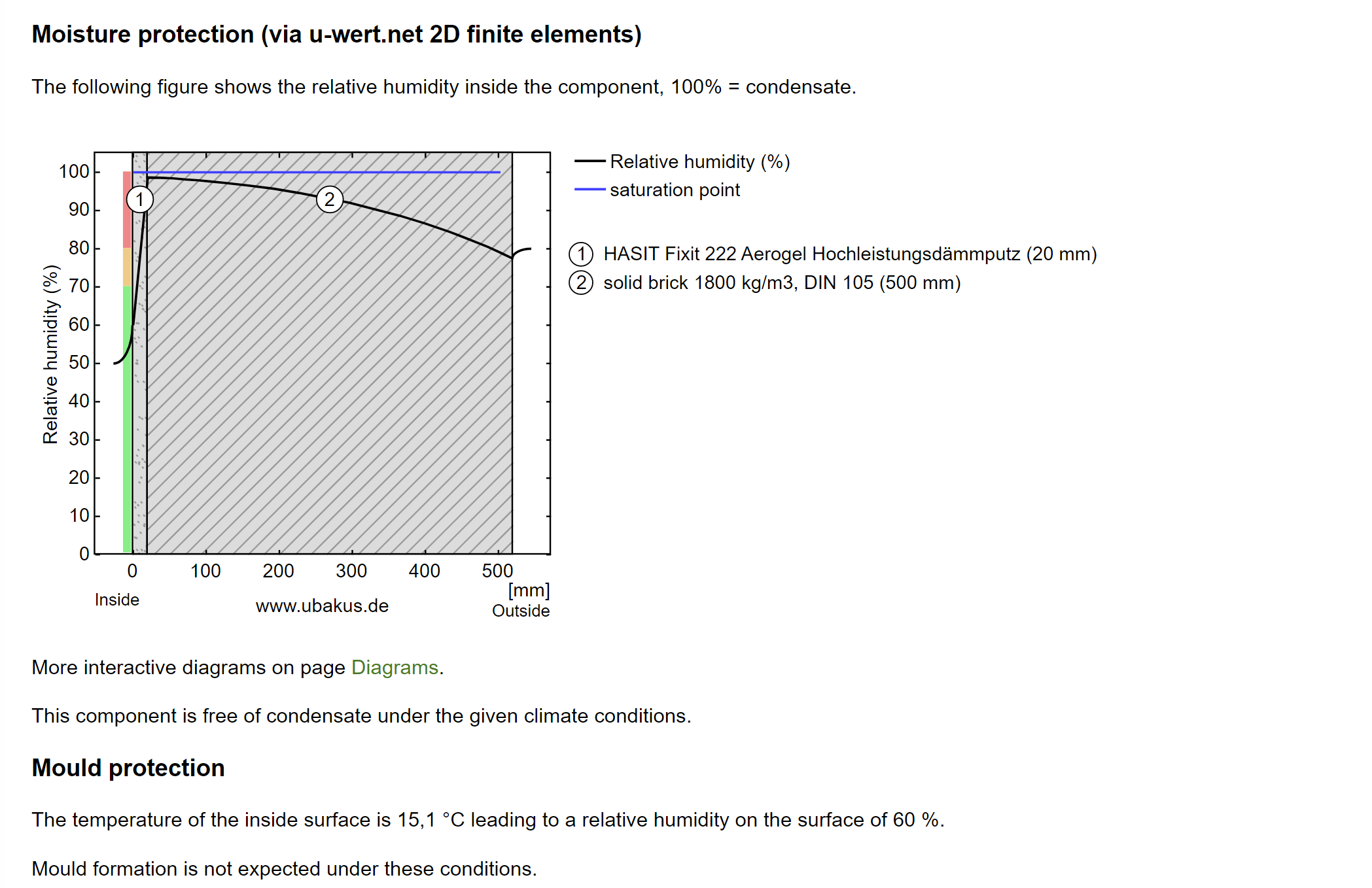

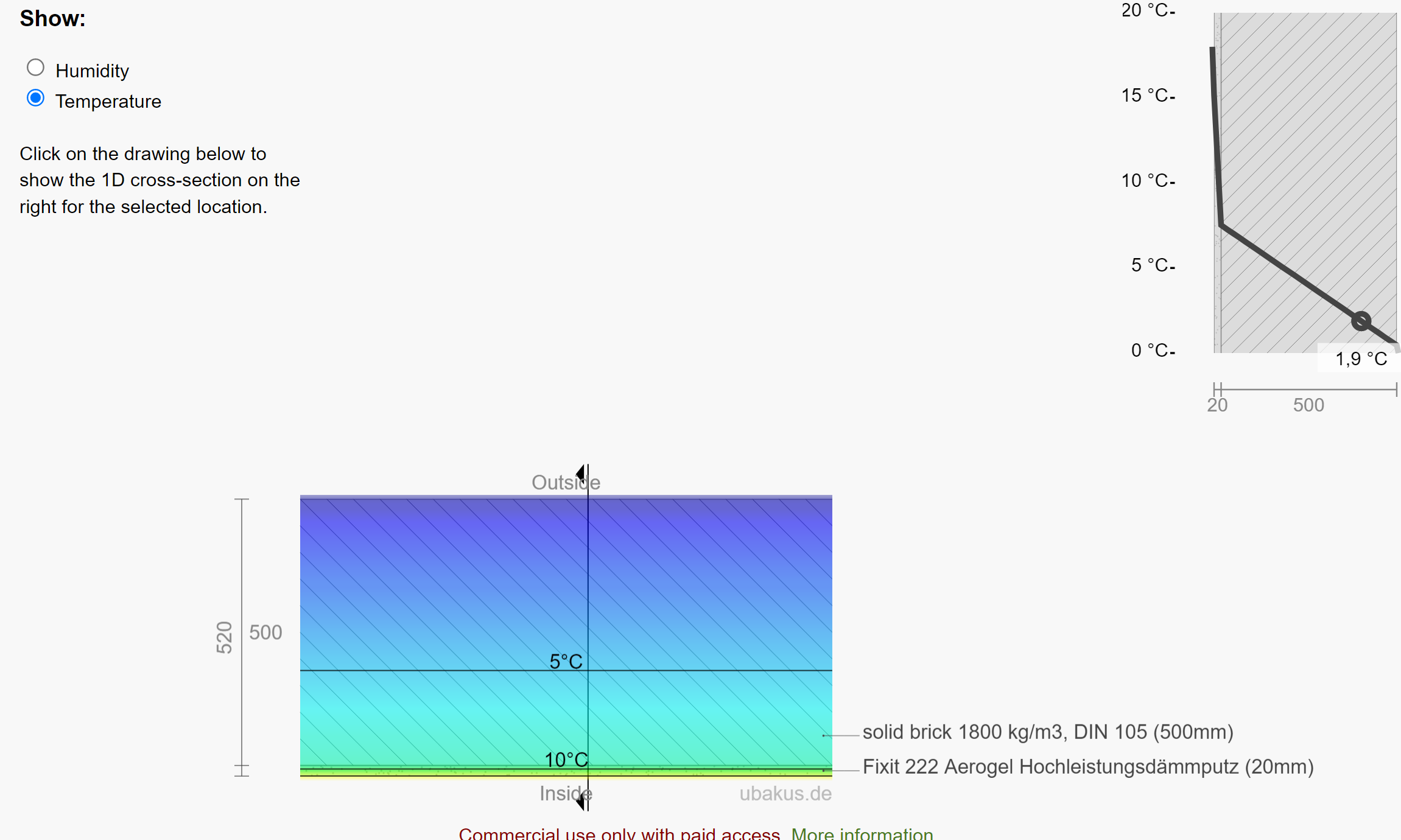

Garald Posted December 14, 2022 Author Posted December 14, 2022 But when it's -5 C outside, I do get condensation: What to do?
Garald Posted December 15, 2022 Author Posted December 15, 2022 (Of course, the average temperature in Paris during winter months is around 3C, not -5C. Does this mean I should not worry?)
Radian Posted December 15, 2022 Posted December 15, 2022 You definitely need to understand the materials involve in the construction of the external wall. By insulating the surface on the inside, you move the dewpoint out into the wall. Whether or not this is an issue for the wall needs to be understood. The problem is you may do too good a job of insulating the inside. If you downgrade the insulation by swapping the plaster for thin sheets of composite XPS (Ubakus suggests WLG 035) then the dewpoint remains below saturation point throughout the structure and still prevents condensation on the inside. To see this suggestion, disable the plaster layer and look at the Moisture report with 20oC/50% in, -5oC/80% out: Mould protection The temperature of the inside surface is 13,1 °C leading to a relative humidity on the surface of 78 %.Some kinds of mould start to grow at relative air humidities of 70% or more, mould cannot be excluded!. Under the given circumstances, mold formation can be avoided by the following measures: Reduction of the relative humidity of the room air to 45% Increasing the surface temperature to 14,7°C by (additional) thermal insulation. This would require about 10 mm insulation (WLG 035).
