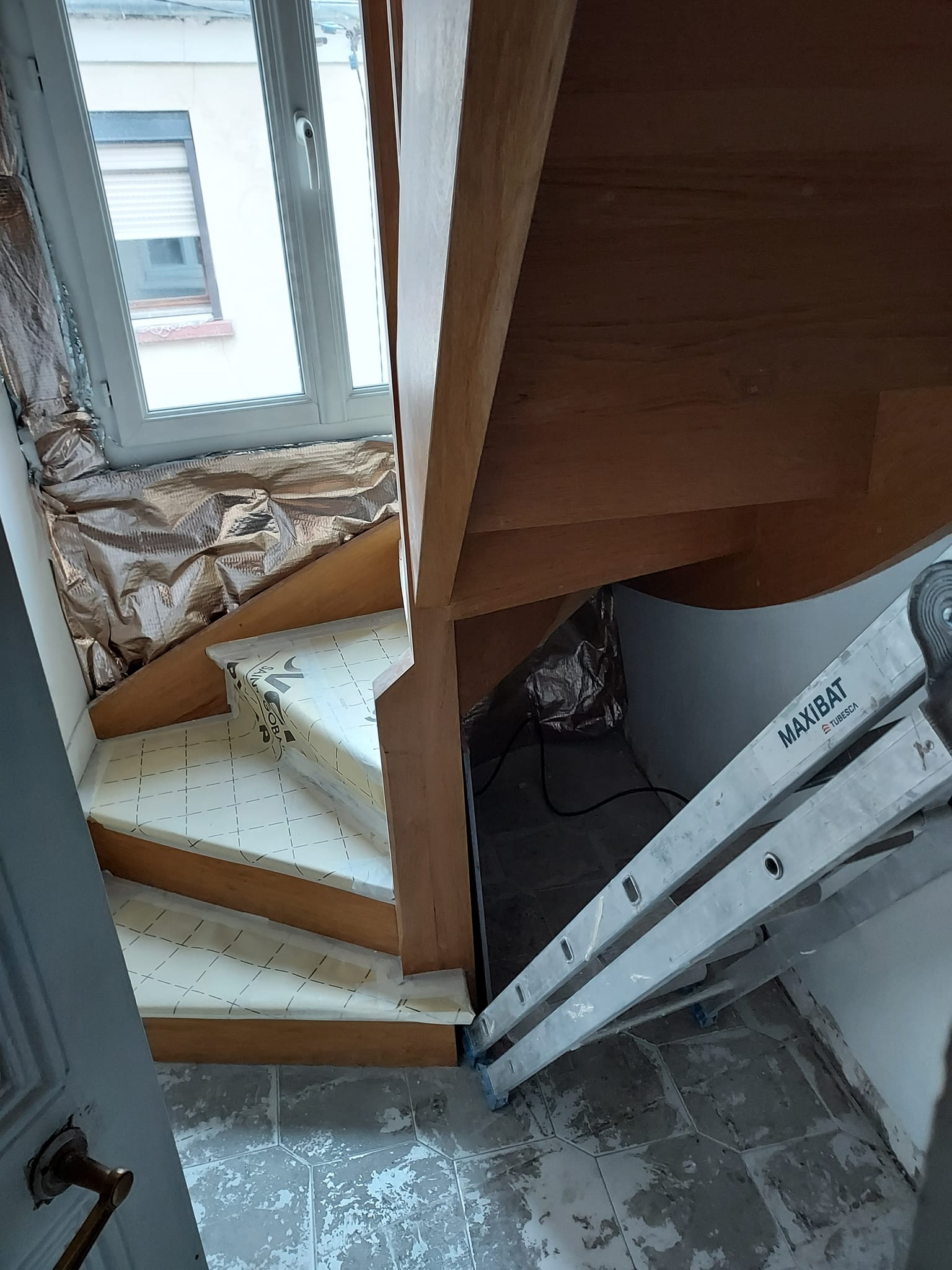

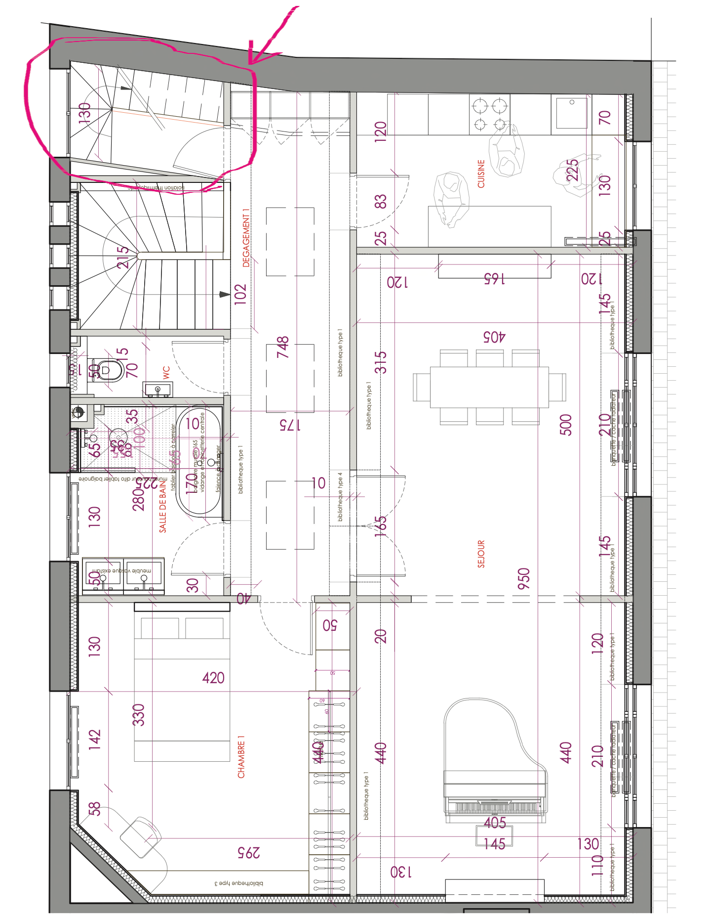

Garald Posted December 11, 2022 Posted December 11, 2022 There's one weakness in our insulation plan, which is otherwise going well: a small stairwell going from the first floor to the attic. (This is an old plan; now we are also insulating the kitchen's long wall, and also filled in the gap above the pantry/closet on the top end of the corridor.) We simply do not have the space to insulate that corner without destroying the staircase, or so the architect says. Unfortunately, that means that the heat loss from that staircase alone is about 650W, that is, well over 10% of the total heat loss in the house. (It may be more like 10%: the first meter or so of the stairwell's long wall benefits from being adjacent to a building next door. (The rest doesn't, if my memories of checking it with an infrared thermometer have a year ago are accurate.) One obvious measure is to insulate the door leading to it (seen in the plan above) as well as possible. The architect says we can't really close the top off easily - hopefully convection will work its charm and just let cold air accumulate down the bottom part of the stairs. I imagine I should *not* put a radiator there. Are there other small measures we should take to reduce heat loss through that corner?
Adsibob Posted December 12, 2022 Posted December 12, 2022 (edited) How about adding EWI? You mention part of the outside is covered by an adjoining building, but what about the other part? Can you annotate the pan to show which part of the wall is attached to the neighbouring building and which part is detached? Edited December 12, 2022 by Adsibob
Garald Posted December 12, 2022 Author Posted December 12, 2022 3 minutes ago, Adsibob said: You mention part of the outside is covered by an adjoining building, but what about the other part? I'm actually not sure whether their first story is just particularly low in that corner, or whether they have some sort of peculiar machine that cools that corner (and sends the heat off to feed reptiloids or what have you). I'd imagine it's the first one. At any rate, the thermal thermometer showed that a spot was particularly cold. 3 minutes ago, Adsibob said: How about adding EWI? You mention part of the outside is covered by an adjoining building, but what about the other part? My architect once talked about it, but in the end felt it would not be cost-effective for such a small bit of wall. We would need to ask permission from the owners of the neighboring building (I have no idea who they are), get the workers to install scaffolding... And of course we are already in the middle of things, and would like to be done in a couple of months. In summary, it's an option that we have kept for when and if I decide to raise the roof/add an extra story to the building (whenever that would be; certainly not in the immediate future). And of course the short wall in the stairwell would remain uninsulated (unless we were to apply insulation to my entire courtyard side on the outside; sounds a bit daft, given that we are already insulating it from the inside). Again, we could rethink the staircase if a story is ever added, but...
Adsibob Posted December 12, 2022 Posted December 12, 2022 The floor plans suggest you are in France or Canada. If the former, I wouldn’t worry about it too much. You are unlikely to have long hard winters, and this is a corner of your house that doesn’t appear to contain any living space, just staircase. If you are in Canada, that’s a different story, but even then not terrible.
Garald Posted December 12, 2022 Author Posted December 12, 2022 I am in France (Paris area, in fact), but, as I said, this tiny corner accounts for more than 10% of heat loss. It's not nothing, in that it's the difference between "I feel comfortable with a 7kW heat-pump (which is really 6kW in the rare occasions when it gets to -7C)" and "maybe I should think about that a bit more". (10kW would be very oversized, but that's the next step up in Saunier-Duval aka Vaillant.)

Garald Posted December 12, 2022 Author Posted December 12, 2022 Ah wait, did the workers just manage to insulate the short side with a bit of reflective material and just did not tell me? Nice!

ProDave Posted December 12, 2022 Posted December 12, 2022 I can see why yo can't do much above the stairs, but there is no reason you can't insulate the wall below the stairs, that will be about half of it insulated. And a thick pair of curtains over that suicide door / window.
Garald Posted December 12, 2022 Author Posted December 12, 2022 3 hours ago, ProDave said: And a thick pair of curtains over that suicide door / window. Do curtians really help substantially? OTOH, they might keep.one from realizing that the window is open... (Btw, that window locks, with a key.)
