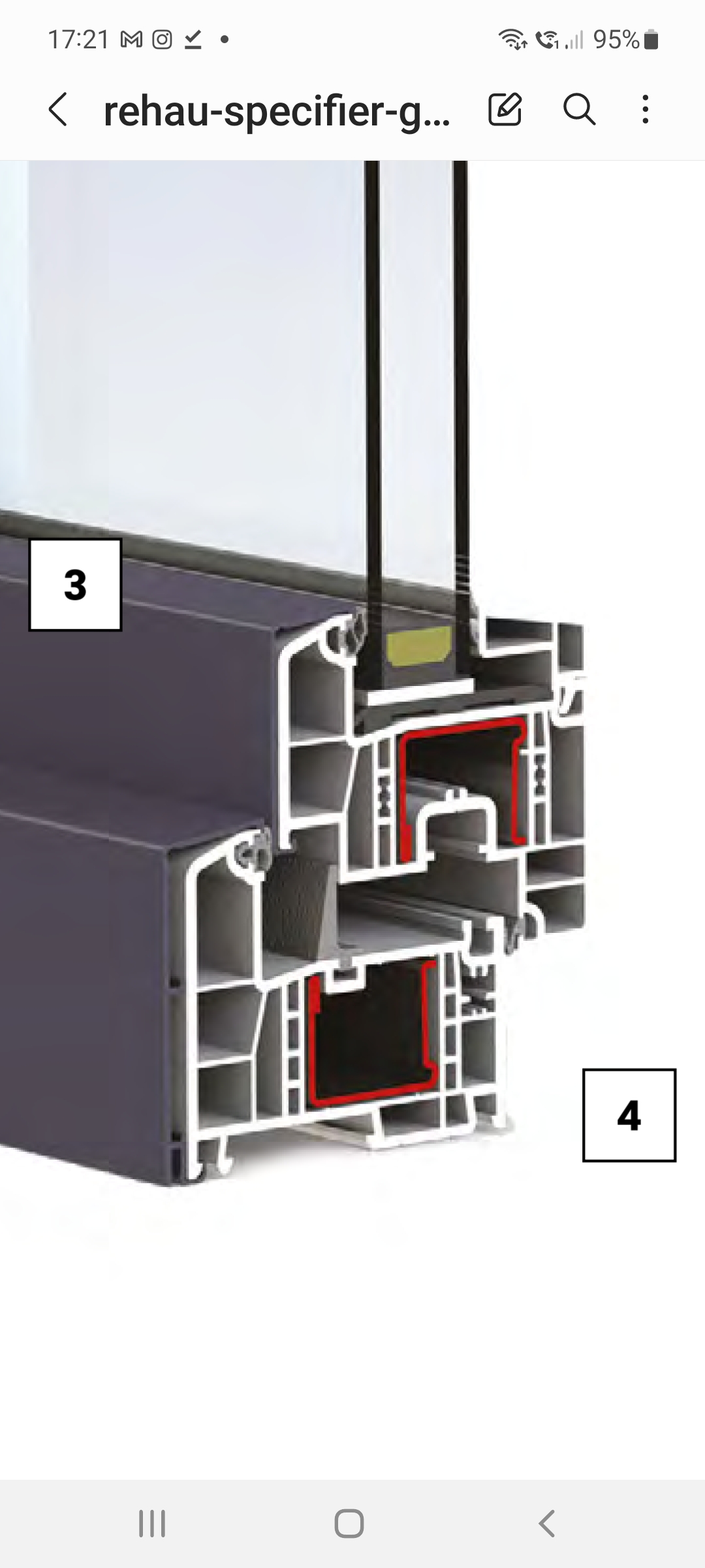

Gone West Posted December 14, 2022 Share Posted December 14, 2022 2 minutes ago, saveasteading said: Physically insulated or air cells? Physically insulated. Link to comment Share on other sites More sharing options...

saveasteading Posted December 14, 2022 Share Posted December 14, 2022 2 hours ago, Gone West said: Physically insulated. The catalogue just shows hollow chambers. "6 chambers and 3 seals" is the proud quote. My special interest is that we are currently putting Rehau in. As we are leaving some stone exposed, this minor bridge is relatively insignificant, but it all adds up. Link to comment Share on other sites More sharing options...
Gone West Posted December 15, 2022 Share Posted December 15, 2022 13 hours ago, saveasteading said: The catalogue just shows hollow chambers. We had the windows installed in 2012. We visited the manufacturers to see the profile and a window being made. We saw the lengths of insulation for the each of the chambers which was just slid into the cavity. The insulation was optional but we wanted to have it to minimise thermal bridging. I'll see if I can find an old PDF describing the construction, but don't hold your breath, it was a long time ago. It might be worth contacting Rehau to see if it's still an option. Link to comment Share on other sites More sharing options...
Gone West Posted December 15, 2022 Share Posted December 15, 2022 14 hours ago, saveasteading said: "6 chambers and 3 seals" is the proud quote. Amazingly I found the old Rehau Geneo PDF. Page three shows the optional insulation that was available with the version ten years ago. REHAU Geneo Energy Efficiency.pdf 1 Link to comment Share on other sites More sharing options...
saveasteading Posted December 15, 2022 Share Posted December 15, 2022 6 hours ago, Gone West said: worth contacting Rehau to see if it's still an option The brochures are very vague, but no mention of this option. . The windows are sitting on site anyway. No more to be done I think. Link to comment Share on other sites More sharing options...

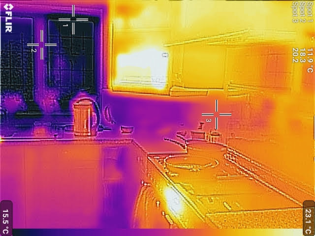

Gus Potter Posted December 16, 2022 Share Posted December 16, 2022 Had a chat today with a window system manufacturer. Jist that I got and to distill a good bit was.. they test their windows with a "hot box". The window is fiitted into a box, they put a heater on one side and measure the temperature on the other. This lets them calculate the overall U value of the glass and frame. Dead simple and they then can develop a model for all the small and varying window sizes in between. But then we started to talk about trickle vents and how much they impact on the window performance. The new regs for trickle ventilation (Scotland) are quite onerous for new build. One problem practically is that the vents break the thermal barrier between the window frame layers and this really shows up in infra red. We never got to discuss if the trickle vents get sleeved but if not I can imagine that the draft will "whizz" round the internal voids in the frame? I wonder if the trickle vents can set up internal convection currents in the window frames? Of course if you have a MVHR system it becomes a mute point. Link to comment Share on other sites More sharing options...
saveasteading Posted December 16, 2022 Share Posted December 16, 2022 1 hour ago, Gus Potter said: if the trickle vents get sleeved The windows i have looked at, the trickle vent is a thing, plugging between frame and pane. So no link from vent to frame Link to comment Share on other sites More sharing options...
Gus Potter Posted December 16, 2022 Share Posted December 16, 2022 9 minutes ago, saveasteading said: The windows i have looked at, the trickle vent is a thing, plugging between frame and pane. So no link from vent to frame Spot on. To expand on the chat I was having with the manufacturer today. They said they needed 20000m ^2 trickle ventilation on a new build . The only way to achieve this was to add a head extension to the window and fit double vents and one at the hopper.. remember window frame looses more heat than a modern argon / filmed glass unit. For a bit of fun they did a hot box test and you had massive heat loss at the vents.. but does the window need to comply with or without vents? Most trickle vents in Upvc are formed by routering out the outside and inside, have yet to seen sleeved ones on the commonly installed windows .. every day is a school day. The outcome was they said to the developer.. will be cheeper and more Architecturally pleasing to fit MVHR.. problem goes away until each occupant say in a block of housing wants to live their own individual life. My grip is this. I do a bit of work on historic structures. I make the argument to BC that they leak air like sieves and say.. my Clients are grown up.. if the buiding gets stuffy they will open a window! If you ask for big trickle vents you need to justify why.. yes you are BC but I will challenge you on these techinical matters, in particular how to you justify the heat loss and environmental impact.. that gets them thinking. They stick to the regs but you can turn this against them at times.. by saying if you stick to this part of the regs you shoot yourself in the foot on energy conservation so "tell me what to do" I wonder.. why can we not just educate the public.. if your house feels damp, you are boiling up potaoes / drying a bit of washing inside.. open a window? My Mum does that and she is 91. If it is windy then the house will air quickly.. we need some common sense in the regs rather than this blanket prescribed approach that we need to conform to because some young polititians who are over paid for their talents decide that this is the best way to get re elected at our expense. 2 Link to comment Share on other sites More sharing options...

Radian Posted December 16, 2022 Share Posted December 16, 2022 49 minutes ago, Gus Potter said: I wonder.. why can we not just educate the public.. Have you never met the public? 🤣 But I do sympathise with your stance on trickle vents. The ones on my kitchen window are closed in this thermal image... In case it's not clear from this image of our kitchen at 20oC, the wooden DG window frames are at around 18oC except for where they're being washed down with cold air from the poorly designed vents, leaving large areas at around 12oC or less. Link to comment Share on other sites More sharing options...
