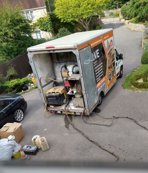

Radian Posted December 9, 2022 Share Posted December 9, 2022 I always smell a rat when something doesn't come up in a google search - I want it, I've seen other people say they want it, so why isn't it on general sale? We recently had our cavity walls injected with graphite coated (fire retarded) EPS beads and the big old box-van showed up with around 12m3 of beads in a built-in sack. The van is mostly just a big sack of beads: So I'm thinking that these would be ideal for pouring in around several boxed-in stacks that I've got in the house. But can I find a supplier for them who won't only show up in a van and pump them in? Can I heck. Anyone know a way to get hold of them? Link to comment Share on other sites More sharing options...

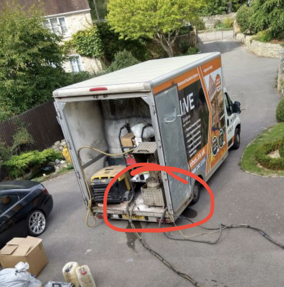

PeterW Posted December 9, 2022 Share Posted December 9, 2022 Beads I one thing / you need that pot in the bottom corner too - that’s the glue system that stops the beads becoming a torrent when you drill though the wall Link to comment Share on other sites More sharing options...
Radian Posted December 9, 2022 Author Share Posted December 9, 2022 5 minutes ago, SteamyTea said: First Google hit. http://polypearl.co.uk/cavity-wall-insulation/ Sorry, yes, I should have elaborated: a supplier with a retail facility. I mean, it's easy to find furnishing grade EPS beads all over ebay and Amazon but claims of fire ratings are highly dubious for a plain white poly bead. Funny really because graphite EXP sheets are readily available from those places as well as insulation stores. On their website it says "We also work closely with a selection of builder’s merchants and retail suppliers." but I'm still waiting for a callback. I don't hold up much hope as without retail sales it usually means f-off unless you're in the trade. Link to comment Share on other sites More sharing options...
Radian Posted December 9, 2022 Author Share Posted December 9, 2022 34 minutes ago, PeterW said: Beads I one thing / you need that pot in the bottom corner too - that’s the glue system that stops the beads becoming a torrent when you drill though the wall I don't want them to put in a wall. As I said above, I've got three boxed-in stacks that I can access from above and I just want to pour in beads to get the insulation all the way down to the ground where I know there is none. Link to comment Share on other sites More sharing options...
PeterW Posted December 9, 2022 Share Posted December 9, 2022 Yes - so what happens when someone cuts or drills into the ground floor stack boxing :.?? 1 Link to comment Share on other sites More sharing options...
nod Posted December 9, 2022 Share Posted December 9, 2022 6 minutes ago, PeterW said: Yes - so what happens when someone cuts or drills into the ground floor stack boxing :.?? Exactly I recently routed a pipe in the 600 void at my brother in-laws and couldn’t move for the stud Link to comment Share on other sites More sharing options...
Radian Posted December 9, 2022 Author Share Posted December 9, 2022 22 minutes ago, PeterW said: Yes - so what happens when someone cuts or drills into the ground floor stack boxing :.?? I've lived here for 25 years and never once so much as put a screw into any of these boxes. However, in the extremely unlikely event of me wanting to gain access, I'd get out the garden vac and suck 'em out ready to re-fill. If it's someone else's house, I'd consider it an excellent posthumous practical joke. Do you have any other suggestions for how to retrospectively insulate the voids around these stacks? 1 Link to comment Share on other sites More sharing options...

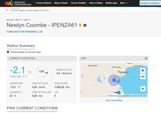

Radian Posted December 9, 2022 Author Share Posted December 9, 2022 You're about 8oC warmer than us here along the South coast. I'd be looking at something hotter than Battenberg. Something with Bacon. Link to comment Share on other sites More sharing options...
SteamyTea Posted December 9, 2022 Share Posted December 9, 2022 (edited) 15 minutes ago, Radian said: You're about 8oC warmer than us here along the South coast. I am current at 0.2°C, Swanage is 0.6°C. 15 minutes ago, Radian said: Something with Bacon. Now you have made me really hungry. 15 minutes ago, Radian said: I'd be looking at something hotter Dipping spring rolls and bhajis into chilli sauce ATM. Edited December 9, 2022 by SteamyTea Link to comment Share on other sites More sharing options...
Radian Posted December 9, 2022 Author Share Posted December 9, 2022 8 minutes ago, SteamyTea said: I am current at 0.2°C, Swanage is 0.6°C. Been around -3oC this evening but just noticed it's rinsing quite fast. Down on the tip of Cornwall it looked, for example, like +5oC in Penzance at the time. Link to comment Share on other sites More sharing options...
SteamyTea Posted December 9, 2022 Share Posted December 9, 2022 (edited) 8 minutes ago, Radian said: Been around -3oC this evening but just noticed it's rinsing quite fast. Down on the tip of Cornwall it looked, for example, like +5oC in Penzance at the time. Was -1°When I drove home, but it seemed warmer than when I went to work. No frost on my car, but was on some. Don't really care as there is no wind or rain, so may be a nice sunny day tomorrow. Edited December 9, 2022 by SteamyTea Link to comment Share on other sites More sharing options...
