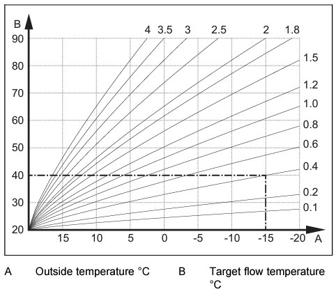

Marvin Posted December 8, 2022 Share Posted December 8, 2022 Hi @daunker As I understand it, a high SCOP is derived from keeping the water temperature coming out of the ASHP as close to the temperature of the outside air temperature as possible whilst still keeping the building at a suitable temperature. A bit of a balancing act. We use the weather compensation option to do this. Link to comment Share on other sites More sharing options...

HughF Posted December 9, 2022 Share Posted December 9, 2022 Well, if the flow temp is permanently fixed at 45 degrees, it isn’t running under weather compensation. I wouldn’t trust your installers, they might well have stuffed up the install as easily as they stuffed up the flow temperature. 1 Link to comment Share on other sites More sharing options...
Marvin Posted December 9, 2022 Share Posted December 9, 2022 As I understand it, the weather compensation setting has to be individually set to each property to work properly. 1 Link to comment Share on other sites More sharing options...
HughF Posted December 9, 2022 Share Posted December 9, 2022 1 hour ago, Marvin said: As I understand it, the weather compensation setting has to be individually set to each property to work properly. Pretty much, yes... Although a good starting point would be 50@-2, 37@15 - the 37 being chosen to keep people quiet about 'the radiators aren't warm' 1 Link to comment Share on other sites More sharing options...

Marvin Posted December 9, 2022 Share Posted December 9, 2022 -7°C this morning first thing and heating setpoint 43°C and inside 21-22°C. 36 minutes ago, HughF said: Not ideal numbers but good enough to stop people calling up the support number and complaining. Yes it's taken us a while to think about the room temperature rather than how hot the radiator is... Also we would not have been able to adjust ours ourselves without understanding how it all works - and that's due to help from people @BuildHub Link to comment Share on other sites More sharing options...
ReedRichards Posted December 9, 2022 Share Posted December 9, 2022 3 hours ago, Marvin said: -7°C this morning first thing and heating setpoint 43°C and inside 21-22°C. -7°C must be very rare on the Isle of Wight, in which case you have probably gone off the end of your weather compensation curve and 43°C must be the maximum heating setpoint. Link to comment Share on other sites More sharing options...
PhilT Posted December 9, 2022 Share Posted December 9, 2022 56 minutes ago, ReedRichards said: -7°C must be very rare on the Isle of Wight, in which case you have probably gone off the end of your weather compensation curve and 43°C must be the maximum heating setpoint. This is the Vaillant Arotherm Plus WC - a choice of 14 curves of which Marvin's looks like it's been set to the 0.6 curve Link to comment Share on other sites More sharing options...
Radian Posted December 9, 2022 Share Posted December 9, 2022 7 hours ago, HughF said: a good starting point would be 50@-2, 37@15 - the 37 being chosen to keep people quiet about 'the radiators aren't warm' An important bit of psychology it would appear. I tried increasing the hysteresis by 0.5oC to reduce boiler firing frequency but the occupants perceived this as a reduction in indoor temperature even though the average was identical. Cold radiators were the most often cited case for the prosecution. Link to comment Share on other sites More sharing options...
ReedRichards Posted December 9, 2022 Share Posted December 9, 2022 29 minutes ago, PhilT said: This is the Vaillant Arotherm Plus WC - a choice of 14 curves of which Marvin's looks like it's been set to the 0.6 curve So what does it mean when the curve reaches an impossibly high target flow temperature? Link to comment Share on other sites More sharing options...
JohnMo Posted December 9, 2022 Share Posted December 9, 2022 9 minutes ago, ReedRichards said: So what does it mean when the curve reaches an impossibly high target flow temperature? You are living in a barn and you have left the doors open, or your heat emitters are undersized. But looks like a controller suitable for both a heat pump, but also a gas boiler. Link to comment Share on other sites More sharing options...

Marvin Posted December 9, 2022 Share Posted December 9, 2022 3 hours ago, PhilT said: This is the Vaillant Arotherm Plus WC - a choice of 14 curves of which Marvin's looks like it's been set to the 0.6 curve Hi @PhilT To clarify we have a coolenergy ASHP, and we set our own weather compensation curve to suit our own heat loss results. Link to comment Share on other sites More sharing options...

daunker Posted December 22, 2022 Author Share Posted December 22, 2022 On 10/12/2022 at 12:11, PhilT said: sorry daunker who made the original post Thanks! I've changed if to 0.4 and not noticing any deterioration in house temps at all, it seems to be running a better COP too, but was very poor over the real cold weather spell we've just had. Thanks @jothand @Bob77for that, yes now read this in Vaillants brochure but really appreciate you for posting. Seems unusual way but I guess makes sense once you wrap head around it. having a lot of fun playing with controller settings if nothing else, although changing so much and the environmental temps are so variable that I'm not sure which changes are making the biggest impacts. Definitely heading the right way tho Link to comment Share on other sites More sharing options...
