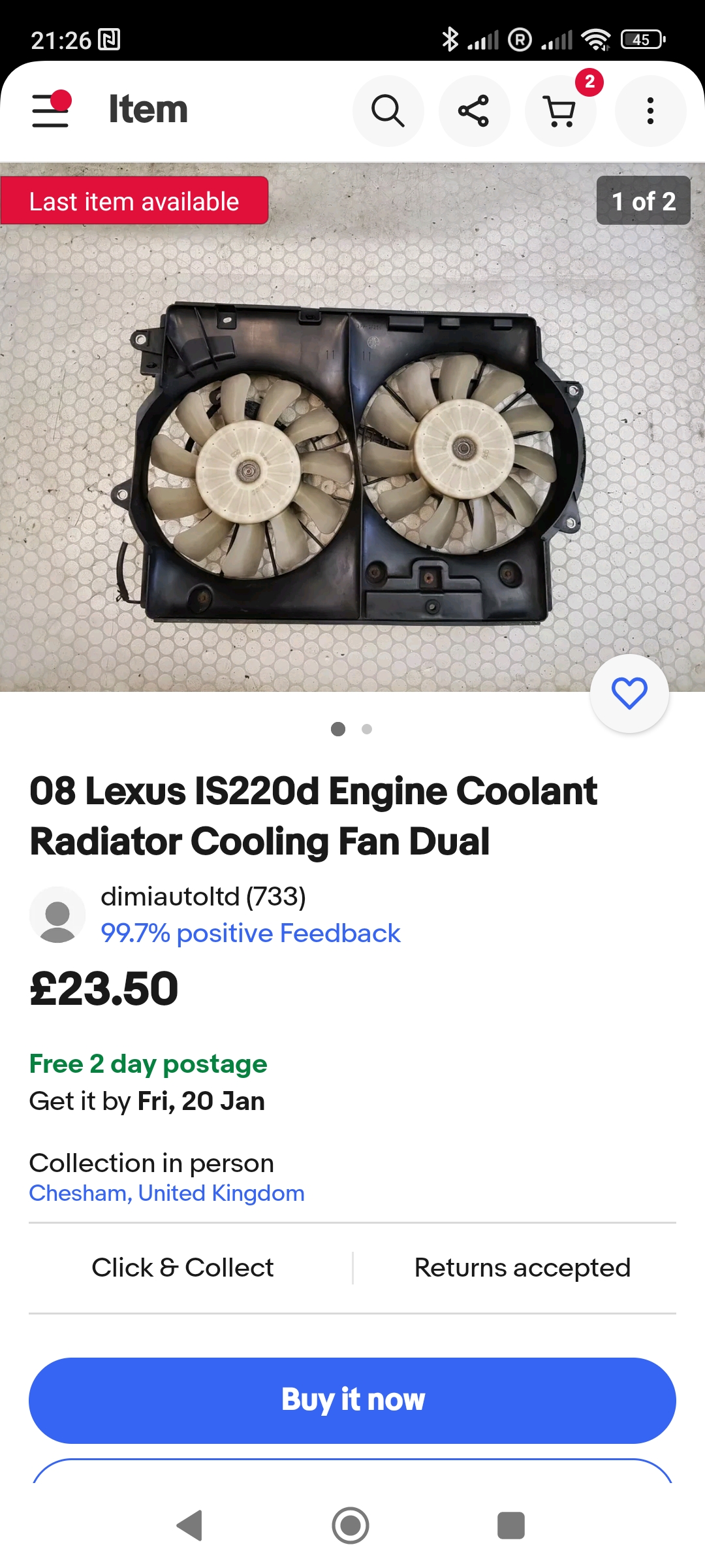

Sparrowhawk Posted January 18, 2023 Share Posted January 18, 2023 On 09/12/2022 at 10:46, Iceverge said: Ingredients. 1. A sheet of OSB. 2. A scrap car radiator fan. As scrap car radiators fans on ebay seem to go at a premium at present, would one of these 12" fans or these 16" fans be powerful enough to do the job? They're listed with the same CFM so I'm thinking the smaller one. Link to comment Share on other sites More sharing options...
Iceverge Posted January 18, 2023 Share Posted January 18, 2023 Should be. The bigger the better I say. Maximum attack!! One point I would note is that the flange area around the edge seems minimal. You would be left trying to cut a very accurate hole and tape to the bare minimum the remainder. Something like this would be twice as powerful and easier to fit. Just get the seller to include the plug and a few cm of wire when posting it. 1 1 Link to comment Share on other sites More sharing options...
