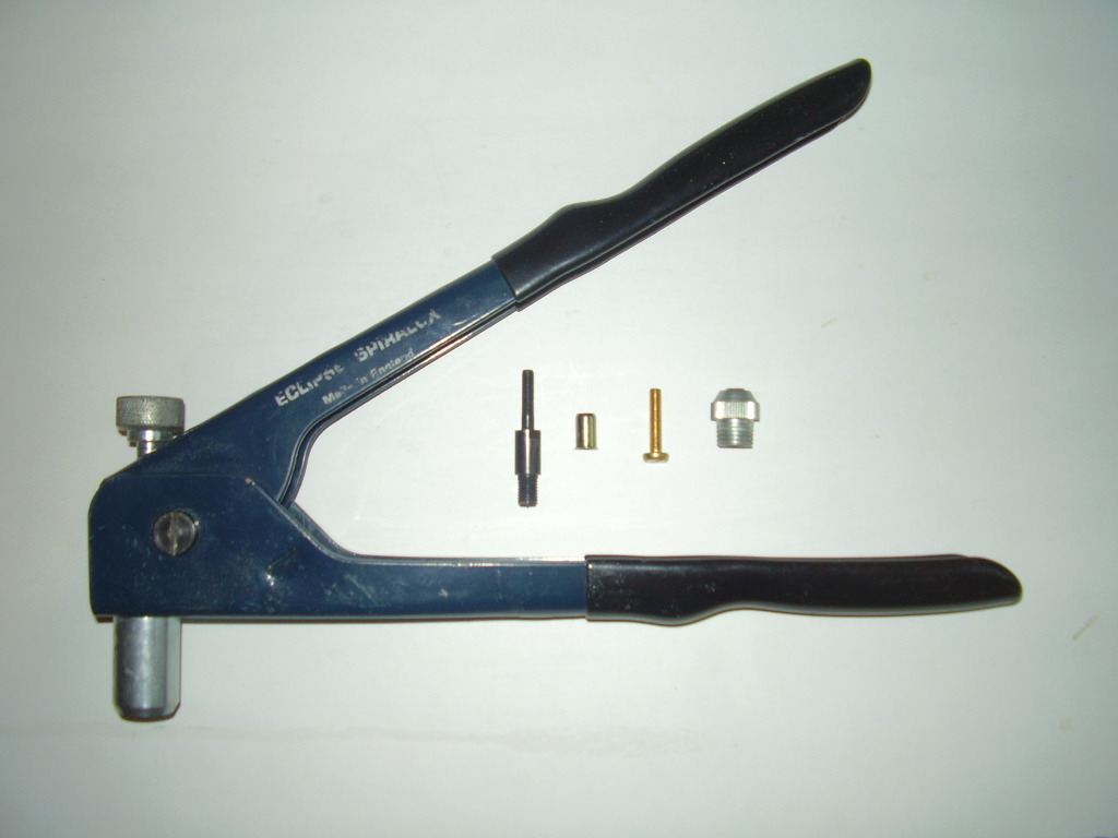

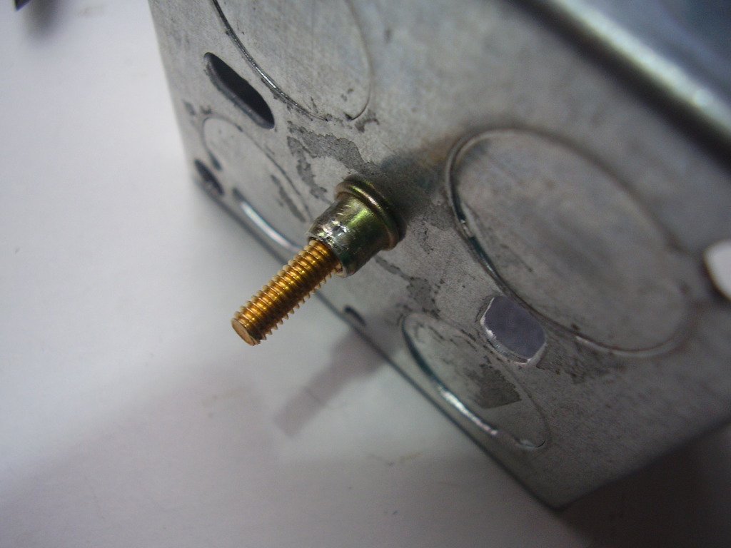

Are you talking a rivnut / nutsert type tool? Magic bit of kit!
Used to add an earth point in a back box (original fooked):
