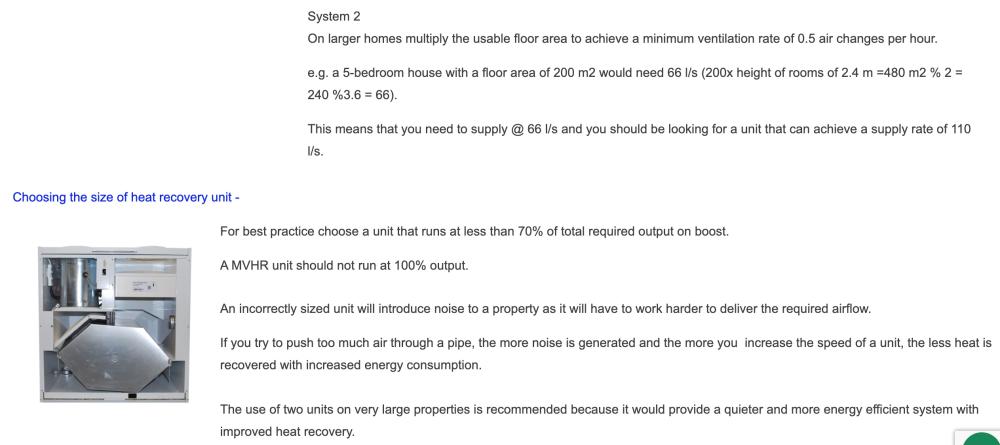

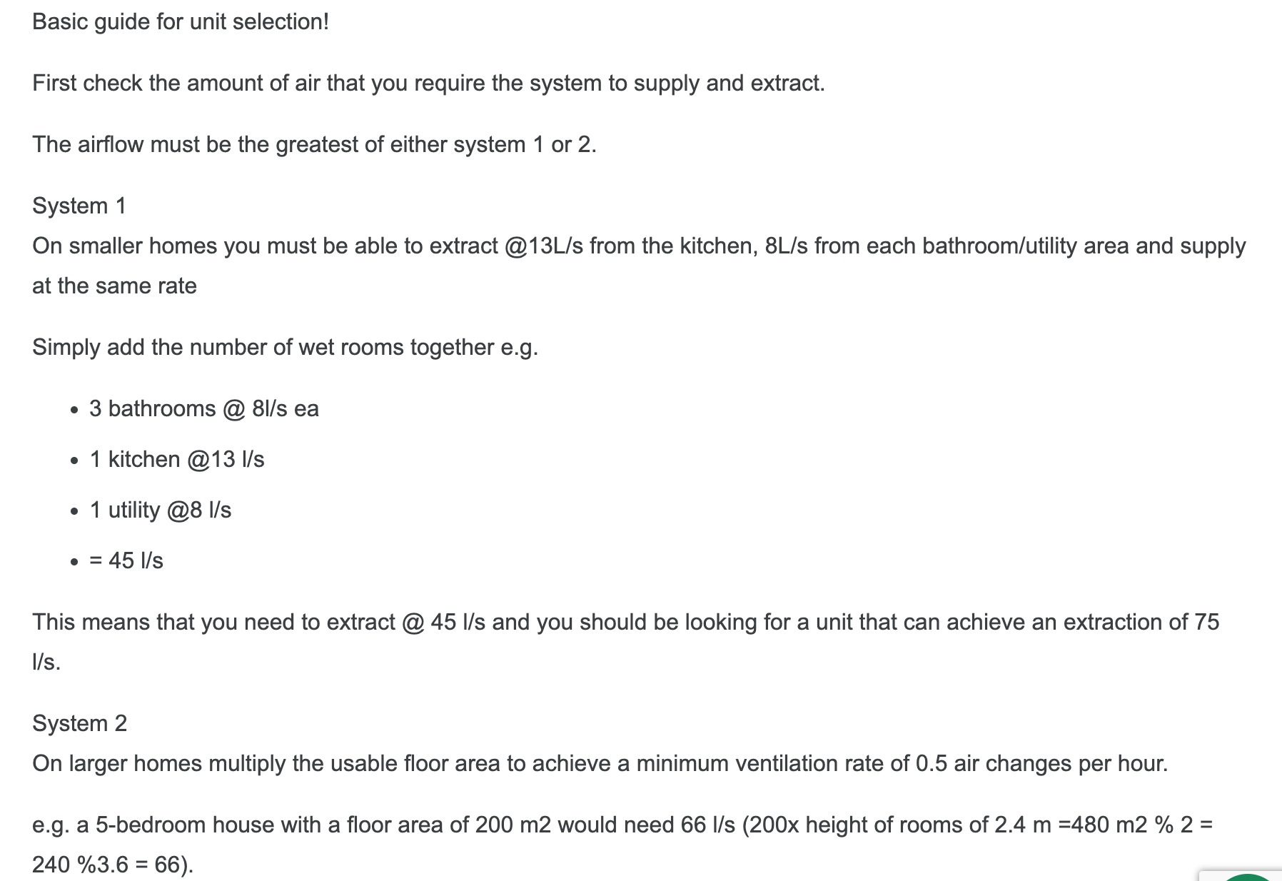

Johnny Jekyll Posted February 17, 2023 Author Posted February 17, 2023 Progress update - After Zehnder tech guy strongly advising not installing the MVHR in our cold loft, we are now going to re-design it into the ground floor utility room. We've had two supply quotes (new build 127m2, other details about the property at the top of this thread). Installing ourselves. Quote 1 - BPC (free design) using a Vent-Axia Sentinel Kinetic BH system (up to 150m), with 75mm semi-rigid ducting. Quote 2 - Green Building Store (paid design) using a Zehnder ComfoAir Q350 Pre-Heater, with 90mm semi-rigid ducting. Our experience so far with both companies has been great. Green Building Store is twice the price, due to the design fee and of course much more expensive Zehnder unit. I'd like your opinions as to whether the paid design and bigger Zehnder passive unit are worth it - what would you do if this was your house? -- Is the Zehnder unit overkill for a 127m2 3-bed property like this? -- How would the paid design help me? I pretty much know where the ducts must run (not many options), noise from so called pressure drops etc may be unavoidable (my understanding is pressure drops = noise)? -- Fellow self-builders on here have built their own acoustic enclosures (I could also do that). -- Did you just install the damn thing with a design and accept the final outcome after commissioning? How much science is behind the design? Thanks everyone. So many decisions to make on your own, friendly opinions would really help.

Johnny Jekyll Posted February 18, 2023 Author Posted February 18, 2023 (edited) Thanks @crispy_wafer and @Susiefor the feedback. Looks like the Vent-Axia Advance S you mention use 125mm ducts instead of the bigger 160mm ducts that the Zehnder unit uses. Cool, hadn't looked at that unit. So did you simply get simple layout plans and equipment lists? Then just get on with it? Feel like I just want to do that rather than keep worrying about all the exacting design theory. I'm pretty good at following best practice and my work is very neat. I just wish someone would grab me by the scruff and say get on with it! I've also started reading about the filters, which seem to make a big difference. Seems tests can produce much better (manipulated) results if coarse G4 filters are used, rather than the much better F filters. I guess that's where the (more expensive) Passive Zehnder type units come into their own. Still nice and quiet when using better filters. This stuff is never easy! Edit: It's also ridiculous that Vent Axia units come with 5 year warranty and Zehnder units just a 2 year guarantee (talk about a put off). I take that back, Zehnder seems to have an extendable warranty as long as you replace filters as per their terms. Edited February 18, 2023 by Johnny Jekyll
Mike Posted February 18, 2023 Posted February 18, 2023 On 17/02/2023 at 19:24, Johnny Jekyll said: Is the Zehnder unit overkill for a 127m2 3-bed property like this? It depends on your objectives and in what way are you think it may be overkill. FWIW I'm planning to install a Zehnder ComfoAir200 in a 40m² apartment, which you could call overkill. However it's suitable for several reasons: I can minimise noise by keeping the fans pretty slow under all normal conditions, it's one of the best performing units that I can fit in the limited space available, and I need a good intelligent summer bypass. Plus, by shopping around, I can get it for an acceptable price. I'll be feeding it with 125mm ducts - you don't have to use 160mm with Zehnder if you don't need the extra airflow. You can find independently evaluated performance figures for the Zehnder unit in the Passihaus List. You can't do a you can't do a direct comparison with the Vent-Axia unit; they haven't had units evaluated so as you're reliant on their own figures. 1
crispy_wafer Posted February 18, 2023 Posted February 18, 2023 1 hour ago, Johnny Jekyll said: So did you simply get simple layout plans and equipment lists? Just the quote/equipment list, then thought thanks for the unit suggestion, bet I can do it better and cheaper. So I did. 1
ruggers Posted February 19, 2023 Posted February 19, 2023 Hi @Johnny Jekyll I'll post my experience so far and see if you can take anything from it. My supply rooms are: 4 x Bedrooms, 1 x living room, 1 x dining room. Extracts are: 2 x bathrooms, 1 x ensuite - Toilet sink no shower, 1 x boiler room which houses the boiler & cylinder & will double up as a drying room with UFH passing through it, 1 x kitchen, 1 x utility room. So for my build I contacted 4 companies, BPC was one of them, the other two i met at the home show and both were very similar in their quotes for spec and price but I found one of them willing to discuss every option in detail much easier. BPC only offered design and supply, not commission being in Ireland. Their prices were good and they also mentioned something up that i need to look into in more detail which was how they recommend sizing the unit for my build. Something i will need to add a post for. The other two companies have told me that a Zehnder 350 is fine and BPC said that I'd need a 450Q or a Vent axia plus B. I need to know if the volume is calculated by ground floor and first floor total volume based on 2.4m ceilings, or by including the 250mm joist void into the calculation like my SAP did saying ground floor was 2.7m (250mm between intermediate floor). My floor space is 200m2. BPC didn't think a 350Q could run under 70% of full power on boost hence the need for a different or larger unit. Taking these comments back to the other designer, they provided an explanation are maintain that the 350Q is fine leaving me slightly confused. When i first made contact, I supplied my preferred locations for MVHR unit, the room plenum locations and my proposed duct runs. the companies seemed to be happy with my design & said it's pretty much where they'd put things too, but I may require an extra vent or two in some of my rooms and this would be calculated in a detailed design. It was due to me having more extracts than supplies. They discussed options of 125 or 160 vents, having 75mm or 90mm pipes. Because i want a very quiet running system I immediately opted for 90mm semi rigid ducting. BPC then said they'd always go with twin 75mm which was different again. A detailed design is going to cost around £700, i had 6 extracts and 5 supplies, I've now been told I will require 7 extracts and 7 supplies, for my large 24m2 living room they will look at the option of either 2 supplies or 2 ducts to one plenum. I'd like to use 90mm ducting. The kitchen diner requires a supply where as I'd only included the extract at the kitchen end, & my larger main bathroom might require further extraction. I think it's possible with good self research to get a 90% efficient design, but as everything's fully enclosed once complete, I only get one chance, So i'm going to pay for the design to ensure everything's been considered by professionals, I'll do the full install to which they've listened to my suggestions and also highlights any bad ideas, then I'll pay for the £450 commissioning service to balance everything & complete the final set up. 1
