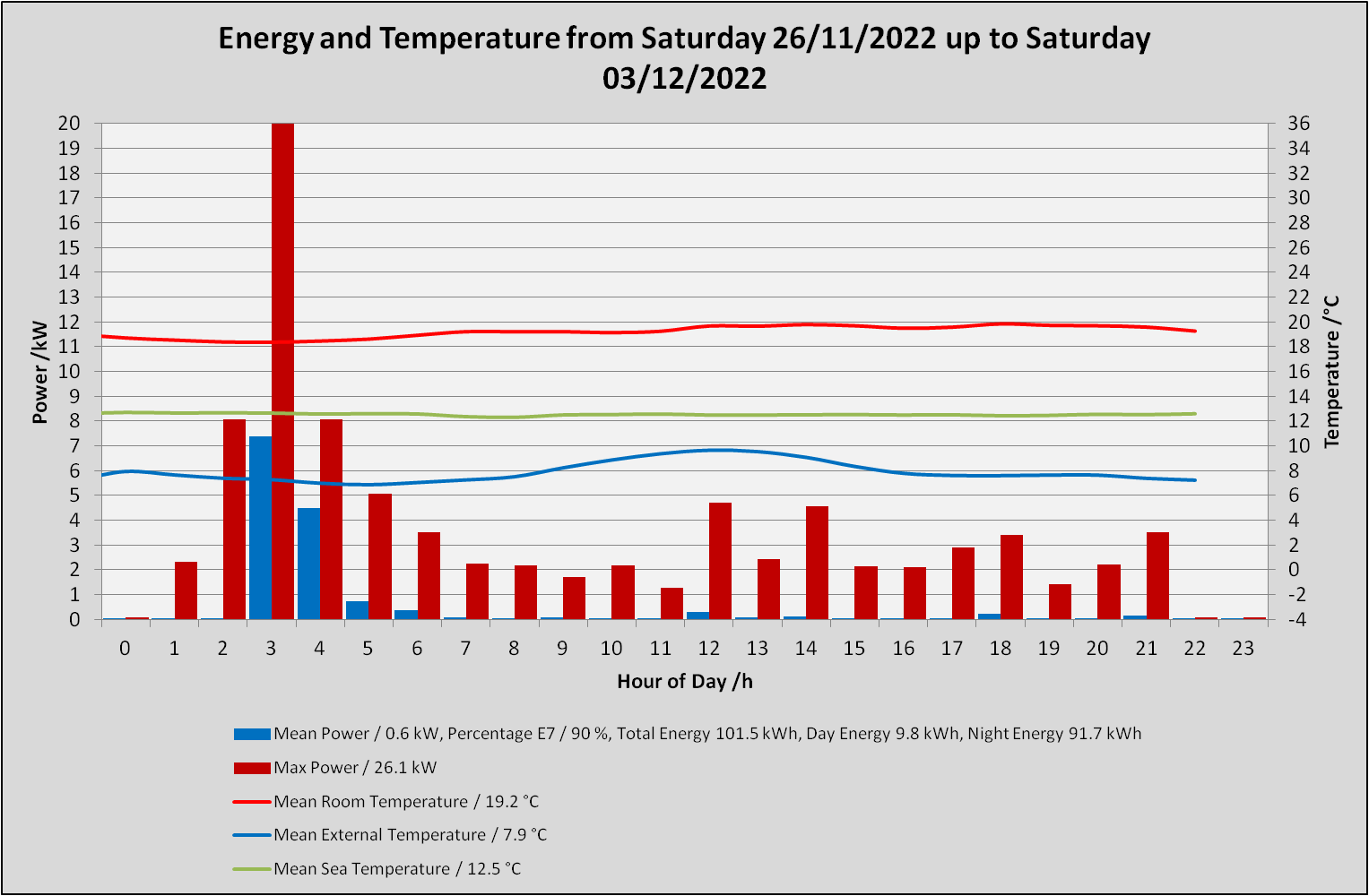

SteamyTea Posted December 3, 2022 Share Posted December 3, 2022 (edited) 3 hours ago, zoothorn said: And my understanding of why any heater would be designed to be excessively hot at the very time it's not wanted, still seems not just bizarre, but completely ridiculous, & totally wasteful; & I just can't see why anyone would deem this a worthy design. Look up Newton's Law of cooling, it is not linear. So to get usable thermal energy delivery later in the day, the stating temperature has to be high. The timing is nothing to do with the storage heaters, it is the time that the National Grid had deemed the most useful to them, and the power generators, to deliver cheap power. They can always have a heat pump fitted, I am sure they are eligible for a free one. Edited December 3, 2022 by SteamyTea Link to comment Share on other sites More sharing options...

ProDave Posted December 4, 2022 Share Posted December 4, 2022 As to why 5AM seems to be the hottest time. They start charging with heat about midnight, give or take a bit depending on where you are. They charge until the core has reached the required temperature as set by the input control. It is unlikely they will take the full 7 hours to fully charge, so about 5PM would be a likely time to reach peak temperature and then just maintain that until the E7 time finishes about 7AM. Of course a better control system would be to calculate the expected heat loss in the house in the next 24 hours, and from that calculate how much charge the heater needs, and adjust the start time so it finishes charging just as the off peak time finishes. That is boffin territory but at least one well known member here has a control system that does that calculation each night and does just that, adjusts the start time according to how much charge is needed. A simpler version would be just make the "input" knob adjust the start charge time, so at maximum it would start at midnight, at minimum it might not start until 5AM and then it would charge until the off peak time ends. I doubt even the new posh electronic ones even do anything as useful as that. Link to comment Share on other sites More sharing options...
SteamyTea Posted December 4, 2022 Share Posted December 4, 2022 (edited) 45 minutes ago, ProDave said: A simpler version would be just make the "input" knob adjust the start charge time, so at maximum it would start at midnight, at minimum it might not start until 5AM and then it would charge until the off peak time ends. Basically what @TerryE does automatically, and I do manually on my timers. Blue Columns Edited December 4, 2022 by SteamyTea Link to comment Share on other sites More sharing options...

SteamyTea Posted December 4, 2022 Share Posted December 4, 2022 Quite simply, if the storage heaters are overheating first thing in the morning, and are not heating during the late afternoon and evening, they are undersize (either though wrong usage of controls or actual physical capacity). Yet again, temperature is being mixed up with power and energy. They are different things. Learn the difference, it is three things to learn, not difficult. Link to comment Share on other sites More sharing options...
