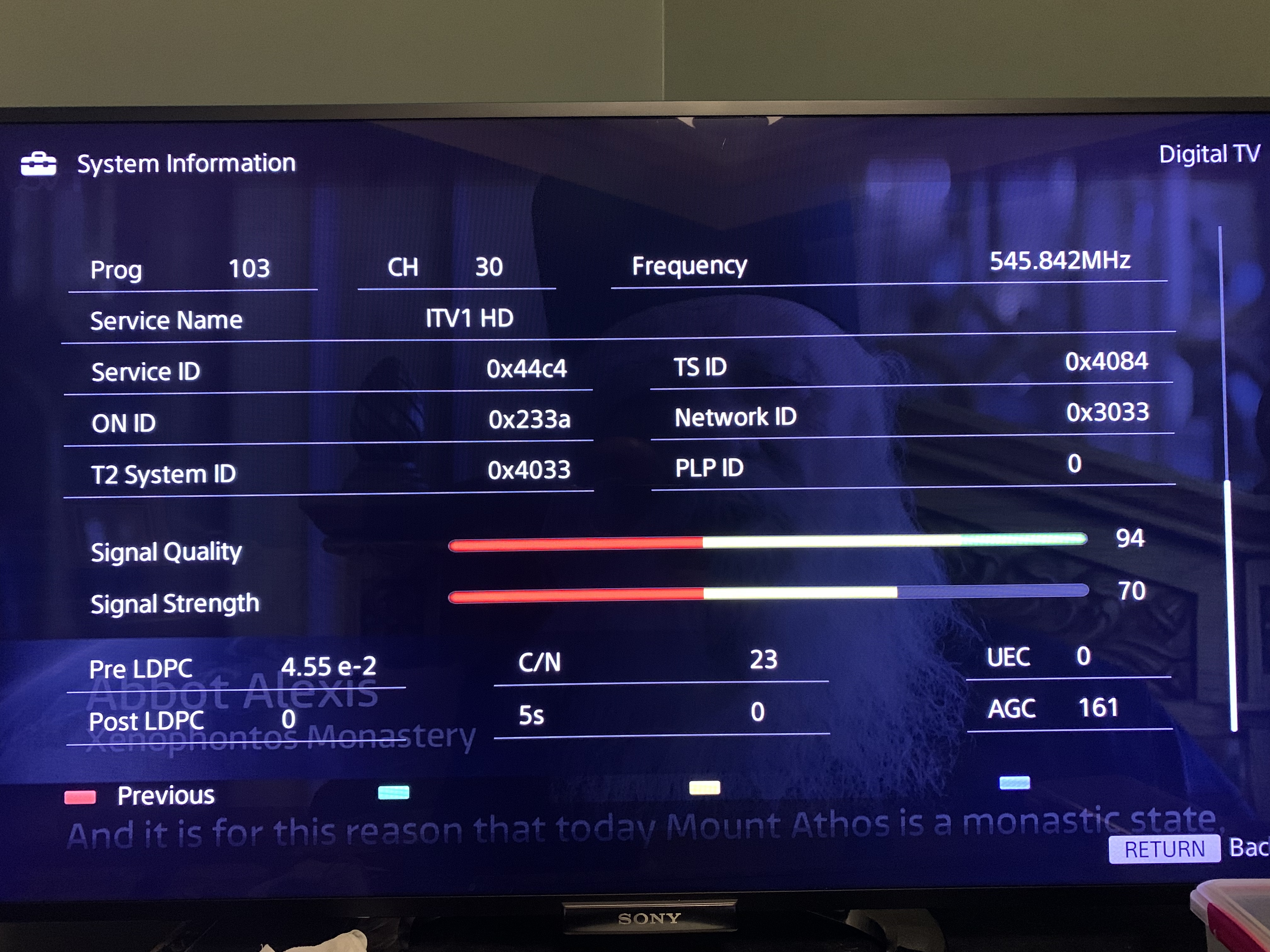

ProDave Posted December 1, 2022 Posted December 1, 2022 Find the appropriate menu on your tv to show signal strength and quality. It is is marginal, then it only takes a small dip in signal or a bit of electrical interference to break up the signal. It is all or nothing, there is no such thing like in the old days of the picture gradually getting worse as the signal drops.

Adsibob Posted December 1, 2022 Author Posted December 1, 2022 1 hour ago, ProDave said: Find the appropriate menu on your tv to show signal strength and quality. the signal quality actually fluctuates between 90 and 100, though mostly stays at 97 or 98. The signal strength stays at 70, no fluctuation. That is on ITV. On bbc it’s pretty much the same. The picture issue I’m having is on both channels. Any point in retuning my TV?

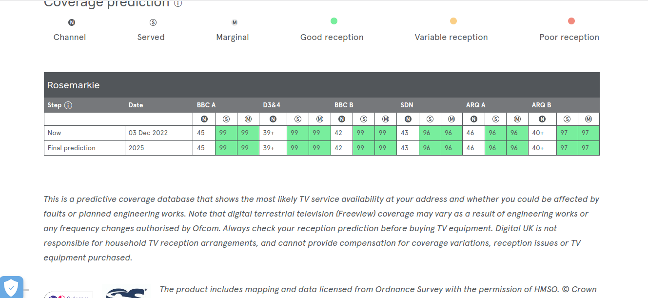

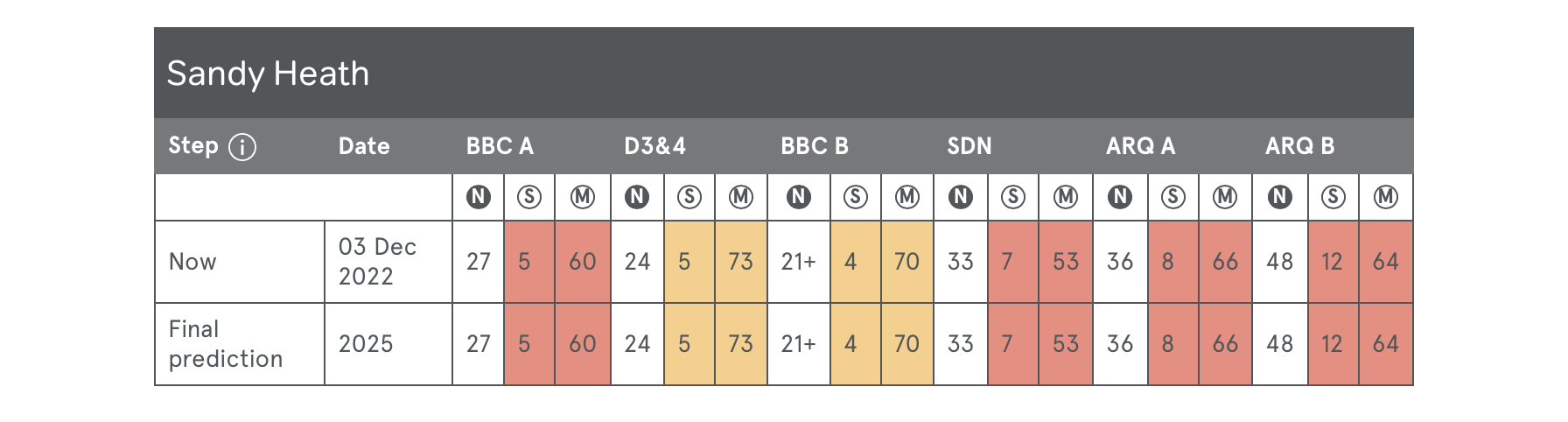

ProDave Posted December 2, 2022 Posted December 2, 2022 Your signal is pretty weak. Can you do anything to improve it, bigger aerial, higher aerial, re align the aerial etc, or even try a different location for the aerial. What does the signal checker database say here? https://www.freeview.co.uk/corporate/detailed-transmitter-information
Adsibob Posted December 3, 2022 Author Posted December 3, 2022 15 hours ago, ProDave said: What does the signal checker database say here? https://www.freeview.co.uk/corporate/detailed-transmitter-information What exactly am I looking for on this database? When I put my postcode in (which is a part of London) it tells me that I can get lots of channels and the name of my closest transmitter.
ProDave Posted December 3, 2022 Posted December 3, 2022 After you enter your postcode, scroll down to this bit Main thing is do you get green for good reception?

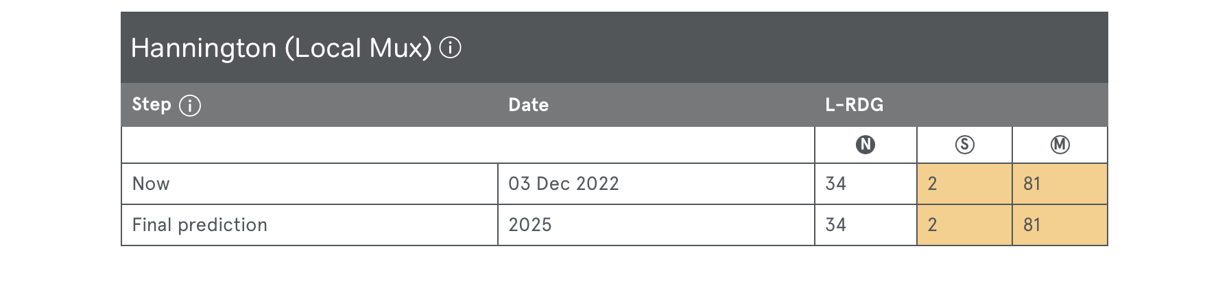

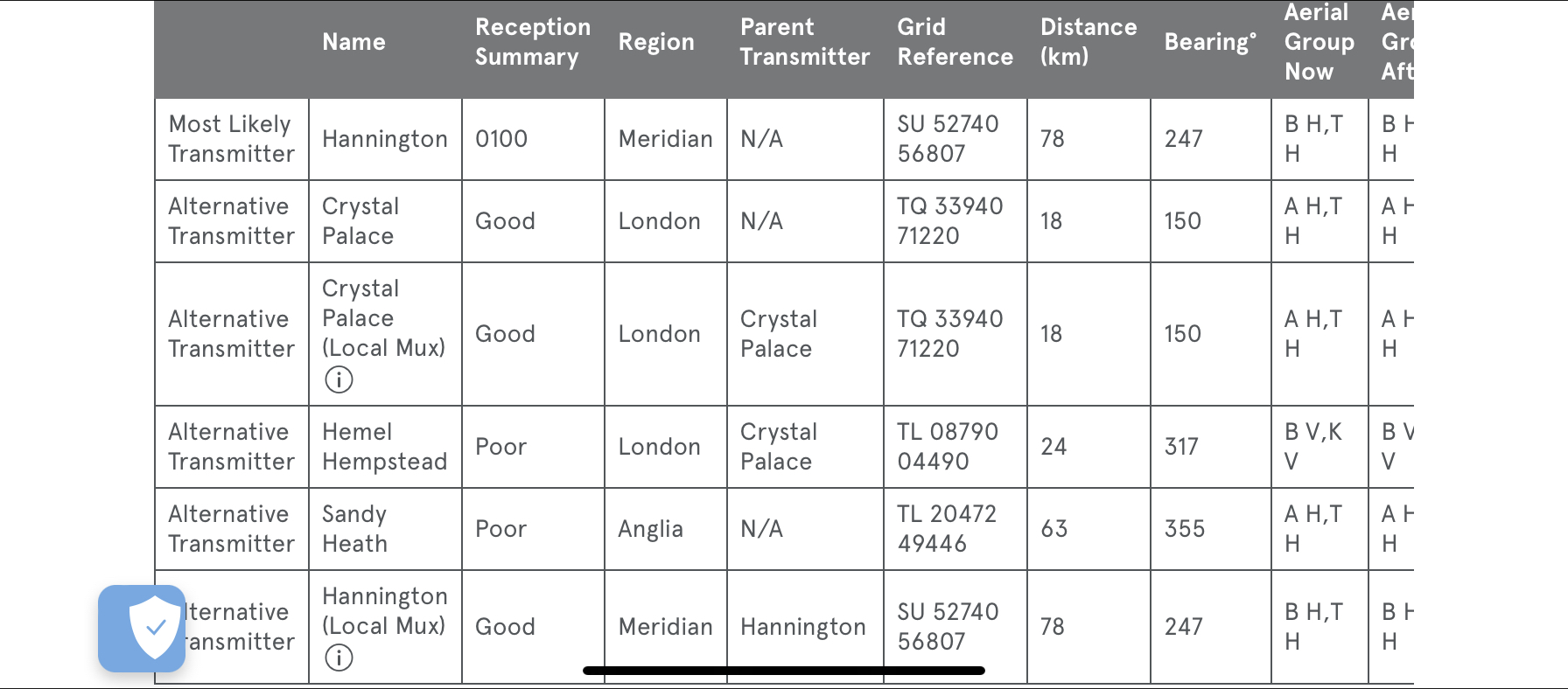

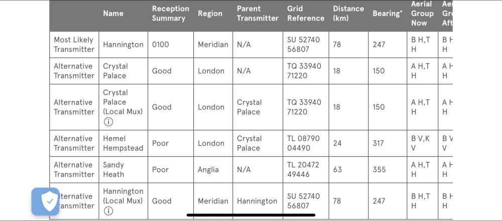

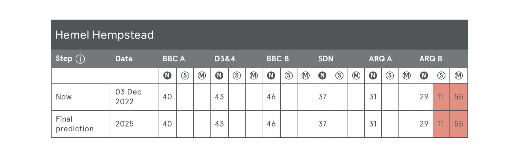

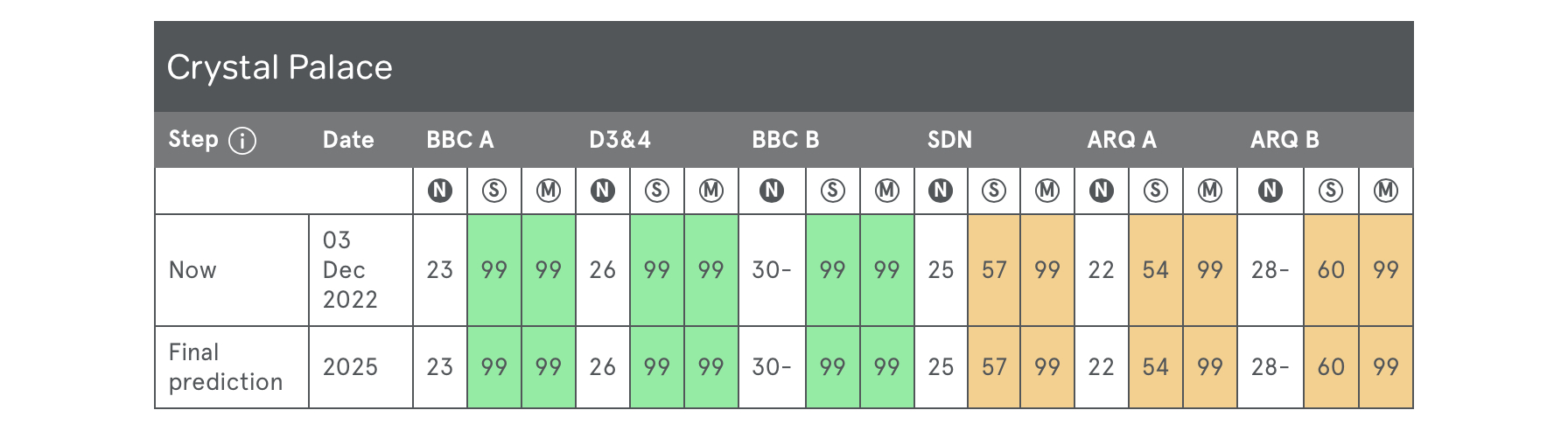

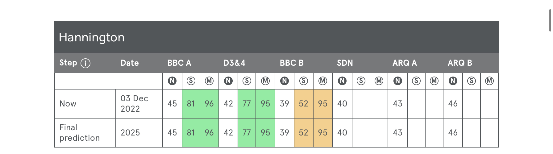

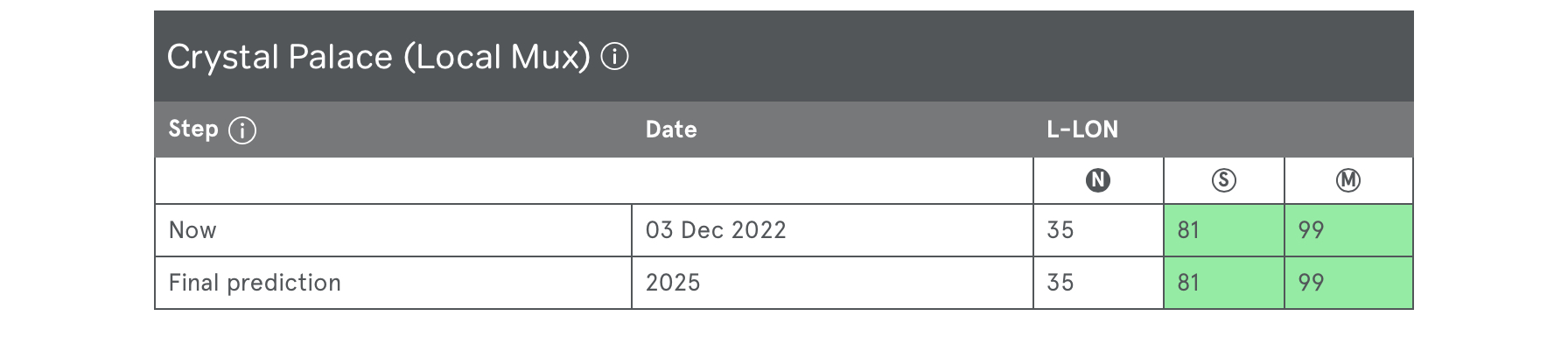

Adsibob Posted December 3, 2022 Author Posted December 3, 2022 ah, I missed the bit that said best viewed in landscape mode on my phone. Hmm, not seeing all green: Really surprising as I thought London would have good coverage.
Adsibob Posted December 3, 2022 Author Posted December 3, 2022 2 minutes ago, dpmiller said: so are you Crystal Palace then? According to the freeview site, my most likely transmitter is Hanwell, with Crystal Palace and “Crystal Palace (Mux)”, whatever that means, as two “good” alternatives.
ProDave Posted December 3, 2022 Posted December 3, 2022 So which direction is your current aerial pointing? (approximate compass bearing)
Temp Posted December 3, 2022 Posted December 3, 2022 You mentioned you have an amplifier. That can make the signal strength reading on the TV misleading. The signal from the aerial could be a lot weaker but it's being boosted by the amplifier. Unfortunately amplifiers boost noise as well as the signal. It would be worth trying a temporary direct connection to the aerial with no branches off to other outlets just to see what the baseline signal is like. Maximise reception like that first. If the signal from the aerial is good then use a distribution amplifier with low/modest modest gain to provide the other outputs. High gain amplifier shouldn't really ever be needed. It's better to fit a bigger aerial or if it's already massive fit a mast head amplifier. Unfortunately there are loads of possible reasons for reception problems but always best to start with the best aerial set up you can't get.
