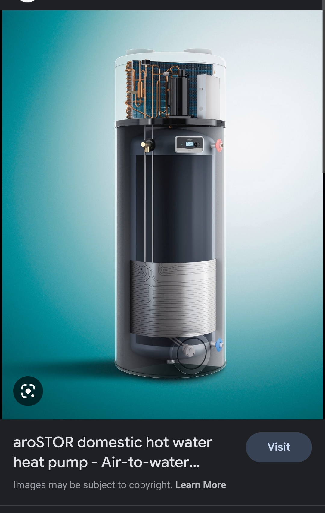

Iceverge Posted January 15, 2023 Posted January 15, 2023 You can get exhaust air heat pumps for DHW only. In fact the exhaust air heat pumps for space heating are a bit like trying to invent perpetual motion. The energy needs to come from somewhere! Here's an example of a DHW ESHP. You get excellent COP with the elevated temps that the heat pump can harvest. A2A or stove heating the air means you'll get air to water heat pump running costs without all the plumbing trouble and cost.
