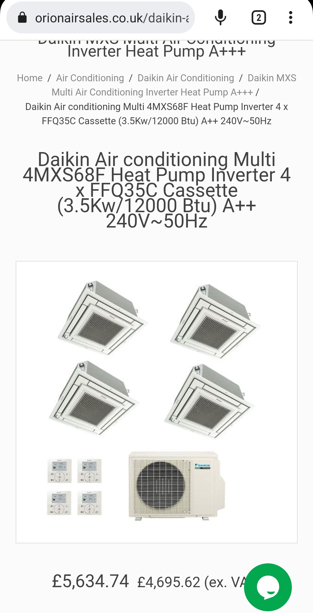

    I can see that 3phase and off grid are probably not the way forward. What is an multi split air to air system, who supplies those?                                                                                  Sutton lane site plan 2 (1).pdf

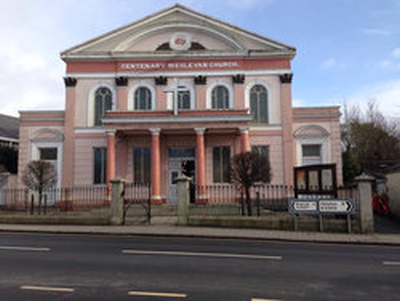

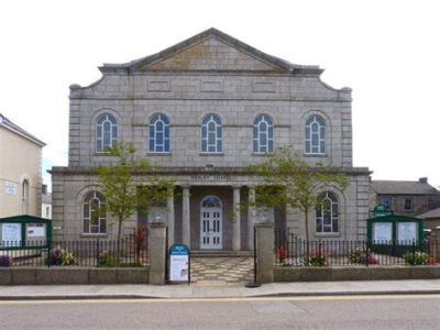

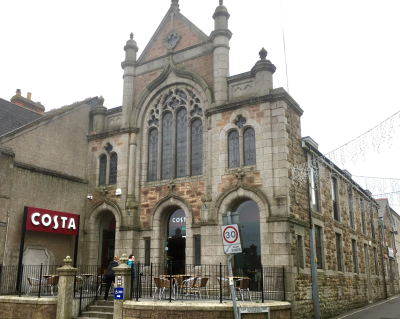

You seem to have focused on the inside space, but do you want it to look like a Methodist Chapel, or a generic village hall, or worse, fit in with the local vernacular?
Most Methodist Chapels down here have a very grand frontage, then 'tin shed' built behind then.
If you want to take advantage of PV, and I think you should, most of the front should become PV modules, that will make a really big statement.
Just make sure the Cross does not cast a shadow.  So avoid porches, trees and street lamps/telegraph poles that could cast shadows as well.
3 Chapels in a town in I avoid.
OK, that last one has become a community hub.
They're heat pumps but only heat the air directly rather than water, sometimes called A2A on here.
They're fast response, cheap, offer excellent heating and cooling performance if you pick the right model.
Where space heating is the bulk of the energy requirement they make a lot of sense. They're in almost every commercially building.
