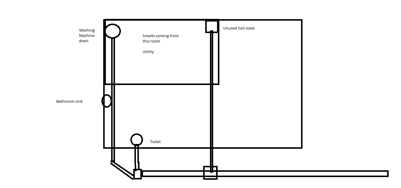

Alwayslearning22 Posted November 24, 2022 Posted November 24, 2022 Anyone have any idea why when I flush my toilet, my utility room stinks of sewage. This only happens for a few mins and then the smell disappears again. I have a washing machine in there and a boxed in soil pipe that’s unused was supposed to be for an ensuite. could the washing machine trap be getting sucked out? when I check the trap it’s got water in it though.
ProDave Posted November 24, 2022 Posted November 24, 2022 Check the unused boxed in soil pipe, is it properly capped possibly with an AAV? 1

ProDave Posted November 26, 2022 Posted November 26, 2022 Why not post some pictures of the pipework and what connects where, it might give someone a clue.
Alwayslearning22 Posted November 26, 2022 Author Posted November 26, 2022 Heres a plumbing layout if thats any use to you guys?
Nickfromwales Posted November 27, 2022 Posted November 27, 2022 It is symptomatic of a failed AAV. What does the stack do after it rises from the ground floor > bedroom?
Alwayslearning22 Posted November 28, 2022 Author Posted November 28, 2022 21 hours ago, Nickfromwales said: It is symptomatic of a failed AAV. What does the stack do after it rises from the ground floor > bedroom? It rises to the bedroom and is capped off. I had a look at it last year and it looked like a cap on it. Must be an AAV? Would it be standard practice to put an AAV on an unused stack like that?
