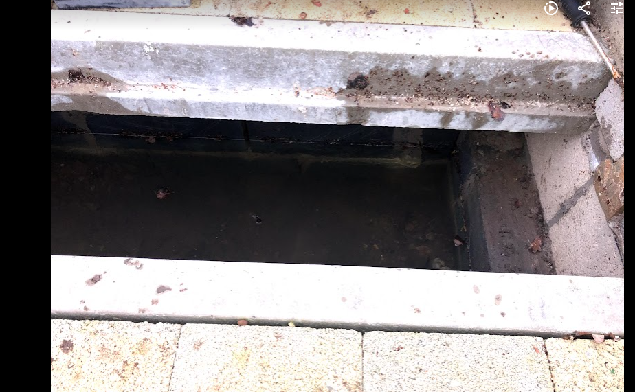

Andehh Posted November 21, 2022 Posted November 21, 2022 We are building a large bungalow, our garden has a slight incline to the peak of a hill above the property. Prob 5-7m total height change over 60m odd as we look out & up. Block & beam, with around 400-600mm space under the beams. Roof on, windows about to go in. Pretty heavy clay soil under a few feet of typical soil. What we seem to be getting is mysterious water appearing under the garage aspect of the house. I lifted up a block for the first time in a month, and found there to be about 4" of water trapped there - this has worried me as I expected it to be bone dry as the roof has been on for the couple of months since I last checked. I imagine rest of the place is similar though I cant check as UFH & screed is all in now. I am wondering if it could be a higher water table when it rains heavily, or water flowing down the hill in the soil and then seeping into some of the blocks and puddling under the floor? There back garage wall is very wet from lack of roof guttering, so it would be getting in via this way as well. Air flow is 'fine' to the sub floor - ie; not perfect as we lost a couple of air bricks due to patio changes, but there is still free flowing air in & out to all cavities under the house. No space is without air flow. Is this normal? How do average builds built over winter (like today when we have had 2cm of rain....) cope with the water getting under there and being trapped? Damp proof was all immaculately installed & maintained, so no risks there.. I'm not sure what I am worried about, just dont like the idea of water underneath? Has anyone ever thought about this themselves? Many thanks in advance

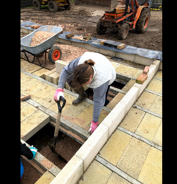

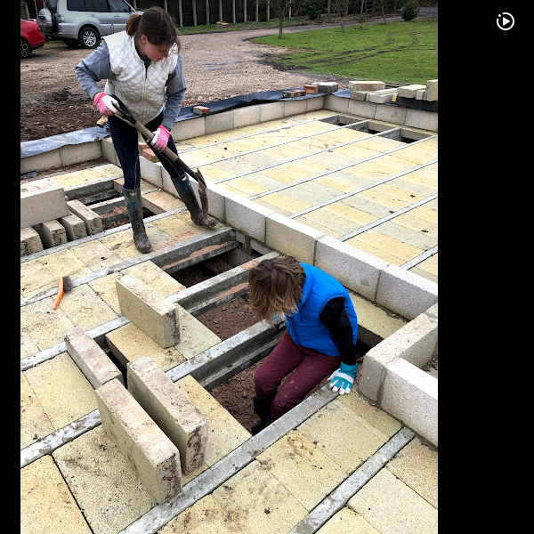

crispy_wafer Posted November 21, 2022 Posted November 21, 2022 ours was the same, however, the areas where the water was pooling /gathering was around the edges where the builder hadn't filled in. I know I live in an area that has quite a variable water level, due to slow draining ground more than anything. I figured the water ingress was seepin in between or through the trench blocks and via the openings that had been created for the service ducts etc. I spent a weekend lifting the blocks on the b&b floor, then on the tractor loading wheelbarrows whilst the missus and boy spread MOT under the beams (Looks bloody good, and when I had to go tunneling for a lost hammer, i didnt come out covered in mud, so that was a bonus). The builder thought I was mad for doing so quite honestly, they dont tend to bother with these details. It looks a lot better, and for the sake of a few hundred pounds worth doing and justified in my mind. I've also put in some drainage around the property about 10m away or so from the build over the last year or so, basically 4ft deep trenches wrapped and filled with 4-6" limestone chunks leading off to a drainage ditch. Just to give the water somewhere to go. Logically once your DPC, and DPM is down your habitable area is a damp proof box, and going about things as slowly as I have, I've seen the seasons pass, dry and wet alike and not seen or noticed any issues. All is good, and I have no worries. These was taken after a wet spell, albeit we had no walls or roof at the time, so it was likely to puddle... Lifted them blocks more times than I care to remember. 1 1

Andehh Posted December 2, 2022 Author Posted December 2, 2022 The water is only a couple of inches so actually sits within the foundations, below the block surrounds, so no real way to drain it out. I will prob try & pump it out, and see if it returns. We are 4/5 the way up a hill, so in theory water should be draining down & away, as our ground water cant be that high, I hope!!
