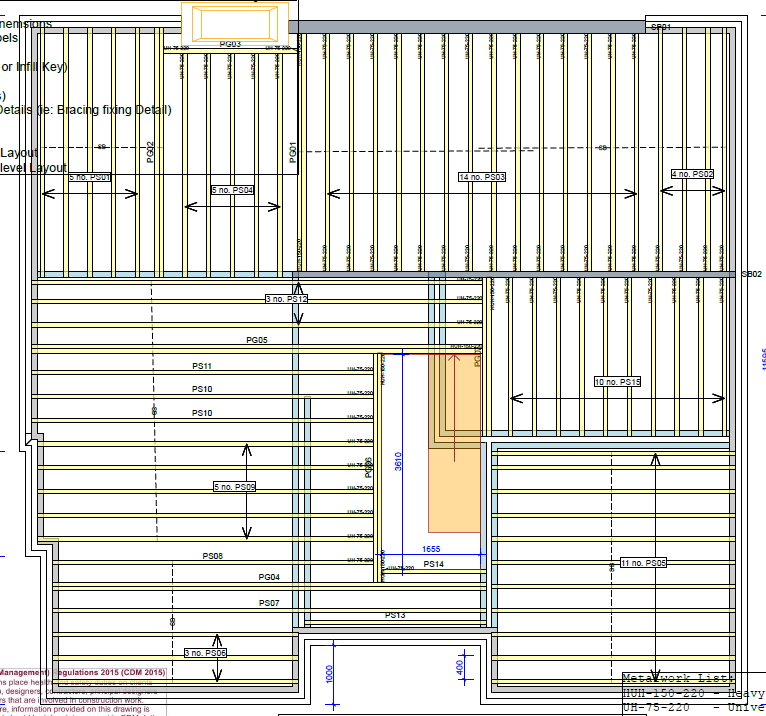

richo106 Posted November 20, 2022 Share Posted November 20, 2022 Good Morning The builders have finally started on our project and all being well will be up to first floor height in couple weeks (weather dependant) To help with times and cost I will be installing the joists along with my joiner mate The joists will be 225mm deep and the plan/layout (see attached) I have from the joist company is too drop the joists on the inner block work. Is this the best method to do this? We are focussing on air tightness also so was going to ask builders to point around the joists (I am happy to sort after aswell) but is there to consider when installing them? Daft question: - Do the builders leave a gap to drop them in or do I drop them all in first so they can brick around them? Are they heavy enough to stay square or do they need some kind of fixing? Would people wait until all steel beams in place or take measurements from the blues/drawings? The drawing is slightly wrong as the beam for bi fold is lower so joists will run on top of that? My only concern if we wait until everything in place then it will hold everything up 4 weeks while waiting for delivery Any advice/information greatly appreciated Cheers Link to comment Share on other sites More sharing options...
ProDave Posted November 20, 2022 Share Posted November 20, 2022 Make sure the brickies do NOT build up the end walls (the walls the joists are not resting on) You will need the ends clear to slide the strong backs into the joists. Only when those are in can the brickies build up higher. 2 Link to comment Share on other sites More sharing options...

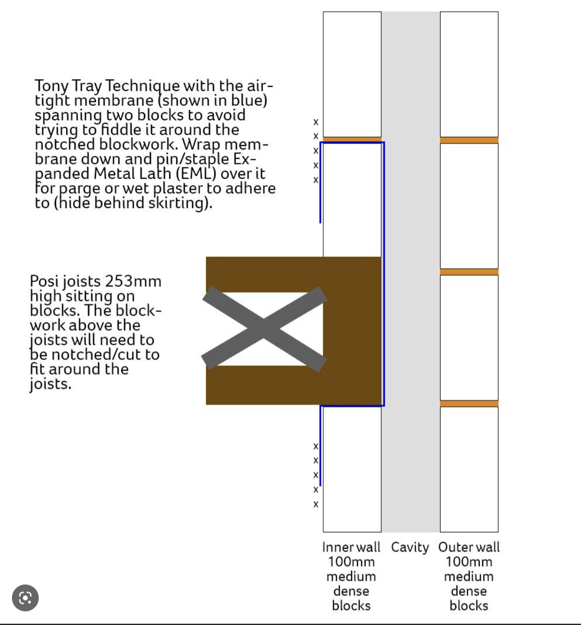

Thorfun Posted November 20, 2022 Share Posted November 20, 2022 consider a Tony tray for your air tightness around the joists. https://forum.buildhub.org.uk/search/?&q=Tony tray&quick=1&search_and_or=and&sortby=relevancy 1 Link to comment Share on other sites More sharing options...

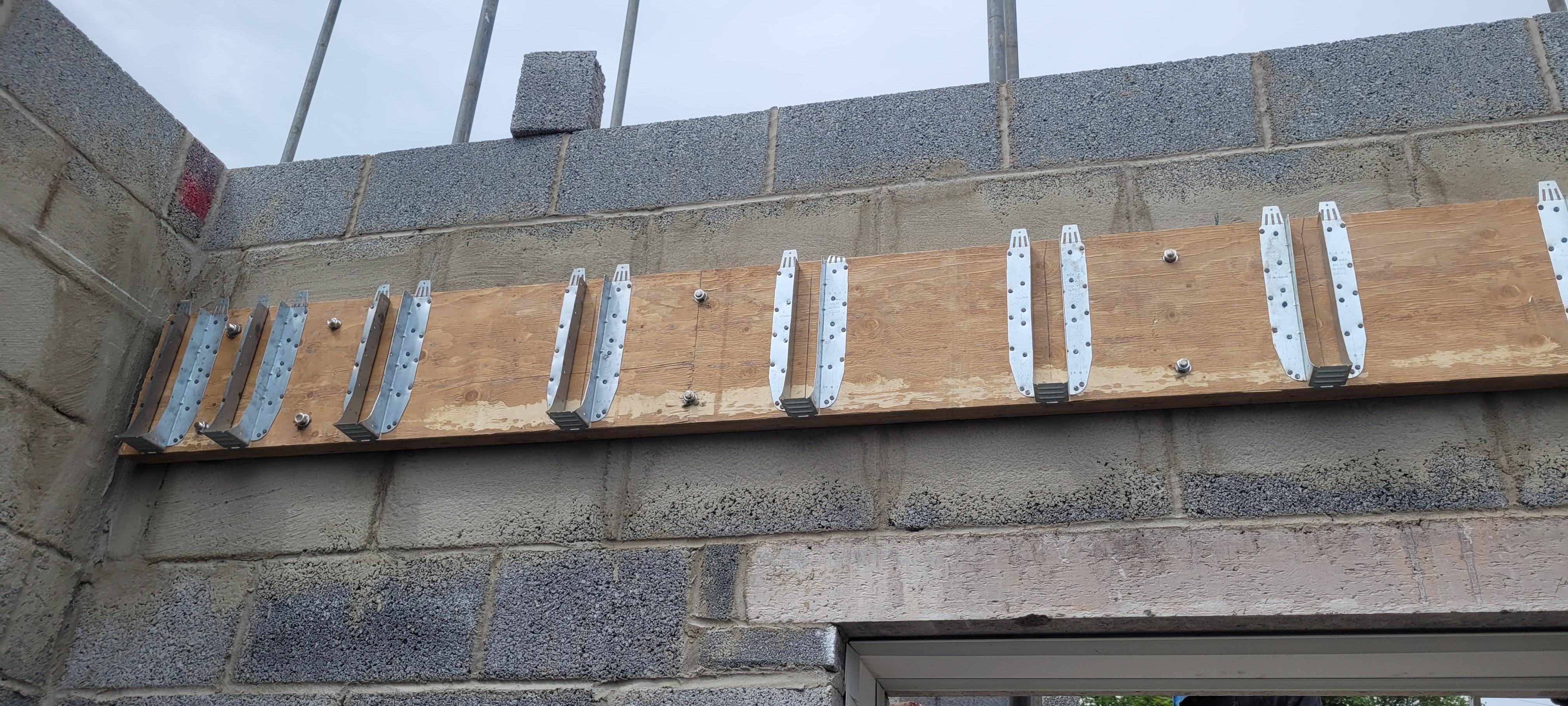

Miek Posted November 20, 2022 Share Posted November 20, 2022 Pocketing the joists Into the wall is bad for airtightness. A Tony tray works. Or resin fix a ledger to the walls (after parging) and hang joists on hangers 3 Link to comment Share on other sites More sharing options...

Miek Posted November 20, 2022 Share Posted November 20, 2022 I didnt find it much work to fit the ledgers, just nail on the hangers before lifting them. Fixings are just 12mm studs 2 every 800mm ( I just guessed this spacing) . I love resin anchors, but they are slower In the winter. If your webs are open and you need strongbacks I can see the difficulty. Mine were osb closed web so no strongbacks. Link to comment Share on other sites More sharing options...
richo106 Posted December 19, 2022 Author Share Posted December 19, 2022 We are finally getting to the point when we will be installing the first floor joists. Originally I was just going to rely on good pointing/good workman ship to overcome the airtightness issues with joists sitting on the inner lead blocks. however re-visiting this aspect I am leaning towards the Tony tray method. Could anyone recommend some material/size of material to use? I am using the picture attached (from BH) as a guide, I know this is a daft question but could anyone also recommend tacks please Many Thanks Link to comment Share on other sites More sharing options...

Canski Posted December 20, 2022 Share Posted December 20, 2022 9 hours ago, richo106 said: We are finally getting to the point when we will be installing the first floor joists. Originally I was just going to rely on good pointing/good workman ship to overcome the airtightness issues with joists sitting on the inner lead blocks. however re-visiting this aspect I am leaning towards the Tony tray method. Could anyone recommend some material/size of material to use? I am using the picture attached (from BH) as a guide, I know this is a daft question but could anyone also recommend tacks please Many Thanks I like this idea. I must admit that in 40 years of bricklaying I’ve never been asked to do it. Every day is a school day. It’s a bit of work with the mesh but I was wondering if it was modified to a 50 mm down stand sealed against the blockwork with CT1 for example would it be as effective. Also on the top we normally fill level with the top of the joists before restarting. This could then be sealed to the masonry and lapped over on to the joists and fitted below the flooring. Just a thought. as far as the manthorpe units go they seem a bit pricey and I would need a few different sizes to cover the end of various width joists. Link to comment Share on other sites More sharing options...
