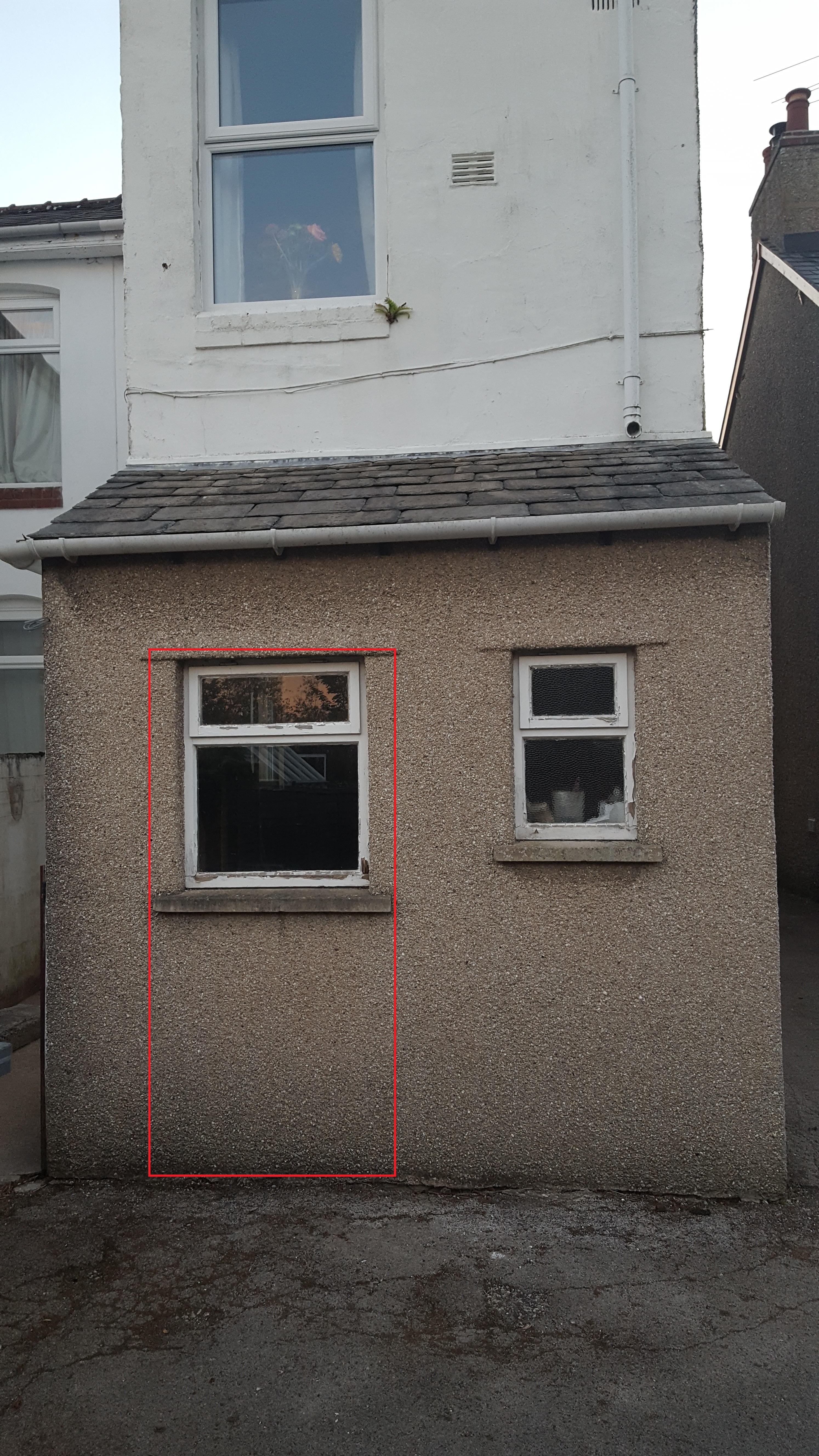

iSelfBuild Posted July 2, 2017 Share Posted July 2, 2017 I only have 100mm to play with to fit a lintel to the underside of my utility room tiny lean to roof. I was going to go for a 6" concrete lintel but I don't have the room. The door is only 840mm wide. Can anyone recommend the type of lintel I need for a solid wall? My Dad said I only need one on the internal skin that supports the roof wall plate. Do I also need to do structural calculations for building control or will the inspector just agree it's way overkill and not ask. Like I said the roof is TINY!!! Link to comment Share on other sites More sharing options...

PeterW Posted July 2, 2017 Share Posted July 2, 2017 1 minute ago, iSelfBuild said: Pretty sure all the ones posted are not sufficient, you need a few course of brick above for them to be effective? Two questions .. - what is above the lintel..? - are the joists parallel to or landing on the lintel ..? will help to advise the correct choice . Link to comment Share on other sites More sharing options...
iSelfBuild Posted July 2, 2017 Author Share Posted July 2, 2017 Above the lintel will be a timber wall plate, it looks like 3x2 or something (not crashed it out yet) the rafters go directly onto it. See the picture attached. All though the door will go virtually up to the gutter. Link to comment Share on other sites More sharing options...
PeterW Posted July 2, 2017 Share Posted July 2, 2017 Is that a single skin wall ..?? Assuming those are 600 centre's and only one joist lands on the lintel then you could get away with a Naylor ES1 65mm lintel. Link to comment Share on other sites More sharing options...

Russell griffiths Posted July 2, 2017 Share Posted July 2, 2017 The thinner 100mm concrete prestressed lintel will be way overkill. No load on that at all Link to comment Share on other sites More sharing options...
Nickfromwales Posted July 2, 2017 Share Posted July 2, 2017 4 minutes ago, Russell griffiths said: The thinner 100mm concrete prestressed lintel will be way overkill. No load on that at all Yup. It's a no brainer. 100mm bearing ( overhang ) each side and Roberts your Mothers Brother. You could quite happily get away with a timber head tbh, it's really doing nowt. Link to comment Share on other sites More sharing options...
Declan52 Posted July 2, 2017 Share Posted July 2, 2017 A 65mm/100mm pre stressed concrete would carry that no bother many times over. Link to comment Share on other sites More sharing options...
iSelfBuild Posted July 3, 2017 Author Share Posted July 3, 2017 Fantastic. Will building control be OK with that? They will be inspecting it. Link to comment Share on other sites More sharing options...
PeterW Posted July 3, 2017 Share Posted July 3, 2017 Yep - no issue with a pair (one inside and one out) as allows you to change the door in the future Link to comment Share on other sites More sharing options...

PeterW Posted July 3, 2017 Share Posted July 3, 2017 Pair of 1050's if they do them or 1200's if not Link to comment Share on other sites More sharing options...
iSelfBuild Posted July 3, 2017 Author Share Posted July 3, 2017 Cheers guys, will they be OK with 100mm bearing. Thought it had to be 150mm? Link to comment Share on other sites More sharing options...
