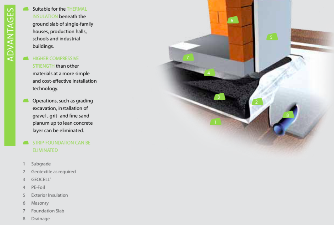

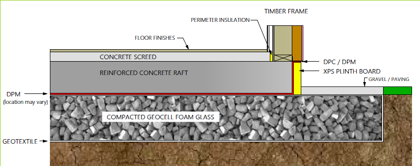

Adrian Walker Posted November 15, 2022 Posted November 15, 2022 12 hours ago, Russdl said: @George thanks for the offer but I’m not in the market yet. Any insight you can share from using it? Details for foamed glass foundations attached. GEOCELL-Foundation-Details.pdf 1
Russdl Posted November 15, 2022 Author Posted November 15, 2022 Thanks for that @Adrian Walker most useful (and I see the DPM does maker an appearance, no worries) 1
Adrian Walker Posted November 15, 2022 Posted November 15, 2022 4 minutes ago, Russdl said: Thanks for that @Adrian Walker most useful (and I see the DPM does maker an appearance, no worries) To be honest with a garage you don't need a screed.
Russdl Posted November 15, 2022 Author Posted November 15, 2022 14 minutes ago, Adrian Walker said: To be honest with a garage you don't need a screed. Spooky! That was my next question! (trawling through the Mikewye website now). My fermenting plan is to use the Geocell as per the image above, then build the garage/workshop in block off the raft, then use EWI to insulate the whole - questions seeking guidance regarding all that will be on their way in a separate post. (I've already been persuaded to go for UB steels for the roof)
