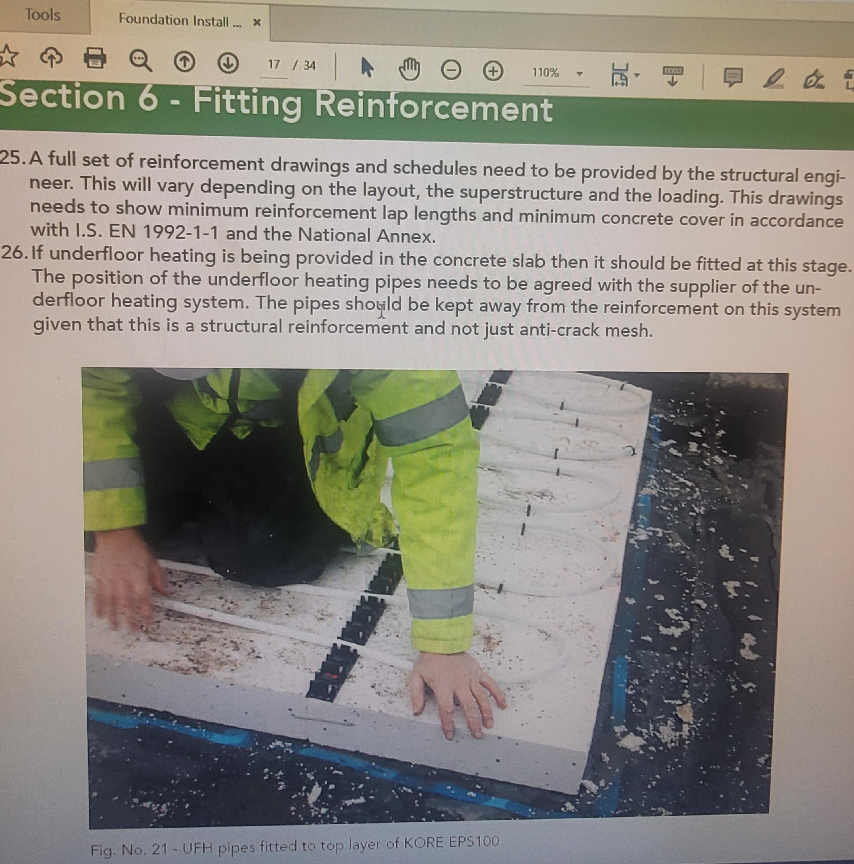

JackofAll Posted November 8, 2022 Posted November 8, 2022 OK, so recently tried to price an all in one package(Ashp, tank and uf heating kit) but the crowd won't quote as cable tying pipes to mesh in insulated raft does not meet their spec. Just to clarify I mentioned that we didn't need pipe tracks when submitting the plans as we were cable tying to pipes. Was subsequently told that you can't do that not just by supplier but also by two plumbers? Now I believe these guys have never worked on insulated raft before and are just used to clipping to insulation. Did check out Kore raft fitting instructions and they say that pipes are not be be attached to mesh as it's structural in purpose. The 2 plumbers mentioned that fitting pipes in screed will be quicker to heat up than in concrete. Am confused.
JohnMo Posted November 8, 2022 Posted November 8, 2022 I purchased all my UFH kit from Outsourced energy. Just buy what you need. The floor would be quicker to heat in a thin screed, but only if the insulation is directly below the screed, if it has to heat up the concrete below also it will be no quicker than in the concrete. UFH isn't a radiators system it is slow, suits a heat pump as it can used at very low temperature for a long period. Many on here have directly attached to the mesh. Not really understanding Kore's statement on the mesh being structural as that has nothing to do with the UFH pipes. UFH seems complicated when you first look at it. But is quite simple when you actually get into the nuts and bolts of it. Download a free copy of loopcad. That will develop a plan for you to give to the plumber. Your piping centers can be just about anything you like, I did 300mm, most do 150-200mm. Do loops no more than 100m long. Once you have a plan, you will have piping quantity, number of loops for you manifold etc. Get a low temp mixer/pump such as an Ivar. 1
JackofAll Posted November 8, 2022 Author Posted November 8, 2022 9 minutes ago, JohnMo said: I purchased all my UFH kit from Outsourced energy. Just buy what you need. The floor would be quicker to heat in a thin screed, but only if the insulation is directly below the screed, if it has to heat up the concrete below also it will be no quicker than in the concrete. UFH isn't a radiators system it is slow, suits a heat pump as it can used at very low temperature for a long period. Many on here have directly attached to the mesh. Not really understanding Kore's statement on the mesh being structural as that has nothing to do with the UFH pipes. UFH seems complicated when you first look at it. But is quite simple when you actually get into the nuts and bolts of it. Download a free copy of loopcad. That will develop a plan for you to give to the plumber. Your piping centers can be just about anything you like, I did 300mm, most do 150-200mm. Do loops no more than 100m long. Once you have a plan, you will have piping quantity, number of loops for you manifold etc. Get a low temp mixer/pump such as an Ivar. Thanks John, see below from Kore, will look into loopcad. 1
JohnMo Posted November 8, 2022 Posted November 8, 2022 You could do what they show or staple. Use Pert-al-pert pipe as it is easy to form, straightens easily and bends well by hand. 1

Nick Laslett Posted November 9, 2022 Posted November 9, 2022 (edited) On 08/11/2022 at 11:11, JackofAll said: Thanks John, see below from Kore, will look into loopcad. @JackofAll, that is a great find. I knew from TDS Ltd’s drawings for the Kore foundation, that he wanted the UFH stapled to the EPS. It would have also helped with ICF wall prop fixings having the pipes deeper. I had my foundation installed by a Kore recommended installer. They do the insulated foundations for MBC Timber Frame. Their preference was to cable tie the UFH to the top of the mesh, which is what they did. See picture in other thread. Our slab was 150mm thick. We also have a 100mm poured concrete 1st floor. We fixed the UFH to the EPS, under the reinforcing mesh. Big fan of LoopCAD. Lots of video tutorials. Also gives heat loss calculations, very detailed. Edited November 9, 2022 by Nick Laslett
JackofAll Posted November 9, 2022 Author Posted November 9, 2022 (edited) 4 hours ago, Nick Laslett said: @JackofAll, that is a great find. I knew from TDS Ltd’s drawings for the Kore foundation, that he wanted the UFH stapled to the EPS. It would have also helped with ICF wall prop fixings having the pipes deeper. I had my foundation installed by a Kore recommended installer. They do the insulated foundations for MBC Timber Frame. Their preference was to cable tie the UFH to the top of the mesh, which is what they did. See picture in other thread. Our slab was 150mm thick. We also have a 100mm poured concrete 1st floor. We fixed the UFH to the EPS, under the reinforcing mesh. Big fan of LoopCAD. Lots of video tutorials. Also gives heat loss calculations, very detailed. Just curious Nick where mesh is overlapped x 2 or3 what was the solution as the top of pipe would be very close to finished floor level. Having trouble opening loopcad as it's an exe file, haven't tried on laptop yet thought only phone so will see. Edited November 9, 2022 by JackofAll

Nick Laslett Posted November 9, 2022 Posted November 9, 2022 (edited) 1 hour ago, JackofAll said: Just curious Nick where mesh is overlapped x 2 or3 what was the solution as the top of pipe would be very close to finished floor level. Having trouble opening loopcad as it's an exe file, haven't tried on laptop yet thought only phone so will see. This is a good question. I think in places we did have 3 sheets of mesh overlap. The ducting for the hot water pipes actually created the highest points for the mesh. We have a 150mm thick slab, the mesh is sitting at 50mm, 16mm of UFH on top of the mesh. I measured the highest point, where there was mesh, UFH and duct. This was 110mm, leaving only 40mm of clearance. Most of the foundation the height of mesh and UFH was 85mm. Is this enough clearance? Probably not. Edited November 9, 2022 by Nick Laslett
