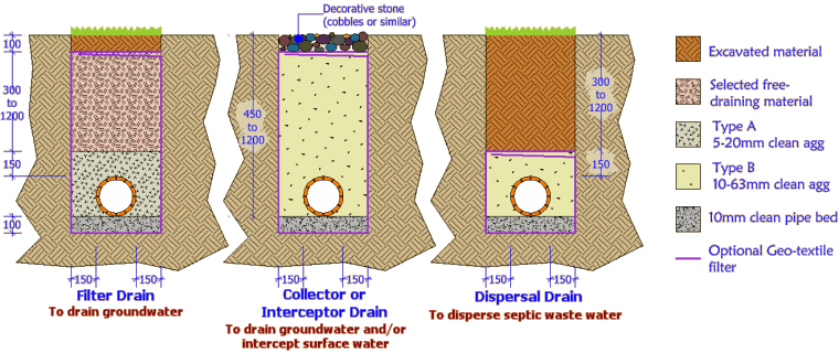

ruggers Posted November 6, 2022 Posted November 6, 2022 I have a site that needs cleared to build on which will require some underground 100mm perforated drainage pipe installed as it sits lower than a neighbouring plot & both have historically been wet woodland. The top soil and sub soil seem to vary between 300-450mm (12 to 18") and then its the clay. Questions: 1. Do I install the drainage pipe onto the top of the clay as this is the lowest point? 2. People have different methods of installing the pipe, which is best? (A) Dig the pipe trench, add a sock over the drainage pipe then surrounding it in stone and then cover with soil. (B) Digging a trench for the pipe, lining it with a geotextile membrane, lying the pipe into it surrounding with stone, and then wrapping the pipe & stone with the rest of the membrane. (A) Seems easiest & some say it works, others say, eventually that the soil works between the stones & clogs the sock sleeve & that (B) is the harder but best option to last a life time. I can't understand how the sock/membrane sheet could clog one way but not the other or is this personal preference?
Conor Posted November 6, 2022 Posted November 6, 2022 I went with B for our basement perimeter drain. Reason being that it will prevent your clean gravel from clogging up. The gravel does the work 90% of the time anyway, with just heavy rain needing the pipe to kick in, unless you've a high water table. It's easy enough. Just make sure your membrane is wider than it needs to be. 1

Temp Posted November 6, 2022 Posted November 6, 2022 Great site for all things paving and drainage. This is their page on French Drains. Perhaps bookmark their index https://www.pavingexpert.com/drain03#french Index https://www.pavingexpert.com/pavindex Option B would be the one on the left. The middle option is possibly better if it was all clay and you get standing water. Right hand one is for dispersing output of treatment plant. 1

saveasteading Posted November 7, 2022 Posted November 7, 2022 Option B without a doubt. As well as the point re silting up, the wet gravel is very attractive to tree and other roots, which would soon fill all the gaps. It is a pain to do and needs to be quite organised, but worth it. 1
