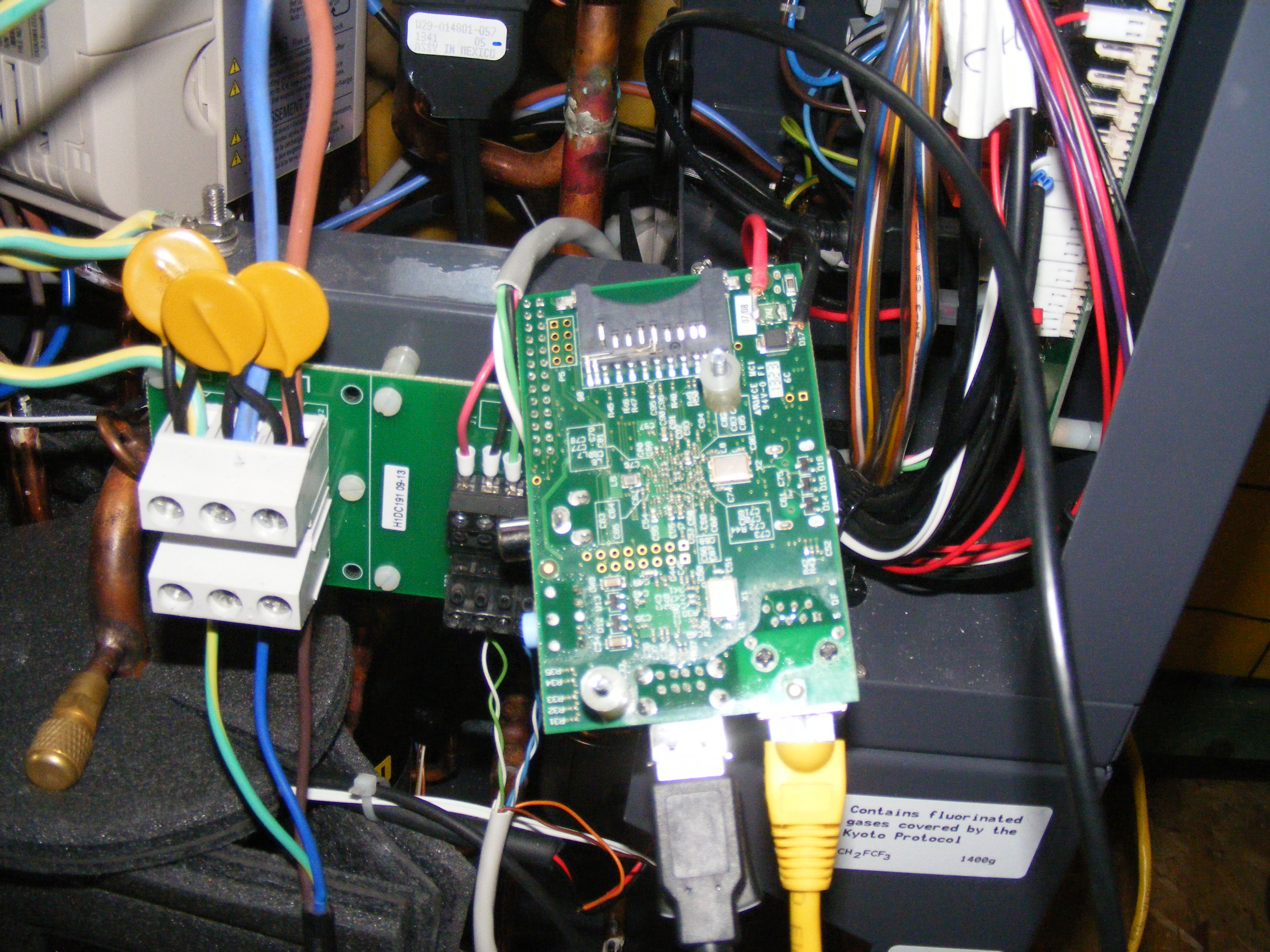

ProDave Posted June 30, 2017 Author Share Posted June 30, 2017 Okay, I have got to the bottom of the problem. Having had a look at the Raspberry Pi inside it, it's plain to see that there is no memory card plugged into it. No memory card = no software for the Pi to run. The wifi is (will) be provided by a usb "WiPi" adaptor plugged in. I am now discussing the missing memory card issue with the supplier...... Link to comment Share on other sites More sharing options...
Jeremy Harris Posted June 30, 2017 Share Posted June 30, 2017 Which version of the RPi is it? The early ones had a "click-click" card slot, and that was a bit notorious for pinging cards out a long way if the card was pressed and let go. The later models change to "push-pull" card slot, that is a lot less likely to ping the card out. I think it may be possible to ping the card out of an early RPi just from a bit of shock or vibration, so it could be the card was in there but has been pinged out. Link to comment Share on other sites More sharing options...
ProDave Posted June 30, 2017 Author Share Posted June 30, 2017 Here's a picture of the memory card slot I think if it had "pinged out" in transit, I would have found it rattling around in the bottom of the enclosure, but I have had a good look and can't find it. I am discussing the situation with the supplier at the moment but doubt I will get an answer until Monday. Link to comment Share on other sites More sharing options...
Jeremy Harris Posted June 30, 2017 Share Posted June 30, 2017 That's a RPi model A, which commonly had the "click-click" SD card slot, so it's possible that the card has pinged out. It's ten minutes work to burn a new bootable card, if they can send you the image file. Link to comment Share on other sites More sharing options...
