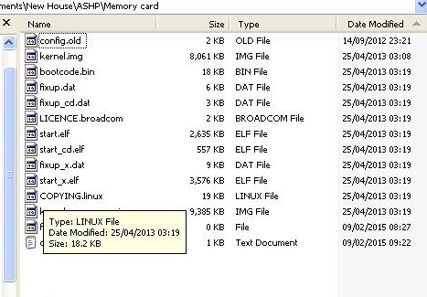

I have just had a look at the memory card (and taken a backup)  this is all that is on it:
That didn't work very well. I will try a better listing tomorrow, have to go now.......

You can't just copy the files from the card with a file manager in Windows.  Windows cannot see the Linux files on the card in the two other partitions, it can only see the boot partition usually, so they won't show up in something like file manager.  Also, this is a bootable SD card, with the operating system on it.
You can image (not copy) the SD card easily enough, either from the Linux command line (not recommended unless you know what you're doing, as it's possible to screw up) or by using an imaging tool.  For Linux and Windows there is an open source tool called Etcher that will so the job, but it's a bit clunky.  For Windows there's a free utility called Win32DiskImager that does a pretty good job.
These tools make an image of the SD card, complete with all the partitions (there will probably be three on that card).  This saved image can then be used to create another bootable SD card, using the same imaging tools, but in write, rather than read, mode.
So what you are saying is I can make an image and copy it under windows but I can't see what's on that copy using windows.
But if I then plugged that copy into the ubuntu laptop I would then be able to see what's on it?
Yes, Windows can't normally see all the partitions on  Linux boot device like this.  You can see all the partitions if you plug it into a Linux machine, but be careful, as this is a boot device.  If you just plug it into a Linux box the chances are that it will automount and all three partitions will come up in the file manager.  Linux doesn't always behave nicely when hot-unplugging devices, to it's worth remembering to unmount the device before unplugging it, just to be on the safe side.
Best to just image it first to be safe, as once you have an image file saved you can easily make a duplicate card.
Make an image of it and write it to a new card.  Then check the new card is working and 'archive' the old one (put the original in a safe place).
You can get utilities for Windows that can read Linux drives, but I have not found a good free one yet.
