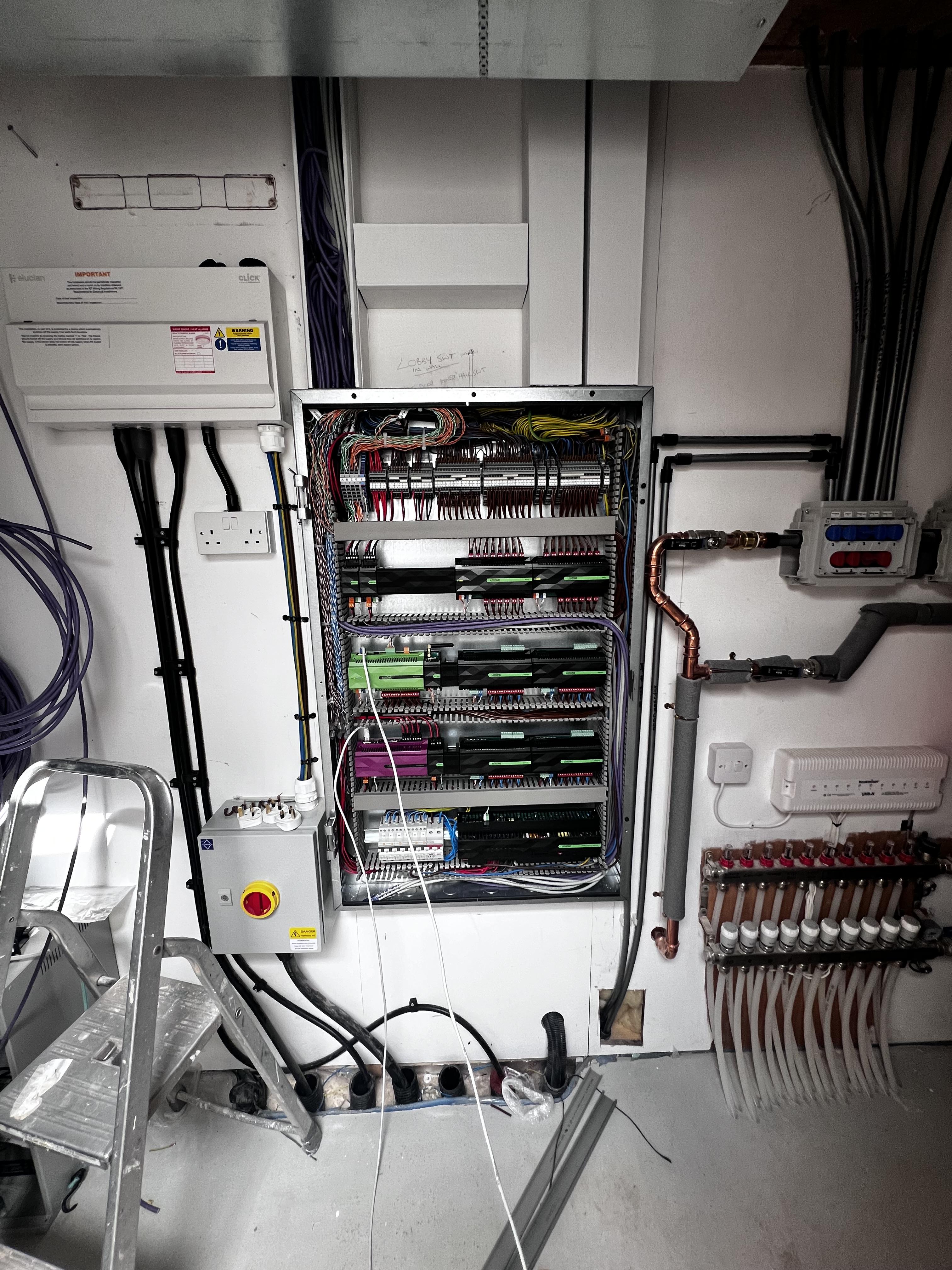

Thorfun Posted April 14, 2024 Author Posted April 14, 2024 put the new Loxone relay extension in and connected up the blinds to it and they just work. it was a good experiment trying the SSRs and I still have them if I want to use cheap relays for something else (maybe the wet UFH control when I get that set up?). cabinet is almost ready to put the covers on as there's not many more lighting circuits I can connect up at the moment. making a final push for BCO sign off in the next couple of months so need to make it all safe and get the electrics signed off. 2
Pocster Posted April 14, 2024 Posted April 14, 2024 2 hours ago, Thorfun said: making a final push for BCO sign off in the next couple of years so need to make it all safe’ish and get the electrics signed off. 1

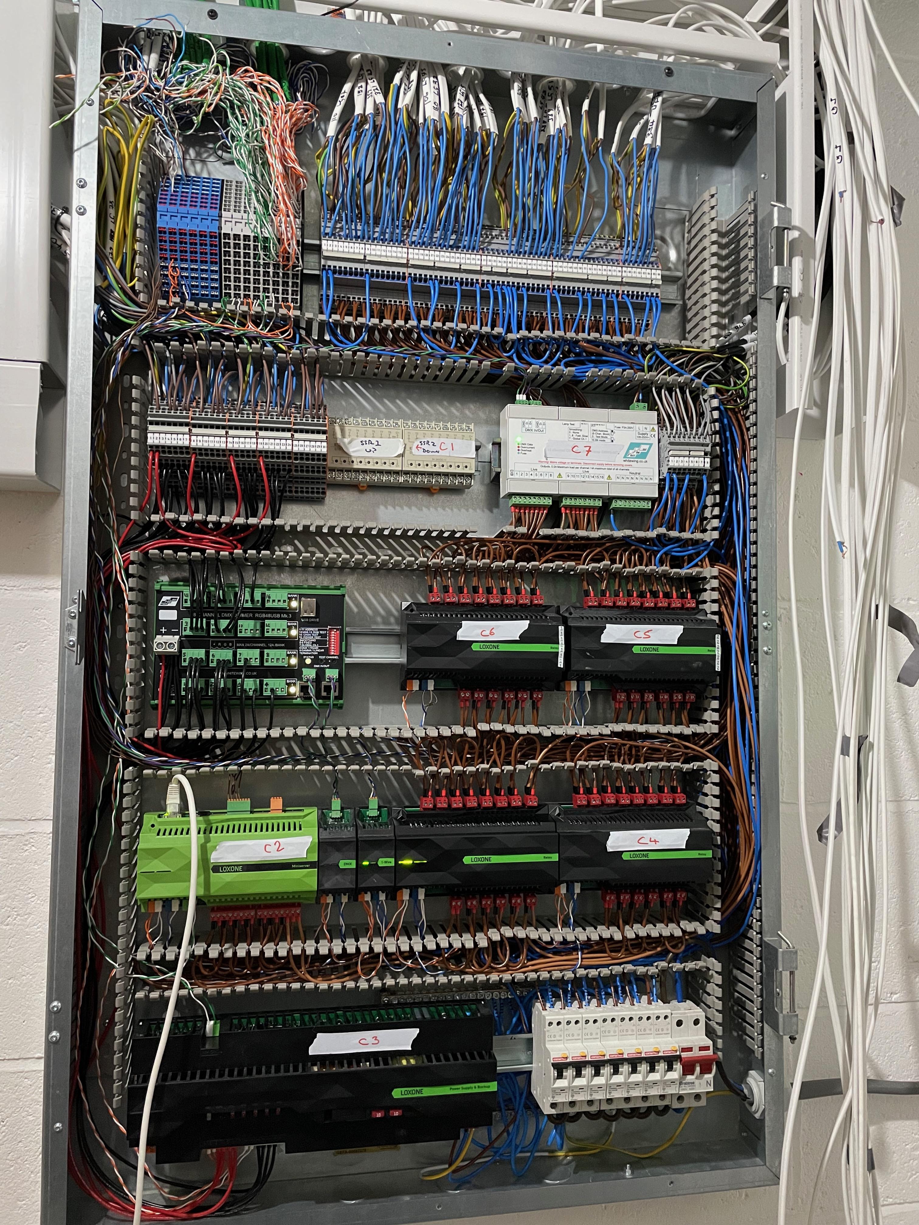

Kelvin Posted May 15, 2024 Posted May 15, 2024 (edited) Loxone panel up and running. Thanks to @Rob99 for the panel. Very neatly laid out with easy to follow instructions and easy for the sparkie and I to wire it up. Had a few cabling issues largely caused by a few things not yet connected, some cable wiring issues and a cable fault outside. Loads still to do as I’ve just quickly added all the devices to rooms and routed the lighting circuits. But at least we have lights Edited May 15, 2024 by Kelvin 4
Rob99 Posted May 15, 2024 Posted May 15, 2024 Thanks @Kelvin, you've installed that nicely in a very tight space 👍
Thorfun Posted May 15, 2024 Author Posted May 15, 2024 2 hours ago, Kelvin said: Loxone panel up and running. Thanks to @Rob99 for the panel. Very neatly laid out with easy to follow instructions and easy for the sparkie and I to wire it up. Had a few cabling issues largely caused by a few things not yet connected, some cable wiring issues and a cable fault outside. Loads still to do as I’ve just quickly added all the devices to rooms and routed the lighting circuits. But at least we have lights looking great! @Rob99's wiring is almost as neat as mine! 🤣 1

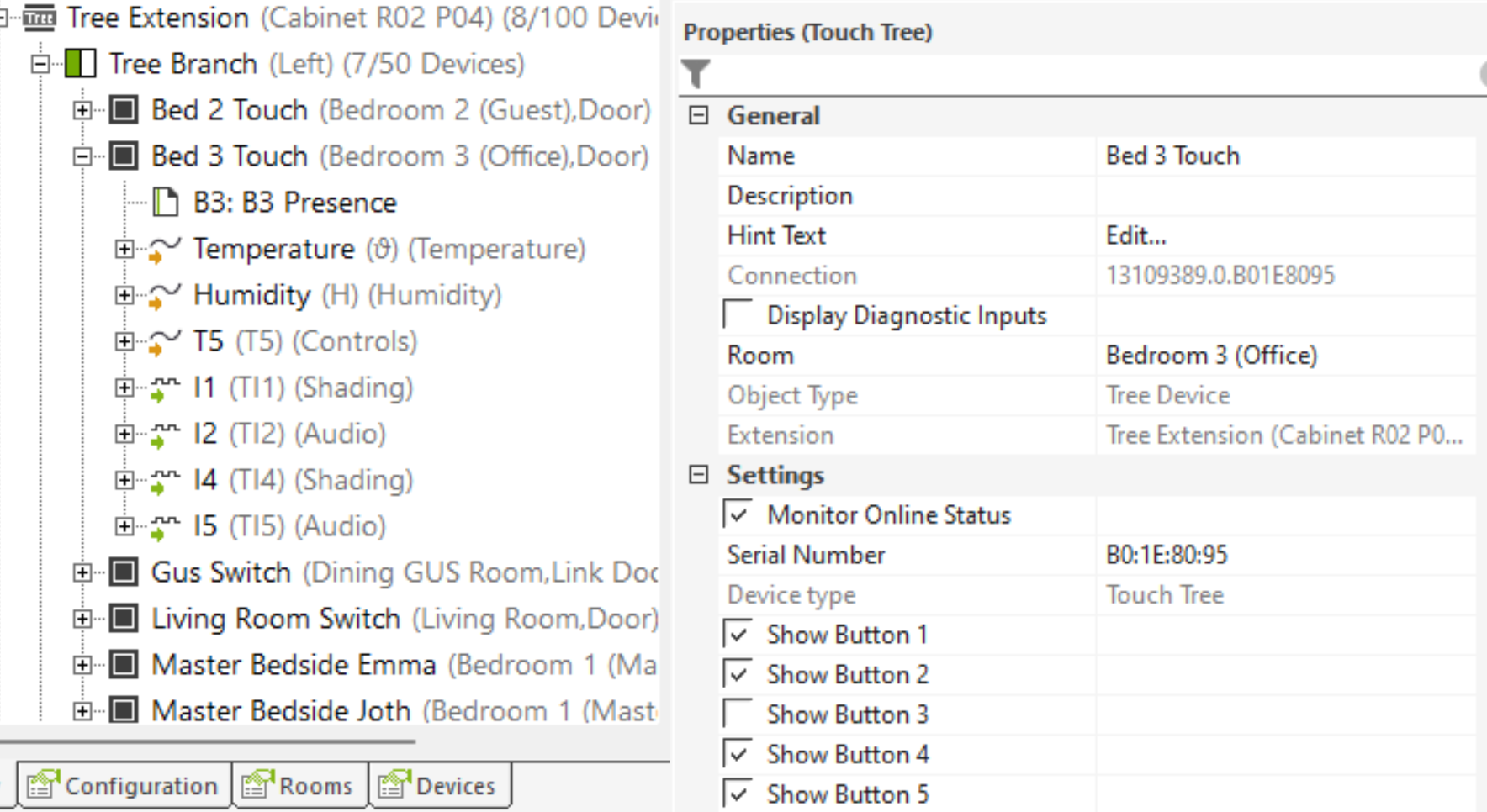

joth Posted May 21, 2024 Posted May 21, 2024 On 18/05/2024 at 09:02, Kelvin said: 3. I can’t quite work out how to use the other buttons on the Touch switch to activate lights. I know the Loxone standard is shading and volume for these switches which is how most of them are configured but there’s one switch where I want to use the other buttons for lights. You need to enable the "Show Button 1-5" check boxes in the settings for the Touch switch. You then get I1-I5 inputs which you can use as standard retractive button input to any other logic block. Here I have all of them except I3 enabled, as I3 is the big center button which I use via the standard T5 input to a lighting controller. 1

Kelvin Posted May 23, 2024 Posted May 23, 2024 On 21/05/2024 at 09:03, joth said: You need to enable the "Show Button 1-5" check boxes in the settings for the Touch switch. You then get I1-I5 inputs which you can use as standard retractive button input to any other logic block. Here I have all of them except I3 enabled, as I3 is the big center button which I use via the standard T5 input to a lighting controller. Yes I’ve done that. The problem I am having is getting them to do anything once configured. I’ve not looked at it again so will figure it out.
