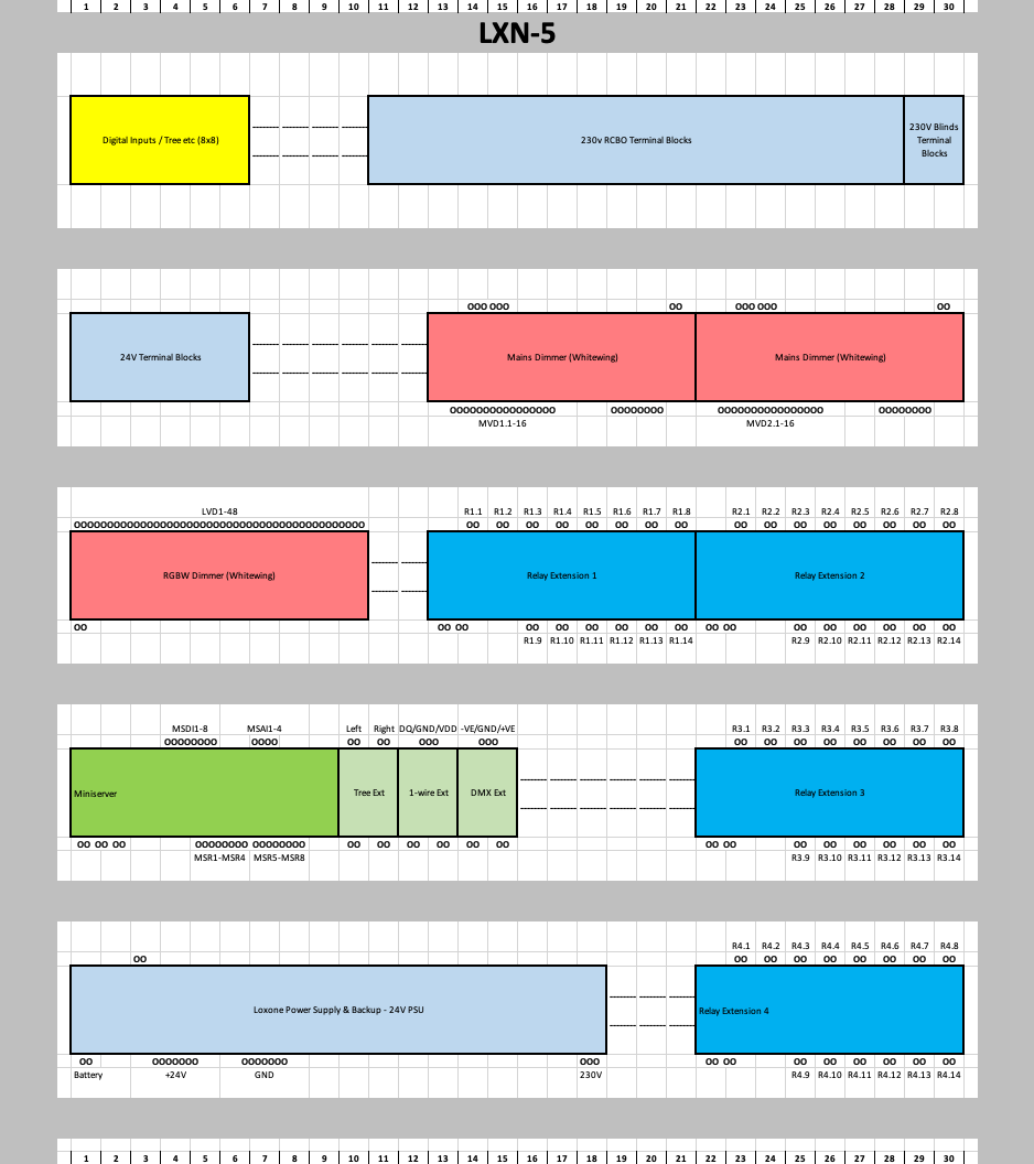

Thorfun Posted December 19, 2023 Author Posted December 19, 2023 ok. I think I've made a decision as to what to do with the primary deciding factor being I have very little money left to finish the house! as such I am going to takes @joth's suggestion and purchase something like the 18-way version of this to house the audio server and stereo extensions. then I will need to purchase a new WW mains dimmer and a Loxone relay to finish the circuits of the main house. that will leave me with a potential 11 230V circuits and 8 x 24V LED strips to run the basement. which won't be enough but I can position another relay on the bottom rail which will add 14 relays which will be enough to run the basement. in order to leave that expansion space on the bottom row I will need to run individual RCBOs in the CU rather than a single cable from the CU and house them in the LXN-5. that means more cable from the CU to the LXN-5 but I can live with that and will put it in some trunking. it doesn't leave me with much expansion room tbh but it should be enough to finish the house and then, when/if I ever have any money again, I can see if I want to add an expansion cabinet below to create more space within the enclosures. with that in mind, below is my proposed layout. Relay #4 will not exist for a while and is the space for future expansion of the basement circuits. it's not ideal but it is an inexpensive way of getting it operational. happy to receive feedback.
Dan F Posted December 19, 2023 Posted December 19, 2023 5 hours ago, Thorfun said: I think I just have too many circuits, especially when I think about trying to light up the basement so all the termination on the top rail really isn't possible I think! my spreadsheet is currently showing 77 x 230V terminal blocks and 24 x 24V terminal blocks. then with the 11 x 8-way blocks that is a total width of 626.4mm. The din rails are only 550mm wide. and then I haven't even got to the basement circuits yet. I'd also rather keep all the Loxone stuff in the one comms room and it's way too late in the day now to try and start running cables elsewhere. I will go and have a good measure up down there in the comms room and see what I can fit in but it's pretty tight in there with my CU, batteries, LXN cabinet and 800mm x 600mm data cabinet! luckily I have pretty high ceilings so should be able to fit the LXN5 with a.n.other cabinet below whether that's a LXN3 or the LXN-2RE I'm not sure yet. I have the power supply and backup from Loxone for my power requirements which 'should' suffice so don't really need the deep cabinet. in hindsight I'd have made the comms room bigger 🤦♂️ Batteries/inverter not elsewhere wherever you have electrical meter and any PV?
Dan F Posted December 19, 2023 Posted December 19, 2023 (edited) 3 hours ago, Thorfun said: ok. I think I've made a decision as to what to do with the primary deciding factor being I have very little money left to finish the house! as such I am going to takes @joth's suggestion and purchase something like the 18-way version of this to house the audio server and stereo extensions. Yet another option is to put loxone audio in your rack. I have a tall Middle Atlantic 20" deep network rack. There isn't much in this rack currently but I have - Bottom half set up as shelving. - Unifi router/switch/patch panel. - Loxone audio at the top (mounted on one of these https://www.network-cabs.co.uk/product/ad-tek-products-1u-19-inch-rack-mount-din-rail-panel-bracket-with-cover-406) Works quite well, and saved adding an additional "box/panel/cabinet" Edited December 19, 2023 by Dan F spelling 2
Thorfun Posted December 19, 2023 Author Posted December 19, 2023 10 minutes ago, Dan F said: Batteries/inverter not elsewhere wherever you have electrical meter and any PV? PV inverter is in the loft and feeds down to the CU/batteries in the comms room. I had a long discussion with folk on here about where to site my batteries and, for me, the basement in the comms room was the most obvious position. Again, way too late for me to think about relocating them just to put another Loxone cabinet in when I could find another solution for the Loxone system. I do have 2.5m height to play with but that is from the floor so I could easily fit a LXN-2RE in under the LXN5 should I need it. could probably fit an LXN4 depending on regulations on the unit being a certain height etc. at the moment, it's just funds that are low and I just need to get it working so we can move in. 1
Thorfun Posted December 19, 2023 Author Posted December 19, 2023 4 minutes ago, Dan F said: Yet another option is to put loxone audio in your rack. I have a tall Middle Atlantic 20" deep network rack. There isn't much in this rack currently but I have - Bottom half set up as shelving. - Unifi router/switch/patch panel. - Loxone audio at the top (mounted on one of these https://www.network-cabs.co.uk/product/ad-tek-products-1u-19-inch-rack-mount-din-rail-panel-bracket-with-cover-406) Works quite well, and saved adding and additional "box/panel/cabinet" I did think about this as it's a 36U rack so I have plenty of space. also running the speaker cables to the network rack would allow me to move away from the Loxone audio server in the future should I wish to. I could also put the amp for the cinema in the rack too. thank you so much for that link. I will definitely consider it especially as it's the same price as that cheapo enclosure I found and would be a neater solution I think. 1

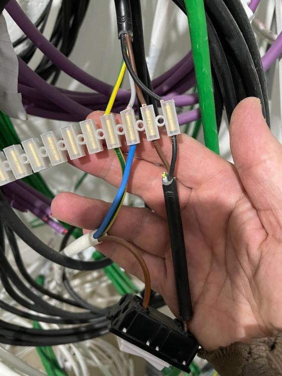

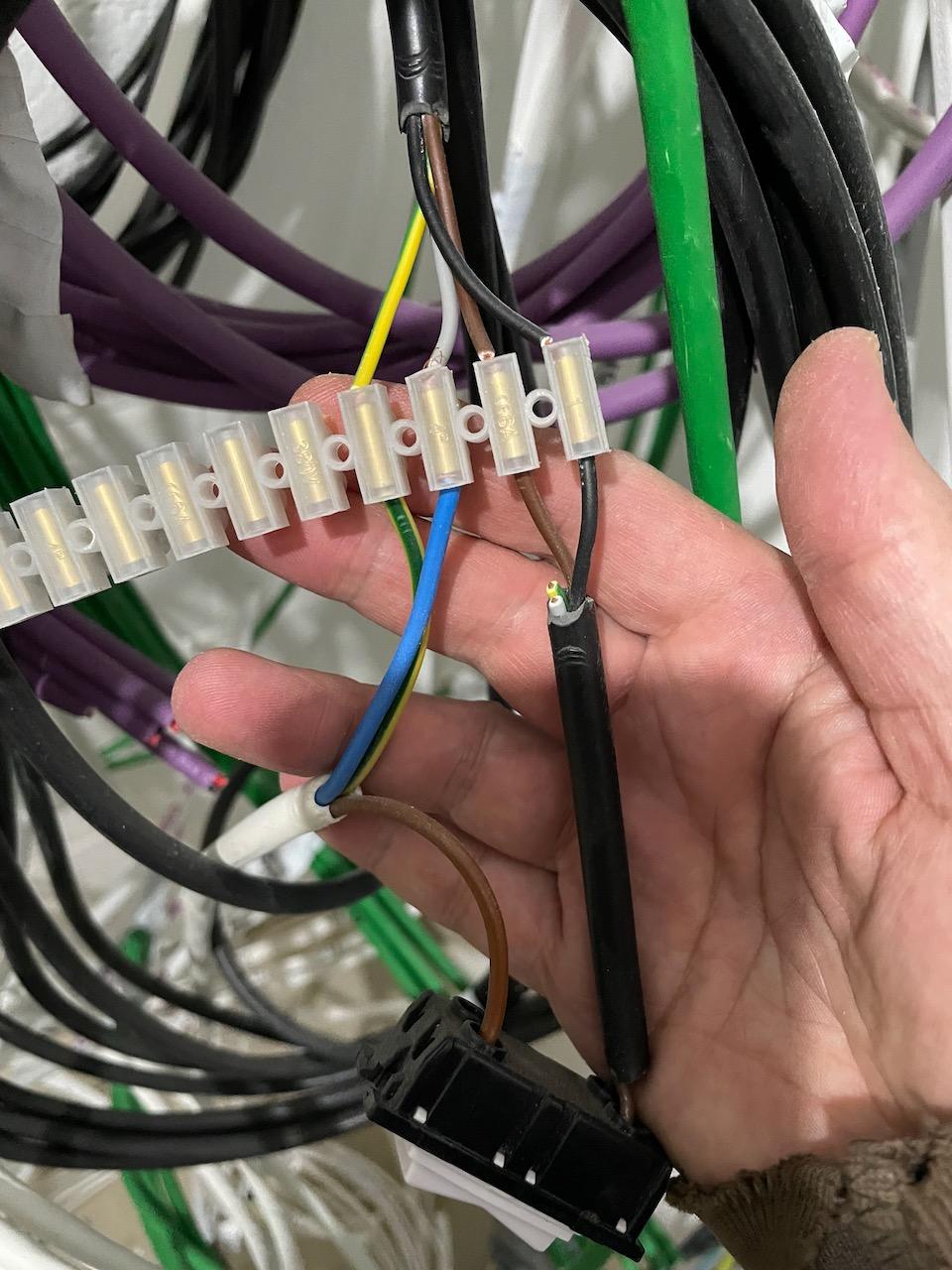

Thorfun Posted December 23, 2023 Author Posted December 23, 2023 external blind terminal blocks.....I bought https://www.wago.com/gb/rail-mount-terminal-blocks/quadruple-deck-rail-mounted-terminal-block/p/2002-4157 for the blinds and here is how I have my blinds tester wired the switch is a rocker switch so raises and lowers the blind. I am presuming that the blind cable brown and black are both live and one makes the motor go forwards and the other in reverse. do I then need 2 x relay connections for each blind? one to take it up and the other to take it down? seems logical but, as usual, I haven't catered for that in my number of relay calculations so I would just like to confirm please
joth Posted December 23, 2023 Posted December 23, 2023 1 hour ago, Thorfun said: external blind terminal blocks.....I bought https://www.wago.com/gb/rail-mount-terminal-blocks/quadruple-deck-rail-mounted-terminal-block/p/2002-4157 for the blinds and here is how I have my blinds tester wired the switch is a rocker switch so raises and lowers the blind. I am presuming that the blind cable brown and black are both live and one makes the motor go forwards and the other in reverse. do I then need 2 x relay connections for each blind? one to take it up and the other to take it down? seems logical but, as usual, I haven't catered for that in my number of relay calculations so I would just like to confirm please You want to check the installation manual on those assumptions. And especially on the device voltage. But yes assuming it is dual switched live control, you need two relay channels per blind. Be careful to never power both cores at the same time. Most are robust to it, but some dislike it immensely 1
Thorfun Posted December 23, 2023 Author Posted December 23, 2023 1 hour ago, joth said: You want to check the installation manual on those assumptions. And especially on the device voltage. But yes assuming it is dual switched live control, you need two relay channels per blind. Be careful to never power both cores at the same time. Most are robust to it, but some dislike it immensely thanks. definitely dual switched live. the way I wired the tester up was how the MI stated. I've got 8 blinds.....16 relays.....damn! 😢
