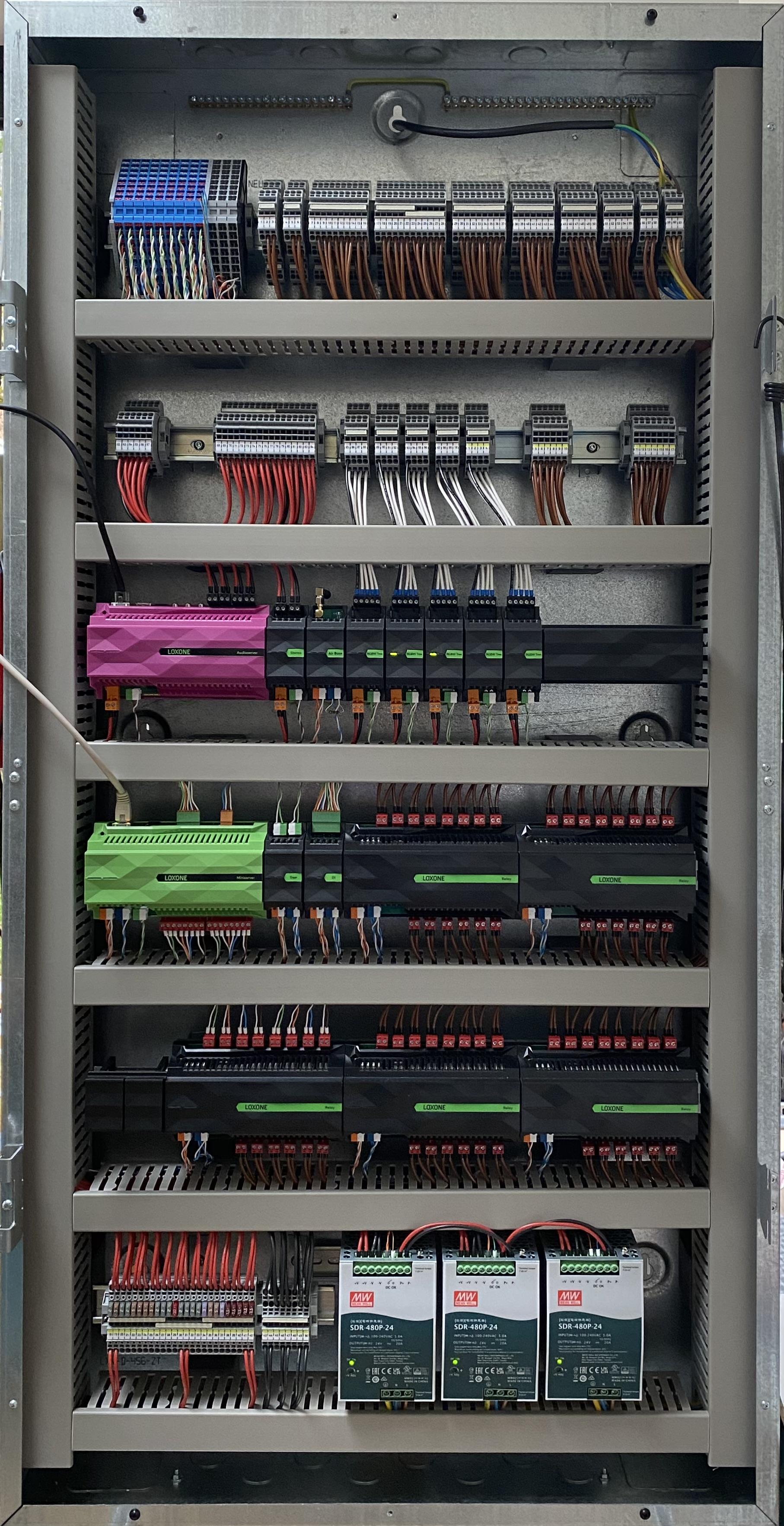

This is a clients cabinet I built last year so you can get an idea of what is included.
6 hours ago, Rob99 said:
Not sure of the need for gel crimps inside the cabinet
The gel crimps aren’t for the cabinet.
Thank you! Very useful and I’ll study it in detail.

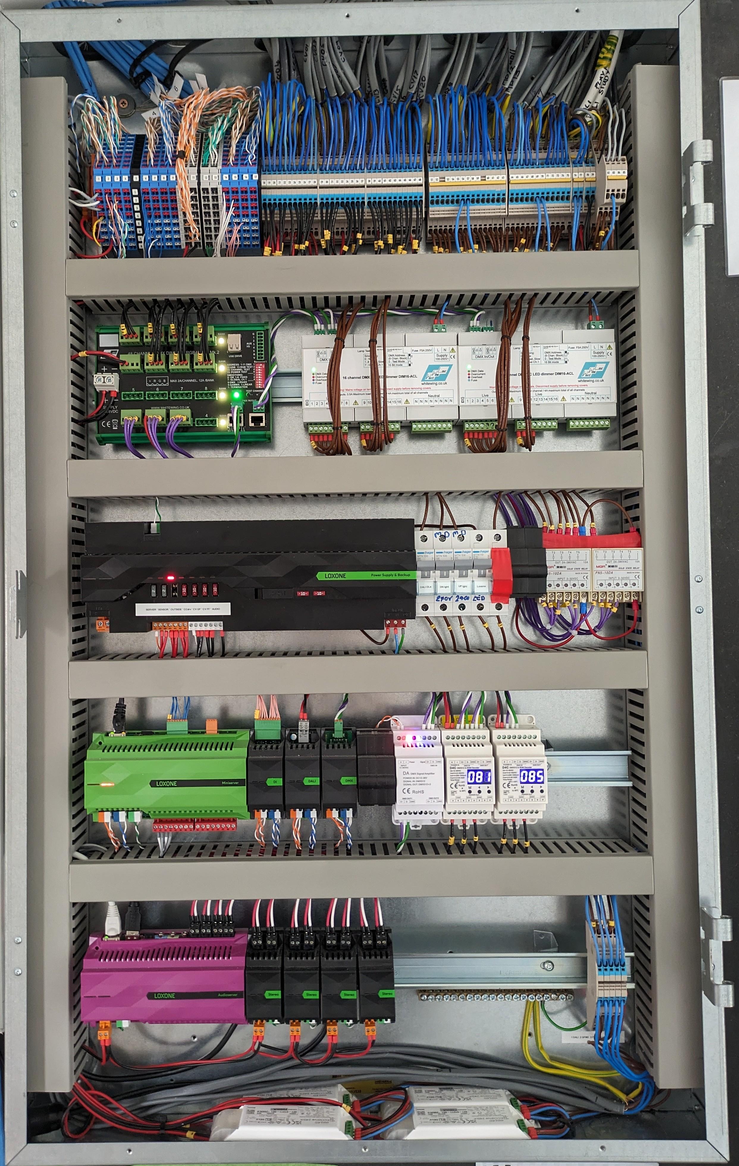

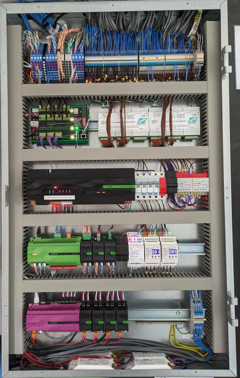

On 27/07/2023 at 21:49, joth said:
I'll let you know how that goes and post photos if it's something I feel a bit more proud of 😂
Ok so yes, I completed second fix of my 2nd install today, and I'm much happier with how the CAT6A termination into the cabinet is looking, if still not perfection.
Top left corner:
To recap, my approach here is I'm still not using external 110 pushdown but instead use 8 way din terminal blocks to fully terminate every incoming CAT6 core (hopefully once and for all), and then any changes (of which we've had a couple already) are made on the internal cabinet lacing side of the terminal block rather than rewiring the external facing CAT6 side.
looks nice! out of interest how many incoming Cat6 cables do you have?
17 shown there. 7 GF, 7 FF, and 3 external. I'm extending Loxone Link to an exterior cabinet with relays (and could add DI in future) to minimise airtight penetrations for all the exterior and landscape lighting
Thanks. Very neat for 17 cables! Well done.
Top left corner:
This looks great!
Not spending the extra time/money to terminate all incoming CAT6 cables, either as you've done it or with a 110 block, is one of my biggest regrets with our Loxone installation.
I've done the same but instead used a terminal block per CAT cable, rather than two terminal blocks per twisted pair. I then used jumpers to supply 24v and tree to each block.
I think both approaches have their merits but in my case, I went with the "horizontal" approach because:
- I have >16 incoming CAT cables.
- It makes it slightly easier to understand (before labelling)
- I needed to be able to split the incoming tree connections between two tree buses (and adjust this based on the cumulative number of devices).
If you have <12 incoming CAT cables then the horizontal approach may also make sense as it would take up less space and use fewer terminal blocks.
EDIT: Actually, now I remember I used:
- 1 CAT cable per terminal block where DIs (blue/brown) are being used or may be used.
- 2 CAT cables per terminal block where I know it is only tree/24v.
Edited by Dan F
