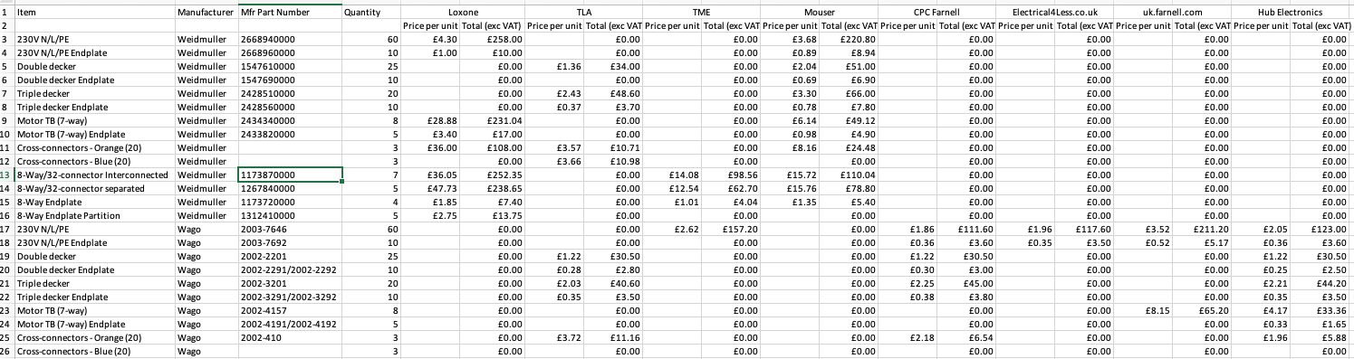

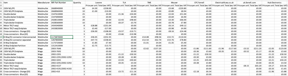

Thorfun Posted December 13, 2023 Author Posted December 13, 2023 1 hour ago, Dan F said: I started looking at the different brands, but got lost with all the different options and decided to stick to Weidmuller. Are the Wago ones cheaper, or easier to get individually? I also was banging my head against a wall trying to compare and look at other brands and find where to buy from so I created a spreadsheet. 🙂 Wago are cheaper but there seems not much difference between the two to get individually. In the end (and I've literally just finished my research) I've decided to go with Wago which will please @Rob99. I wonder if the knowledgable folk on this forum can double check that these Wago parts are compatible please? Loxone Cabinet Din rail components PPV 8 GR 35X7.5 DGR https://catalog.weidmueller.com/catalog/Start.do?ObjectID=1173870000 PRV 8 BL 35X7.5 RT/WS https://catalog.weidmueller.com/catalog/Start.do;jsessionid=34F4787B2C14E096B97A60ACDA4A89A3?ObjectID=1267840000&page=Product PAP PRV/PPV8 SW https://catalog.weidmueller.com/procat/Product.jsp;jsessionid=A6DB5AA66D28A4F406F80D634E4BF620?productId=(%5b1173720000%5d)&page=Product Multilevel installation terminal block N/L/PE 2.5mm2 https://www.wago.com/gb/rail-mount-terminal-blocks/multilevel-installation-terminal-block/p/2003-7646 Multilevel installation terminal block N/L/PE End and intermediate plate https://www.wago.com/gb/rail-mount-terminal-blocks/end-and-intermediate-plate/p/2003-7692 Double-deck terminal block https://www.wago.com/gb/rail-mount-terminal-blocks/double-deck-terminal-block/p/2002-2201 Double-deck terminal block end and intermediate plate https://www.wago.com/gb/rail-mount-terminal-blocks/end-and-intermediate-plate/p/2002-2292 Triple-deck terminal block https://www.wago.com/gb/rail-mount-terminal-blocks/triple-deck-terminal-block/p/2002-3201 Triple-deck terminal block end and intermediate plate https://www.wago.com/gb/rail-mount-terminal-blocks/end-and-intermediate-plate/p/2002-3292 Quadruple-deck terminal block L1 - L2 - L3 - PE for motor https://www.wago.com/gb/rail-mount-terminal-blocks/quadruple-deck-rail-mounted-terminal-block/p/2002-4157 Cross-connectors https://www.wago.com/gb/rail-mount-terminal-blocks/jumper/p/2002-410 In order to get the best prices and all components I will need to buy from 3 different places which is a bit frustrating but most seem to offer free delivery over a certain amount so it doesn't really affect me too much. it's just a faff to keep track of what is coming from where!
Rob99 Posted December 14, 2023 Posted December 14, 2023 On 11/12/2023 at 22:16, Thorfun said: @Rob99? how do you do your customer's setups? I'm pretty sure I remember from @joth's photos that he also has RCBOs in the Loxone cabinet. @jack? how's yours done? anyone else care to comment? I only tagged the above as they're in the top posters in this topic 😉 I have always built cabinets with RCBO feeds coming from the main DB, not included within the Loxone cabinet. Having RCBO's within the cabinet and as the only form of circuit protection and isolation in my view would not comply with current regs. Using RCBO's or MCB's in the Loxone cabinet as a secondary means of circuit isolation I would say is fine but not something I have done for any clients. 1
Rob99 Posted December 14, 2023 Posted December 14, 2023 5 hours ago, Thorfun said: I also was banging my head against a wall trying to compare and look at other brands and find where to buy from so I created a spreadsheet. 🙂 Wago are cheaper but there seems not much difference between the two to get individually. In the end (and I've literally just finished my research) I've decided to go with Wago which will please @Rob99. I wonder if the knowledgable folk on this forum can double check that these Wago parts are compatible please? Loxone Cabinet Din rail components PPV 8 GR 35X7.5 DGR https://catalog.weidmueller.com/catalog/Start.do?ObjectID=1173870000 PRV 8 BL 35X7.5 RT/WS https://catalog.weidmueller.com/catalog/Start.do;jsessionid=34F4787B2C14E096B97A60ACDA4A89A3?ObjectID=1267840000&page=Product PAP PRV/PPV8 SW https://catalog.weidmueller.com/procat/Product.jsp;jsessionid=A6DB5AA66D28A4F406F80D634E4BF620?productId=(%5b1173720000%5d)&page=Product Multilevel installation terminal block N/L/PE 2.5mm2 https://www.wago.com/gb/rail-mount-terminal-blocks/multilevel-installation-terminal-block/p/2003-7646 Multilevel installation terminal block N/L/PE End and intermediate plate https://www.wago.com/gb/rail-mount-terminal-blocks/end-and-intermediate-plate/p/2003-7692 Double-deck terminal block https://www.wago.com/gb/rail-mount-terminal-blocks/double-deck-terminal-block/p/2002-2201 Double-deck terminal block end and intermediate plate https://www.wago.com/gb/rail-mount-terminal-blocks/end-and-intermediate-plate/p/2002-2292 Triple-deck terminal block https://www.wago.com/gb/rail-mount-terminal-blocks/triple-deck-terminal-block/p/2002-3201 Triple-deck terminal block end and intermediate plate https://www.wago.com/gb/rail-mount-terminal-blocks/end-and-intermediate-plate/p/2002-3292 Quadruple-deck terminal block L1 - L2 - L3 - PE for motor https://www.wago.com/gb/rail-mount-terminal-blocks/quadruple-deck-rail-mounted-terminal-block/p/2002-4157 Cross-connectors https://www.wago.com/gb/rail-mount-terminal-blocks/jumper/p/2002-410 In order to get the best prices and all components I will need to buy from 3 different places which is a bit frustrating but most seem to offer free delivery over a certain amount so it doesn't really affect me too much. it's just a faff to keep track of what is coming from where! All those terminal blocks should work fine together. I use most of what you've listed in my cabinet builds. I don't use the 2003 series as I never see the need to connect the earth of any circuit to the DIN rail, preferring instead to install large earth bars at the top of the cabinet. The cross-connectors/jumpers can be bought in 2-10 way variants. Which suppliers are you sourcing your terminal blocks from?
Thorfun Posted December 14, 2023 Author Posted December 14, 2023 7 hours ago, Rob99 said: All those terminal blocks should work fine together. I use most of what you've listed in my cabinet builds. I don't use the 2003 series as I never see the need to connect the earth of any circuit to the DIN rail, preferring instead to install large earth bars at the top of the cabinet. The cross-connectors/jumpers can be bought in 2-10 way variants. Which suppliers are you sourcing your terminal blocks from? can the cross-connectors be cut or do you have to buy the exact size you want? here's my spreadsheet showing the different prices and availability the Loxone prices are so high because of the minimum quantities you have to buy in. it's interesting that uk.farnell.com and cpc.farnell.com have wildly different prices with CPC being a lot cheaper. but CPC don't stock the 2002-4157.
Rob99 Posted December 14, 2023 Posted December 14, 2023 The cross connectors are not designed to be cut to length as that would leave an exposed end. I buy whatever sizes I need to use but usually buy in small batches. I don't bother with coloured terminal blocks or cross connectors, just buy the standard grey. You seem to have a lot of end plates on your list, I'd be surprised if you needed that many. I've never found a single supplier who was able to source everything I needed so always have to place several orders. EIB market came close and cheap but they are in Europe and won't now sell to UK since Brexit. I found Hub good for some of the Wago stuff, and a decent price. I think they are local to you too. The CPC/Farnell price thing is bizarre as they are the same company. Have you tried RS? I find them really cheap for some stuff (e.g. DIN rail terminal block end stops) Not specifically terminal block related but I have found Digi-Key very competitive on other components like power supplies. Even shipping and customs from the states (which is all included in their price) they were 20% cheaper than I could buy from any UK source. 1
Thorfun Posted December 14, 2023 Author Posted December 14, 2023 1 hour ago, Rob99 said: You seem to have a lot of end plates on your list, I'd be surprised if you needed that many True but they’re so cheap I’ve over-specked just in case. 😉 1 hour ago, Rob99 said: I found Hub good for some of the Wago stuff, and a decent price. I think they are local to you too. They are pretty local. Will pop in to see them as they do see very keenly priced.
