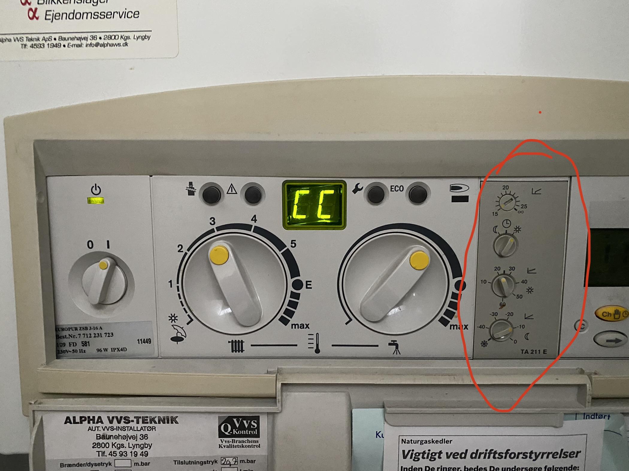

Myatix Posted November 1, 2022 Share Posted November 1, 2022 Hi All, I have an old gas condensation boiler and have a house with 100% UFH in a 10cm slab with 400mm of insulation under the slab. Currently my UFH manifold uses a mixer valve to mix flow and return so the temperature isn’t too high flowing in to the floor. This doesn’t seem to make sense to me as I don’t need high flow temperatures as I don’t have rads. would it not make sense to have the boiler run at a much lower flow temperature (35-40C) and the remove then switch the mixer vale over so it doesn’t mix? Link to comment Share on other sites More sharing options...
jayc89 Posted November 1, 2022 Share Posted November 1, 2022 1 hour ago, Myatix said: Hi All, I have an old gas condensation boiler and have a house with 100% UFH in a 10cm slab with 400mm of insulation under the slab. Currently my UFH manifold uses a mixer valve to mix flow and return so the temperature isn’t too high flowing in to the floor. This doesn’t seem to make sense to me as I don’t need high flow temperatures as I don’t have rads. would it not make sense to have the boiler run at a much lower flow temperature (35-40C) and the remove then switch the mixer vale over so it doesn’t mix? I have a similar set up. My plan is to install weather compensation on the boiler so the flow temp adjusts based on the outside temp and have my UFH mixer valve set to the highest the floor can accommodate (around 45c). So in the coldest depths of winter, the boiler will ramp up, but when you just need to take the chill off it will be running at a much lower temp. You mentioned you're running an older boiler, so this might not be an option for you. Does the boiler also heat your hot water? If so, does that have a different temp setting? This might limit your options too. Link to comment Share on other sites More sharing options...
JohnMo Posted November 1, 2022 Share Posted November 1, 2022 My boiler is currently kicking out out about 26 - 29 on weather compensation, but at the end of a firing the supply temperature does rise until the return temperature increase to a max about 5 degrees over the set point. So at an extreme example you have a set temp of 45, you easily be supplying circa 50 deg to the floor. Secondly you need a over temp protection devise to protect the floor. The mixer valve supplies both these services, it limits supply temp and provides a layer of protection. Plus it will cost to remove. With that much insulation in the floor I would be surprised if you need 35-40 flow temps. I had ours set to 30 for a day and the house got up about 26 degrees. Link to comment Share on other sites More sharing options...
ProDave Posted November 1, 2022 Share Posted November 1, 2022 I heat with an ASHP that can set a low flow temperature I still have the mixing valve. One reason being when the ASHP is heating DHW the water temperature may get up to 55 degrees. When it changes over from DHW to floor heating, that slug of 55 degree water would go straight into the floor were it not for the mixing valves. Link to comment Share on other sites More sharing options...
Myatix Posted November 1, 2022 Author Share Posted November 1, 2022 Thanks for all the comments! according to the MCS Heat Loss Calculation the flow temp needs to be around 35-40 degrees but I should point out that I live in Denmark where we calculate the minimum temperature at -12 rather than -3 in the northern parts of the U.K. I don’t think that a 55 degree surge of hot water would effect our floor as the thermal mass of a 100mm concrete slab would need that 55 degrees to run for at least an hour or more to have a significant impact. I do have a very old weather compensation unit on the boiler but it has been disconnected. My guess is that it didn’t work well or wasn’t commissioned properly. we are planning on installing an ASHP in the near future but until then it would be nice to get the optimum efficiency out of the boiler without spending a huge amount on gas. Current gas prices in Denmark would mean an annual gas bill of £7000. On the mixer valve shown above I can adjust or completely stop the valve from mixing the flow and return by adjusting it with an Allan key. Any advice or tips would be great fully received. Link to comment Share on other sites More sharing options...

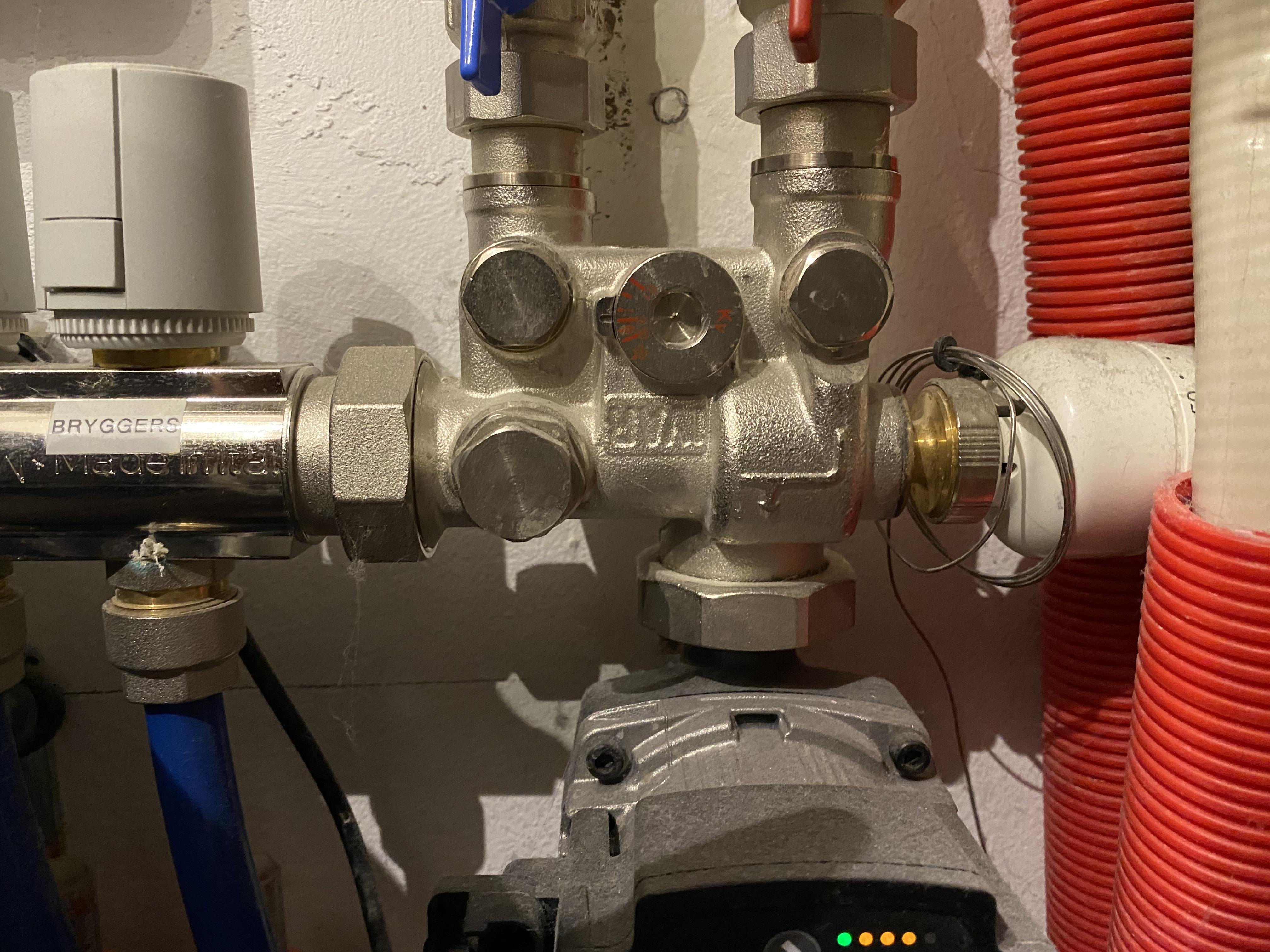

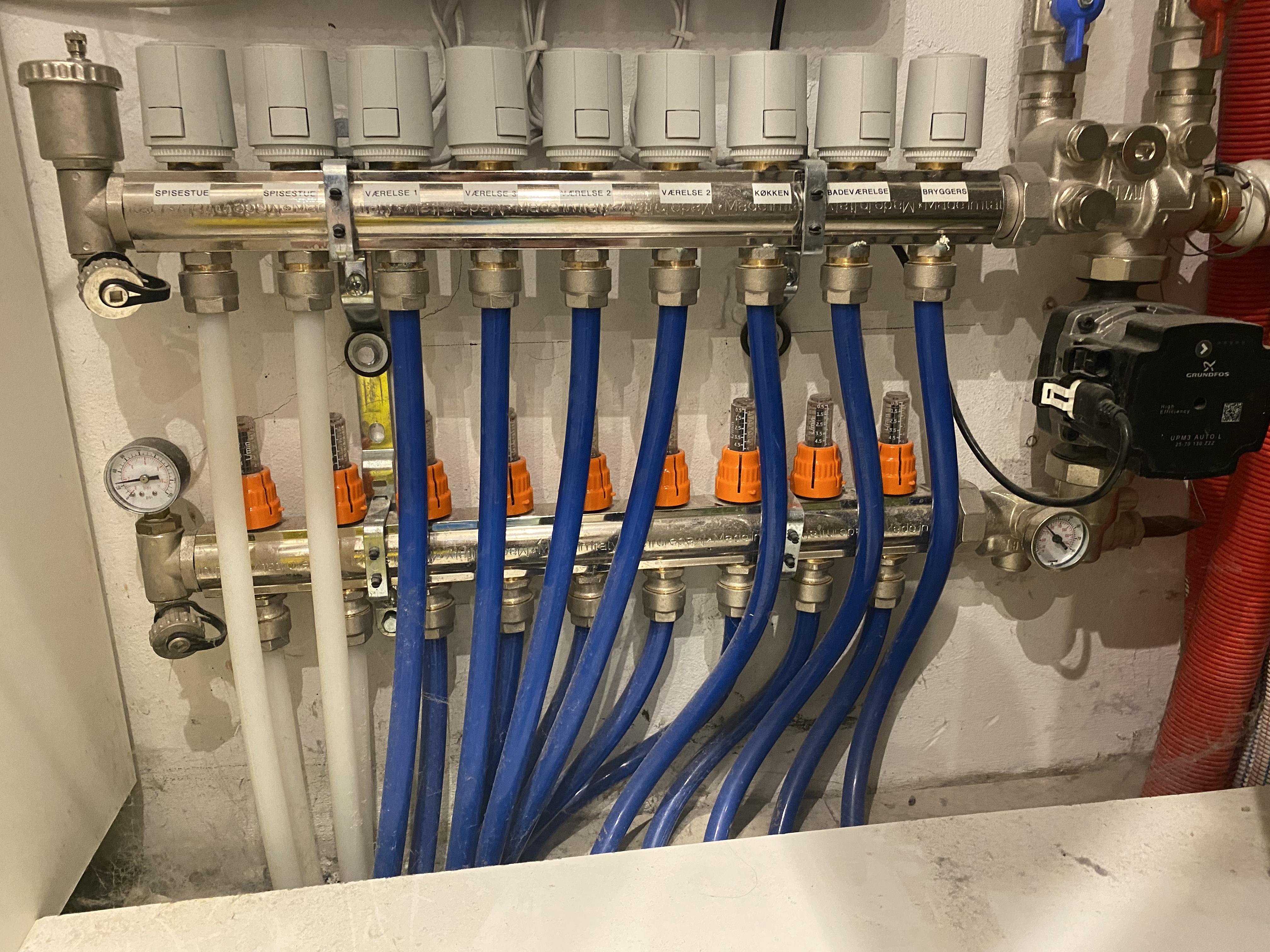

Nickfromwales Posted November 1, 2022 Share Posted November 1, 2022 I'd be more concerned as to why the input group and the pump are completely the wrong way around?!? The pump is pumping upwards, and the words IVAR are upside down, showing that the water that should be being 'sucked' through the input group is in fact being pushed backwards against it. Like that. Link to comment Share on other sites More sharing options...
Nickfromwales Posted November 1, 2022 Share Posted November 1, 2022 (edited) Those setups can only be plumbed it as a left handed arrangement, whereas your plumber has gone against this for possible convenience of plumbing it in..... And the isolators ( red and blue valves ) should be between the rails and the mixing set, as per above image, eg so you don't have to drain down the loops to service the mixing valve etc or the pump and then risk getting unwanted trapped air getting into the rails / loops. Edited November 1, 2022 by Nickfromwales Link to comment Share on other sites More sharing options...

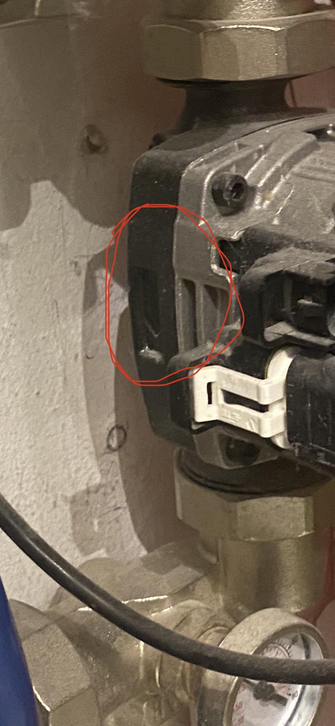

Myatix Posted November 1, 2022 Author Share Posted November 1, 2022 (edited) Hi NickfromWales, Thank you very much for that! I had never noticed that, but I think it’s fine! If you look at the flow direction on the pump it’s correct, the front of the pump has been turned 180 degrees but if you look at the image below you will see that the pump direction is correct. (See the arrow showing up the pump direction on the back of the pump). I can see why the plumber mounted it that way, there is no space in the cupboard to mount it the other way up… I also presume that is why he has moved the automatic bleed valve? So there is no issue there! But thanks anyway! Edited November 1, 2022 by Myatix Correct text and add details Link to comment Share on other sites More sharing options...
ProDave Posted November 1, 2022 Share Posted November 1, 2022 38 minutes ago, Myatix said: Hi NickfromWales, Thank you very much for that! I had never noticed that, but I think it’s fine! If you look at the flow direction on the pump it’s correct, the front of the pump has been turned 180 degrees but if you look at the image below you will see that the pump direction is correct. (See the arrow showing up the pump direction on the back of the pump). I can see why the plumber mounted it that way, there is no space in the cupboard to mount it the other way up… I also presume that is why he has moved the automatic bleed valve? So there is no issue there! But thanks anyway! Yes your plumber took the assembly as posted by @Nickfromwales a few posts above and rotated the complete assembly 180 degrees, so you now have the flow meters on the bottom and actuators on the top. That should work okay. What he has done wrong is put the isolating valves in the wrong place, that may make something like a pump change harder as you may get air in the pipe loops making bleeding harder than otherwise necessary. Link to comment Share on other sites More sharing options...
Myatix Posted November 1, 2022 Author Share Posted November 1, 2022 11 minutes ago, ProDave said: Yes your plumber took the assembly as posted by @Nickfromwales a few posts above and rotated the complete assembly 180 degrees, so you now have the flow meters on the bottom and actuators on the top. That should work okay. What he has done wrong is put the isolating valves in the wrong place, that may make something like a pump change harder as you may get air in the pipe loops making bleeding harder than otherwise necessary. Thanks for confirming its okay! Back to the original subject of the thread! Should I change my mixer valve settings so it doesn’t mix and have the boiler run at a lower temperature to save money? should I be using the weather compensation on the boiler? If so any tips on setting it up? Link to comment Share on other sites More sharing options...

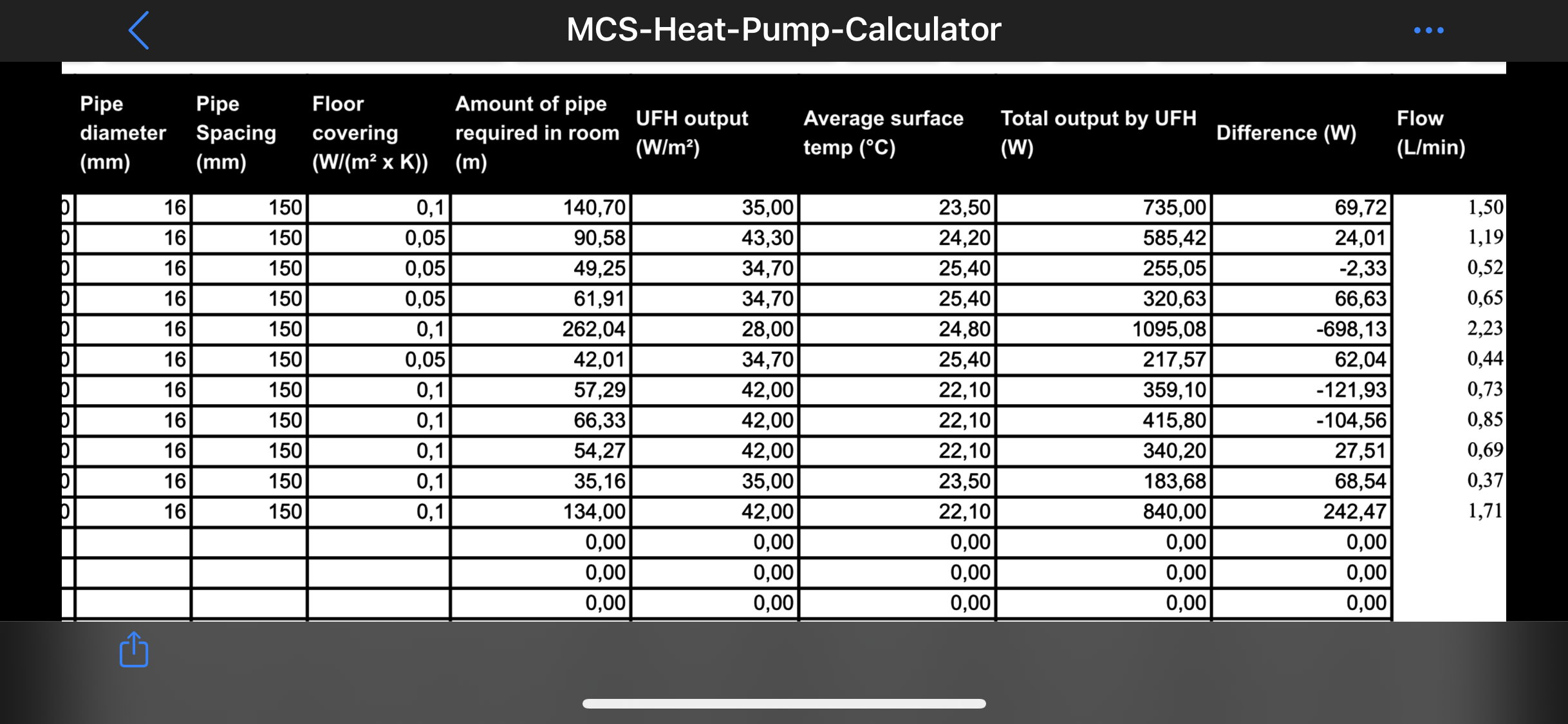

Myatix Posted November 1, 2022 Author Share Posted November 1, 2022 Here are the details from my MCS Heat Loss Calc and the UFH Design details. I have also included in the flow rates (l/m) to set the flow rates Now I need to optimise the manifold and flow temperatures at the boiler but this is were it gets tricky. Because I can set a flow temperature of 35 degrees from the boiler but the actual flow temperature at the actuator is about 24 degrees and 23 degrees on the return. My guess is that this is because of the mixer valve. Link to comment Share on other sites More sharing options...

Nickfromwales Posted November 2, 2022 Share Posted November 2, 2022 45 minutes ago, Myatix said: anyway this is not what this thread is about! Indeed. So, do NOT remove the mixing set, as that is there for failsafe at the very least and it is a bad idea to remove this and then rely solely on the heat source to deliver safe and reliable flow into the floor. Also, your pump being upside down is not great. Look at the manufactures installation guide and that setup has a big ❌ against it as it will cause the pump to wear out prematurely. The plumber detached the pump head and rotated it 180° to make it look right, clearly demonstrating that they knew it wasn’t done properly. 1 Link to comment Share on other sites More sharing options...
