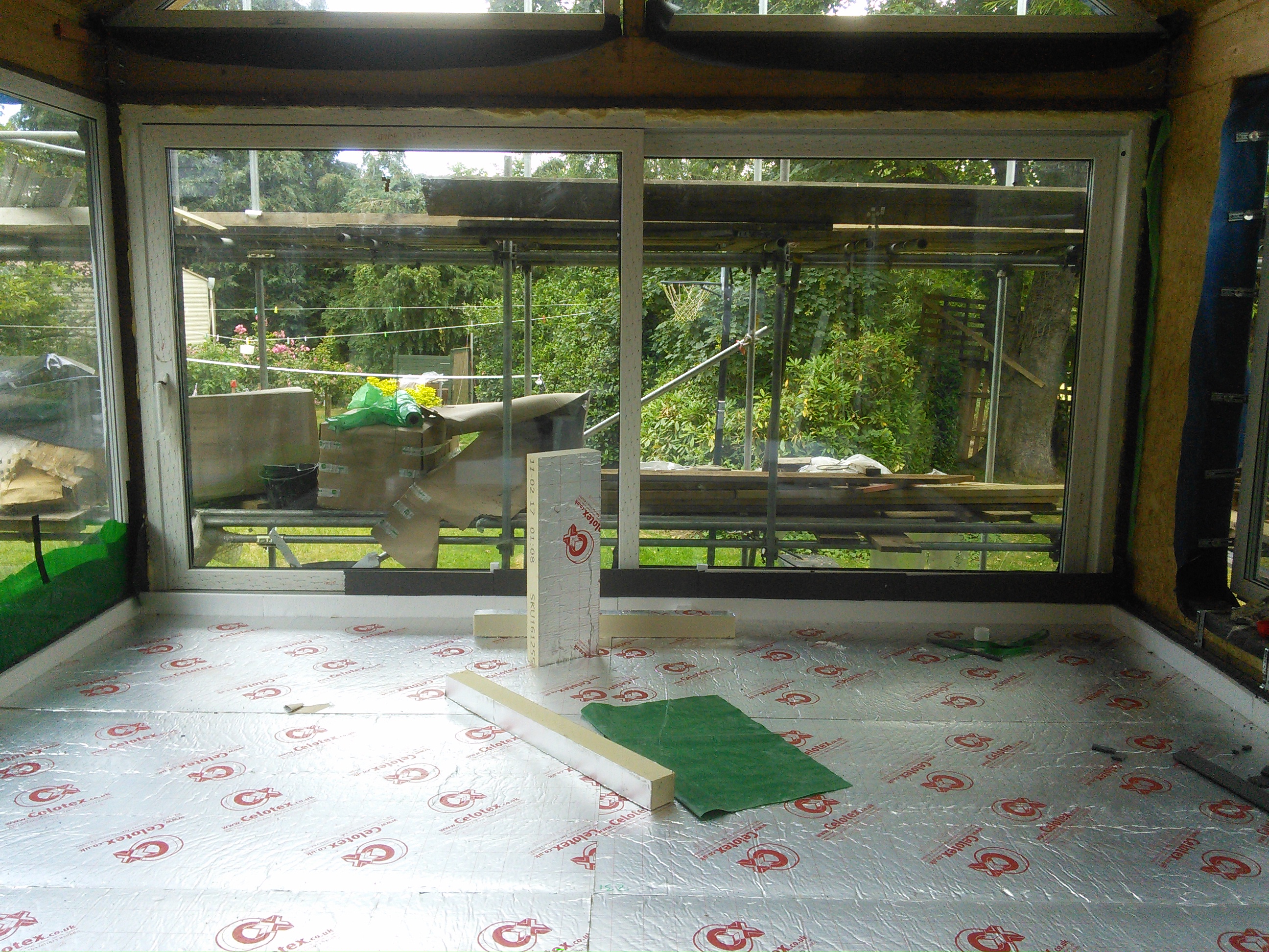

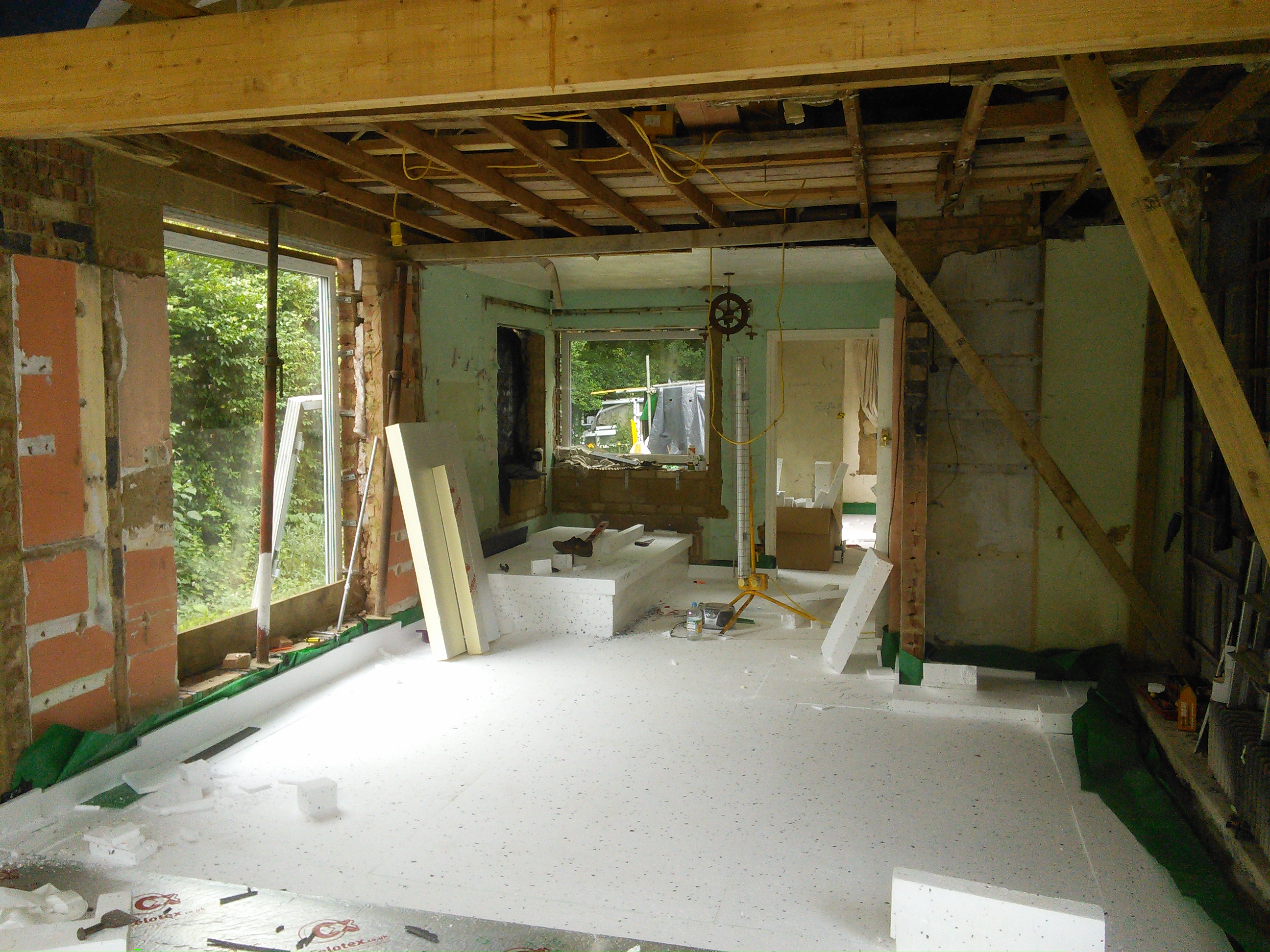

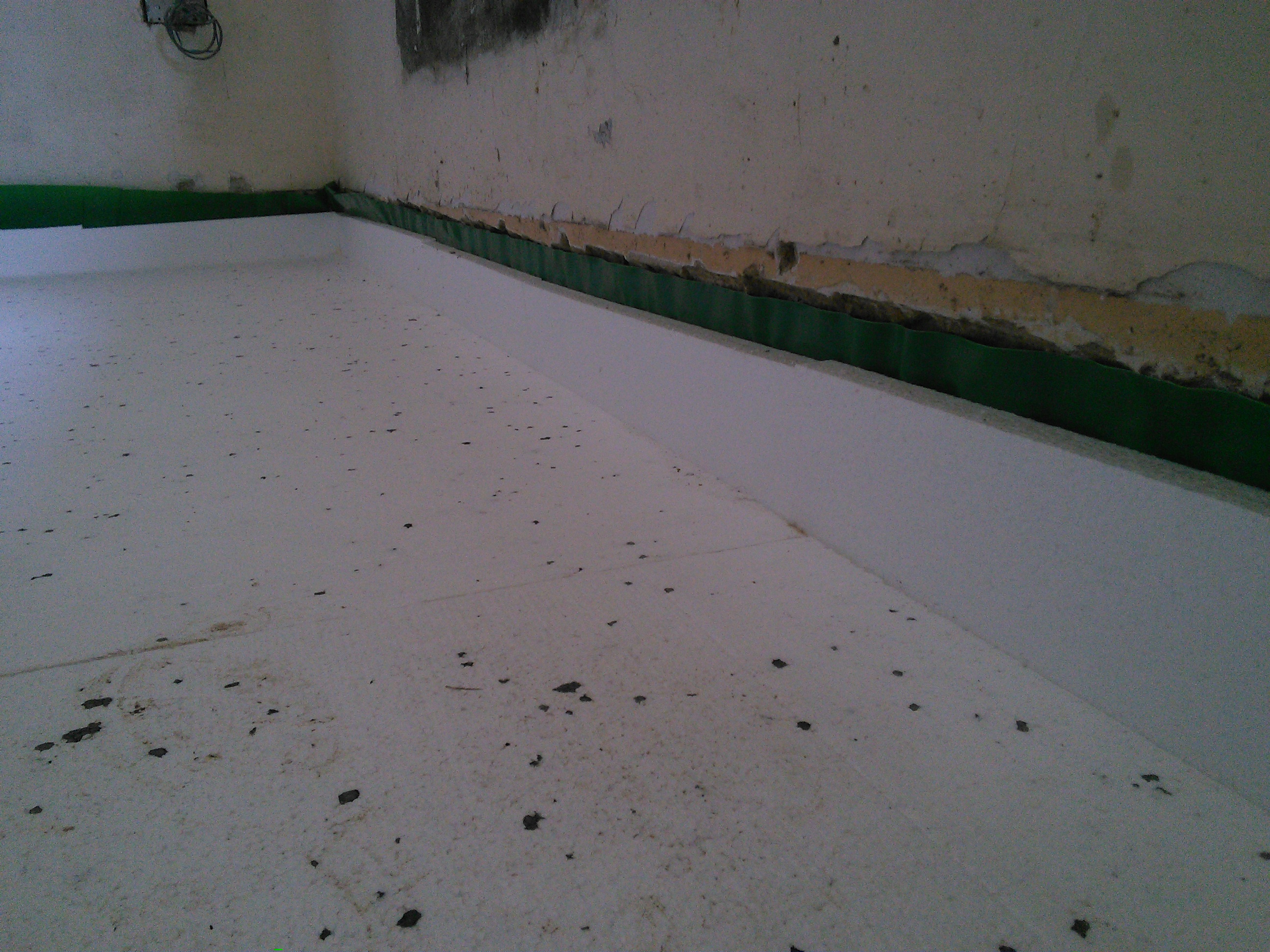

oranjeboom Posted June 26, 2017 Posted June 26, 2017 (edited) I've just about completed my slab insulation for my extensions (EPS + Celotex) and old bungalow (EPS). I've used 25mm of EPS perimeter insulation and will probably stick on the 8mm roll stuff that I will get from UFH supplier. So I'm just about ready to get my 2.4x4.8m mesh sheets into place (will have to cut most of the buggers in order to get through door ways. Luckily I should at least get them through the larger sliding door at the rear. The plan is to have UFH cable tied to mesh and then have a wet mix concrete pour. No final screed! Before I start cutting and laying them, i have some questions: 1) How much overlap should I have? Is one 'square' overlap enough? The mesh has 200mm squares. 2) How far from the walls should I have the mesh? I know there should be some distance and I think I read somewhere 150mm? 3) Tying wire. As it's just a case of keeping the mesh in situ whilst concrete is being poured, would cheapo galv wired be sufficient rather than defacto tying wire? e.g. https://www.toolstation.com/shop/Landscaping/d130/Wire+Fencing+%26+Tools/sd3333/Galvanised+Straining+Wire/p40640 4) Should I continue the mesh through doorways? 5) Not mesh related, but if I am supposed to cover the celotex top layer (in the extensions only) with a poly sheet (vapour barrier) or should I use something more heavy duty like a DPM? (I have the DPM/radon barrier in already but further down the layers. My only concern with the lighter vapour sheets is that it is more prone to being punctured / ripped with the mesh (I will be using chairs) and people (i.e. me!) repeatedly tripping over the mesh. 6) I intend to tape up the celotex joins (not the EPS sheets). Can I use any tape to do this or need the foil type tape? Thanks in advance. Edited June 26, 2017 by oranjeboom Photos 2
