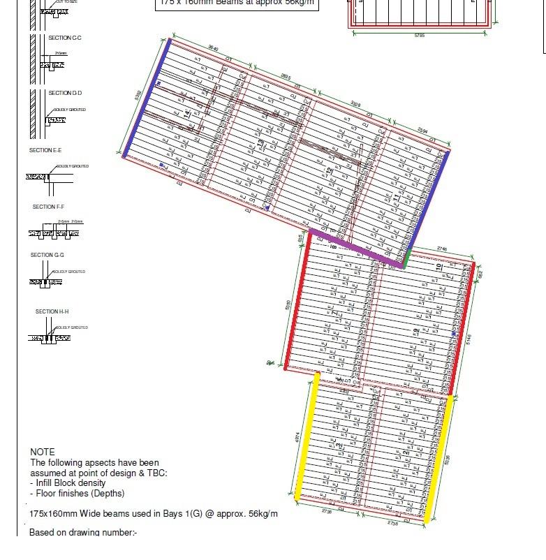

Mulberry View Posted October 30, 2022 Author Share Posted October 30, 2022 Here's our Beam & Block design. The blue walls will bear beams at 225mm void height The red walls will bear beams also at 225mm void height, but off a +600mm foundation The purple wall will bear the beams from the 'red' section, but off the lower foundation (needing an 825mm fill), no part of the 'blue' section bears on this The little green section will need to bear the 'blue' section beams at the 225mm void and 3 of the 'red' section beams later on (I guess it'll need to be topped up once the blue section floor is done) The yellow walls will bear beams with a 625mm void All uncoloured walls will not bear any part of the floor structure. Link to comment Share on other sites More sharing options...

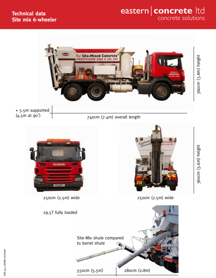

Iceverge Posted October 30, 2022 Share Posted October 30, 2022 I mixed 8m3 for our garage floor in a 300l tractor mixer. I was loading the gravel with a digger mind you, but it was still total suffering. It allowed me to move my premade floor shutter and do one "square" per day but the difference in mixes and joints are apparent. I wouldn't consider it for your purpose. It's impossible to achieve the consistency of delivered concrete self mixing and the price I paid for cement alone was more than the cost of delivered readymix. Something like the below would work. Is there any point more than 5.5m away from where the truck could reverse to? 2 Link to comment Share on other sites More sharing options...

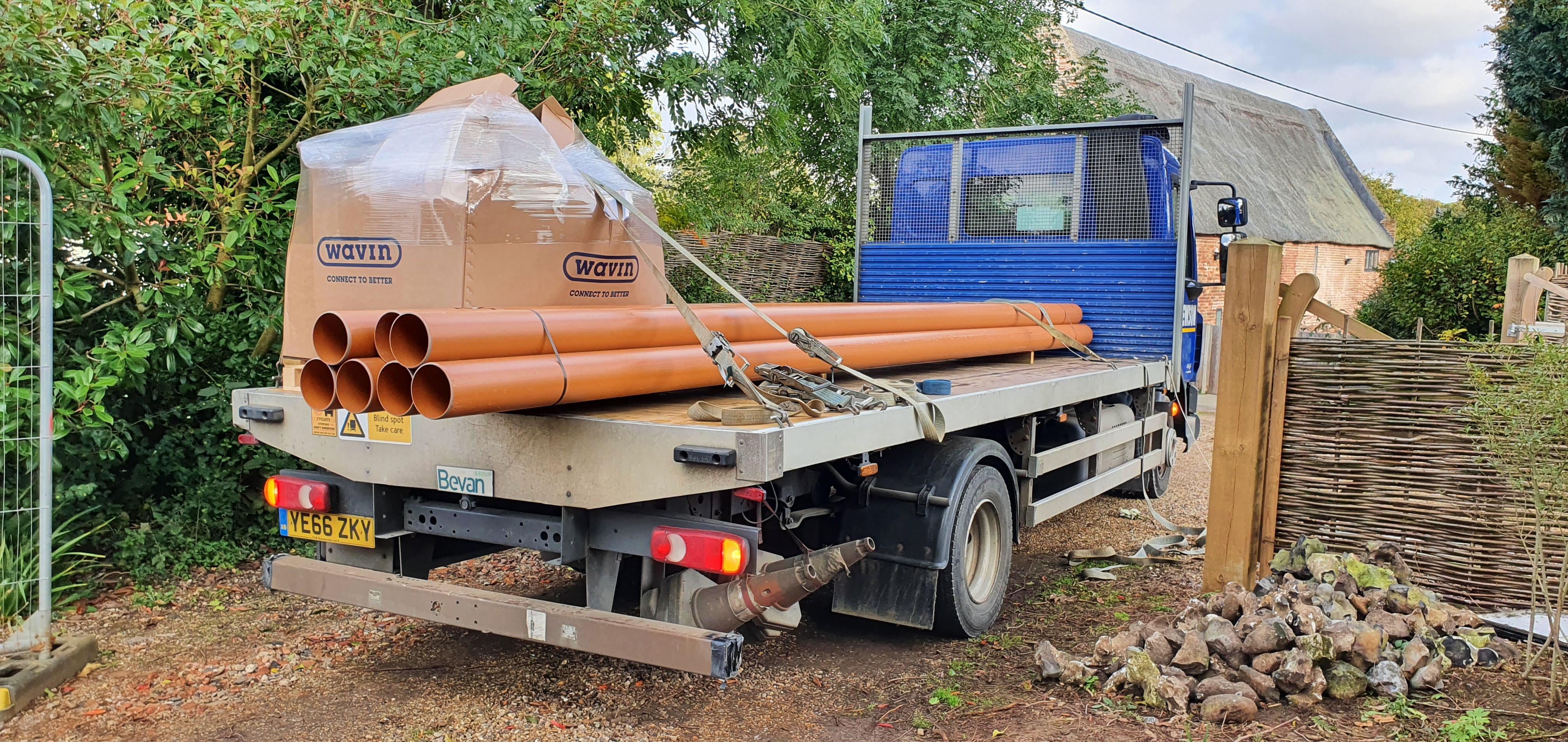

Mulberry View Posted October 30, 2022 Author Share Posted October 30, 2022 I'm taking onboard all the opinions about the mix quality and time etc and coming around to the idea of readymix etc. This is the biggest truck we've had up here. I don't think you'd get anything bigger up here, there's a bend to tackle and on an incline (the building in the background of the pic is a 16th Century Tudor Barn which sits right up to and on the bend). I don't know how long the truck is, but the soil pipes must have been 6m. He was a good driver, not everyone could have managed it. From this point, there's still another 100m to the plot, but that's the hard bit done. Link to comment Share on other sites More sharing options...

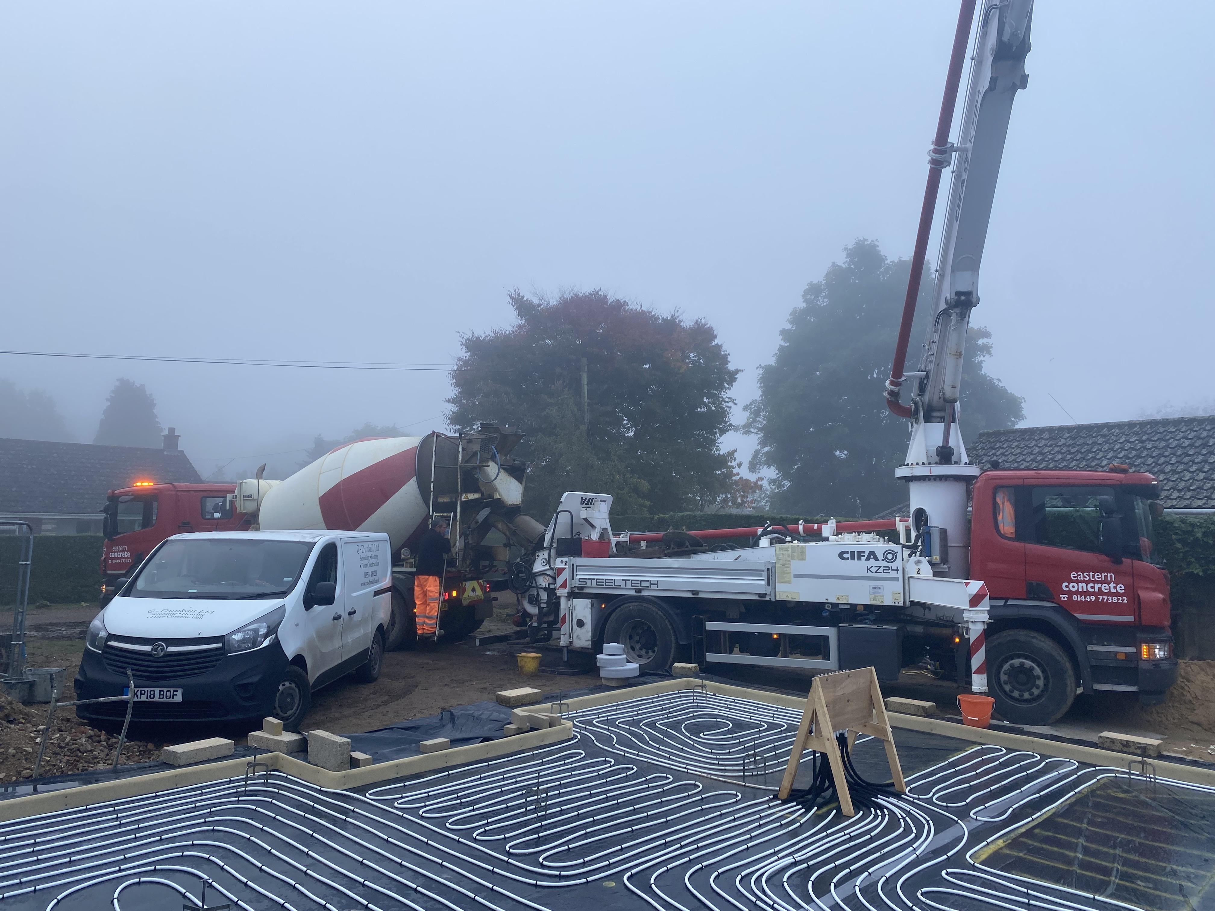

Mulberry View Posted October 30, 2022 Author Share Posted October 30, 2022 5 minutes ago, Dave Jones said: overhead pump is peanuts. crazy to try and cheap it. The 42m boom pump that did our foundations was £1200. Not sure where you're getting your peanuts from. I could get away with 32m, but to pour 2-3 cube?! Plus I have to obtain permission to place it on third-party land. I have permission to do that for the wall pours, but this would be additional to the agreement and extra faff. Link to comment Share on other sites More sharing options...
Chanmenie Posted October 30, 2022 Share Posted October 30, 2022 Have a chat with the lads at Eastern Concrete, I had their 24m boom pump for my slab, I’m sure they’ll pop over and survey your site. They have pumps up to 39m You’ll need at least 15m3 for your walls 1 Link to comment Share on other sites More sharing options...
Chanmenie Posted October 30, 2022 Share Posted October 30, 2022 3 minutes ago, Mulberry View said: The 42m boom pump that did our foundations was £1200. Not sure where you're getting your peanuts from. I could get away with 32m, but to pour 2-3 cube?! Plus I have to obtain permission to place it on third-party land. I have permission to do that for the wall pours, but this would be additional to the agreement and extra faff. Ignor my previous reply didn’t realise you were just looking for 2-3 cube who did your floor ? Link to comment Share on other sites More sharing options...
JohnMo Posted October 30, 2022 Share Posted October 30, 2022 8 minutes ago, Mulberry View said: £1200 Ours was £580, good job it wasn't £1200 as we had him 4 times Link to comment Share on other sites More sharing options...

Iceverge Posted October 30, 2022 Share Posted October 30, 2022 Most trucks will be the same width 2.55m, small or large. The bend may prove an obstacle but I wouldn't write it off. I'd give your concrete supplier a call and see if they can solve the problem for you. You'll be buying a good amount over all from them. It's in their interest to find a solution. Link to comment Share on other sites More sharing options...
