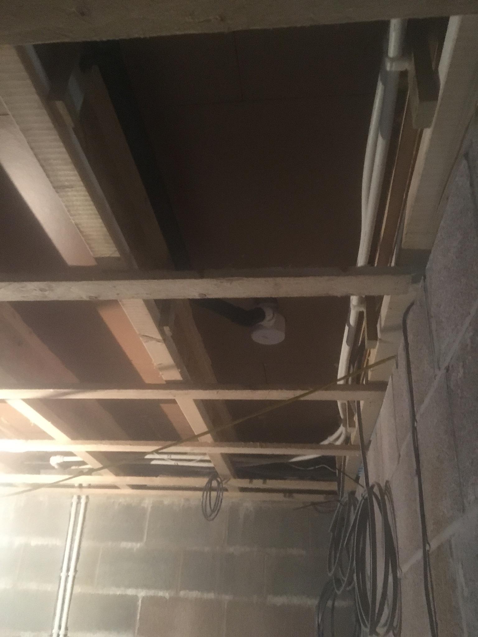

connick159 Posted October 26, 2022 Share Posted October 26, 2022 (edited) Hi, I've just come to boarding internal walls on a bathroom and can see that the roof truss (ceiling plasterboard will be fixed to the truss) is some 20mm higher on one side of the room than the other (across about 2.8m.) The walls that meet the ceiling will be tiled so the difference will stick out like dogs balls, A couple of questions: 1. Whats the best way to fix the difference? Shimming or sistering the underside of the trusses or something else? (builder long gone so up to me to sort it out) 2. Is such a difference an acceptable amount? (whats a general tolerance over about 3m - I'd have thought the trusses should be dead level?) Thanks in advance. Edited October 26, 2022 by connick159 Link to comment Share on other sites More sharing options...

nod Posted October 27, 2022 Share Posted October 27, 2022 8 hours ago, connick159 said: Hi, I've just come to boarding internal walls on a bathroom and can see that the roof truss (ceiling plasterboard will be fixed to the truss) is some 20mm higher on one side of the room than the other (across about 2.8m.) The walls that meet the ceiling will be tiled so the difference will stick out like dogs balls, A couple of questions: 1. Whats the best way to fix the difference? Shimming or sistering the underside of the trusses or something else? (builder long gone so up to me to sort it out) 2. Is such a difference an acceptable amount? (whats a general tolerance over about 3m - I'd have thought the trusses should be dead level?) Thanks in advance. I never board directly on to trusses There’s always some undulating Hangers Bad alignment etc Fix 5x1 to the highest side and simply level and pack down where needed About thirty quid and an hours work on a bathroom Link to comment Share on other sites More sharing options...

connick159 Posted October 27, 2022 Author Share Posted October 27, 2022 12 hours ago, nod said: I never board directly on to trusses There’s always some undulating Hangers Bad alignment etc Fix 5x1 to the highest side and simply level and pack down where needed About thirty quid and an hours work on a bathroom thanks but sorry, i'm a bit lost. Do you mean getting 5 x 1 battens and screwing them up directly to the underside of the trusses and using packer to get it level? or screw them onto the side of the truss and drop the batten at the high side so it hangs down lower than truss and gets it all level? thanks again. Link to comment Share on other sites More sharing options...
nod Posted October 27, 2022 Share Posted October 27, 2022 7 minutes ago, connick159 said: thanks but sorry, i'm a bit lost. Do you mean getting 5 x 1 battens and screwing them up directly to the underside of the trusses and using packer to get it level? or screw them onto the side of the truss and drop the batten at the high side so it hangs down lower than truss and gets it all level? thanks again. Directly under As pictured on our previous build Link to comment Share on other sites More sharing options...
