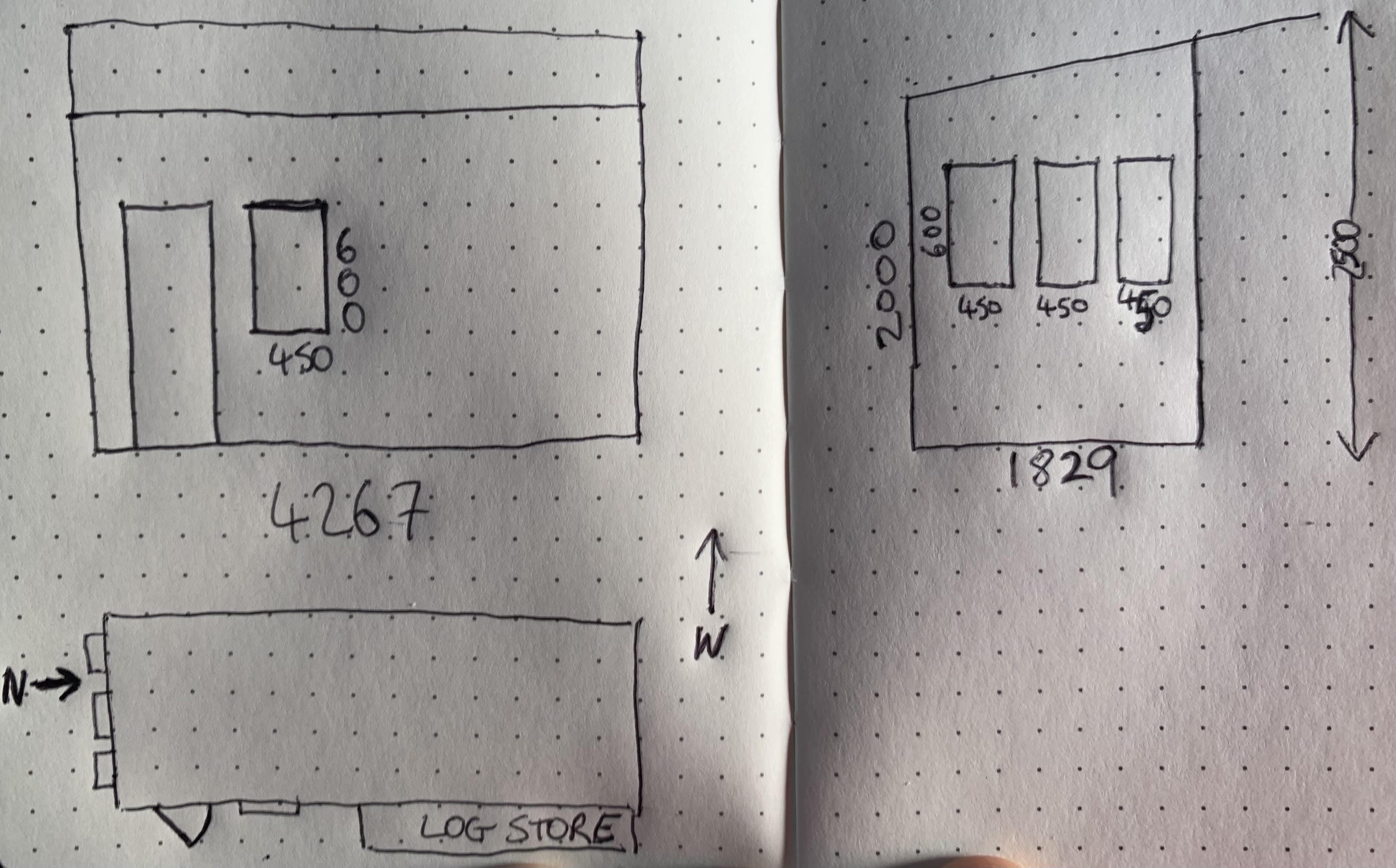

critique my Pent shed / wood store design please
Need to place an order for a Pent shed quite soon. Found a supplier I like who was happy to make some bespoke adjustments to the standard sized sheds. The main bespoke feature we've asked for is for the roof to be extended so that we can have a pent shed that doubles up as a log store on the outside, by having the roof overhang project by 600mm on that side, creating an overhang to shelter the wood from the rain.
Here is a basic sketch showing plan and side and front elevations:
This is a 6' by 14' shed: on the short side (which is South facing) we've got three windows and on the long side (which is East facing) we have the entry door, then a window, then space for the logs.
The shed is going in the back corner of my garden, so no possibility of adding windows to the other sides.
A few queries:
  1. Are the windows sufficient to get much light into the shed? I'm conscious half the shed will probably be in darkness but presumably a battery operated (or perhaps solar powered) lamp can easily be installed? I do have power in the garden, but not close to the shed, so to get power there I would have to lay some 12m of armoured cable and bury it in trunking etc, which I rather not do. Any issues with battery/solar power for this kind of illumination? I won't be working in the shed often, illumination is mainly to see my around and find and store things.
  2. Thoughts on the front elevation? Would it be better to split the log store into two piles, and have the window in between them, rather than all the wood in one pile?
  3. Will the log store stay dry? 600mm overhang at a slight angle of say 10 degrees will result in a covered space of about 590mm. My logs won't be bigger than 25cm long, so this should give enough space for two rows stacked perpendicular to the shed wall (250 x 2 = 500) plus a 90mm gap for rain that doesn't fall perfectly straight. Alternatively, is this all wrong and should the wood store be on the South facing side which will be sunnier than the East facing side? The reason I hadn't put the wood on the South facing side is that because of some tall trees we have at the back of the garden I don't think it will make a huge amount of difference, maybe an extra 10% to 15% of sunlight hours.
Thanks in advance.

Without seeing the picture, an open sided log store the logs will get wet then the rain blows from that direction.  Perhaps not much of an issue unless that is the prevailing wind direction.

Thanks, now amended. Hopefully you can see it?
The prevailing wind direction is very much West South West. If the logs are on the East facing wall, they will get ALL of the westerly wind. I thought that was good for drying them out, but I guess you're right about the rain. I could put in some vertical battons, from the ground up to the overhanging roof, in front of the area for the logs, to protect from wind-driven rain. Not sure.
I have a 600mm overhang on the back of my workshop for log drying/storage facing North and they mostly stay dry, if it was west facing then not a chance as I am near the Atlantic and rain can come horizontally at times, I do wish I had made it greater tho 🤷‍♂️

So there is a possibility of putting the log store on the north side of the shed if I move the shed another foot or so from the fence. But then that area would get zero sunshine and not a great deal of ventilation because it would be sandwiched between the shed wall on one side and the fence on the other side.
 In order of priority, what’s more important:
1. keeping it away from horizontal rain
2. keeping it exposed to as much sun as possible
3. Keeping it exposed to as much ventilation as possible?
Personally but not based on science I would say ventilation first, lots of logs stored in woodlands have a sheet of corrugated iron on top but open on all sides.

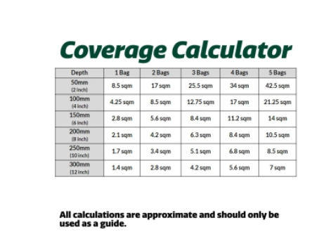

About to order the MOT Type 1 for the sub base. Going to hire a compactor and lay a sub base of about 50mm. Seems overkill for a shed installed on London clay, but there are lots of leylandii tree roots nearby and so I thought I might as well. But then I saw the prices of MOT Type 1 and almost feinted.
Do i really need this much:
Each bag is 800kg. My shed is going to be about 11 sq metres. One bag is a bit short wheras 2 bags is too much.
Could i lay less than 50mm? Would 30mm be enough given that I'm laying the probase plastic grids on top (which are 40mm thick and then filled with pebbles/crushed granite).
The plastic grids need small gravel infill, so why not use that for the base too? 11m2 x (50+40). 1m3. Two bags.
I think because MOT Type 1 base will compact better, whereas gravel won't really compact that well.
Query why the trays can't be filled with MOT type 1?
Type 1 is designed to be like solid stone when compacted, a recipe of large to small stones that pack solid. It will barely go into the grid.
For the wood you need single size stones, with gaps, to drain.
Under a shed anything will do. Type 1 is best but ott.
For 50mm over 11m2 I would buy a thumper for £20, but it won't compact gravel unless you blind it with sand.
Only cutting corners to save you money, do it with thick Type 1 if you want.
