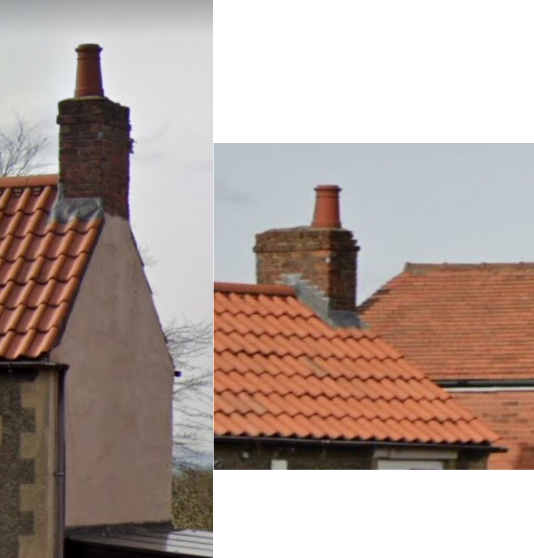

Ferdinand Posted October 24, 2022 Share Posted October 24, 2022 Just after a sanity check on a price and job proposal. Meet my chimney which has been dropping bits of mortar for a few months. I need to have a chimney reduced to just below the protruding course and above the flashing, and capped / ventilated as per usual. As you can see access is a little awkward, and will ideally need to be done from a roof ladder, since scaff would require the leanto roof to be dismantled or finessed. I couldn't easily find a roofer willing to do such a repair job. I do have a a pro-handyman who has just done a good job removing ivy growth from a roof (so I have reasonable confidence) offering to do the job in one day with one colleague for £450. He confirms he has the proper insurance. I'd expect a bit of incidental expenses on top, but does anyone have any comments. Is this a decent price. The chimney is low at approx 20ft height. Any comments would be welcome. Cheers Ferdinand Link to comment Share on other sites More sharing options...
markc Posted October 24, 2022 Share Posted October 24, 2022 As a price it seems pretty reasonable, very easy to have a brick fall onto that roof tho. 1 Link to comment Share on other sites More sharing options...
ProDave Posted October 24, 2022 Share Posted October 24, 2022 Just taking that pot off from just a roof ladder would frighten me. 1 Link to comment Share on other sites More sharing options...
joe90 Posted October 24, 2022 Share Posted October 24, 2022 It’s the sort of thing I would do without a thought years ago, older and wiser now tho. If the chap has the right experience and you think he is reliable then why not? I once put my scaffold tower on my car port roof to access the roof, got some funny looks but with a couple of acros underneath it was fine. 1 Link to comment Share on other sites More sharing options...
Ferdinand Posted October 24, 2022 Author Share Posted October 24, 2022 1 hour ago, markc said: As a price it seems pretty reasonable, very easy to have a brick fall onto that roof tho. The roof is actually quite strong - it is 2-ply chipcutter polyprop across 6x2" joists, and can be walked on with care (I always do them robustly). The plan is to put a couple of 8x4 sheets on it, which seems OK. 58 minutes ago, joe90 said: It’s the sort of thing I would do without a thought years ago, older and wiser now tho. If the chap has the right experience and you think he is reliable then why not? I once put my scaffold tower on my car port roof to access the roof, got some funny looks but with a couple of acros underneath it was fine. I hadn't considered acros - that would be a good idea if we need to do that. That chimney pot will come down in bits. It is perhaps less difficult to access than it looks - the front to back outside dimension of the house is 3.8m, so the roof is *really* small. Thanks all. Ferdinand Link to comment Share on other sites More sharing options...
joe90 Posted October 24, 2022 Share Posted October 24, 2022 12 minutes ago, Ferdinand said: hadn't considered acros - Or a few lengths of 4x2 wedged underneath. And a couple of sheets of old OSB to protect 🤷♂️ Link to comment Share on other sites More sharing options...
saveasteading Posted October 24, 2022 Share Posted October 24, 2022 Make sure that the capping is good for a few decades. I suggest making sure the construction is agreed, and also getting a photo to confirm. Assuming you are not going up to inspect. I don't know how to cap of a chimney. Rainproof but ventilated....somehow. Link to comment Share on other sites More sharing options...
PeterW Posted October 24, 2022 Share Posted October 24, 2022 I’d do that from a cherry picker - easy job. I would check though that the corbel course isn’t the lead soaker course too - if so I would want to keep the course above and then cap with a mix with a waterproof agent in the cement and also fit a vent pot. 1 Link to comment Share on other sites More sharing options...
