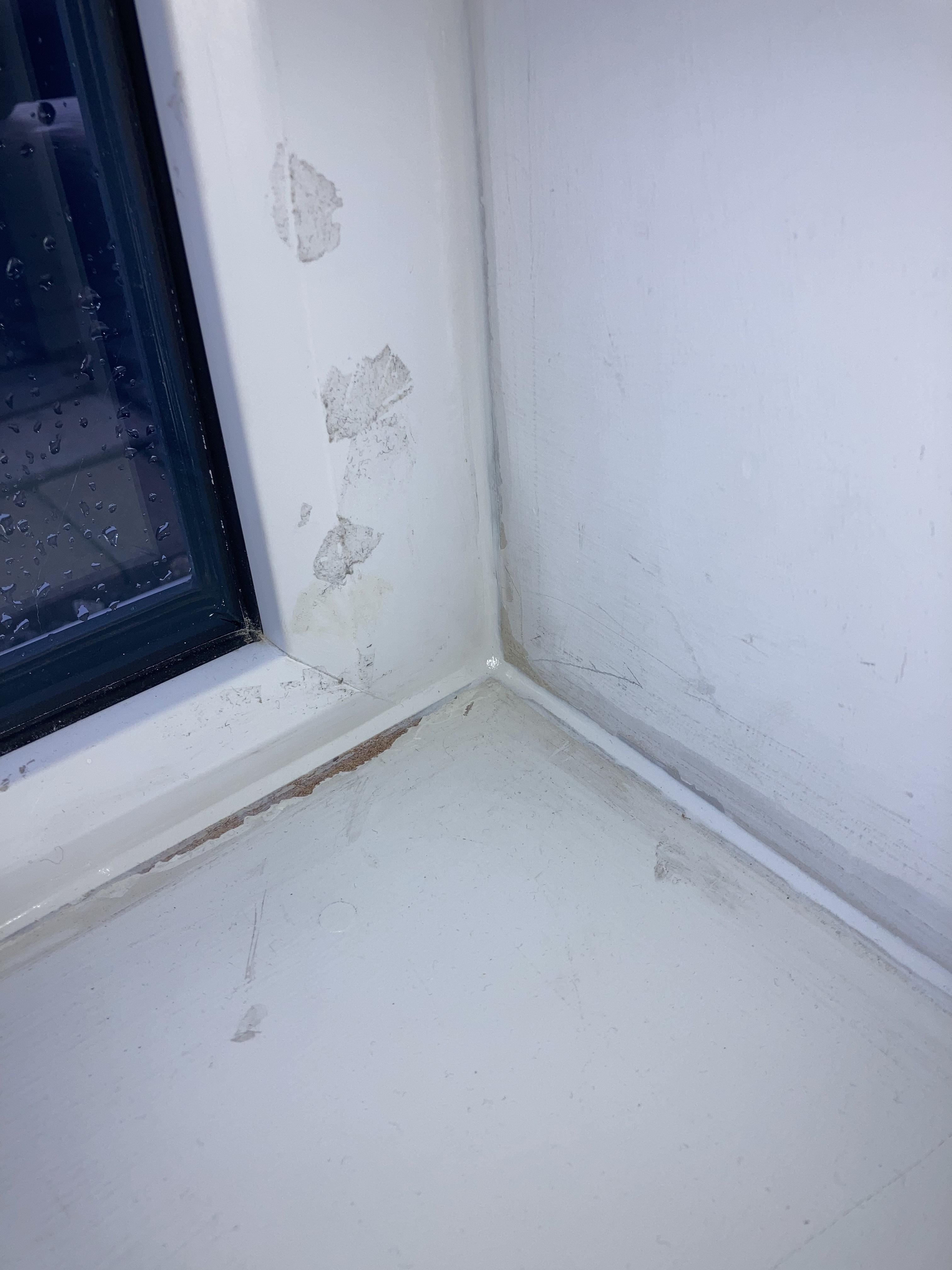

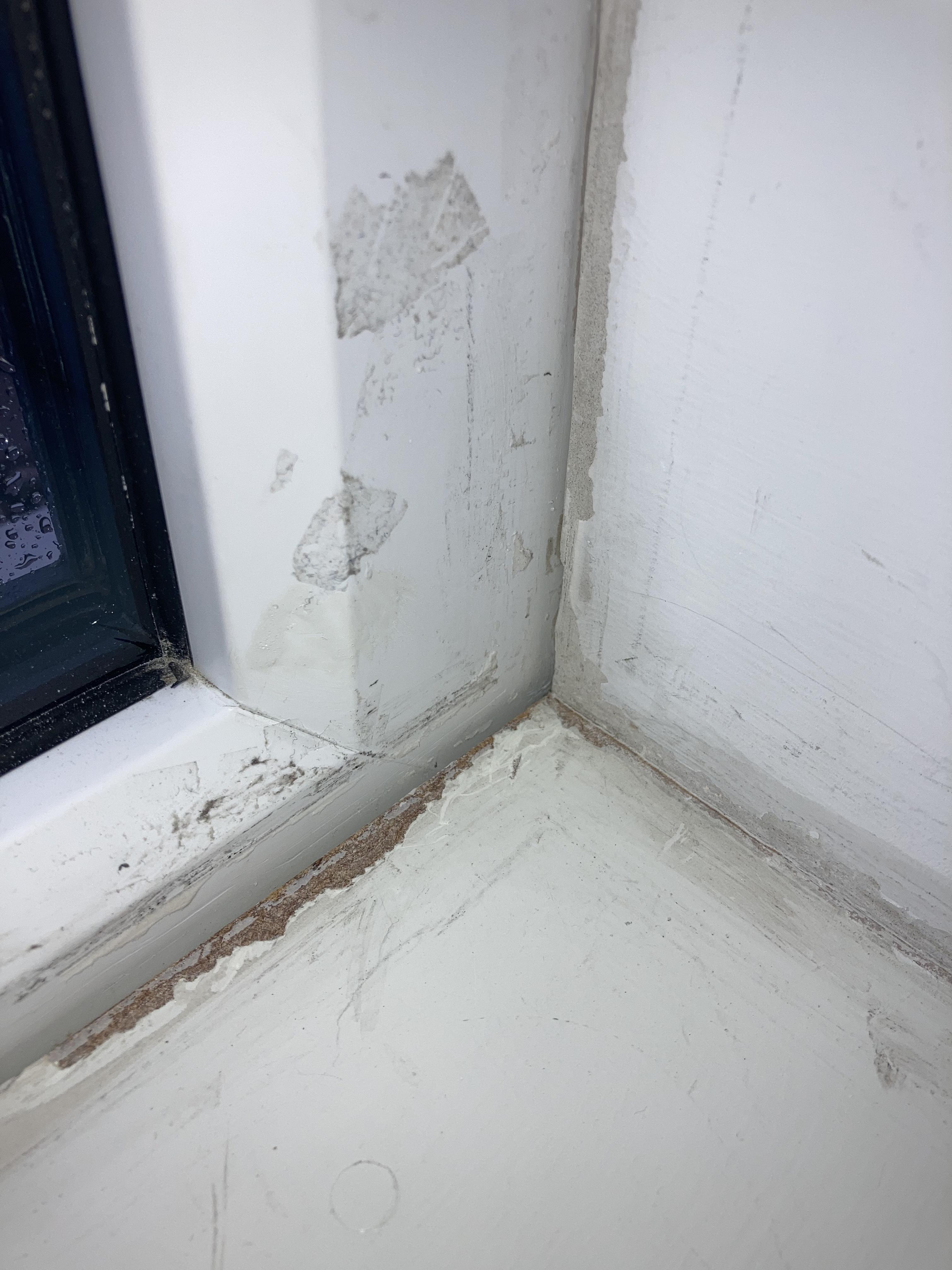

Alwayslearning22 Posted October 21, 2022 Posted October 21, 2022 Hi folks, I’ve a window in my house that hasn’t been sealed properly with window tape. so I’ve a nasty gale getting through. Is it a big job to remove the window board and retape it? Or should I just seal the gap with silicone? thanks
Roundtuit Posted October 21, 2022 Posted October 21, 2022 (edited) I'd just use decorators caulk as its paintable. Not sure taping would have been standard practice when they were installed, and there will be quite a bit of making good if you take the window board out I reckon. Edited October 21, 2022 by Roundtuit typo 1
Radian Posted October 21, 2022 Posted October 21, 2022 (edited) When you say silicone, that's not paintable so you end up with a messy edge. Plus if you tool it and get it on the surrounding area then that becomes difficult to decorate over. The only reason to use silicone is because of its flexibility. Acrylic is over-paintable but is less flexible and tends to dry out and crack so you're back to square on in a few years time. However, you can get a siliconised acrylic sealant which has the both the benefits. It's not going to be as thorough a fix as removing the full plasterboard reveal and window board and taping but it's so much simpler and should last a reasonably time. Edited October 21, 2022 by Radian 1 1

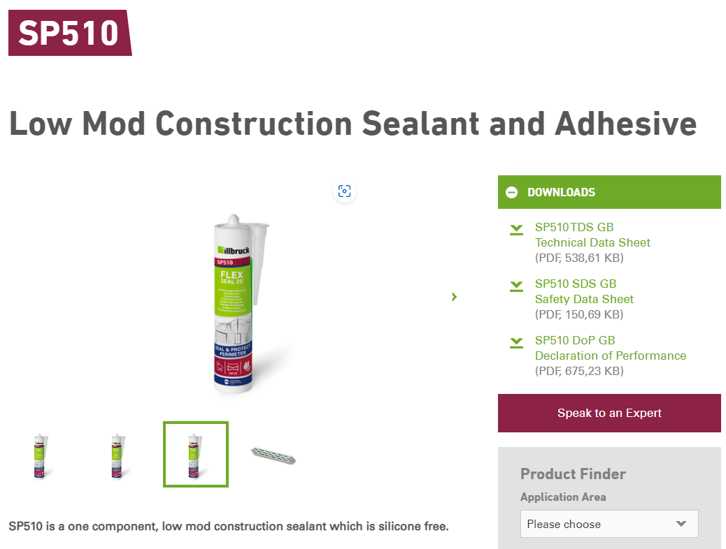

Iceverge Posted October 21, 2022 Posted October 21, 2022 White window, - white sealant, no problem. just mask off the area as you would if over painting a window. This is silicone free and designed for the job. This is a good video for the same technique. I would wipe with an alcohol wipe or similar solvent first and use @Nickfromwales baby wipes instead of paper wipes. 1

Radian Posted October 21, 2022 Posted October 21, 2022 1 hour ago, Alwayslearning22 said: I found this I wonder would it do the job? https://www.soudal.co.uk/diy/products/fix-all/fix-all/fix-all-flexi I don't know if they use the same testing regime but the Soudal product claims it has an Elongation at Break of 750% compared to SP510 at 500% - so I'd be happy to use it. In the absence of anything else, the ability of the sealant to remain attached to both surfaces is of paramount importance. 1

Alwayslearning22 Posted October 26, 2022 Author Posted October 26, 2022 Just incase anyone wondered about the workability of soudal fix all for sealing the internal window frame. I wouldn’t recommend it as it’s difficult to tool. Also I think caulk blends in nicer. 1
Pocster Posted October 26, 2022 Posted October 26, 2022 On 21/10/2022 at 12:11, Iceverge said: t and use @Nickfromwales baby wipes instead of paper He has his own brand of wipes ?? 1
Radian Posted November 4, 2022 Posted November 4, 2022 On 26/10/2022 at 16:45, Alwayslearning22 said: Just incase anyone wondered about the workability of soudal fix all for sealing the internal window frame. I wouldn’t recommend it as it’s difficult to tool. Also I think caulk blends in nicer. I finally got around to using the tube I bought and I'd agree that it's a bit on the wet & sticky side which makes tooling a challenge. In your photo, is that the Soudal fix all? It looks very neat. One thing that was unexpected is the smell. It hangs around more than most sealants!
Alwayslearning22 Posted November 5, 2022 Author Posted November 5, 2022 10 hours ago, Radian said: I finally got around to using the tube I bought and I'd agree that it's a bit on the wet & sticky side which makes tooling a challenge. In your photo, is that the Soudal fix all? It looks very neat. One thing that was unexpected is the smell. It hangs around more than most sealants! Yea it’s Soudal fix all. I used a Fugi tool and baby wipes. Always leaves a professional finish. I once paid a mastic man to seal my shower he was very expensive so I decided it was time to learn the craft. I agree with the smell was surprising considering it claims no Odour. I painted over it too and the paint keeps cracking. 1
