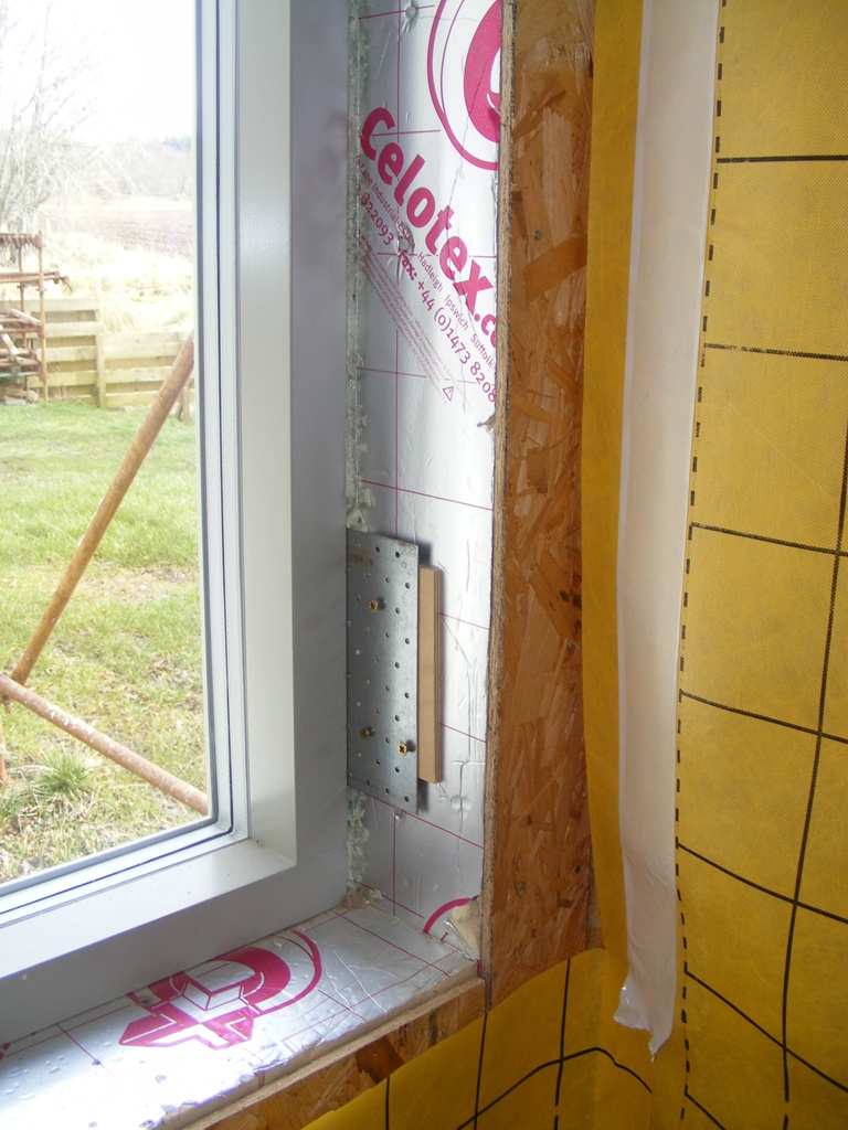

ProDave Posted June 22, 2017 Posted June 22, 2017 Our windows were fitted in openings deliberately made 50mm bigger in both dimensions. The frame opening were first lined with 20mm PUR insulation and any remaining gap then filled with expanding foam. 1

ProDave Posted June 23, 2017 Posted June 23, 2017 In my case the bottom piece of standard PIR / PUR type insulation comfortably supported the weight of the windows until the fixing plates were screwed home.

Russell griffiths Posted June 23, 2017 Author Posted June 23, 2017 On 22/06/2017 at 21:48, ProDave said: Our windows were fitted in openings deliberately made 50mm bigger in both dimensions. The frame opening were first lined with 20mm PUR insulation and any remaining gap then filled with expanding foam. Expand This @ProDave is exactly what I am thinking about. Can you say why you did this? Do you think the insulation on the stud/jamb surface will help with cold bridging from inside to out. Any pics.

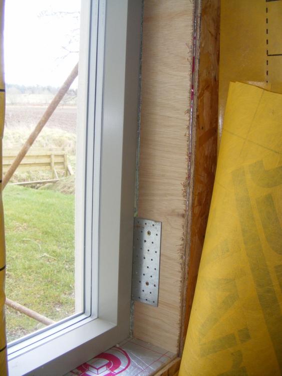

ProDave Posted June 23, 2017 Posted June 23, 2017 On 23/06/2017 at 09:00, Russell griffiths said: This @ProDave is exactly what I am thinking about. Can you say why you did this? Do you think the insulation on the stud/jamb surface will help with cold bridging from inside to out. Any pics. Expand It was the builders suggestion, the ones that build my frame, to make the window openings over size and line them with rigid insulation to reduce any cold bridging. It really was simple, make the openings too big, fix 20mm Celotex strips around the sides then fit the windows. fill in any gap left with expanding foam. I later tidied up the packing detail to fit a continuous strip of ply packing, and countersunk the screws into the fixing plates Then the airtightness membrane wraps around and gets taped to the window frames 1
