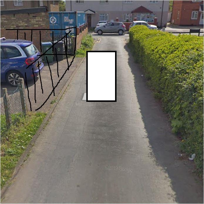

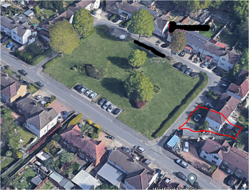

deemi786 Posted October 18, 2022 Share Posted October 18, 2022 Hi there all, We live in a semi detached house at the end of our road. Opposite the front of the house is a small narrow road that follows the houses in a u shape, within the centre is a field that is maintained by the local housing association. Our front garden is split up with an area of shingle to the far left , a patch of grass in the middle and tarmac as a driveway to the far right and to the side of the property. We would now like to repurpose the side of the house and incorporate that into the back garden (since the existing back garden is so small) move the driveway over to the middle and leave the shingle area as is. See my very rudimentary drawings below. We aim to dig up the tarmac area, plant grass and make that a part of the back garden with a shed on it. (6x8) Anything shorter than a 6 foot fence across and we really wouldnt feel safe leaving the kids to play by themselves in the front side garden. (New plans below) My question is are 6 foot fence panels permissable here as its a rear garden or does the fact it is near a public "highway" road and could be recognised as the front of the house mean it is not permissable and needs to be 3 foot? I tried contacting planning permision in our local council but they dont take phone calls and the only advice is pay £££ to some recognised consultants they are outsourcing to help. Any help would be appreciated or alternatives to fence panels (hedging etc) would be appreciated.. Link to comment Share on other sites More sharing options...

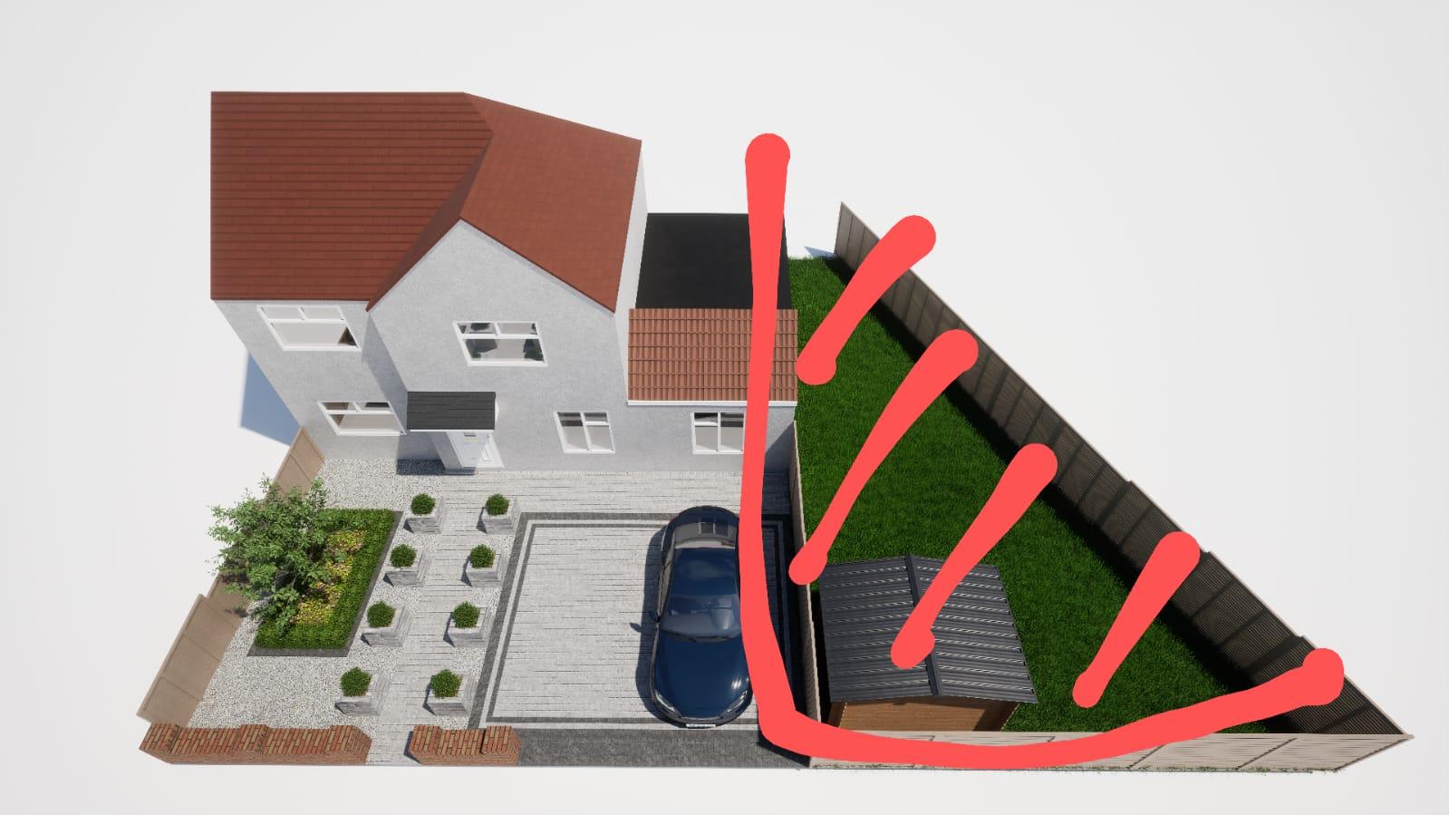

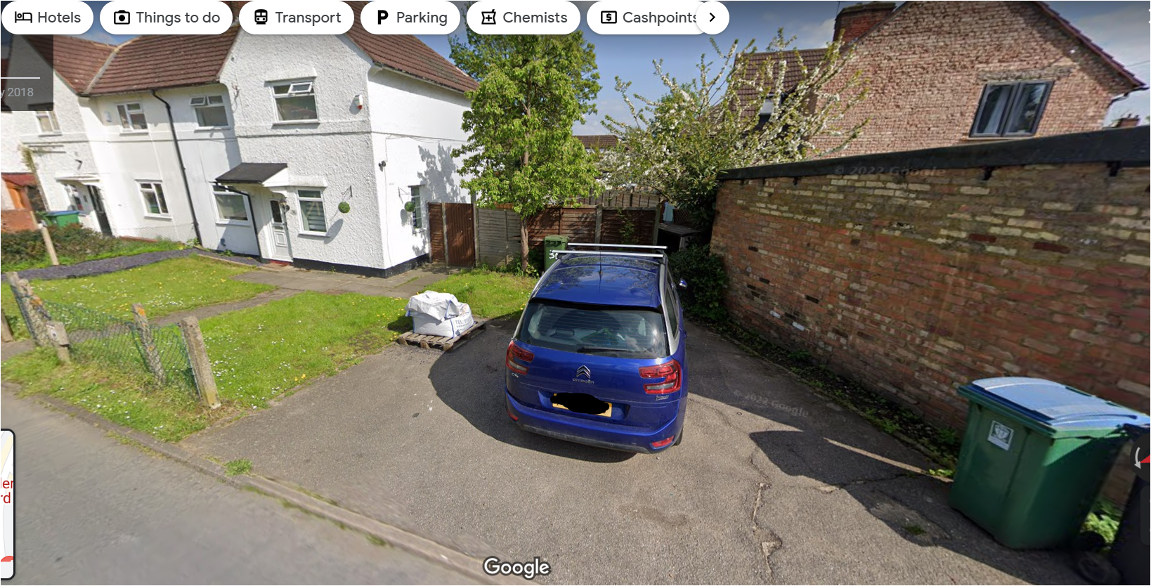

deemi786 Posted October 18, 2022 Author Share Posted October 18, 2022 Apologies it isnt clear, above is the proposed , below is the existing. Why would the shed require planning permission? There was actually a shed located just near where the blue car is parked below some time ago but has since been removed, the concrete base is still there and its on the title plans. Link to comment Share on other sites More sharing options...
Ferdinand Posted October 18, 2022 Share Posted October 18, 2022 TBH I'd say that is your front garden, not the back garden. And you are likely to need PP for the shed in front of the building line, unless perhaps you use one of those semi-sheds that is a storage locker 1-1.2m high. Unfortunately it is likely to be determined by the building line, not by calling an enclosed front garden a "back garden". Sorry 😒. If the shed has only just gone you may get away with whumping another one there immediately, and hope no one notices. Otherwise imo you will need PP. except perhaps for the new driveway if you make it permeable to water (which makes it Permitted Development). Or you just do it and see if anyone jumps on you, then go for a Retrospective PP. But then you have a risk of not getting it and having to take it all away again. Since you will be spending a few thousand, I'd say go for PP. It may be worth phoning up the Council and making an appointment to talk to a Planner at the front desk, where you may get some useful guidance as to the rules that will apply. Frame it as you being intimidated by the system, and take your before and after along. It looks like an attractive scheme for your kids, so I'd say give it a try. HTH. F 1 Link to comment Share on other sites More sharing options...

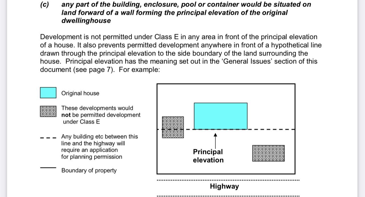

DevilDamo Posted October 18, 2022 Share Posted October 18, 2022 (edited) 56 minutes ago, deemi786 said: Why would the shed require planning permission? Because outbuildings forward of the principal elevation are not PD, irrespective if there was a shed/outbuilding there before. Edited October 18, 2022 by DevilDamo 1 Link to comment Share on other sites More sharing options...
deemi786 Posted October 18, 2022 Author Share Posted October 18, 2022 is that of any height? Link to comment Share on other sites More sharing options...
DevilDamo Posted October 18, 2022 Share Posted October 18, 2022 The height is irrelevant. An outbuilding is an outbuilding. But you will find people putting up stores, sheds in their front gardens without Planning. Technically, they’re in breach but Planning would need to take a view as to whether they would take action against it. It only needs a neighbour to report the potential unauthorised works. 1 1 Link to comment Share on other sites More sharing options...
deemi786 Posted October 18, 2022 Author Share Posted October 18, 2022 in the rear garden it goes then... Link to comment Share on other sites More sharing options...
DevilDamo Posted October 18, 2022 Share Posted October 18, 2022 Just for reference. 1 Link to comment Share on other sites More sharing options...

Temp Posted October 19, 2022 Share Posted October 19, 2022 21 hours ago, deemi786 said: My question is are 6 foot fence panels permissable here as its a rear garden or does the fact it is near a public "highway" road and could be recognised as the front of the house mean it is not permissable and needs to be 3 foot? The fence along the edge of the road would have to be 1m to be permitted development. The one running at 90 degrees to the road can be 6ft but the planners would probably prefer it to be 3ft to preserve the open aspect. Link to comment Share on other sites More sharing options...
