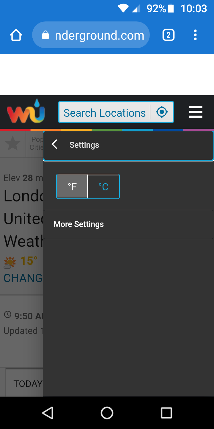

SteamyTea Posted October 18, 2022 Share Posted October 18, 2022 40 minutes ago, JohnBishop said: I have 4 measurements at the moment: Run it though here, find a local WeatherUnderground station to get pressure and outside temp and RH. Link to comment Share on other sites More sharing options...
JohnBishop Posted October 19, 2022 Author Share Posted October 19, 2022 21 hours ago, SteamyTea said: Run it though here, find a local WeatherUnderground station to get pressure and outside temp and RH. Where can you see the pressure on WeatherUnderground? I see Pressure but it's given as 30.27 in From https://www.forecast.co.uk/pressure/ it's 1025 Absolute humidity, kg/m3 - 0.008 (outside) Absolute humidity, kg/m3 - 0.009 (downstairs) Absolute humidity, kg/m3 - 0.011 (room 1 upstairs) Absolute humidity, kg/m3 - 0.010 (room 2 upstairs) Link to comment Share on other sites More sharing options...
SteamyTea Posted October 19, 2022 Share Posted October 19, 2022 3 minutes ago, JohnBishop said: Where can you see the pressure on WeatherUnderground In the settings. Link to comment Share on other sites More sharing options...
JohnBishop Posted October 19, 2022 Author Share Posted October 19, 2022 Ok, thank you. Yes so the number I used is correct 1024hPa Link to comment Share on other sites More sharing options...
SteamyTea Posted October 19, 2022 Share Posted October 19, 2022 1 minute ago, JohnBishop said: Ok, thank you. Yes so the number I used is correct 1024hPa It will be different now. Storm coming in (well down here anyway). Link to comment Share on other sites More sharing options...

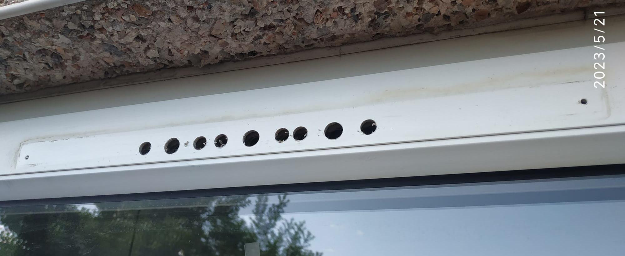

JohnBishop Posted May 22, 2023 Author Share Posted May 22, 2023 I have removed the plastic covers from the outside. Can I simply fill the holes with expanding foam? Then I wanted to simply cover it with two layers duct tape and aluminium tape on top. Link to comment Share on other sites More sharing options...
Dave Jones Posted May 22, 2023 Share Posted May 22, 2023 house full of mould if you have no airflow. Link to comment Share on other sites More sharing options...
crispy_wafer Posted May 22, 2023 Share Posted May 22, 2023 Probably not a great idea, unless you have an alternate means of ventilation. Link to comment Share on other sites More sharing options...
jayc89 Posted May 22, 2023 Share Posted May 22, 2023 Now you've ripped it off, I'd replace it with one of the automatic vents that have already been suggested. It should remain closed, or at least partially closed, when humidity is at a satisfactory level. Having just fitted mechanical ventilation to a house void of any trickle vents, I highly recommend you don't seal them up without some other method of ventilation to those rooms. (Over winter, even the window in our 8 year old kids room would be dripping wet every morning) Link to comment Share on other sites More sharing options...
JohnBishop Posted May 22, 2023 Author Share Posted May 22, 2023 (edited) 4 hours ago, jayc89 said: Now you've ripped it off, I'd replace it with one of the automatic vents that have already been suggested. It should remain closed, or at least partially closed, when humidity is at a satisfactory level. Having just fitted mechanical ventilation to a house void of any trickle vents, I highly recommend you don't seal them up without some other method of ventilation to those rooms. (Over winter, even the window in our 8 year old kids room would be dripping wet every morning) I know but this is too expensive to fit a fancy device on every window. I don't think I need it on every window in the house. Maybe I leave one or 2 on each floor but I don't need like 10 of them. Besides probably the screw holes do not line up and I will have to drill two more holes and it will look bad. I want to fill the void with something then duct and aluminium tape and screw these plastics back on. 4 hours ago, crispy_wafer said: Probably not a great idea, unless you have an alternate means of ventilation. 4 hours ago, Dave Jones said: house full of mould if you have no airflow. as I said I had them all blocked over the winter and no mould or humidity over 52%. There are vents in the bathroom, a big one in the kitchen and a fire stove that most likely circulates all the air from downstairs. Edited May 22, 2023 by JohnBishop 1 Link to comment Share on other sites More sharing options...
SteamyTea Posted May 22, 2023 Share Posted May 22, 2023 Squirt foam in, easy enough to poke a hole through it with a drill if you have to. You could get some white PVC and stick that over the holes. May look better. 1 Link to comment Share on other sites More sharing options...
