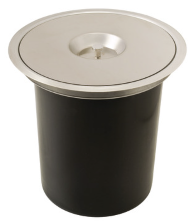

puntloos Posted October 16, 2022 Share Posted October 16, 2022 Subject says most of it, the main idea of course is that if you're prepping, it would be great to just whip anything into some type of bin, and I'm thinking having one embedded in my worktop. Something like: But a crucial problem: the smell. I'm told that having the food waste simmer not inside a cabinet inside a caddy (admittedly in my case only perhaps 80 cm below my worktop) but in a potentially not-very-well sealing bin could be problematic. What approach do you all recommend? Ideally something where getting rid of waste is "one quick flick" away rather than having to pull a caddy out (typically getting your hands dirty) or having some bowl or your sink serve as a temporary caddy, which just delays the problem and clogs up the sink.. Thoughts much appreciated 😃 Link to comment Share on other sites More sharing options...

Conor Posted October 16, 2022 Share Posted October 16, 2022 ^^^Get an insinkerator. One of my favourite things in our kitchen. Contemplated a prep sink in the island with an insinkerator, but in the end prioritised prep space instead and have it in the main sink directly behind prep area. 90% of our food waste goes down it. 1 Link to comment Share on other sites More sharing options...
puntloos Posted October 16, 2022 Author Share Posted October 16, 2022 7 minutes ago, Conor said: ^^^Get an insinkerator. One of my favourite things in our kitchen. Ha funny, my parents, in the late 60s, considered such a thing, and we had a glaring hole in our sink ready for it. Only to be told it was illegal. So here's my current assumption, based on 60's knowledge Good idea then. 7 minutes ago, Conor said: Contemplated a prep sink in the island with an insinkerator, but in the end prioritised prep space instead and have it in the main sink directly behind prep area. 90% of our food waste goes down it. I do have a prep sink planned anyway in fact. Would you agree adding an insinkerator to it would be almost a no-brainer? Link to comment Share on other sites More sharing options...

markocosic Posted November 5, 2022 Share Posted November 5, 2022 BIN DRAWER Not like this: But like this: With lids removed and 2x large size bins in a 600 wide drawer. Make mess. Open drawer with clean hand. Sweep off worktop into bin with dirty hand. Close drawer. Open drawer. Dunk teabag in bin. Close drawer. No missing. No splashing. Honestly life changing. It...doesn't smell if emptied weekly...unless you fill it with the kind of smoked fish that stinks the place up before it has a chance to rot. Smoked fish day = bin empty day. 🙂 We also have a waste disposal for goo. We started with only this but since getting putting the bings in a drawer and the tins on shelves under the sink a lot just goes in the bin these days. Try it by sticking a bowl in a drawer and filling that? Link to comment Share on other sites More sharing options...
puntloos Posted November 6, 2022 Author Share Posted November 6, 2022 Thanks all, I think the bin drawer is not a bad option, but I think it's the waste disposal unit route for me. Permanently being able to whip food into the sink (not to mention stuff you've already been peeling, just let it drop from your hands) seems like a very sensible approach. Just have to think a bit about "what if your favorite xyz drops into the WDU" Link to comment Share on other sites More sharing options...
