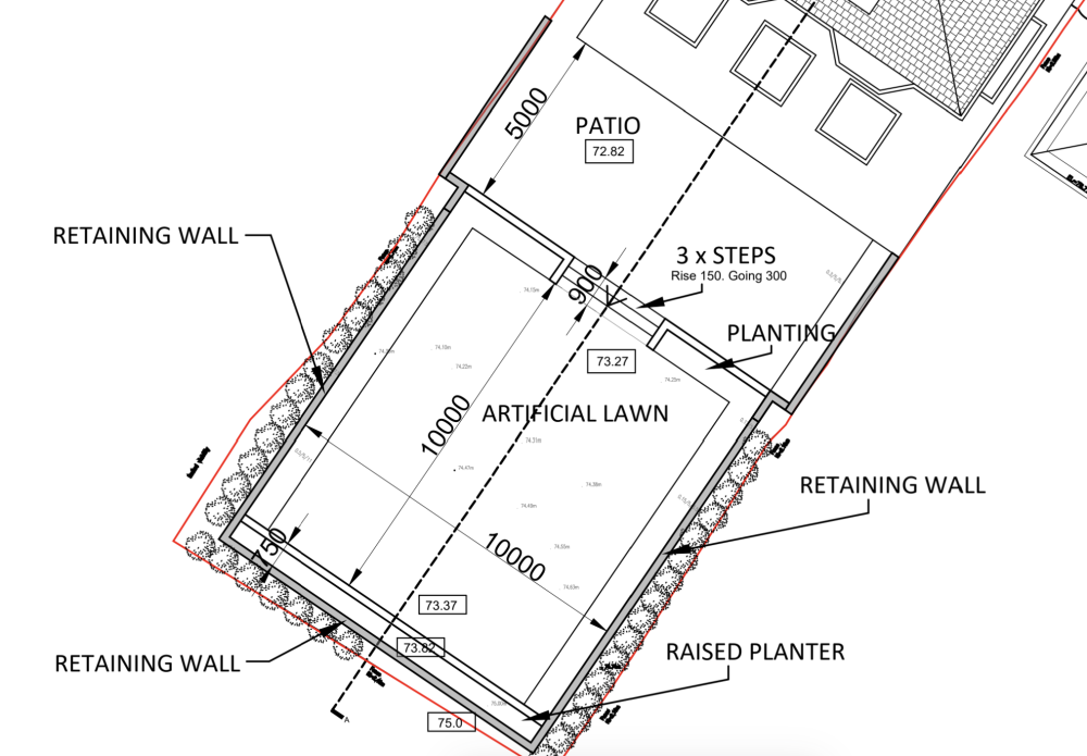

bmj1 Posted October 12, 2022 Posted October 12, 2022 (edited) This is a fun one... We were granted planning for demolition + rebuild, and as part of that agreed levels for our rear garden that showed a patio in line with FFL, and then 8 steps up to the back of the garden In the final event, we excavated a bit more, so just 3 steps up to the back garden (so an extra ~90cm of height has been excavated from the rear part of the garden, and a taller retaining wall has been put in place around the garden) A lovely neighbour has kindly reported us to the council for the levels in our rear garden not matching planning (i.e. being 90cm lower). This picture shows what we have actually done: Our planner has advised we can be fairly relaxed in terms of enforcement because lowering the garden doesn't cause detriment/harm to anyone. But - I wanted to ask the wizards here for any advice on this. Should I be worried ? Any suggestions for points that should be made to the planners to secure a favourable outcome from the upcoming investigation. Any feedback appreciated. Many thanks in advance Edited October 12, 2022 by bmj1

Temp Posted October 12, 2022 Posted October 12, 2022 (edited) My guess is they are worried about your retaining walls. Building Control Approval isn't required for a retaining wall (surprisingly) unless it supports a building or neighbours building, but Building Control have powers to intervene if its unsafe. Do they have any buildings near the boundary? If so the Party Wall Act may apply. https://www.gov.uk/government/publications/preventing-and-resolving-disputes-in-relation-to-party-walls/the-party-wall-etc-act-1996-explanatory-booklet There is no penalty for not complying with the PWA but if an existing building or structure is/was damaged then not having complied might go against you if they took you to court. If there are no buildings nearby then I would take and date some photos showing they weren't there when the walls were built. Edited October 12, 2022 by Temp
bmj1 Posted October 12, 2022 Author Posted October 12, 2022 @joe90, @Ferdinand, @Kelvin, @NSS, @Onoff, @Temp: Ok, so an update on this one: I realised since posting this that we've actually excavated closer to 1.8m at the back of the site, due to the slope (will measure it tomorrow, hopefully under the key 2m threshold). This retaining wall is 1 meter from their boundary, and they do have an out-house of sorts at the end of their garden, likely within 3m from our retaining wall. However, this work was conducted 6 months back.. Before anyone asks, the concrete block wall is reinforced with vertical steel bars, a horizontal steel mesh, and a heel and toe. We've also got drainage behind it. Planner has reached out to me, and I've offered them a site visit (I figure this will serve us better than photos), and I'd like the chance to address any concerns. I think probably sensible to also have our planning consultant attend the site visit so we can best address any concerns. It would be interesting to understand the neighbour's actual concerns - but as far as I can tell - they just seem to be 'one of those'. They objected to our rear dormer on the basis it impacted their privacy, despite it being 60 metres away from their house... I.e. I think @joe90 has got the right idea.. Any other ideas gratefully received 3

Temp Posted October 13, 2022 Posted October 13, 2022 +1 on the planning consultant. He will probably tell you what's likely to happen.. Typically when someone complains about a development the planners will investigate to see if Planning Permission is/was required. If its not required that will be the end of it. They will write to the objector and state that fact. If they decide it is required they may feel obliged to issue a Notice of intended enforcement. If you get one of those don't panic because they may just want you file a retrospective Planning Application to regularise the situation. Hopefully the Planning Officer will tell you what he thinks when he visits. Filing a planning application stops any enforcement action until its processed. Even if Planning Permission is refused you can appeal.
