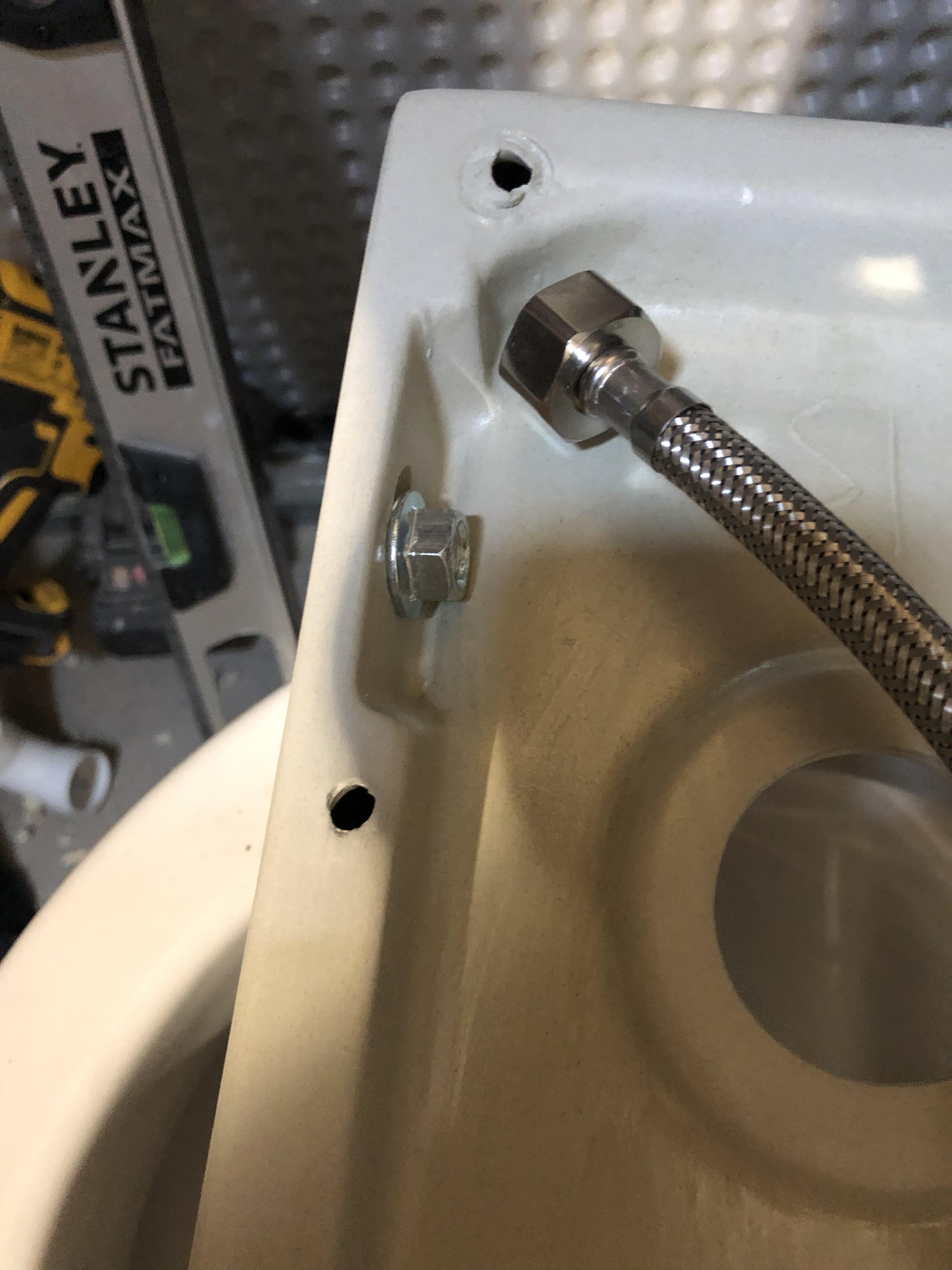

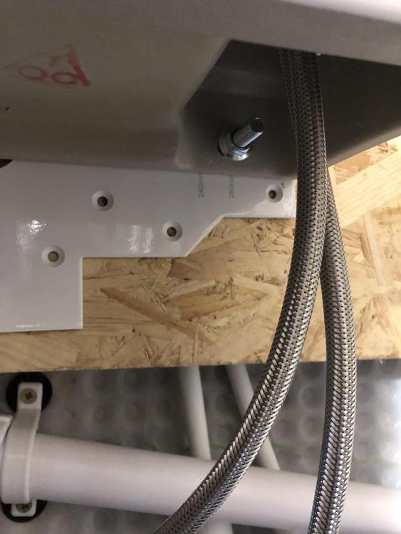

Pocster Posted October 11, 2022 Share Posted October 11, 2022 Small hand basin . It would seem impossible to : fit the plastic washers that keep the steel away from the porcelain and allow adjustment . Though I’ve put a rubber sleeve over the bolts for now . The 2nd nut is impossible to fit . Any advice welcome Link to comment Share on other sites More sharing options...

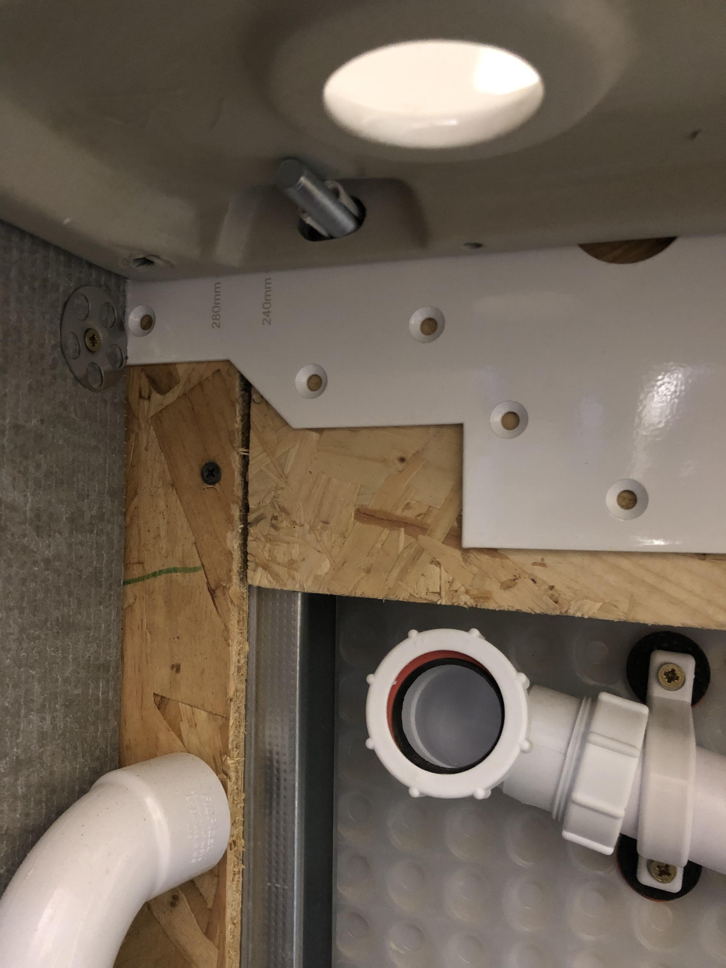

Pocster Posted October 11, 2022 Author Share Posted October 11, 2022 Ffs ! I choose this wall mount system rather than the 2 bolts into masonry because this is a stud wall . Mounting system is causing me more problems though . Link to comment Share on other sites More sharing options...
Pocster Posted October 11, 2022 Author Share Posted October 11, 2022 Right ! F this wall fitting . Take board off wall - wooden noggins and screw bolts into that . Still won’t be able to get a nut on one of them . ct1 back of sink to tiles ??? At least I can fit the waste correctly then .. f ing rubbish Link to comment Share on other sites More sharing options...

Onoff Posted October 11, 2022 Share Posted October 11, 2022 That left hand stud sticking out can't be level.... Link to comment Share on other sites More sharing options...
Carrerahill Posted October 11, 2022 Share Posted October 11, 2022 3 minutes ago, pocster said: Nope . Manufacture of basin supplies no wall fittings . That all looks like a right pig. I can think of a few things I would do, but what about, extend the notch on the back plate so the rod can drop down and under the porcelain, so the sink sort of sits on it then use a big square washer with a rubber gasket behind it, nyloc nut, torque it up, you get clamping force and some under support, a blob of CT1 may do no harm as well. Link to comment Share on other sites More sharing options...

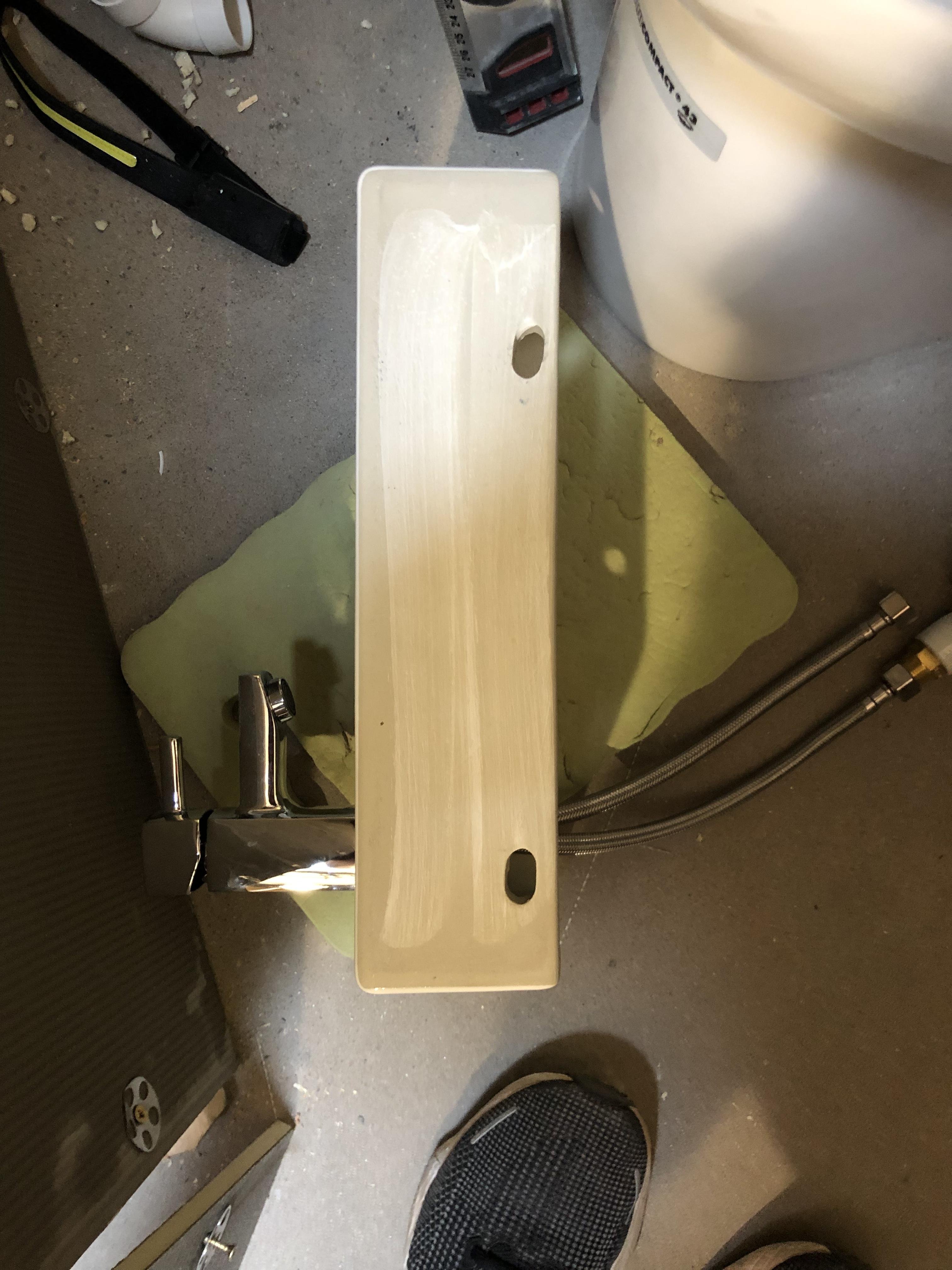

Pocster Posted October 11, 2022 Author Share Posted October 11, 2022 7 minutes ago, Carrerahill said: That all looks like a right pig. I can think of a few things I would do, but what about, extend the notch on the back plate so the rod can drop down and under the porcelain, so the sink sort of sits on it then use a big square washer with a rubber gasket behind it, nyloc nut, torque it up, you get clamping force and some under support, a blob of CT1 may do no harm as well. The slots on the back of the porcelain aren’t level ( photo to follow ) . I could try your ‘ clamp ‘ idea . Could also cut that wall plate in half so my waste has got a chance to get to the bottle trap . I don’t know who designs these things - clearly they do not try actually fixing them to a wall ! Link to comment Share on other sites More sharing options...
Mr Punter Posted October 11, 2022 Share Posted October 11, 2022 The mounting holes on the sink are much too low down. It does not look like it will work wall mounted. Maybe it is for a pedestal or countertop. Link to comment Share on other sites More sharing options...
Pocster Posted October 11, 2022 Author Share Posted October 11, 2022 2 minutes ago, Mr Punter said: The mounting holes on the sink are much too low down. It does not look like it will work wall mounted. Maybe it is for a pedestal or countertop. Nope it’s a wall mount basin 🙄 Link to comment Share on other sites More sharing options...
joe90 Posted October 11, 2022 Share Posted October 11, 2022 It looks like the left hole in the porcelain is too close to the top to allow the nut to fit? Is this correct? Link to comment Share on other sites More sharing options...
Mr Punter Posted October 11, 2022 Share Posted October 11, 2022 But the holes only have about 10mm of material under to stop it levering off the wall. Send a photo when it is fitted. 1 1 Link to comment Share on other sites More sharing options...
Pocster Posted October 11, 2022 Author Share Posted October 11, 2022 6 minutes ago, joe90 said: It looks like the left hole in the porcelain is too close to the top to allow the nut to fit? Is this correct? Yes also holes are on the piss Link to comment Share on other sites More sharing options...

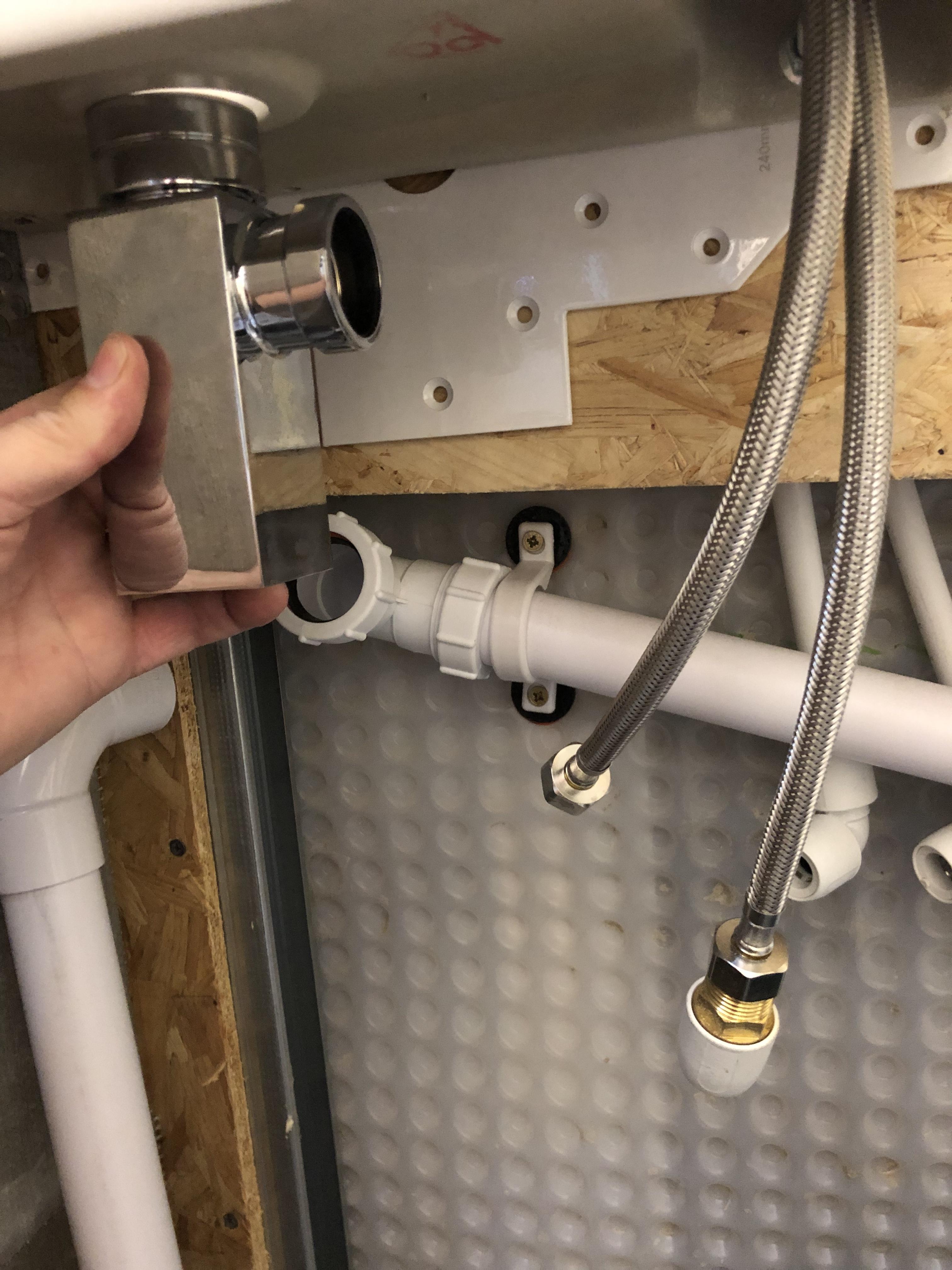

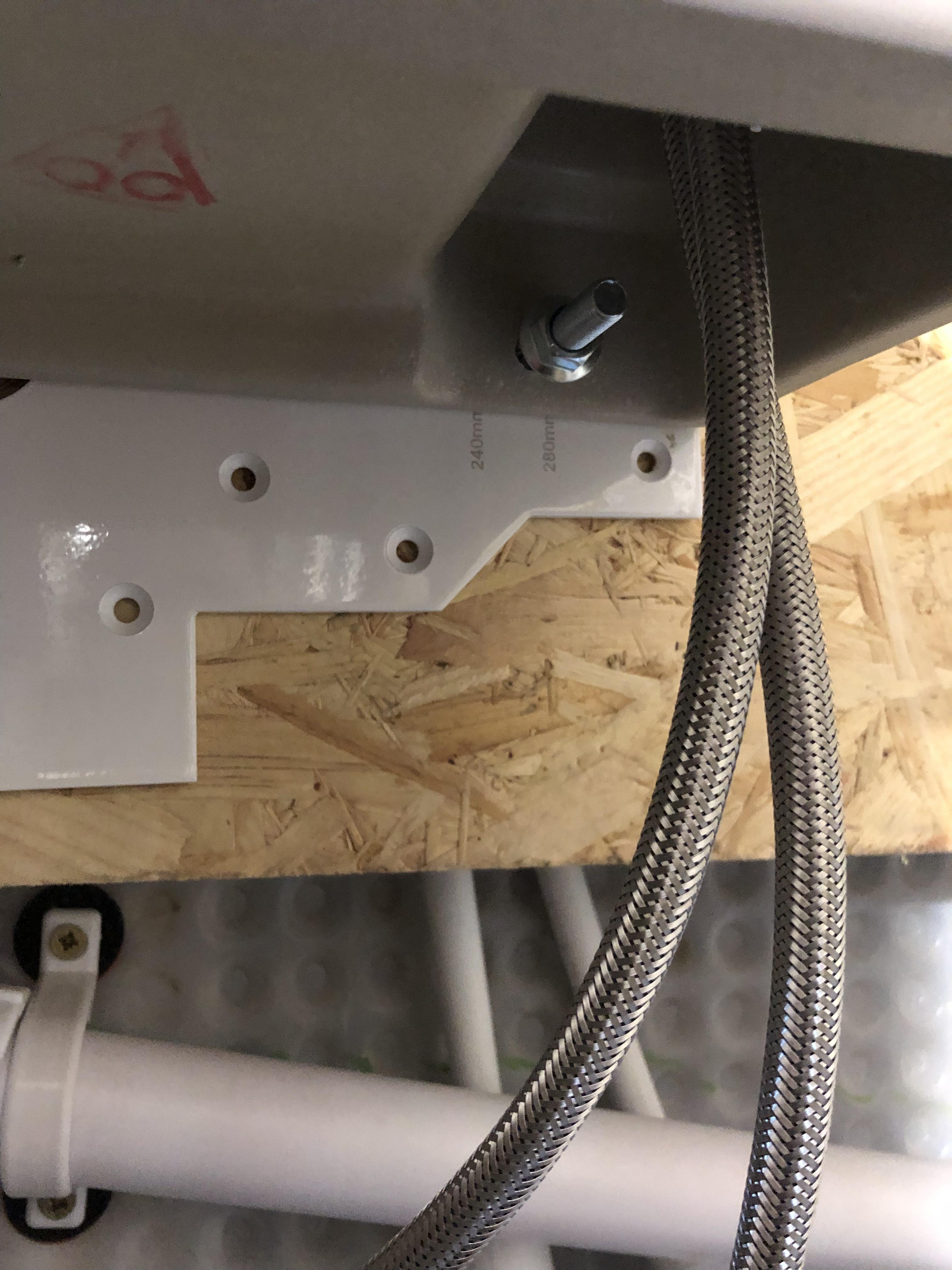

Pocster Posted October 11, 2022 Author Share Posted October 11, 2022 It’s going in a corner , so I can fit one nut - will ct1 back and corner fixing . Tempted to get 3 small steel 90 degree brackets to go under it ( 2 for rear , 1 for corner side ) Link to comment Share on other sites More sharing options...
joe90 Posted October 11, 2022 Share Posted October 11, 2022 Or fit a batten across the back (won’t be seen) and a small bracket or batten under the side 👍 1 Link to comment Share on other sites More sharing options...
Pocster Posted October 11, 2022 Author Share Posted October 11, 2022 Might be able to cut that bolt . But it’s going to be tight if I need to get rubber grommet in there also Link to comment Share on other sites More sharing options...
Pocster Posted October 11, 2022 Author Share Posted October 11, 2022 24 minutes ago, joe90 said: Or fit a batten across the back (won’t be seen) and a small bracket or batten under the side 👍 Yes . Probably better than faffing around with this shite . VictoriaPlum if anyone wants to know 😞 Link to comment Share on other sites More sharing options...
joe90 Posted October 11, 2022 Share Posted October 11, 2022 (edited) 47 minutes ago, pocster said: Probably better than faffing around with this shite I would still leave the wall fixings with the nut on the right h/s, if you cannot get the nut on the left one you need to pack the hole around the threaded stud to stop the basin lifting in that corner from the basin being leaned on at the front right corner 🤔. Edited October 11, 2022 by joe90 Link to comment Share on other sites More sharing options...
Pocster Posted October 11, 2022 Author Share Posted October 11, 2022 8 minutes ago, joe90 said: I would still leave the wall fixings with the nut on the right h/s, if you cannot get the nut on the left one you need to pack the hole around the threaded stud to stop the basin lifting in that corner from the basin being leaned on at the front right corner 🤔. Yeah I agree . Will do that and a pair of brackets . Really annoys me ! . I expect myself to be wrong ( and fix it ) but when it’s produced like this it’s a joke 😡 1 Link to comment Share on other sites More sharing options...
Pocster Posted October 11, 2022 Author Share Posted October 11, 2022 17 minutes ago, pocster said: Yeah I agree . Will do that and a pair of brackets . Really annoys me ! . I expect myself to be wrong ( and fix it ) but when it’s produced like this it’s a joke 😡 Actually I’ll mount that right bolt . Thread the left ( but no nut ) . Take the tile board down on the left ( corner ) . Fit nogging . Then can have 1 L bracket coming out which will support that side and the front . Think I’ll embed it in the wall before tiling . 1 Link to comment Share on other sites More sharing options...
