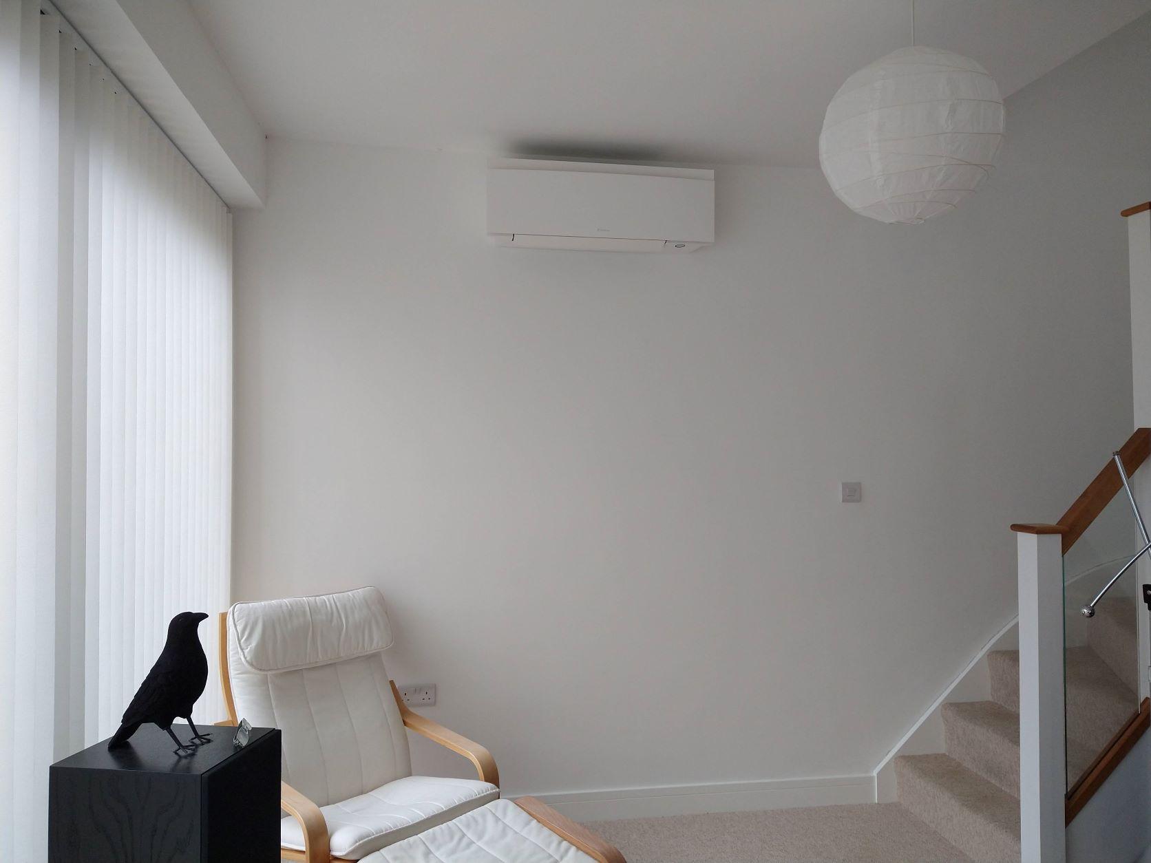

Radian Posted October 12, 2022 Share Posted October 12, 2022 49 minutes ago, pudding said: I fitted 2 Daikin Emura units ( 1 in a dining room/1 in a study/spare bedroom) and 1 Stylish, unit in our extension a couple of years ago. The Emura unit in a spare bedroom is absolutely fine noise wise. The Emura units are the only heat source in those rooms and works great, only a gentle air flow comes through them and most of the time theyre only very slowly ticking over, you need to get close to feel and hear them. Third gen. Emura are the ones I've gone for. They're large but can go very lazy. It's a bit like PC fans, the big ones tend to be quieter than the little'uns. This is in a 4m wide room to give an idea of scale: Link to comment Share on other sites More sharing options...
